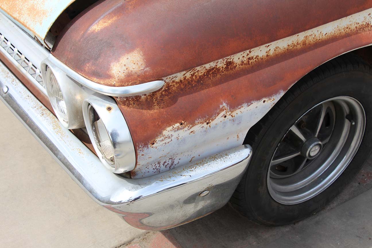

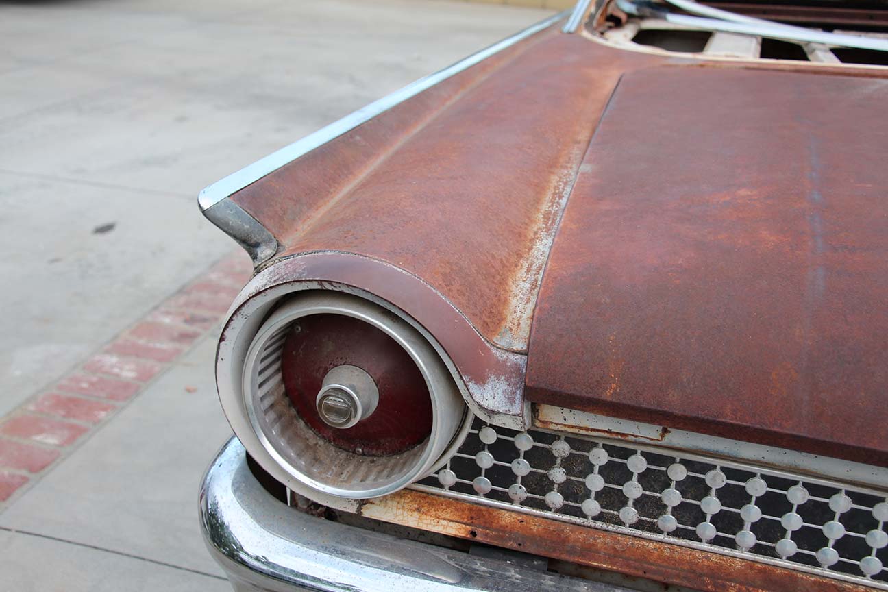

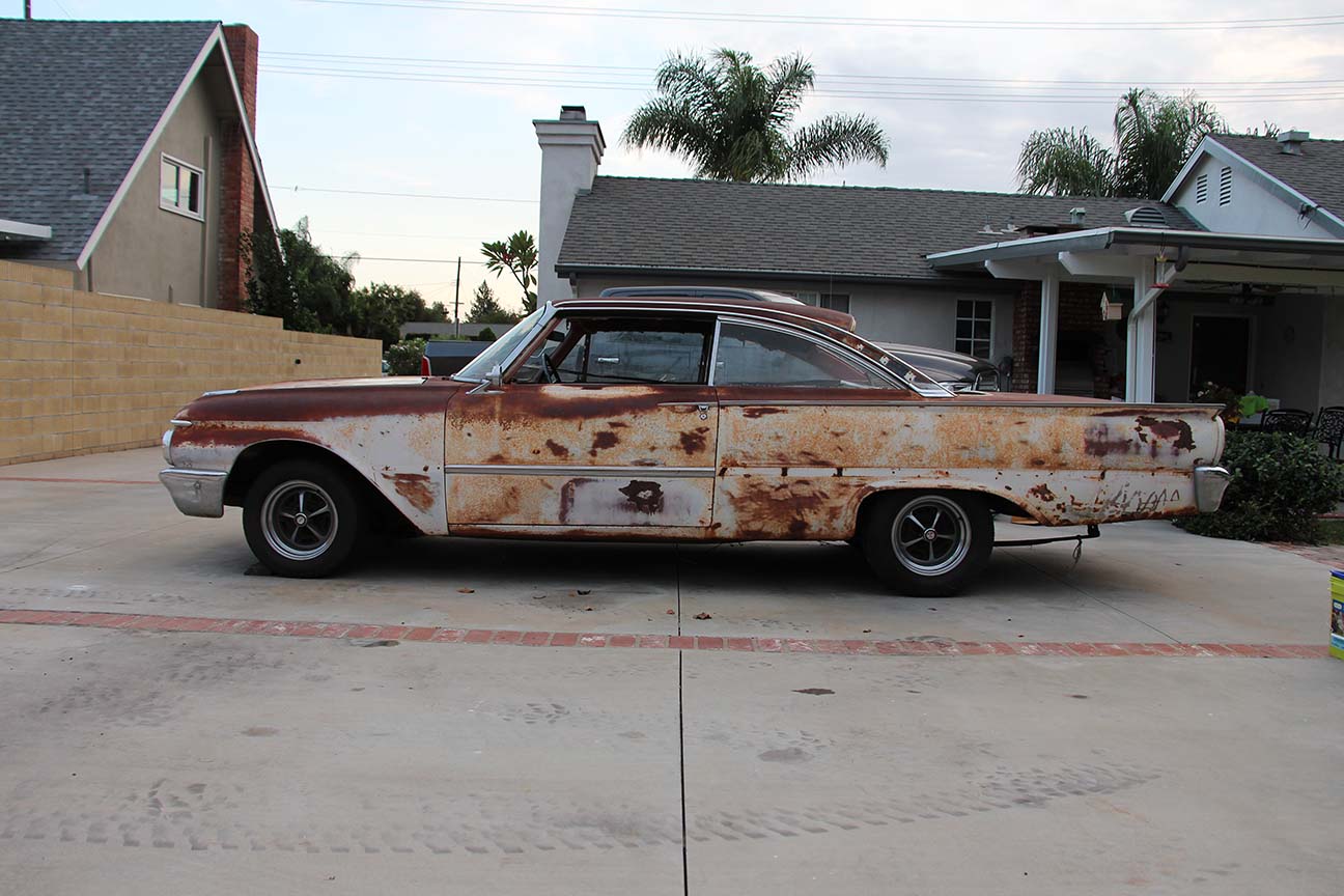

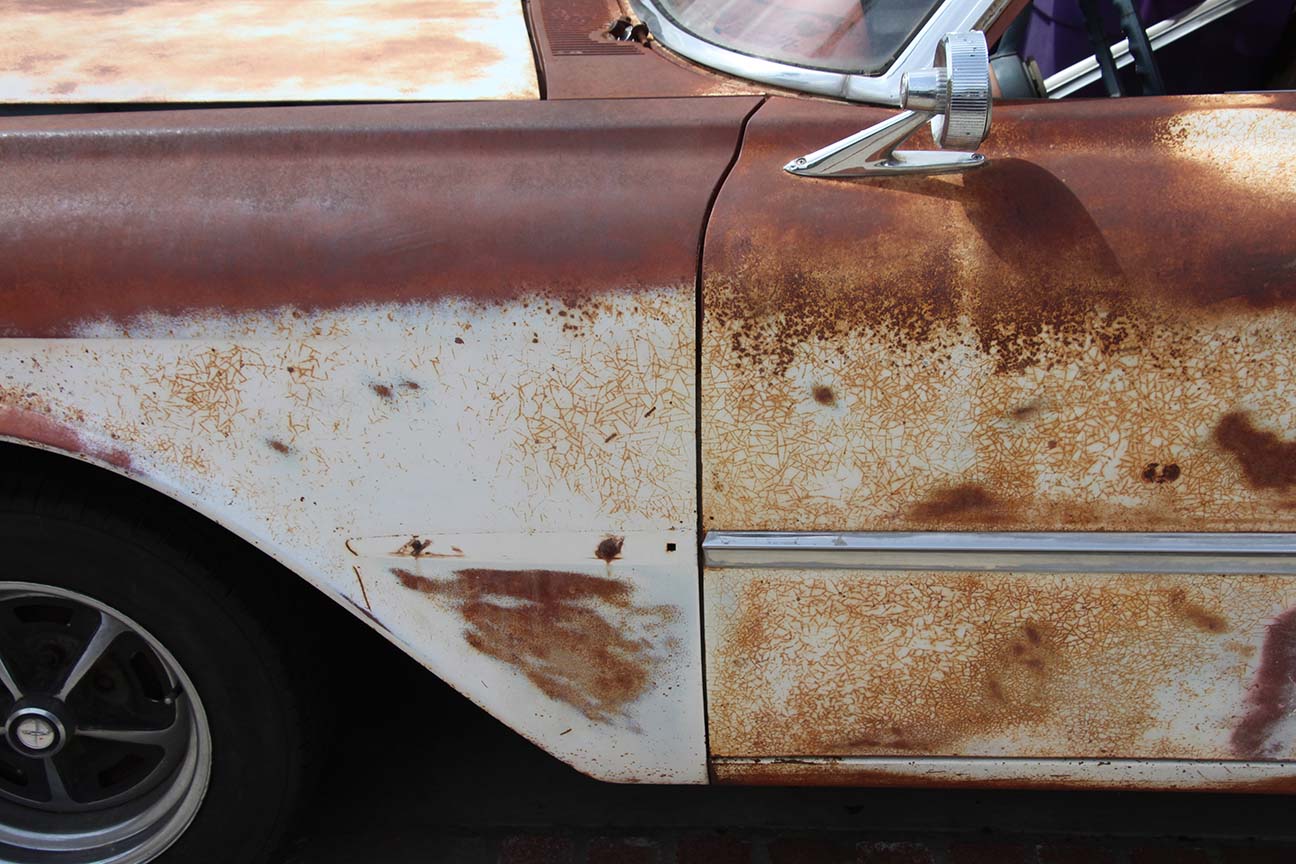

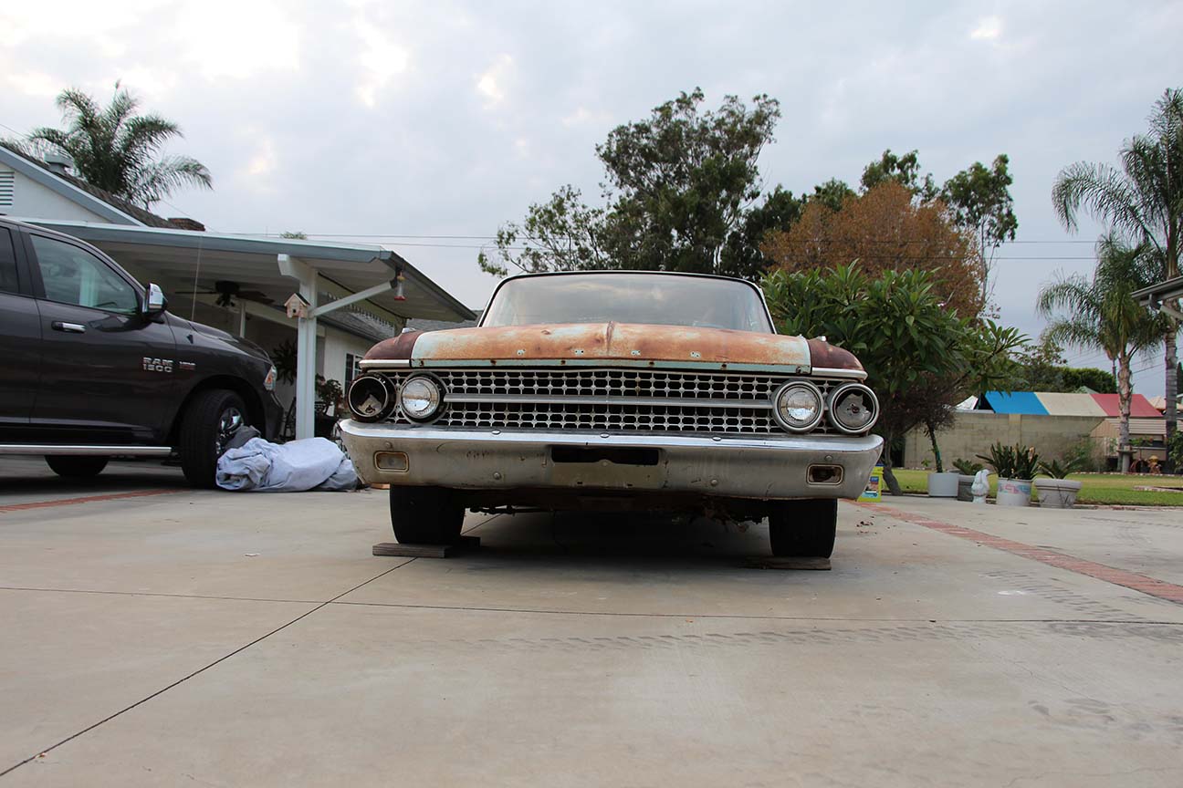

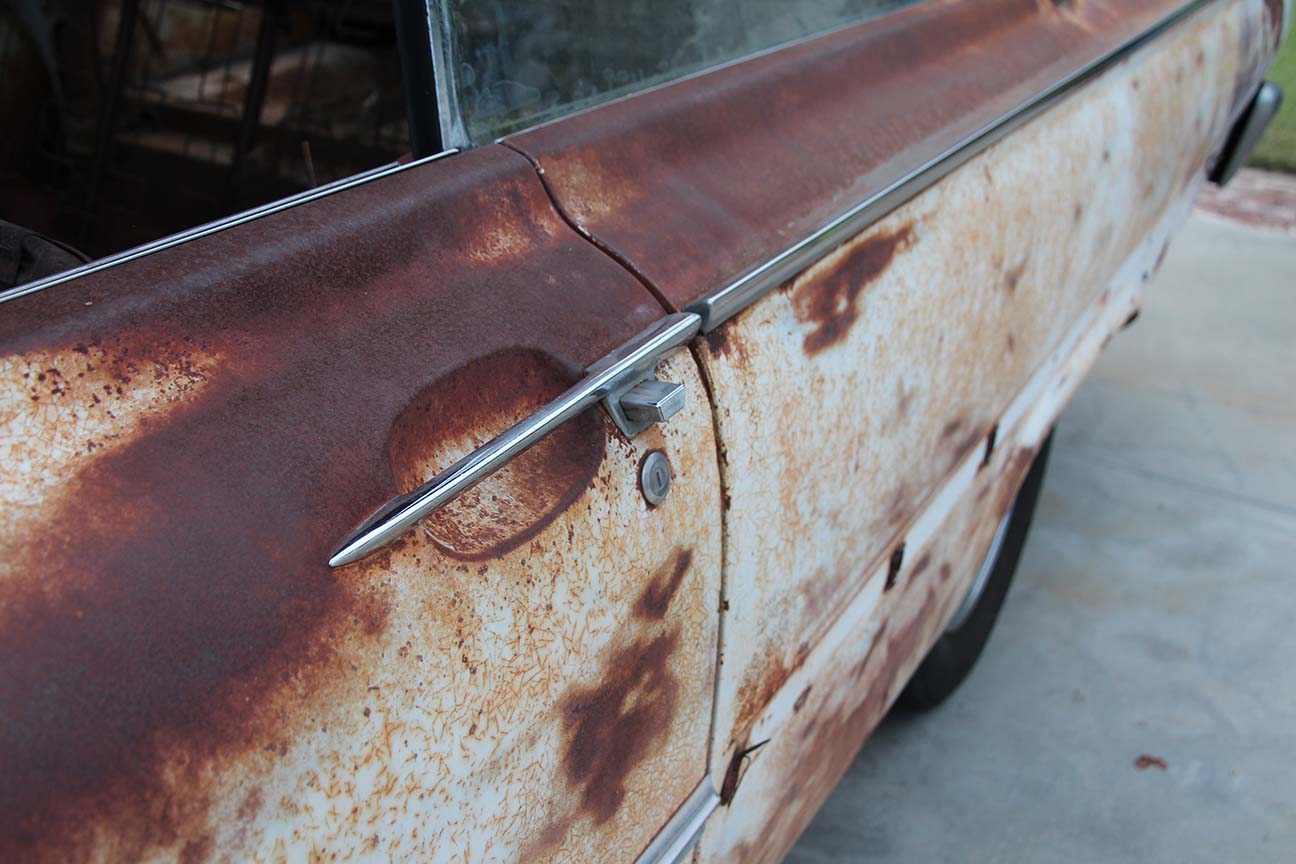

      [FONT=Calibri]Hello Gents! Im getting ready to start my Starliner project and thought I'd put up a build thread to show off the long road I have ahead of me. I've been scouring this forum and a few others and collecting as much knowledge as I can. I do appreciate everyone's helpful posts that i've tuned into and I hope that I can be a valuable resource to some as well at some point down the road.

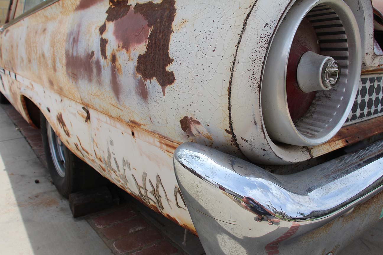

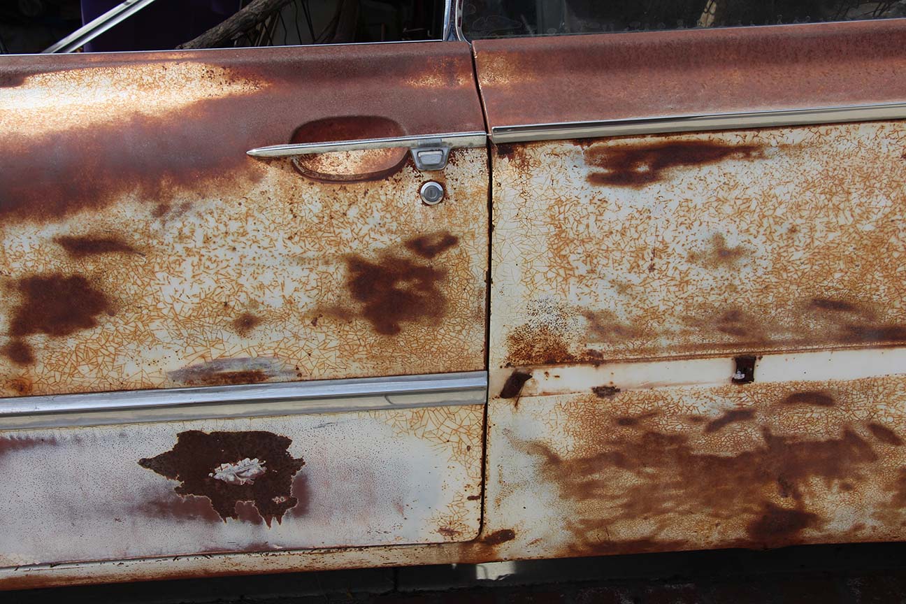

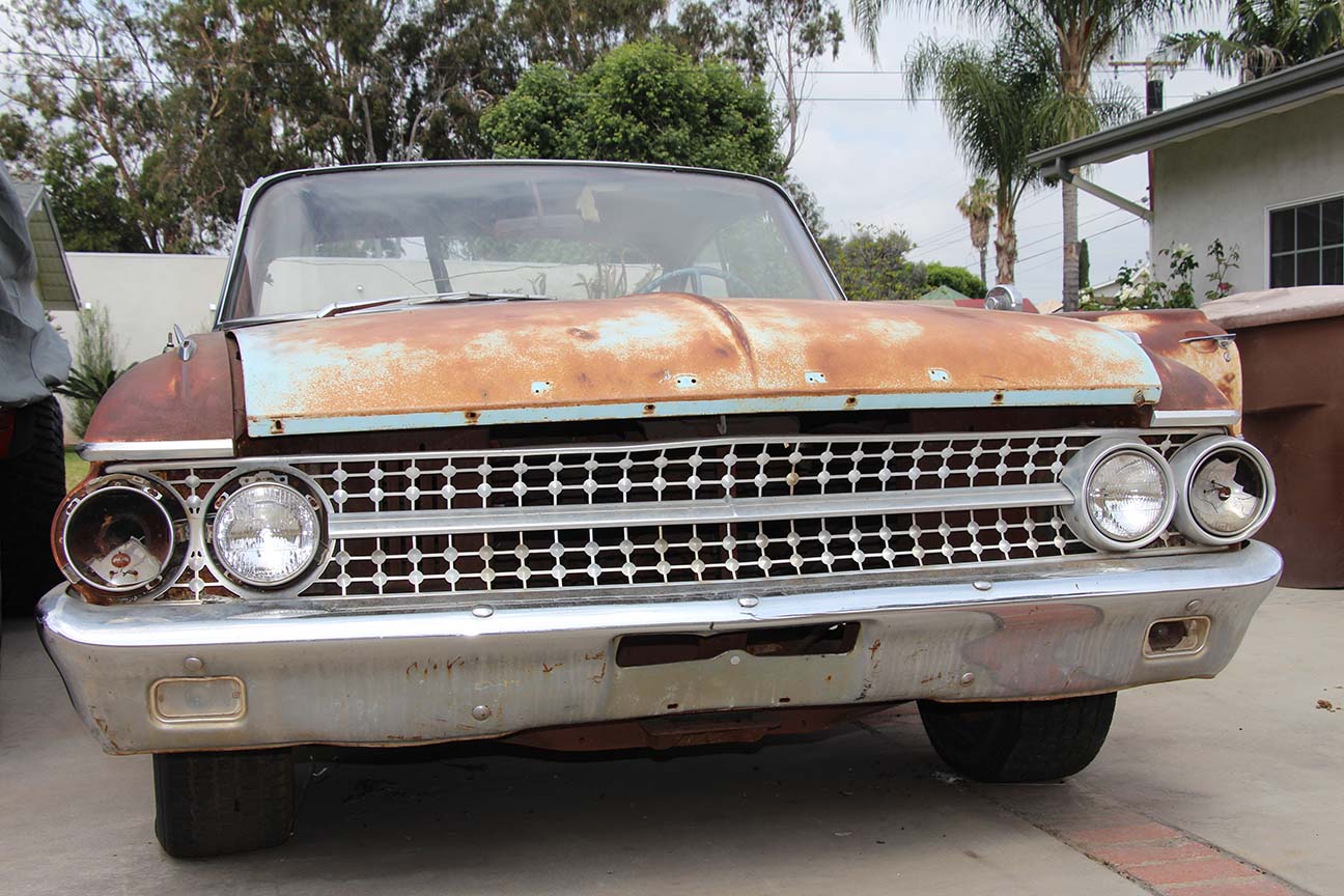

      This is my 1961 Ford Starliner that I picked up a few years ago. It was in a junkyard in Arkansas and I had it shipped out to CA. She's in pretty good shape and I think all of the stainless and trim pieces are intact and straight. She does have a few dents on the passenger side the front fender being the worst and then a small one on the quarter panel. Other than that all the door seems are perfect and straight. The only real big issue is the rust. So much rust. Suprisingly it even had the rear window. It was laying inside when it got dropped off. Thats an expensive piece of glass!
      My goals for her a pretty extensive. I have a 427 FE big block that I want to twin turbo. I dont want it to be radical but instead a very mild mannered car with a good idle and lots of torque. I think with the modest wide lobe seperation cam I should be able to acheive this and then the turbos will provide the extra air needed for around 800 hp. My thought is to run a tear drop style hood with twin throttle bodies on a factory 2x4 manifold (which I already have). Then run a thunderbolt style ram air but modify it to handle boost so at first glance it looks vintage but then you o oh theres twin turbos.
      So here's a bunch of pictures of the body.

      I've seen stuff from Arkansas before. I know nothing about you or your history. My suggestion is to do all the rust repair before you buy any other parts. If you find you're in to deep, your loss will be way less if you have to bail. No offense meant. I've seen plenty of projects fail because of the condition of the body. I have a history with fe's and 800 hp. on a stock block makes me nervous. Good luck with the car. Those starliners are really pretty.
      May 2017
      25
      Its a factory 427 block so Im sure it will do fine. Maybe a non-cross bolted main would be an issue but Im pretty confident this will handle it well. And in all reality i wont be exposing the engine to that much horsepower all the time
      As for the rust. Well ive spent some time working on hot rods and dealing with rust. This car is mostly effected in the floor pans and the body is pretty good so hopefully it wont be too much of a nightmare.

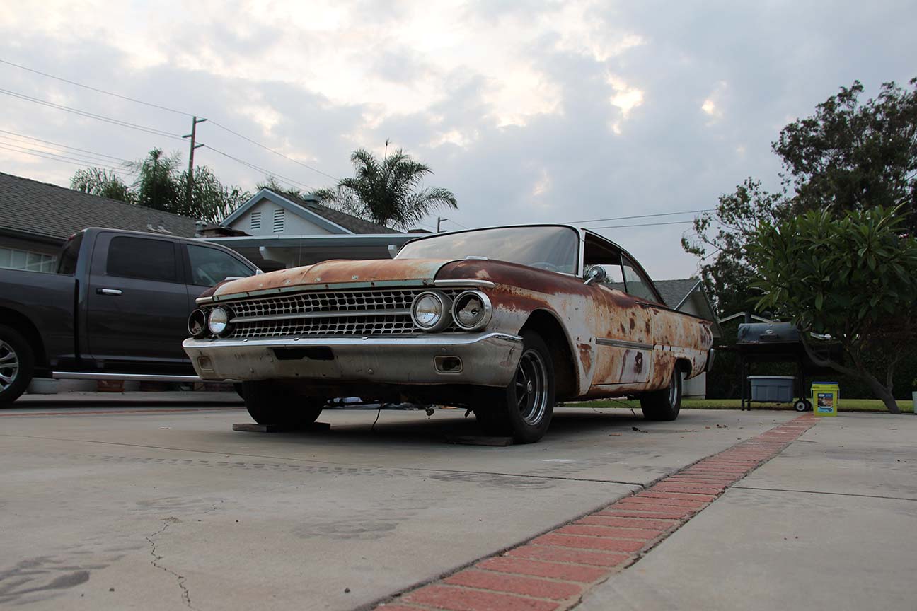

      ride height close and tires are underneath :)
      My real goal for yanking the suspension off right away was to see how the tires fit. I think they look really mean. The ride height is pretty close to what I want but I may kick the back up slightly more. The 10" wide falkens in the front are gonna be a problem for turning radius if I leave the frame where it is. Once I get the front suspension I will have to see how I can modify cleanly to make room. With this big of a car I will need a lot more turning radius if I want to race any of these local goodguys events. If I have to make a 3 point turn I think my times might not be so goode
