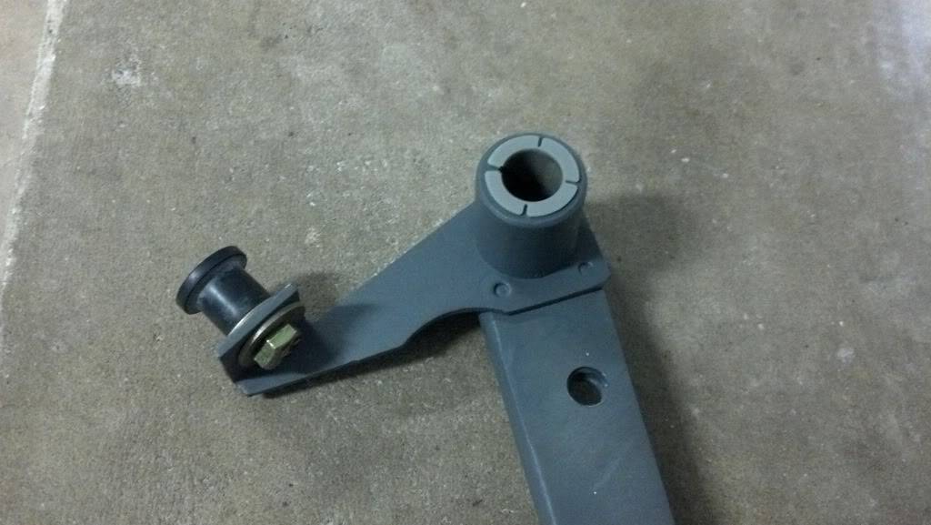

      Ok, so here is what we've got.... I think I've got it figured out, but I'm posting this to possibly help other if they run into a similar situation.
      Here is the removed pedal with the bumpstop I created with a well nut:
      The old style Ford switch:
      The new switch mounted at bumpstop location:
      I still have to put a nut and some washers on the threaded part of the switch and install some new electrical connectors, but you guys get the idea.... I will take some finished pics tomorrow after I go to the hardware store to get some nuts and washers lol.
      JC Scott

      Why do you have a pedal stop anyways? There should be a deep hole in that master and plenty of engagement on the pushrod that you would have to pull the pedal WAY up in order for it to fall out.
      Was I referring to a positive stop when I should have been referring to a return stop? lol
      The stop I have been referring to is the one on the pedal that keeps the MC pushrod from trying to pull out of the back of the MC when the pedal returns. It also keeps the pedal from making a loud metal on metal "ding" everytime I release the brake pedal....
      Let me know if my nomenclature is wrong...

      Nope, you got it right. Just didn't understand why you needed a return stop. usually with manual brakes the pushrod is in so deep the pedal would hit the dash or something else before it could disengage the piston. However I have seen applications where it can come apart there and those would certainly require some sort of a stop on the return side. 55 chevys had a rubber bumper up there that did the job quietly.
