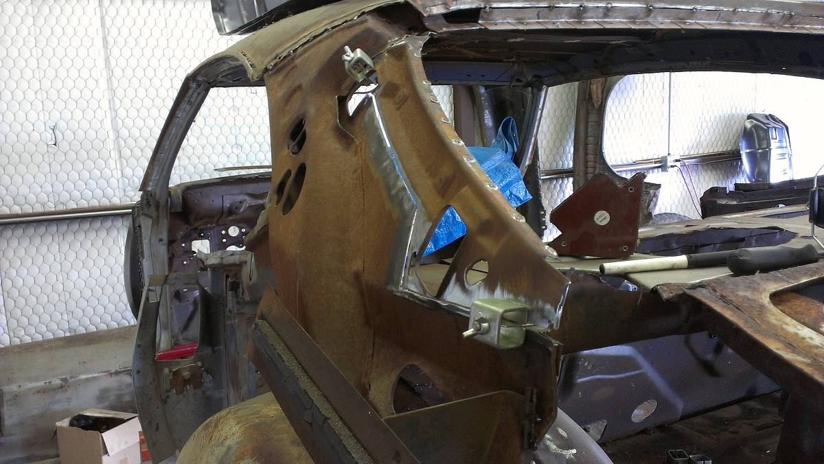

      Progress on the GTO
      I haven't posted in a while so I thought I would update the thread. Check out the pics and let me know what yall think.

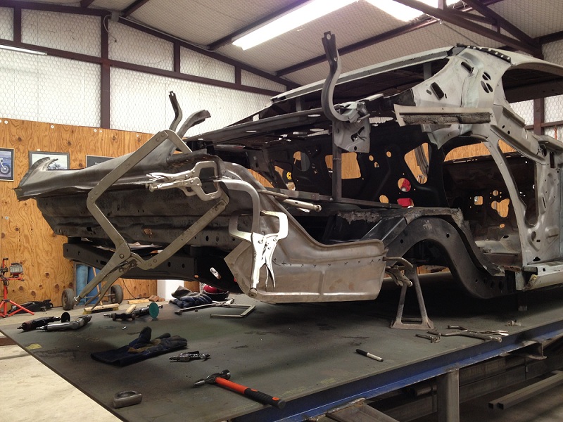

      I've repaired the right inner sail panel the best way possible. I cut the repair patch from a spare quarter I had here at the shop. After drilling all the spot welds to get the panel out of the spare quarter, I decided it would be best to cut a patch because of the work and damaged involved in removing the entire panel.
      I've also decided to reconstruct the repair I started on the rear section of the roof so I order a shrinker/stretcher in order to make a more acceptable patch.

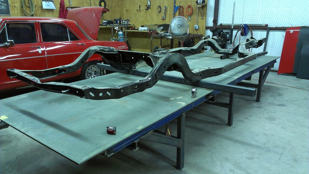

      -The body is on the frame which is attached to jig I built. I had to do this so that the geometry of the wasn't effected while all the structural rust was cut out.
      -A sandblaster has been contacted and a date has been set for late November. I can't wait to see what the car looks like in bare metal!

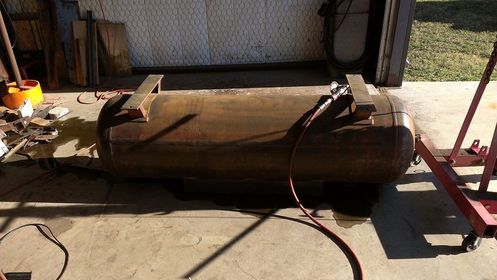

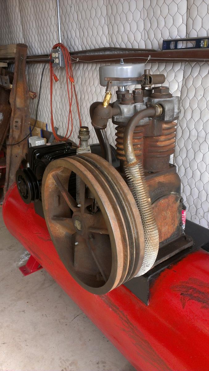

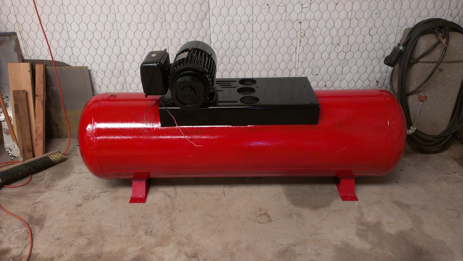

      1942 Curtis Compressor
      Not much progress on the car, but I did rebuild a 1942 Curtis 95A air compressor. The cylinder jug was sleeved, new rings, rebuilt head, re wired, etc. Just needs some more paint, but it works great.

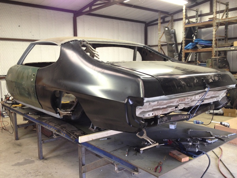

      All the inner structure was sandblasted and sealed with primer before intalling the panels. Also, I did have the car mini tubbed at one point, but decided that my work wasn't par. I ordered all new inner and outer fender wells and I will stretch the new inners.
      The door gaps are OK, but this was as close as I could get them. The passenger side gap is a bit wider at the top. The frame and rockers show damage as if the car was high centered pretty hard at some point in it's life. I'm thinking that this probably has something to do with it.
      Any input/comments is greatly appreciated. Thanks!

      are you making the adjustments with the strikers on the car. i find it easier to have them out. looks like the top hinge needs to go up and in alittle to close that gap and bottom up and out alittle. Just did my car and spent ALOT of time, good luck

      66, The strikers were removed. It took days to get them to look this good. I still think that since I am having the issue on both sides; that it is related to the car being high centered or panel quality. I'm sure with some work, new door hinges, and door alignment I should be able to fine tune the gaps.

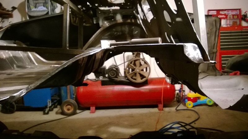

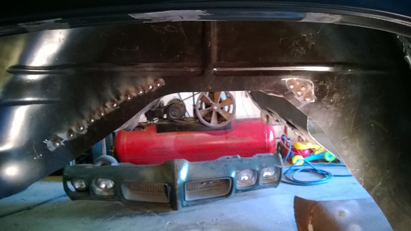

      Well since the last post I have bought a home, ended the lease on the shop, and moved the car into the garage. Space is limited.
      The outer rear fender wells were installed and the car was blasted. Rework began on the inner rear wheel wells once I got the car back.
      The Mini tubs are being redone, well, because I thought I could do better. Passenger side is near 90% complete. Here's some pictures (cell pics, sorry guys I'm not much on photography).
      Trunk and floor braces were capped so I could plug weld the inner well.

      They look much better than before, just need a few touch ups, then some mud and a coat of bed liner. I'll post pictures with a view from the trunk once both sides are complete.
