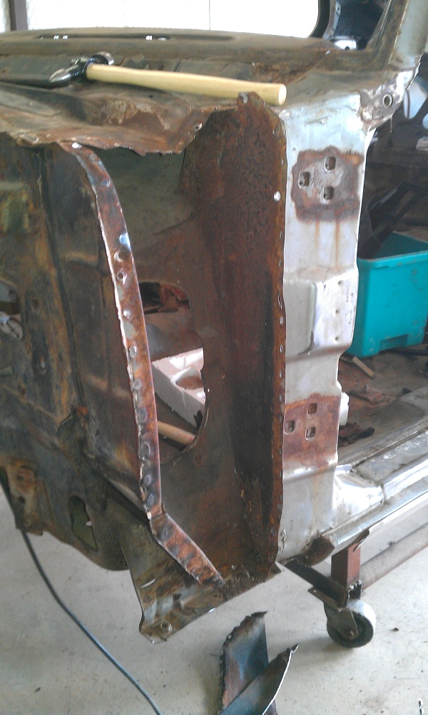

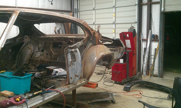

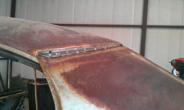

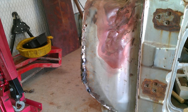

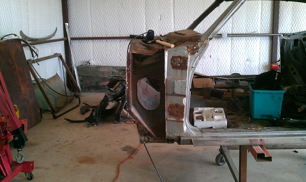

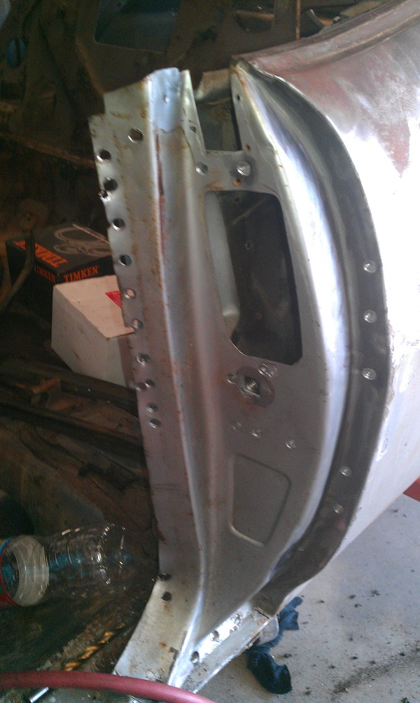

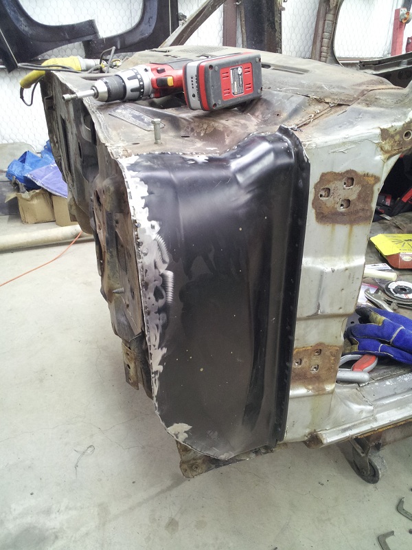

      First fix was the driver's side cowl. The car took a hit on the nose, the nose and fender were replaced and I didn't find this little surprise until the tear down.

      I really wish I would have drilled some holes and plug welded the patch on, but it's on.

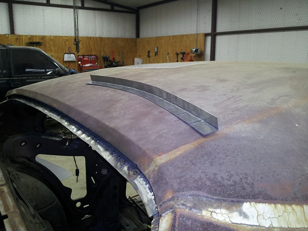

      Some more pics!

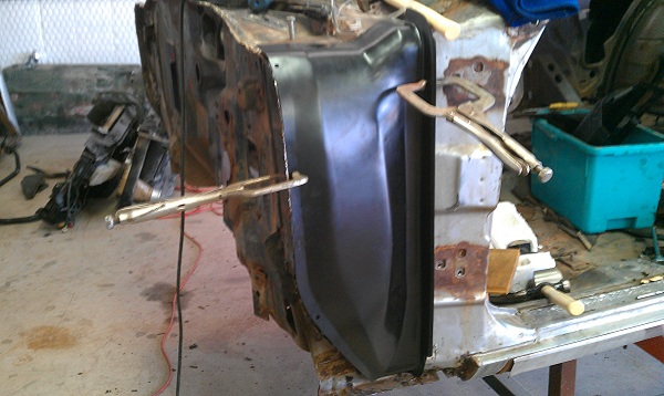

      I got the driver's side inner wheel tub out tonight, tomorrow I should have it back plus two inches!! I'll post up some more pics of the mini tub soon!

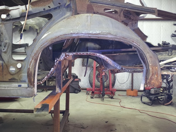

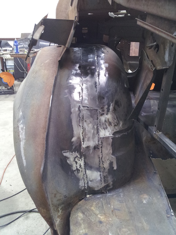

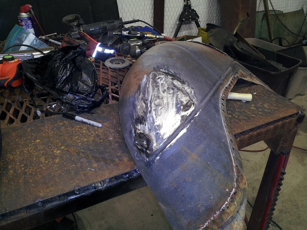

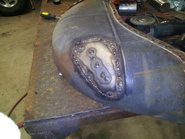

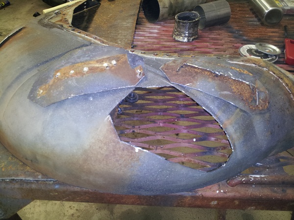

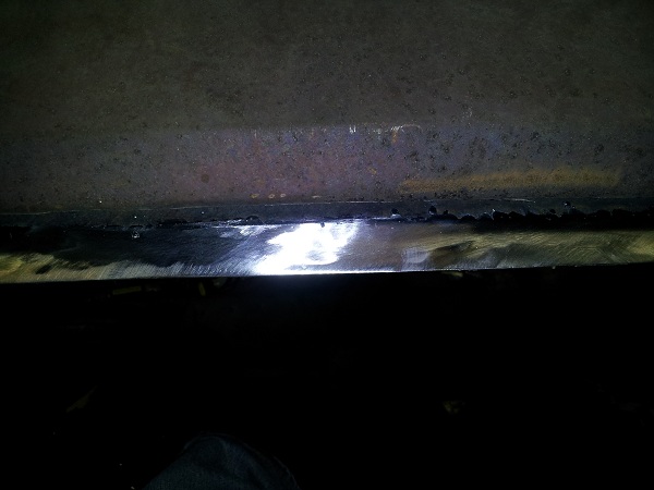

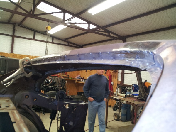

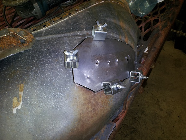

      Well I got into the driver's side wheel tub a few days ago and tonight I had a chance to get up to the shop and do a little work. I patched a rusted area where the trunk hinge support was spot welded to the inner tub. Then, I trimmed the lower portion of the inner tub to match the floor and the rear seat support to match the tub.
      Here's a few pics... The tub isn't setting exactly how I imagined, so if any has had experience with tubbing an A body, please chime in.

      I used masking tape as a guide to to the cut with a die grinder. I decided to make a straight cut instead of trying to follow along the seam where the inner and outer wheelhouses meet.

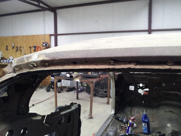

      Update on tub, trunk floor
      Hey guys,
      Just wanted to post an update on the tubs and trunk floor. I've still got some more grinding and sanding to do, but the left tub is done. Also, I started working on the trunk floor... should get the left side and center section stitched up within the next few days. Let me know what ya think!

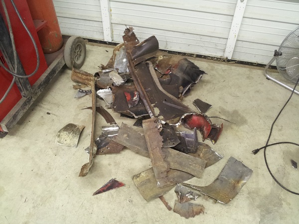

      A pic of some of the cancer that has been cut out... not even close to amount that has been removed in total.
