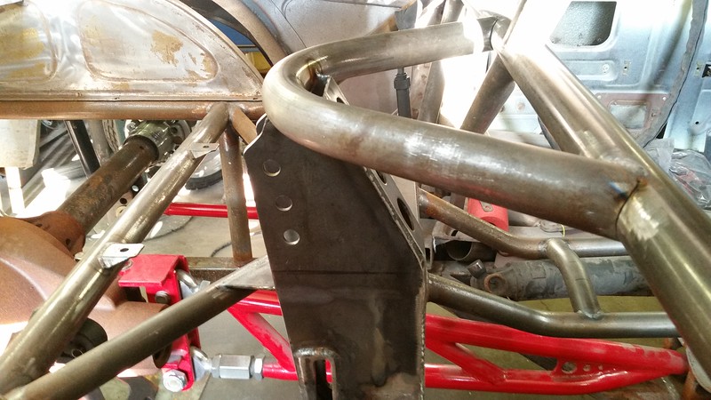

      I think it was a little of both. I have taken some time to fine tune on the car which made it light years better then it was. I do think the truck arm design has a tendency to push, due to the way the arms drive the power from the center of the car. Most other designs, leaf springs, 4 link, 3 link, even my torque arm on this AMC drive the car from just in front of the rear tires. The torque arm power pulls up and down on the center, but it drives from the links just in front of the rear tires. I guess we will see how it works out, if I ever get a chance to work on this car again.

      Mine has massive adjustability. Found that the Nascar stuff is designed with the panhard bar way below the rear axle centerline, which is great for 200mph high banks of Daytona. Not so great for short track road courses, and autocrosses. What I found was that those mounts actually had to be cut off the truck arms and frame and moved up a bit to get the car to work right. Car seemed to like just slightly below axle centerline which was not obtainable with the used Nascar stuff I had. Once I got the adjustments close the car behaved much, much better.

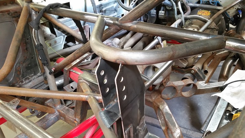

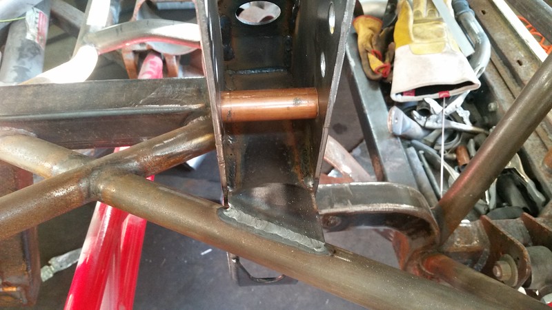

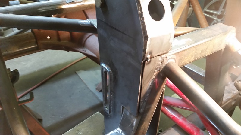

    20. #920
      Maryland
      1,863

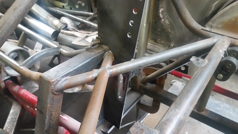

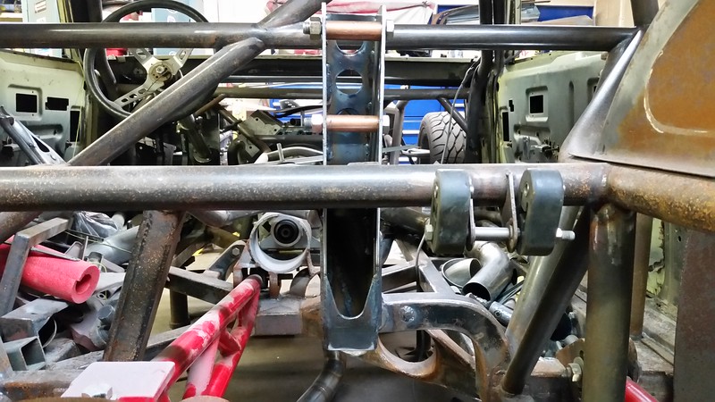

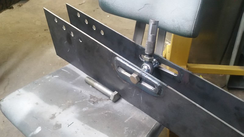

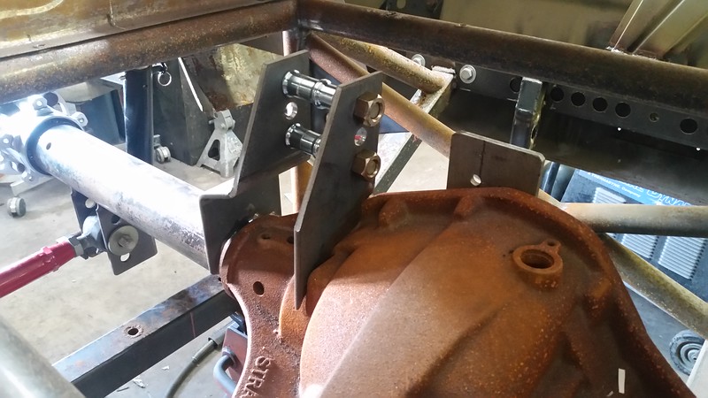

      After a couple of year hiatus, I'm finally getting back on this car. Working with Ron Sutton on a different suspension design, the torque arm I designed in the car he feels would be great for autocross, but not so great on the road course. He designed a decoupled 3 link for the rear, which I have just begun to fabricate. Trying to fit these mounts in my already busy chassis was a lot more difficult then I thought. Funny I ended up not having to move one bar, at least not so far.
      I will leave the torque arm mounts in place and try both designs to see the difference. Hoping to stay the course and get this thing done.
