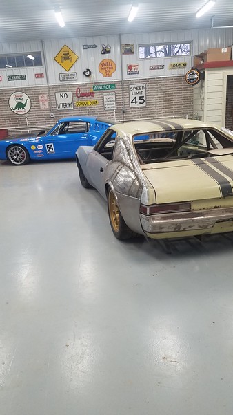

      Nice Ron, like the shop too!

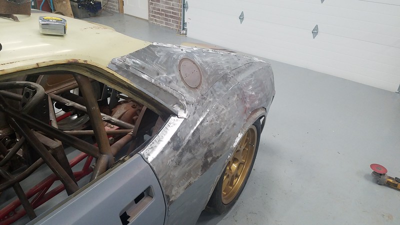

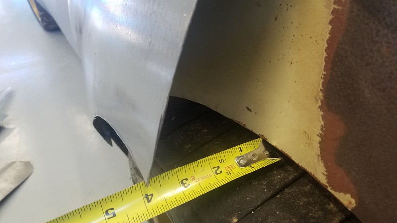

      Started making parts in steel, still need a few tweaks, and the lowers fabbed, but its pretty close. The original quarter panel is still in place, you can see with the tape measure how much wider its getting.

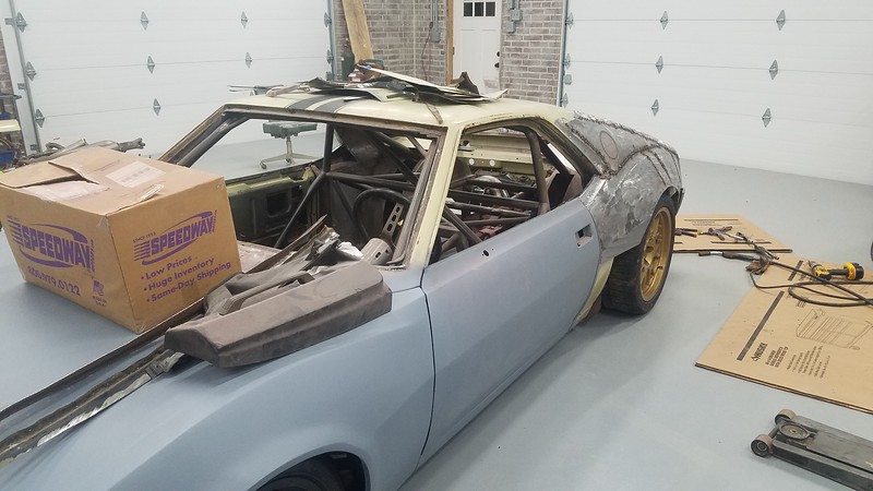

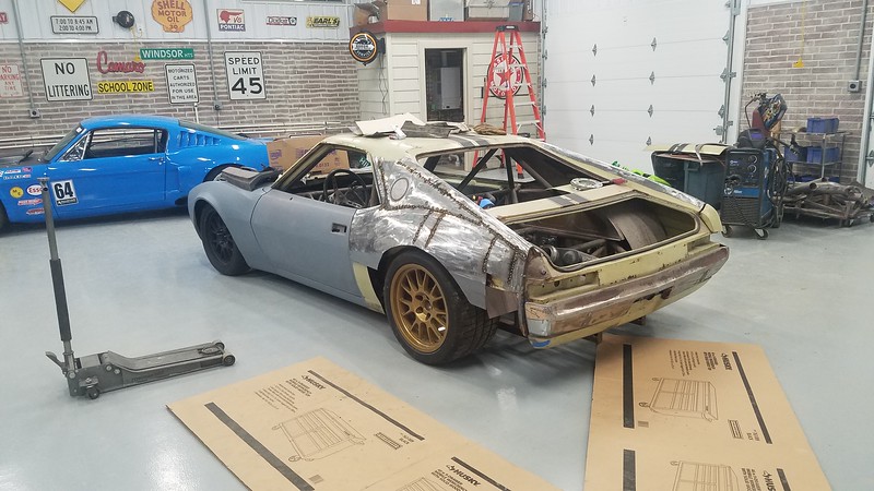

      Starting to get it tacked together, I think its turning out pretty well.

      I have to be honest, I never cared for the sharp body line in the back of the first generation AMXs, but with your changes, it looks amazing.
      Jun 2017
      Edgewater Co.
      150
      Just a thought, I've always thought the AMX had an odd shape to the rear, the trailing edge of the b pillar has a convex shape, I was thinking concave shape in about the same radius would "lighten" up the rear. Not trying to make more work for you, just my 2 cents (for what it's worth)...
      BTW, the new shop rocks.
      Joe
      Maryland
      1,863
      They were always an awkward looking car. Kind of geared toward drag racing like everything in the 60s. It was just a cut down Javelin, funny while dismantling a couple of these cars you can see where AMC cut the original Javelin chassis and floor and welded them back together. Everyone I've seen looks the same.....like someone stick welded it with the lights off.
      I wanted to see with build if I could take a car that was almost a good looking car, do some plastic surgery and actually make a very attractive sled. I'm happy so far, but only time will tell.

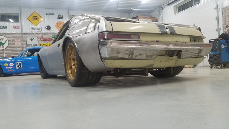

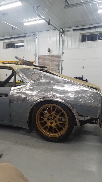

      Ron, can you show how you're doing the "lip" around the tire on the rear quarter? And what you used? Stock AMX or something else?
      SMSgt Ty Ingle, USAF
      "CF71" - Freedom Bird
      Maryland
      1,863
      The wheel lip is a factory part, but not from an AMX. Honestly I can't remember what its off of. A buddy owns a body shop, I dig through his crap sometimes to find parts. It still needs to be reshaped/lengthened/narrowed before it get welded on.

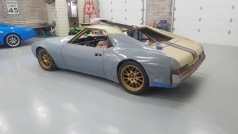

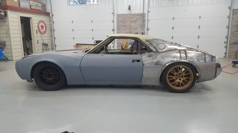

      AMC guy here, so maybe some bias. That said I like how you've integrated the later Javelin wheel openings into an early 2-seat AMX, your design and execution are fantastic.

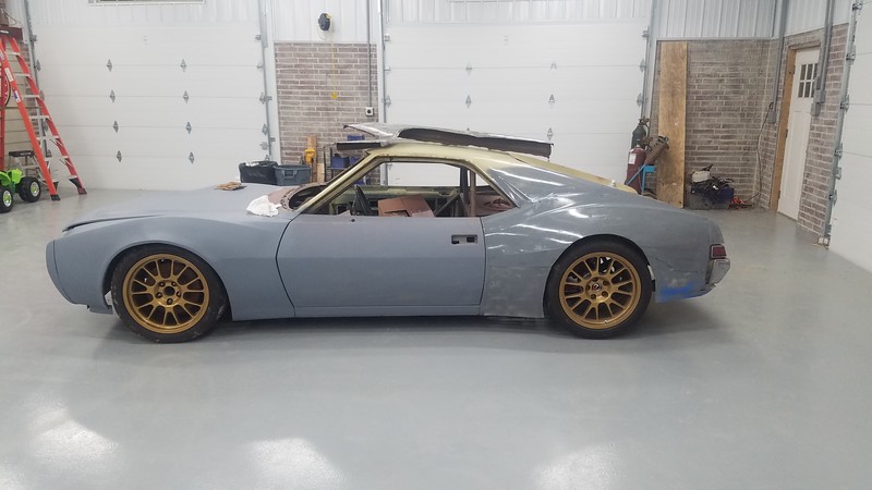

      Slowly getting it done

      Man, this looks so good. And I'm not really a fan of the AMX stock.

      I really like this build. There are extensive modifications that look very natural with the factory lines. I love the wide fenders.
