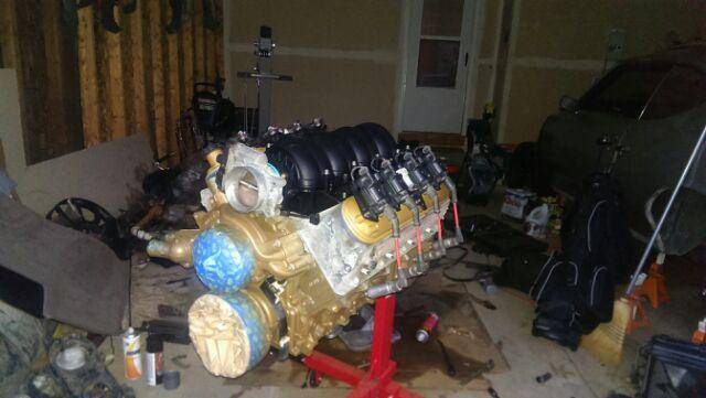

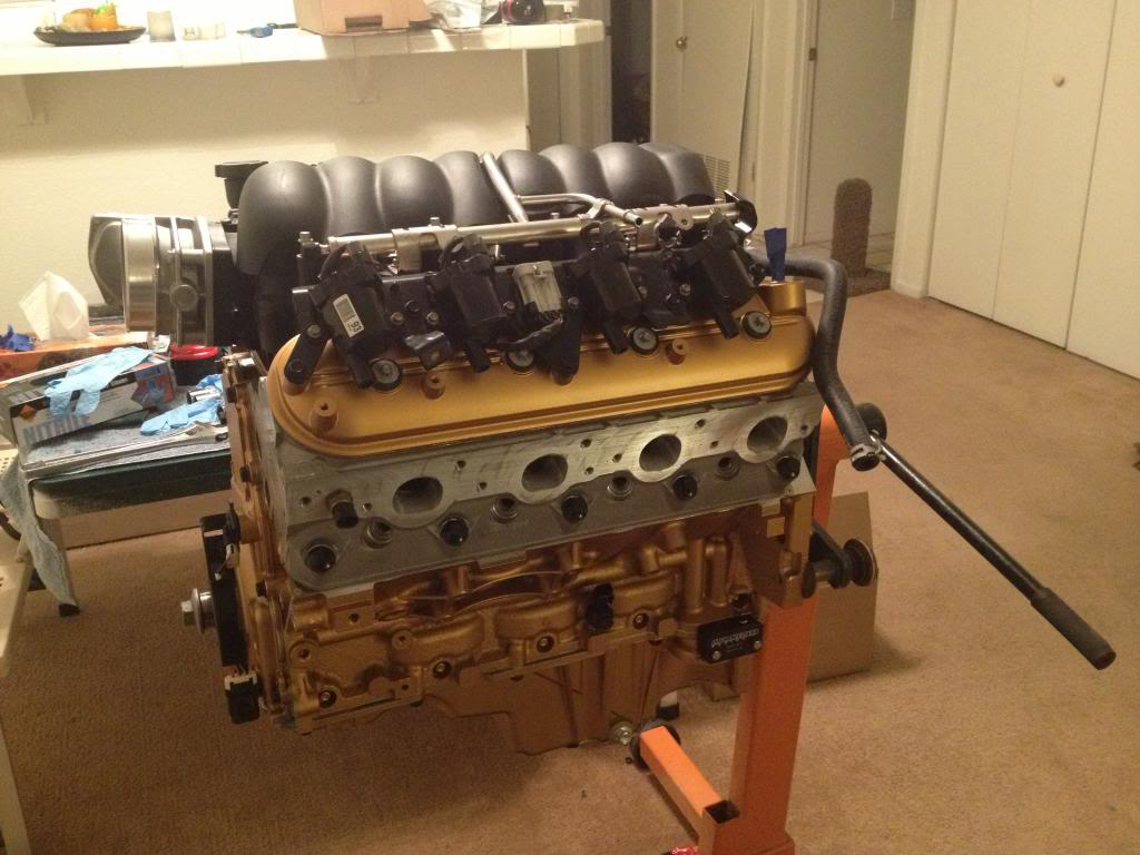

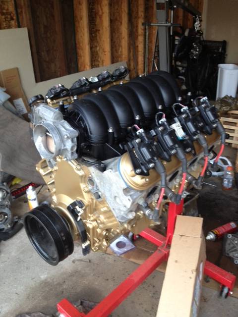

      After seeing a member on Classic Olds using a different paint with better results, I decided to follow his lead. He used Duplicolor gold, here is the motor as it sits today.
      I'm sure you can see the difference in the 2 Gold's
      Inline Tube gold
      Duplicolor Gold. Now the valve covers match the block
      I should be putting it in next weekend. I'm waiting on my shifter since I want to install the motor and trans together. I'm anticipating it will arrive early next week. I'll wait until the weekend, so I can make it an all day affair vs. cramming it into an evening after work.

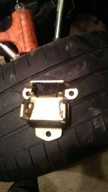

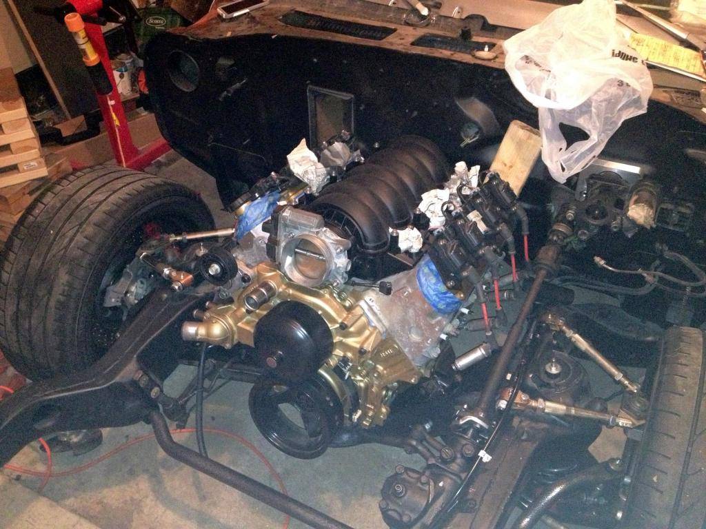

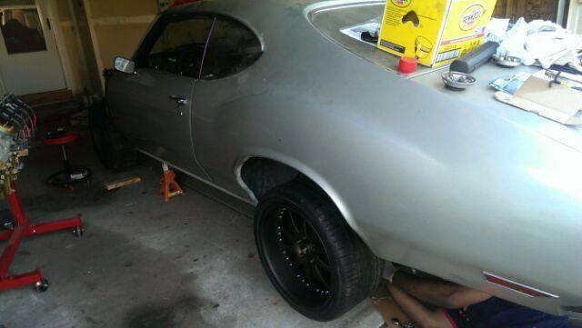

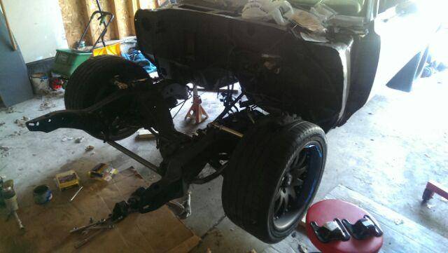

      Well due to some conversion hiccups, I only got one thing done yesterday.
      My friend came by and we got setup to remove the Olds frame mounts and install the Chevy ones. This whole process was a PITA! I'm sure it can be much easier without the suspension installed, but there is no easy way to access these bolts. We got the Olds frame mount off only to find out NPD sold me 2 RH frame mounts! The only thing good about this they are only 15min from my house.
      Setting up on jack stands to get ready for install
      Installed the new frame mounts in a location most others used, all bolt holes used with slight overhang. I used the Dirty Dingo Double D adapter plates with the motor mounts in the normal position. On test fit the oil pan was tight angainst the crossmember and there way to use the setting. I pulled the motor and trans back out and we moved the frame mounts back in the crossmember. I moved the motor mounts up the 3/4" fwd position and it was perfect.

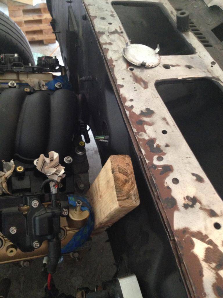

      What I found out next is that while my friend was able to get his motor mounted bolted, I could not get my holes to line up. After zero success shift and prying, I pulled the motor back out. Looking closer, I see Energy Suspension needs better quality control.
      The weld was so sloppy, I could not get the mount to sit flush. NPD was closed and we were in too deep buy now, so my frined just grinded down the welds. I hate have to do that to new parts, but I wanted the motor in.

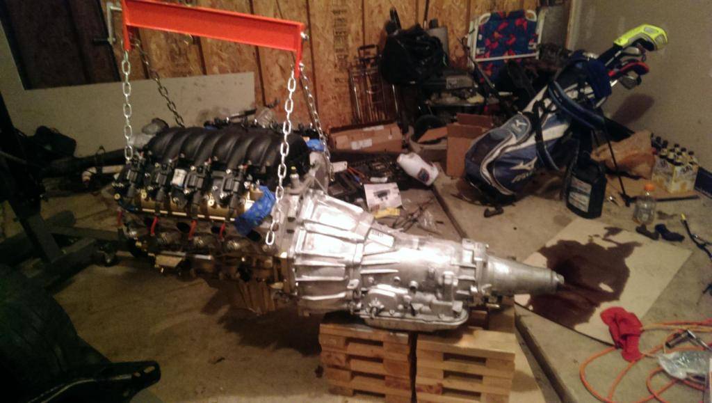

      After a long night the motor was finally in, minus the trans. I did end up with ample oil pan and firewall clearance after all the adjustments.
      Placed a wood block between the head and the firewall to allow the motor to rest.
      All done and back on the ground....

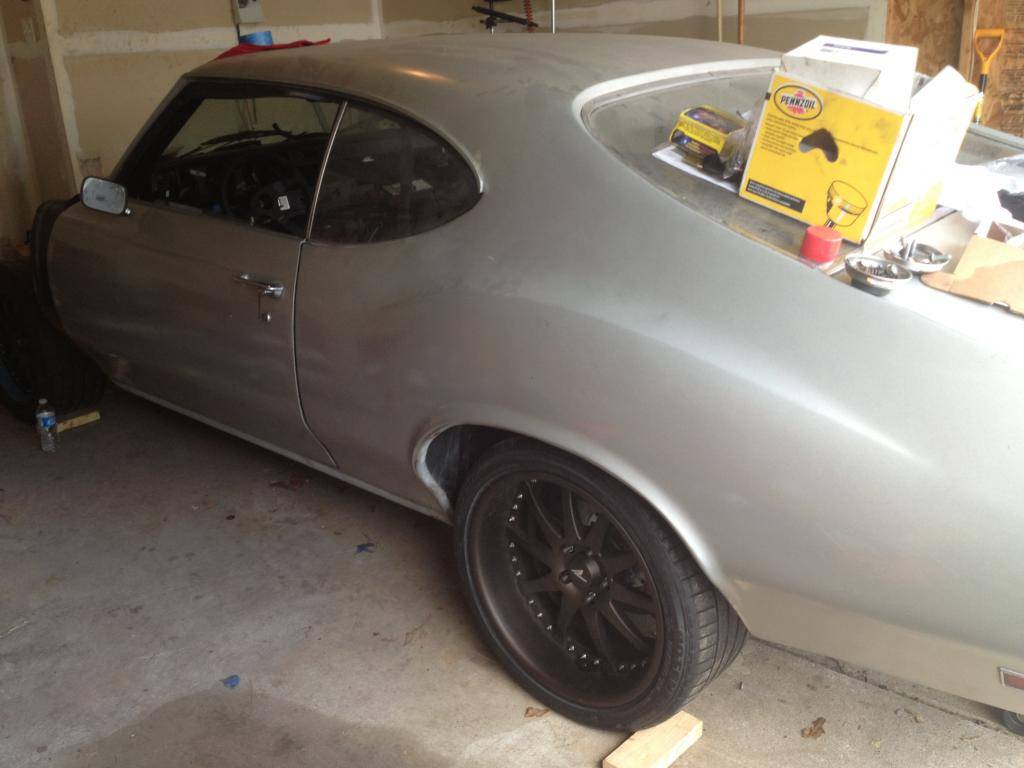

      Quote Originally Posted by 70OldsSportsCoupe View Post
      I'm disappointed that you weren't able to keep Olds power, but it's hard to deny the cost-effectiveness of the LSx. I imagine I would go the same route if I didn't have an Olds powerplant on hand. I like the silver - that's what color my '70 was originally, but it was pretty much all surface rust when the previous owner got it, and he went with black. Unfortunately, he used Car Painters (think slightly better than Maaco) and the paint didn't last more than a couple years. It's various shades of primer now .:(
      I am too, but it would not have been cost effective to build another 455. I have no doubt I'll be happy with the LS2, just wish the swap would have come after selling the 455...lol
      The silver on this car isn't original, although I'm considering it in a respray. Several choices are running through my mind, I'll decide when the funds are there.
