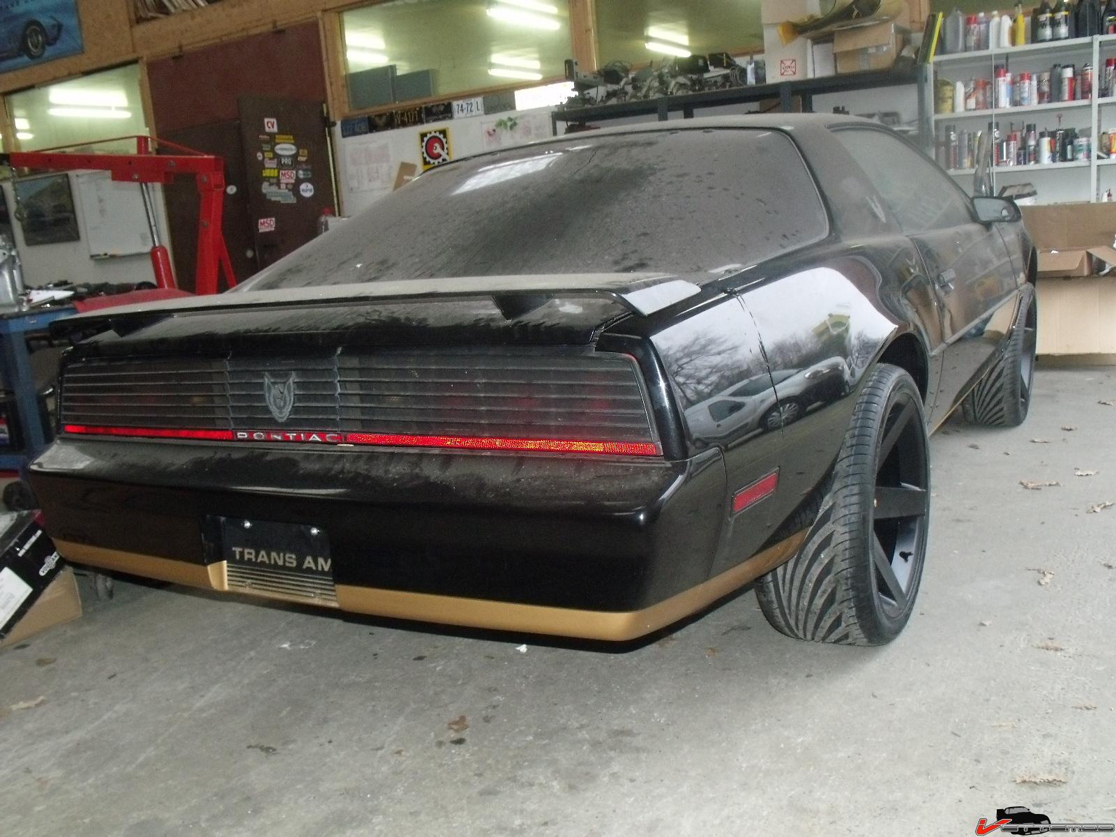

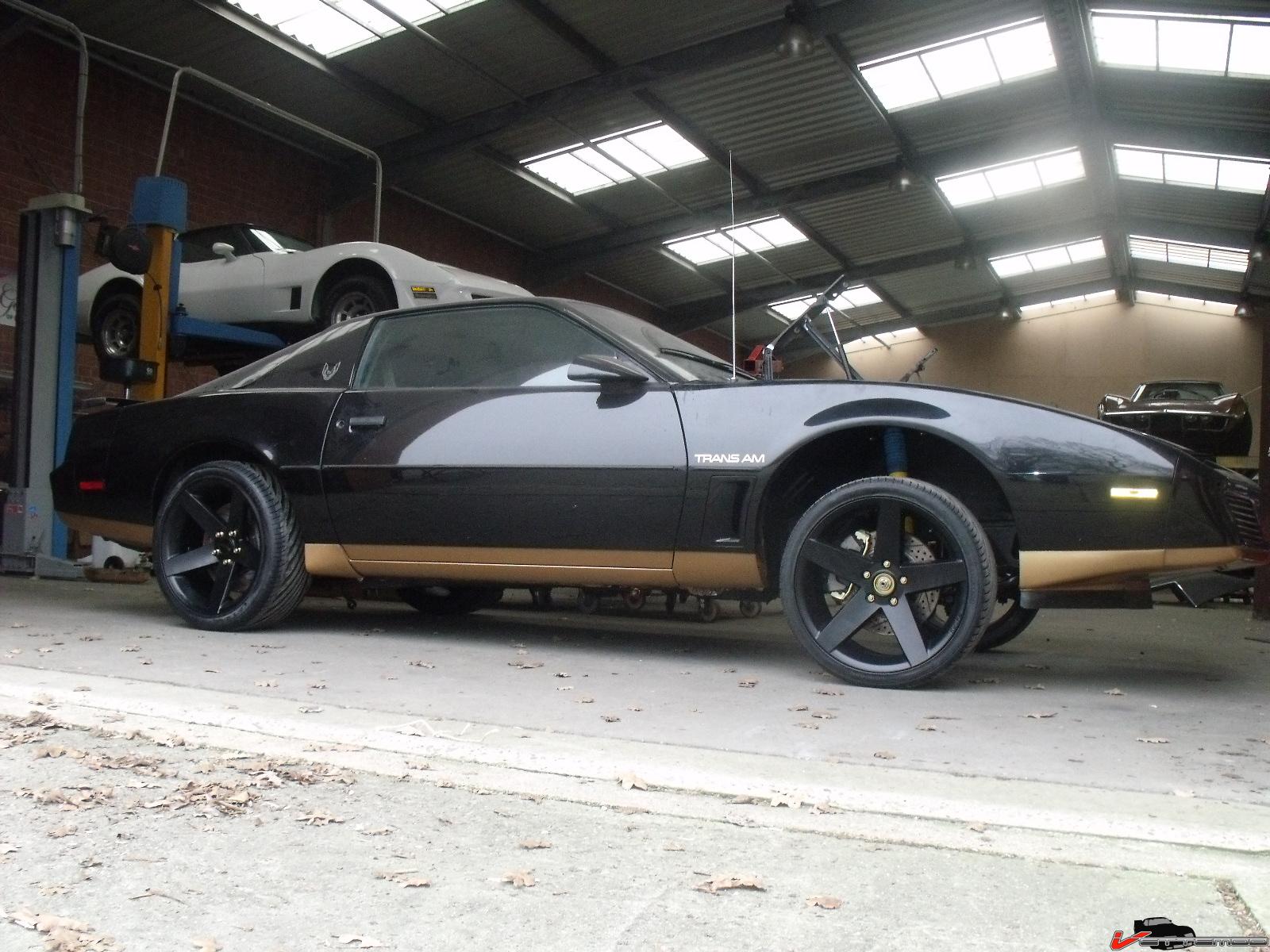

      Major problem here...the wheels don't fit with my C5 brakes :( bolts that hold the 3 pieces together hit the caliper and I'd need a serious spacer to clear. Not going to do that. I ahve 2 options, swap to 1LE hubs w/ C4 Corvette J55 (13") rotors and use a set of baer PBR calipers (I have a spare set and a set of grand sport corvette calipers) but I'd like to retain the eradispeed plus rotors and C5 calipers so that means new wheels.
      I just bought a set of deep concave wheels for my camaro and shopped the same wheels under the TA and changed the color to gold. The Camaro has matte black wheels, these are shopped off a set of silver ones (internet pic)
      What do you say?? Mind you, I absolutely have to have gold wheels LOL

      MHO; I would like to see it with a little more tire and just a bit of dish. As pictured it's looking a little too much "Donk" for my taste.
    9. #49
      Dunwoody, GA
      4,983
      It doesn't look bad but I think you could go with a better design. Sorry your original plan didn't work out.

      Keep in mind, I photoshopped the wheels and they came from a bimmer pic. Those bimmer guys love their rubber band tires, I hate those. I may have the scale off, I have 19s for the camaro and will do a test fit on the TA when I get them next week or so. They are matte black, maybe that's a neat look too. I like the jongbloed wheels better too so I may just swap the brakes for the 13" baer track kit I have lying around. Same as on my Camaro. With those the jongbloed wheels DO fit. Like I posted on pg1:

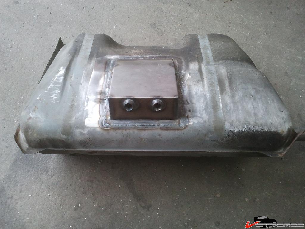

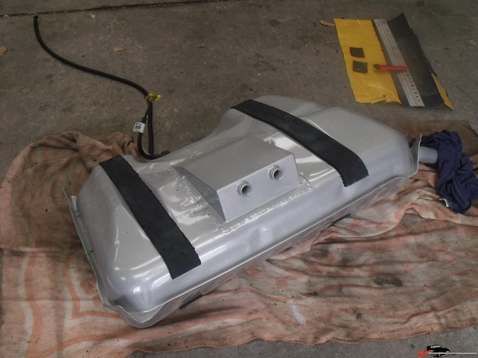

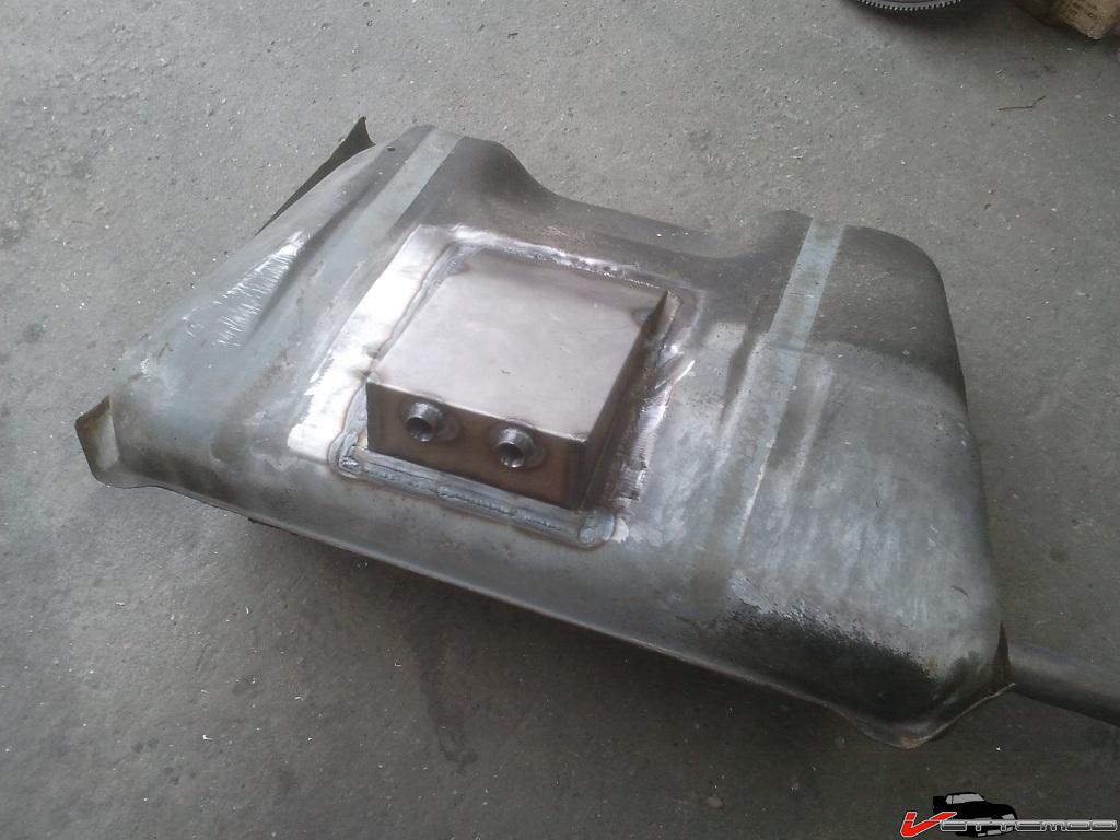

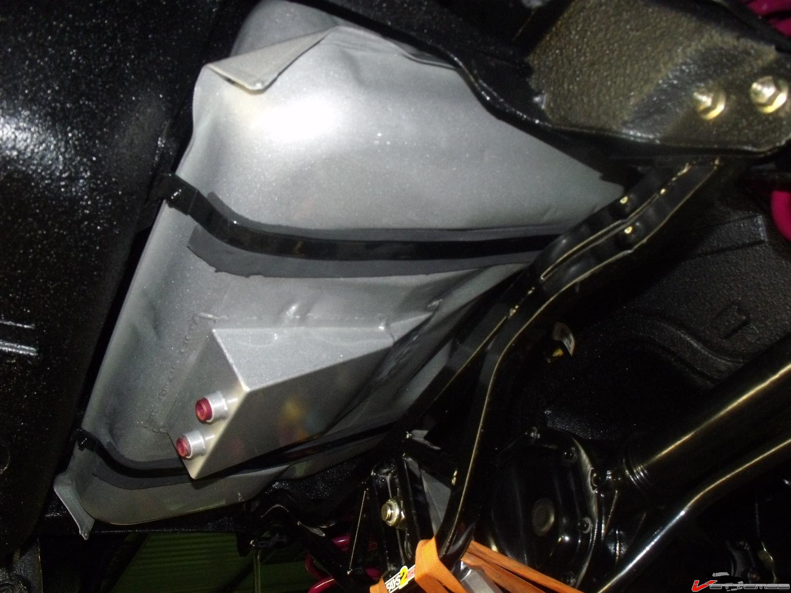

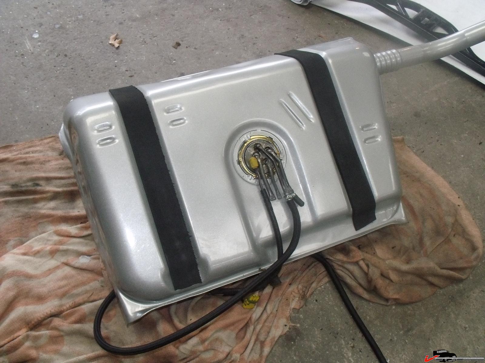

      Decided to get another tank so I could weld in a sump, would be a shame to cut up the already powdercoated one. This one, being from a TPI car has an internal plastic baffle that caught fire when I welded the tank. Took some grief getting it out completely since one can't reach in there with a hand to pull it out.
      Had to mod the sump to angle the back side so it would fit the tank
      Tomorrow it's off to the powdercoater.

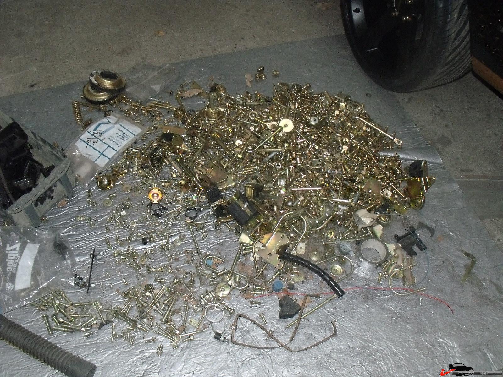

      Hopefully I'll have my Fays2 watts linkage tomorrow too. Then I will send the bolts that come with it (zinc plated blue) to the platers (so they will be gold too) along with a bunch of other misc bolts and hardware that I had left. Some of it was hardware from new parts like J&M strut mounts. Should be the last batch. Also got my Vogtland dropsprings in.

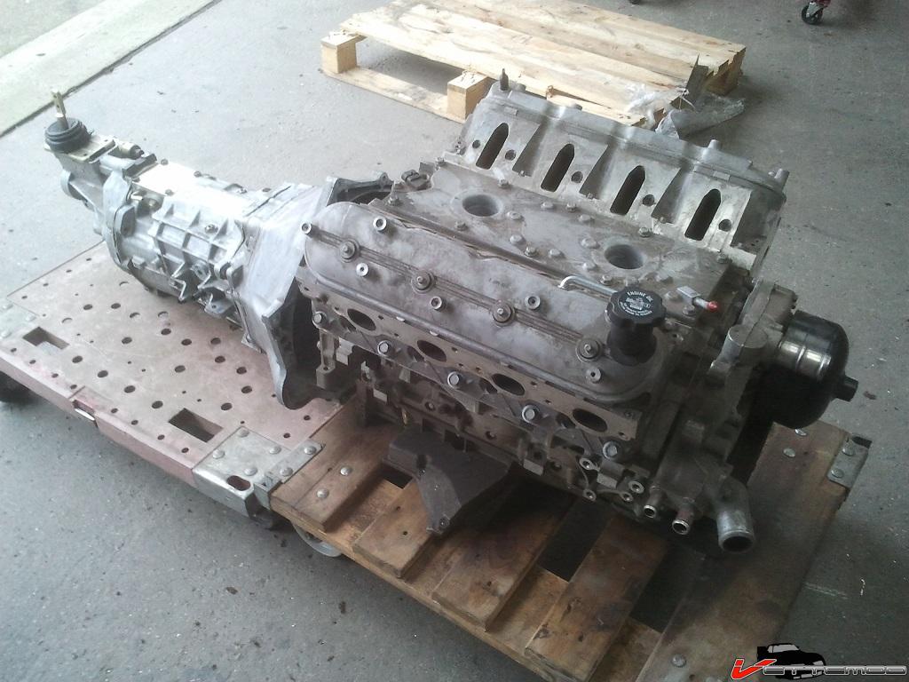

      Also got my LS T56 in, swapped it with a guy in the UK who needed an LT unit. Along with my mockup LS I'll be able to get a good bit of stuff done soon

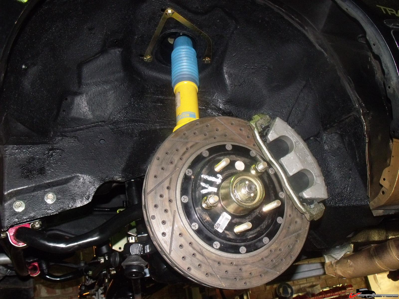

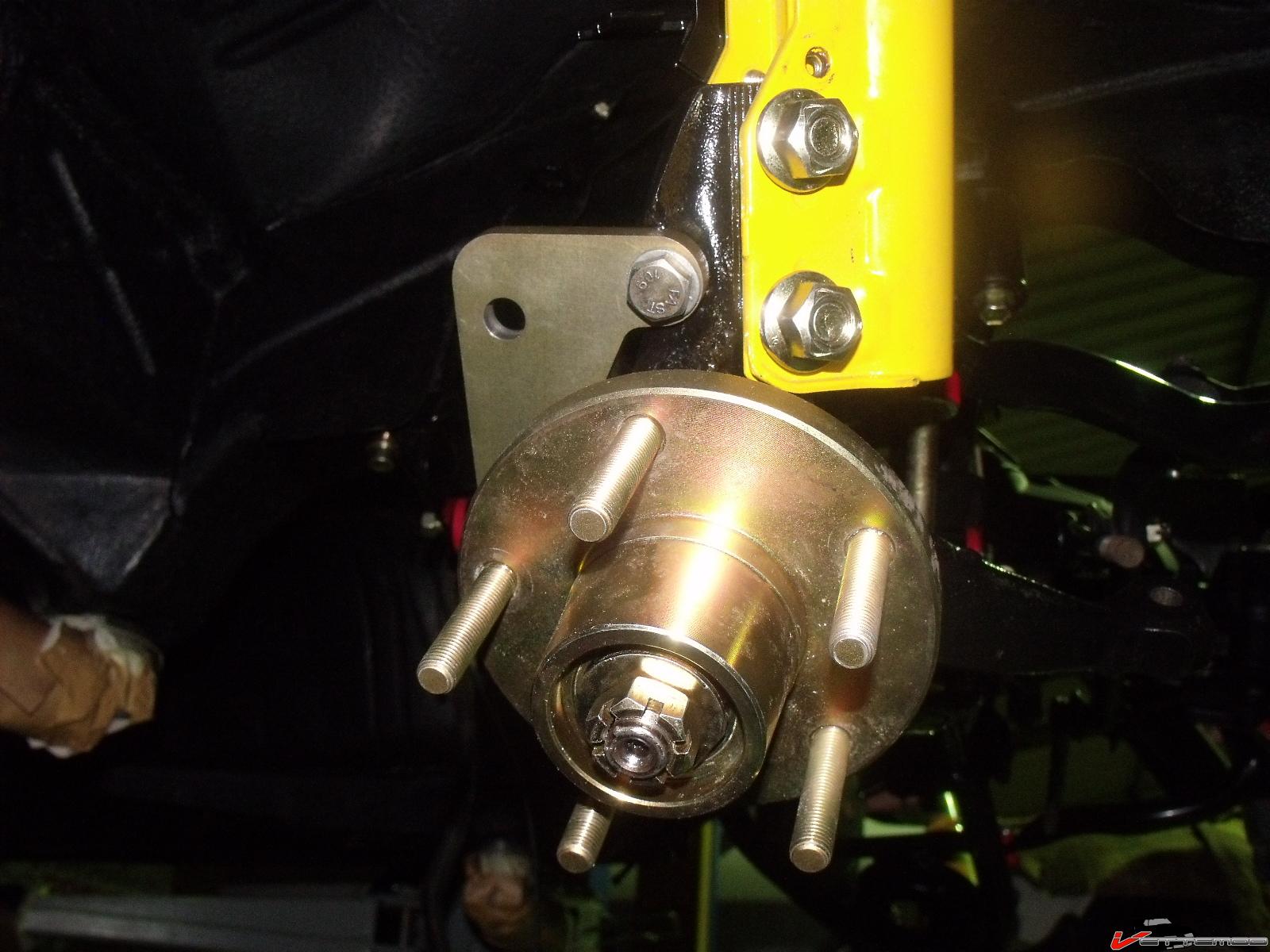

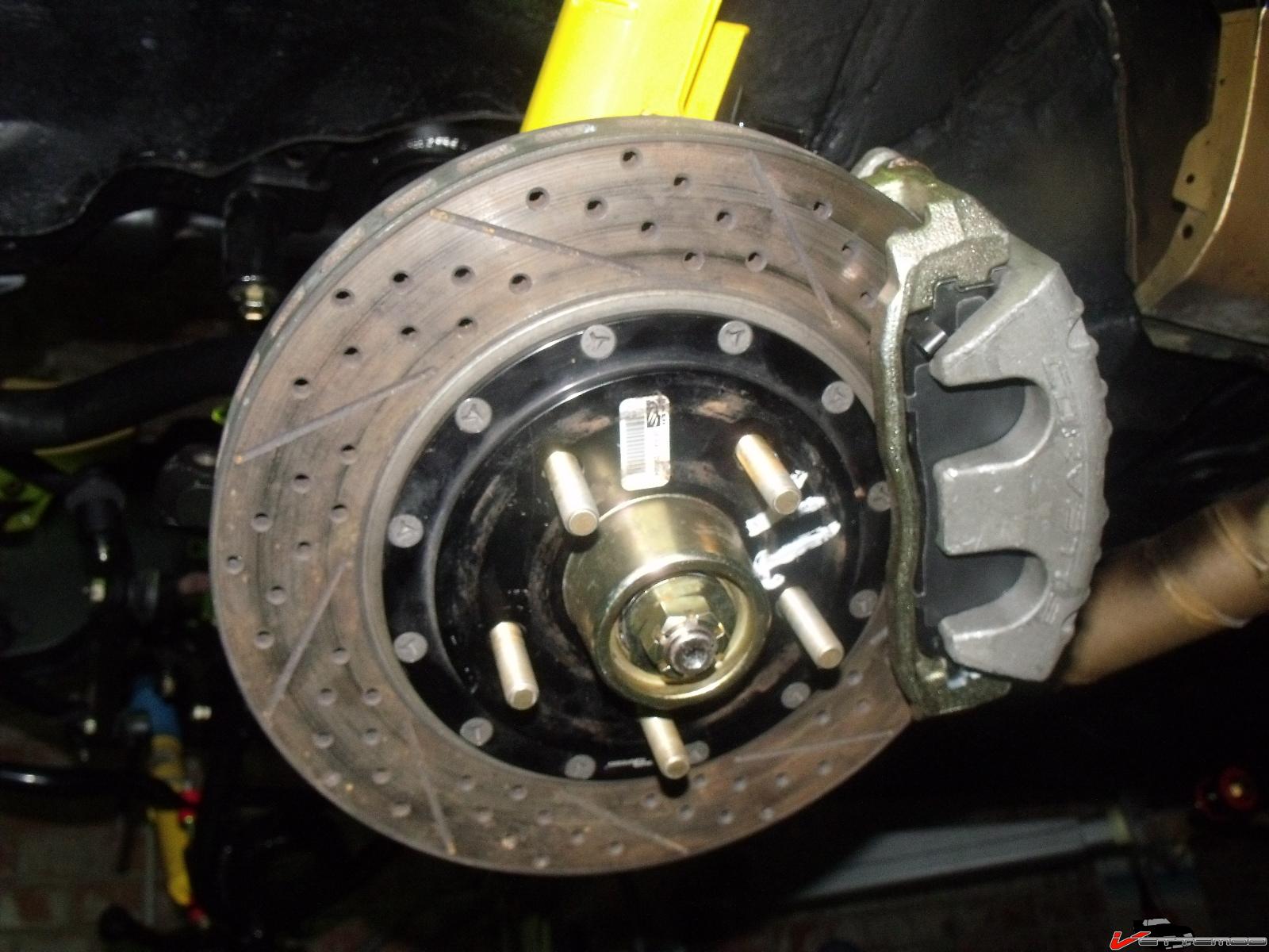

      The hubs for the C5 brake conversion were bare, I hate bare metal so...I had it plated While I was at it, I installed longer ARP studs. I thought I had ordered dog/quick start ends... I got these. Oh well...
      now I'm not feeling the rough finish on the calipers. They have dents and scratches.... and "corvette". I'm leaning towards painting them

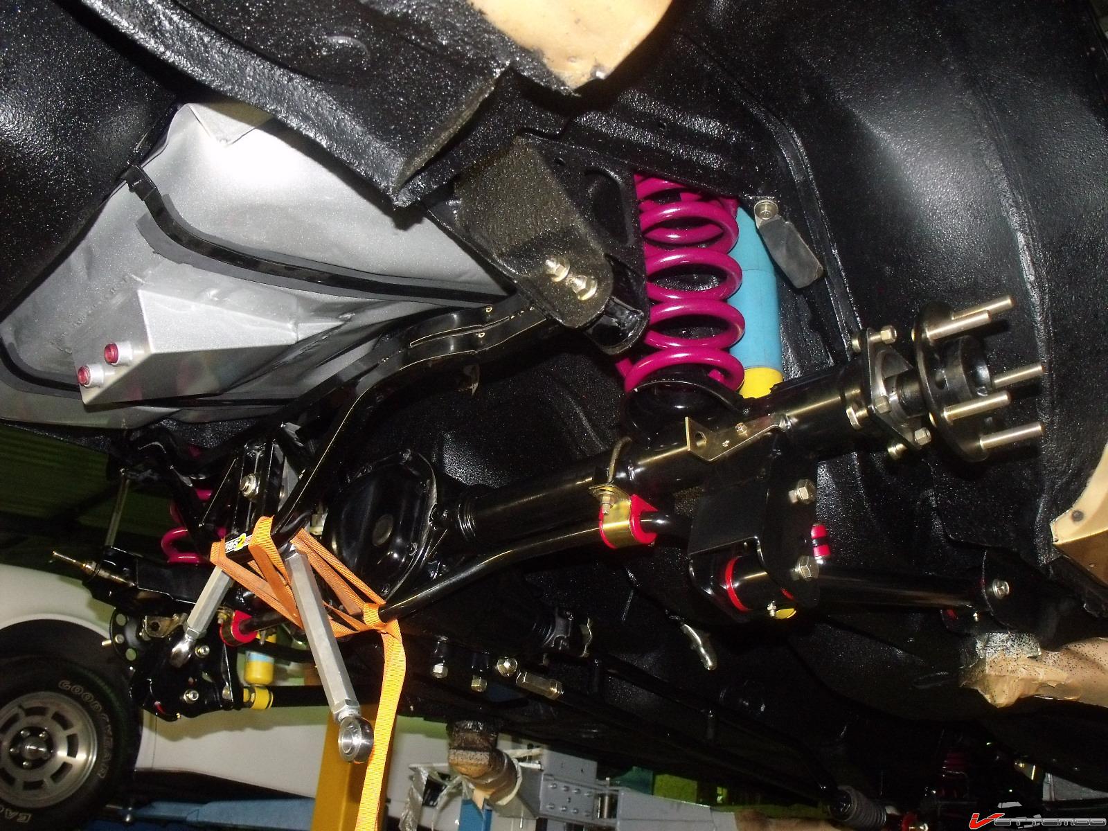

      More progress got the tank back from the coater and a bunch of bolts and misc parts back from the platers.
      I stuck some heavy duty foam rubber to the tank, much better than the paper like factory stuff
      Welded the unused lines on the sender unit closed, the hose is for the pressure valve.

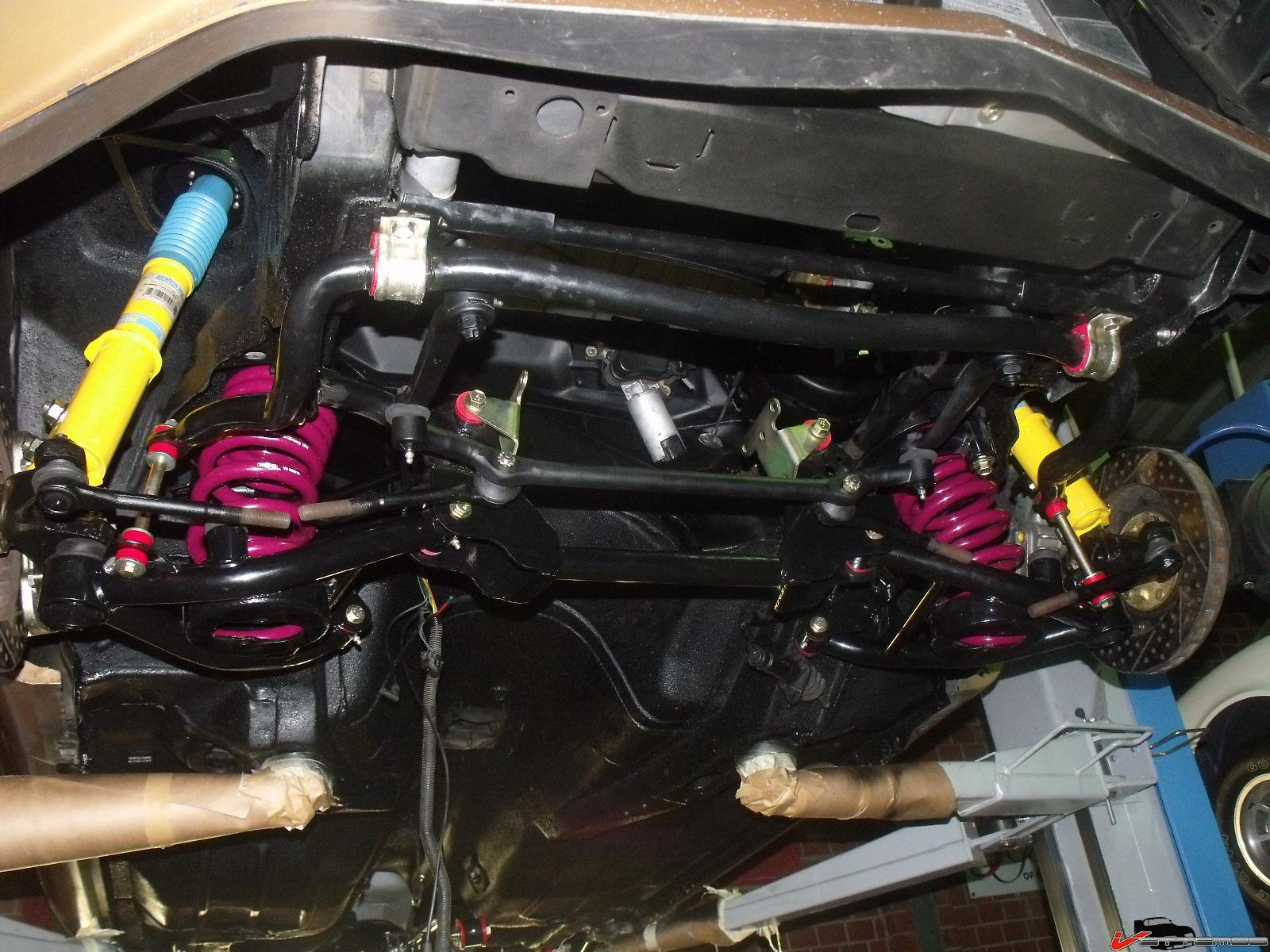

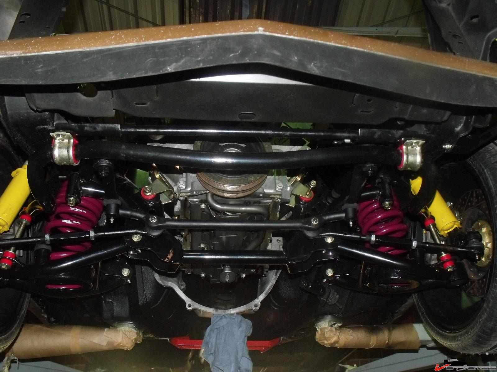

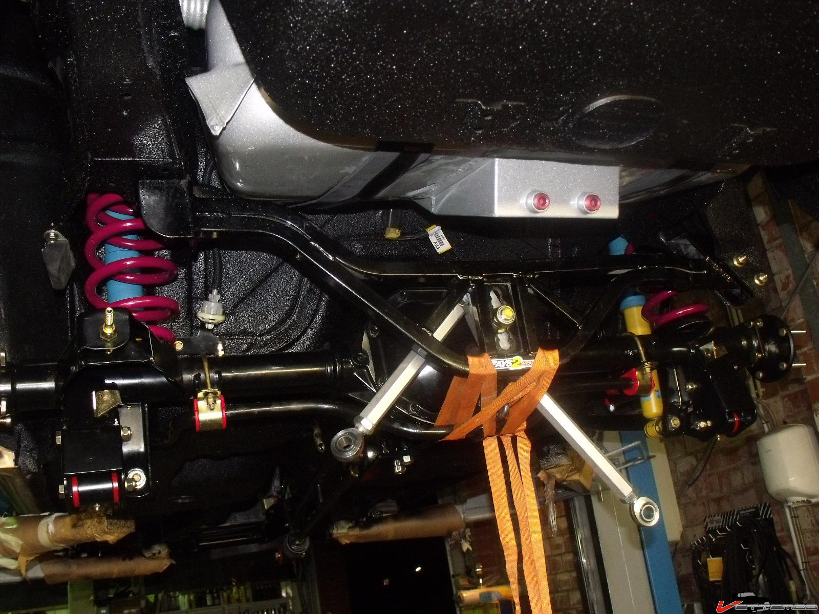

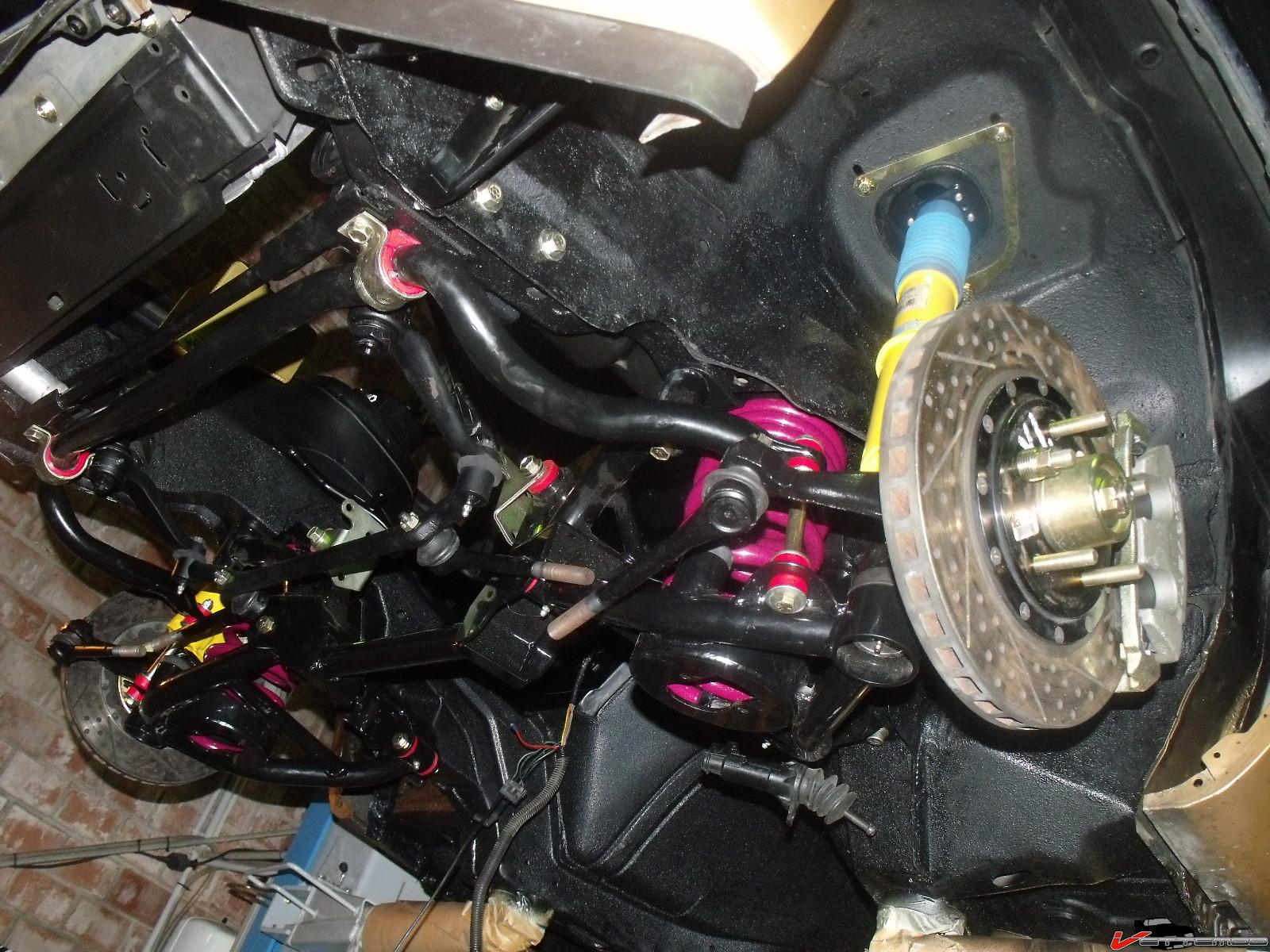

      front suspension all together. Had to shim 3 of the 4 a arm munt pockets because of play on the bushing. Also used washers on the bolts and nuts, I hate to scratch the coating with bare bolts and nuts
      Fays2 watts linkage for the rear, still need that 9 bolt girdle cover and some caliper brackets to complete it. I did install the arp studs on the axles now too.
      and the tank in place The sump isn't even visible from behind the car

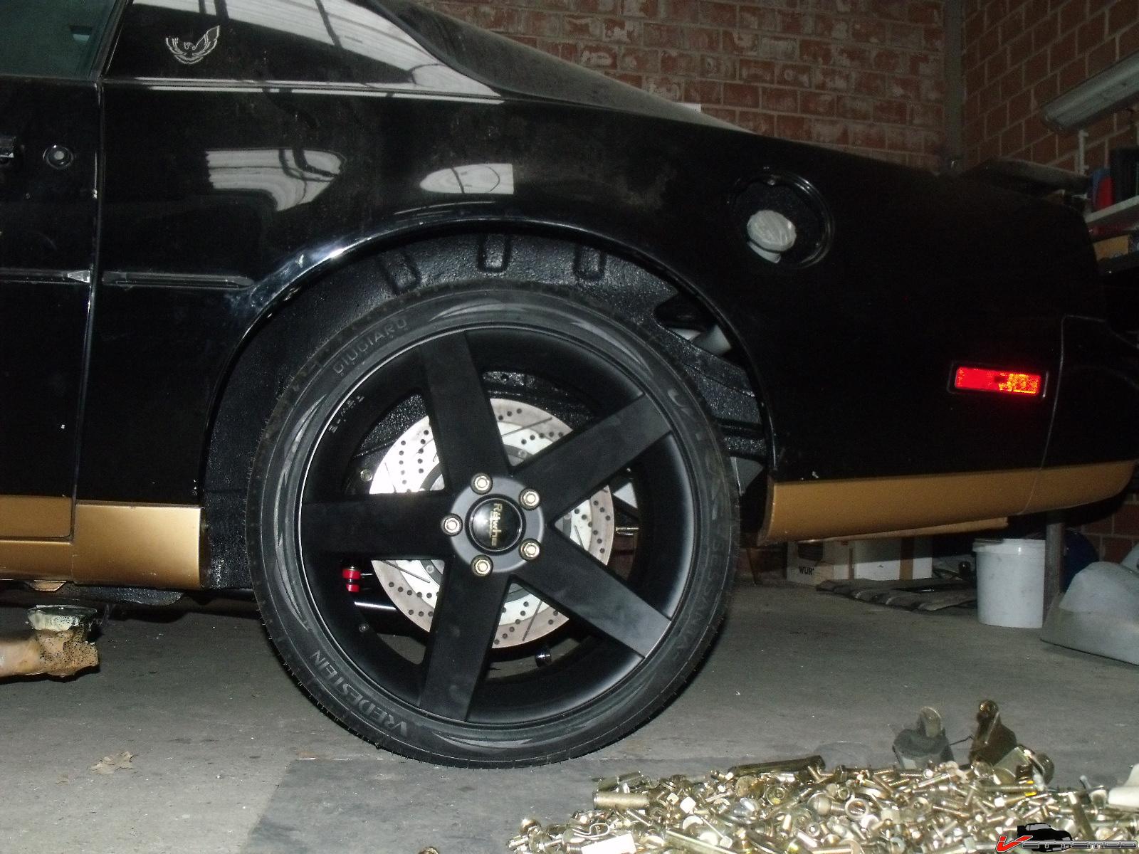

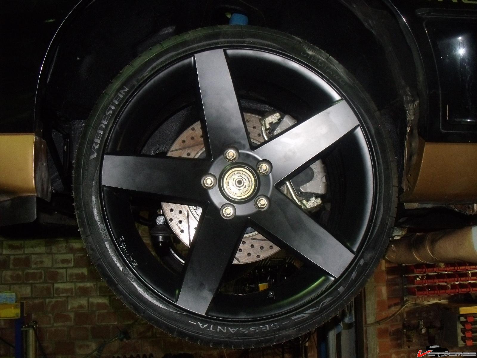

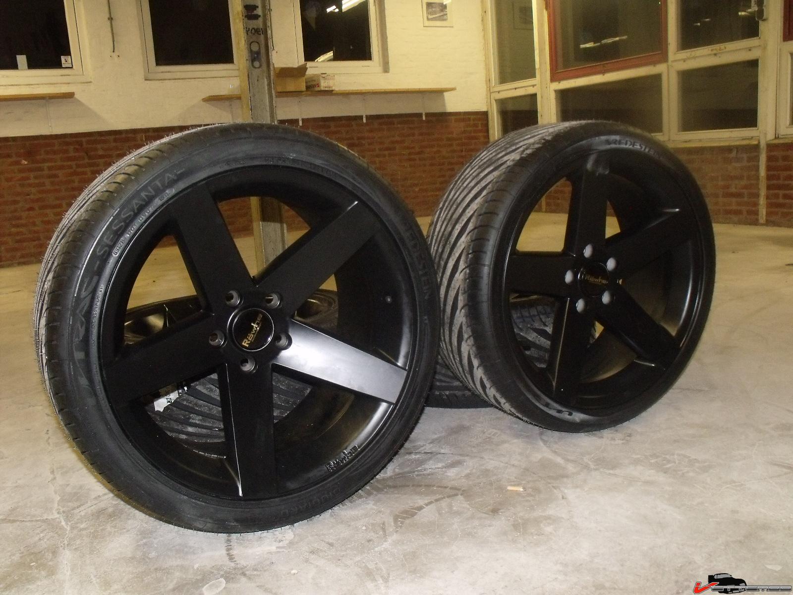

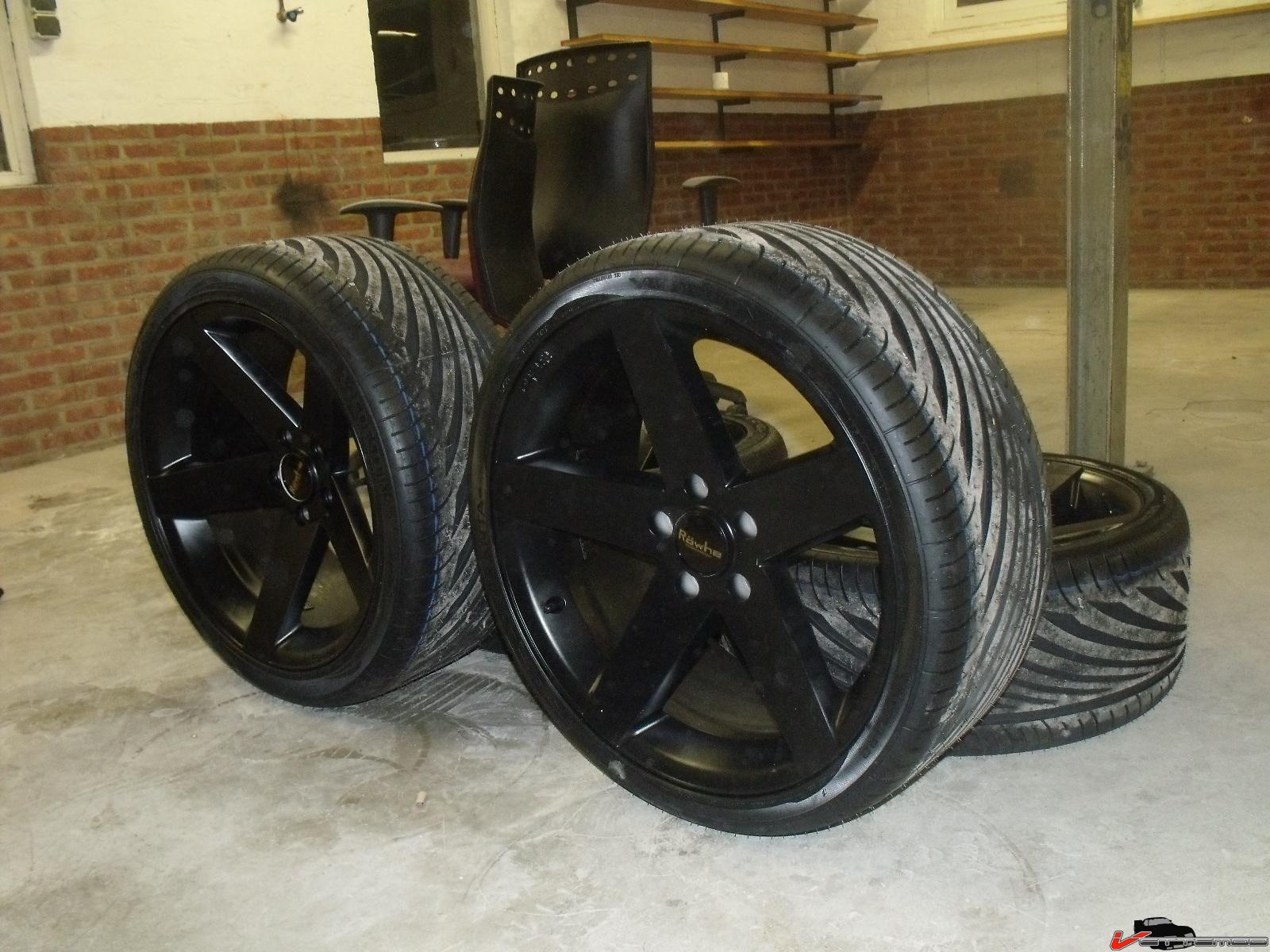

      Got the tires mounted on the rims for my camaro, this weekend I'm going to test fit them on the trans am and see if I like them on there or not
      265 30s front and 295 30s rear (Vredestein Sessanta Ultrac)
      Wheels are a little greasy from the tire mounting

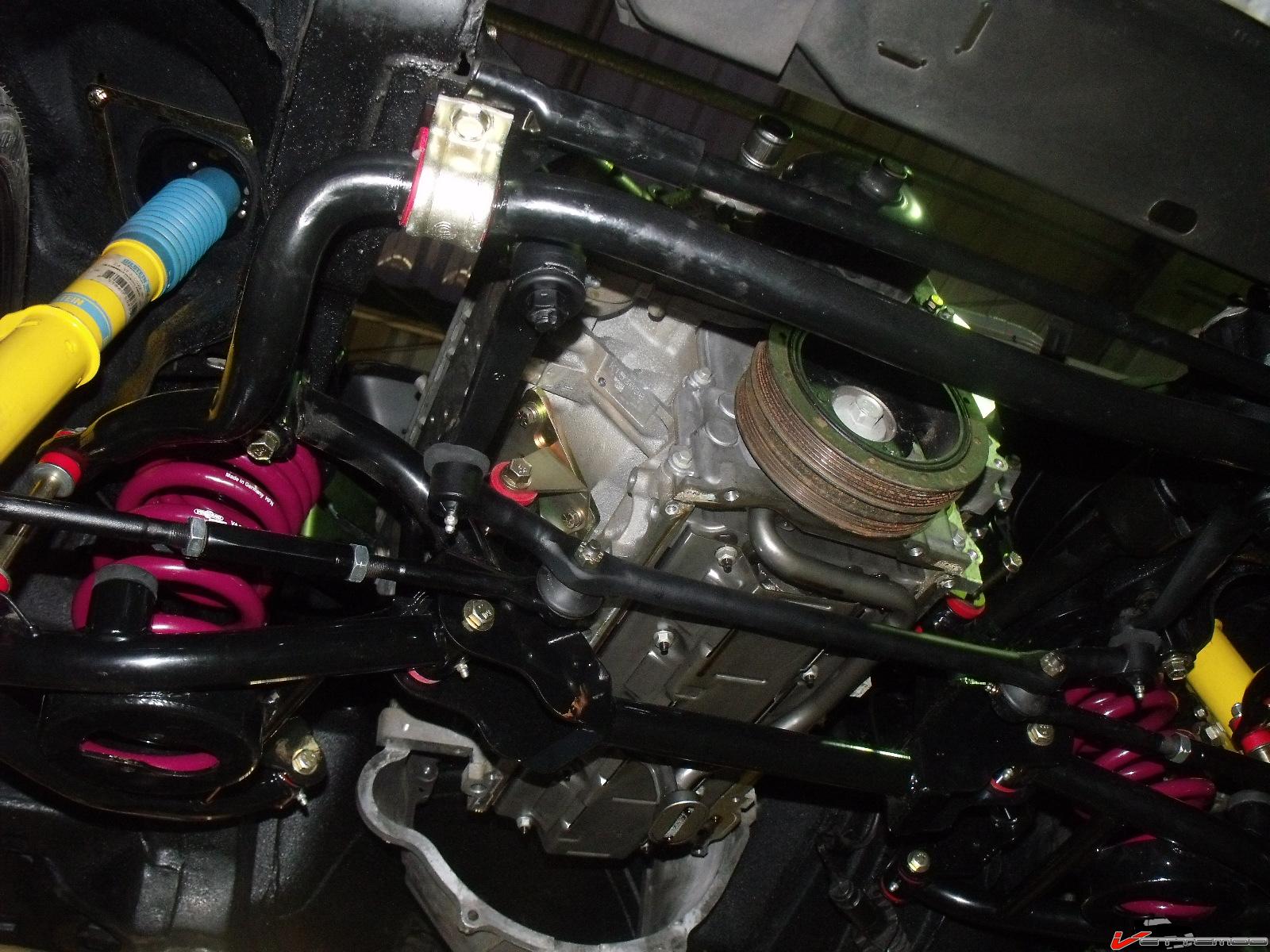

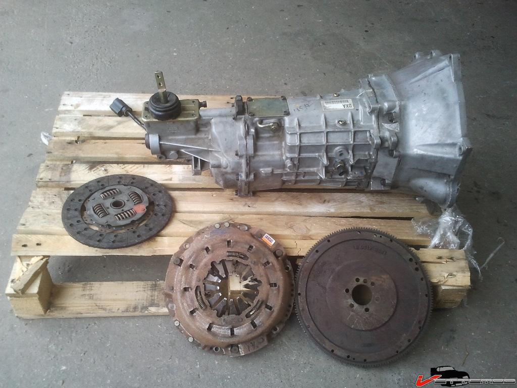

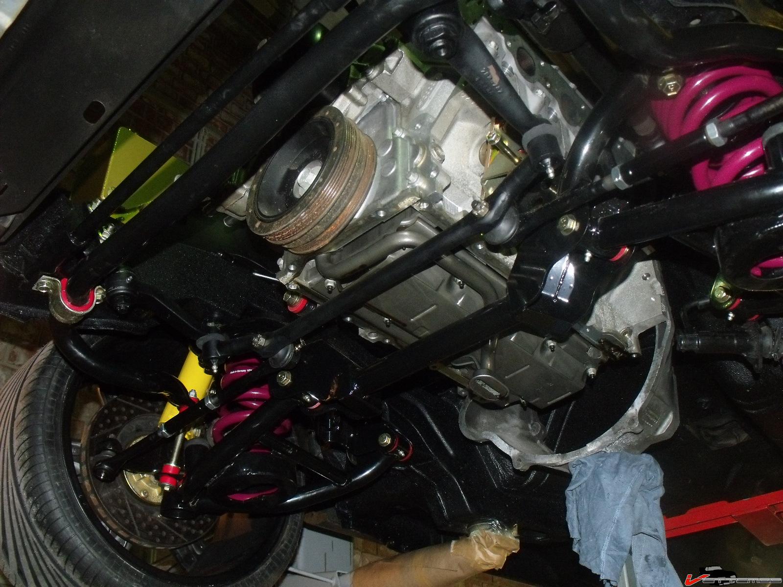

      OK more progress. I was going to install the mockup LS1 and T56. Didn't quite get it done.
      First I installed a remote bleeder setup on the T56. This is from speedwaymotors. Also plugged the reverse lockout hole and the cags solenoid hole. Don't need that stuff
      Then I found out that some of the bolt holes on the T56 bell are stripped and the others aren't perfect either. I may have to get a quicktime 8020 bell. Crap!
      Well, let's install the motor first then... OK, trans dapt 1" offset mount plates. They come with bolts and nuts, the nuts are for on the back of the plates to provide more "support". What a load of hoohah.... they only fit in 1 of the locations. In the bolts bin with that stuff then. Also had to notch the dr. side a little or it wouldn't even fit the motor because of a casting bulge with a machined flat (most likely for maching track system)
      So, the plates are mounted...time to stick it in. Batwing pan won't fit, next to impossible to install. Need new pan too then. Crap!
      So let's just lower the engine in place... Pass side bolt goes in, nice...over to drivers side.. CRAP!!! again!!!!! This stuff doesn't fit. The motor mount adapter plates are probably made incorrect with the mounts sitting too high, spreading them apart. The engine also sits pretty close to the center link. I couldn't even get a thinner bolt in there properly. Crap crap crap...more problems, last thing I need is more probs. I'll have to do some grinding on the moroso solid mounts, I had to modify the 3 holes on them already to be able to bolt them to the trans dapt plates. Should have been worried with these plates since they came with a cheap rattle can paint job. I had them plated. Next time I'm using a different brand, that's for sure.

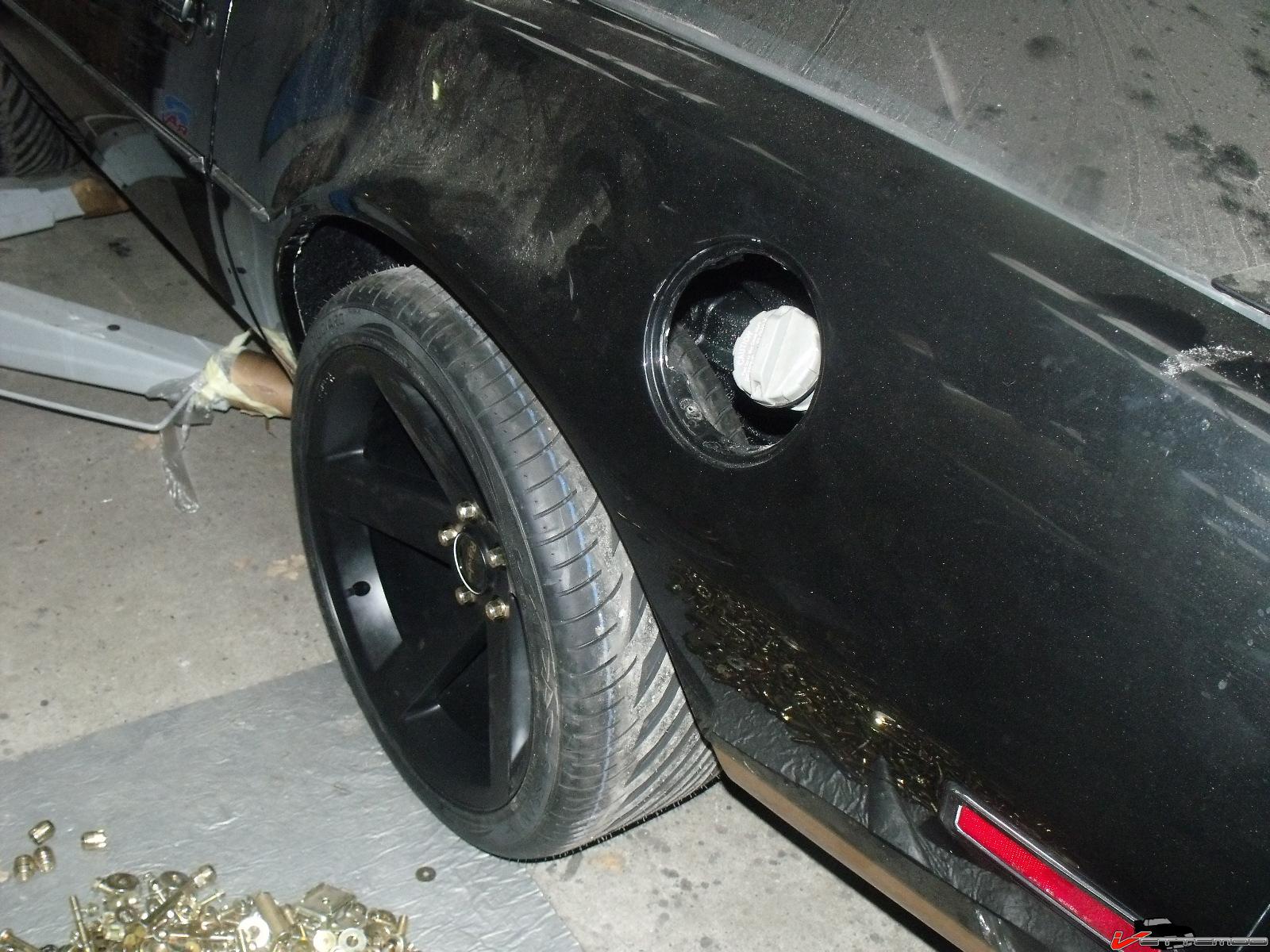

      I installed some 14" rear discs, I'm not 100% sure I like having larger rear rotors than fronts.... hmmm....
      The black wheels from my iroc fit with a small spacer for added clearance
      front
      rear

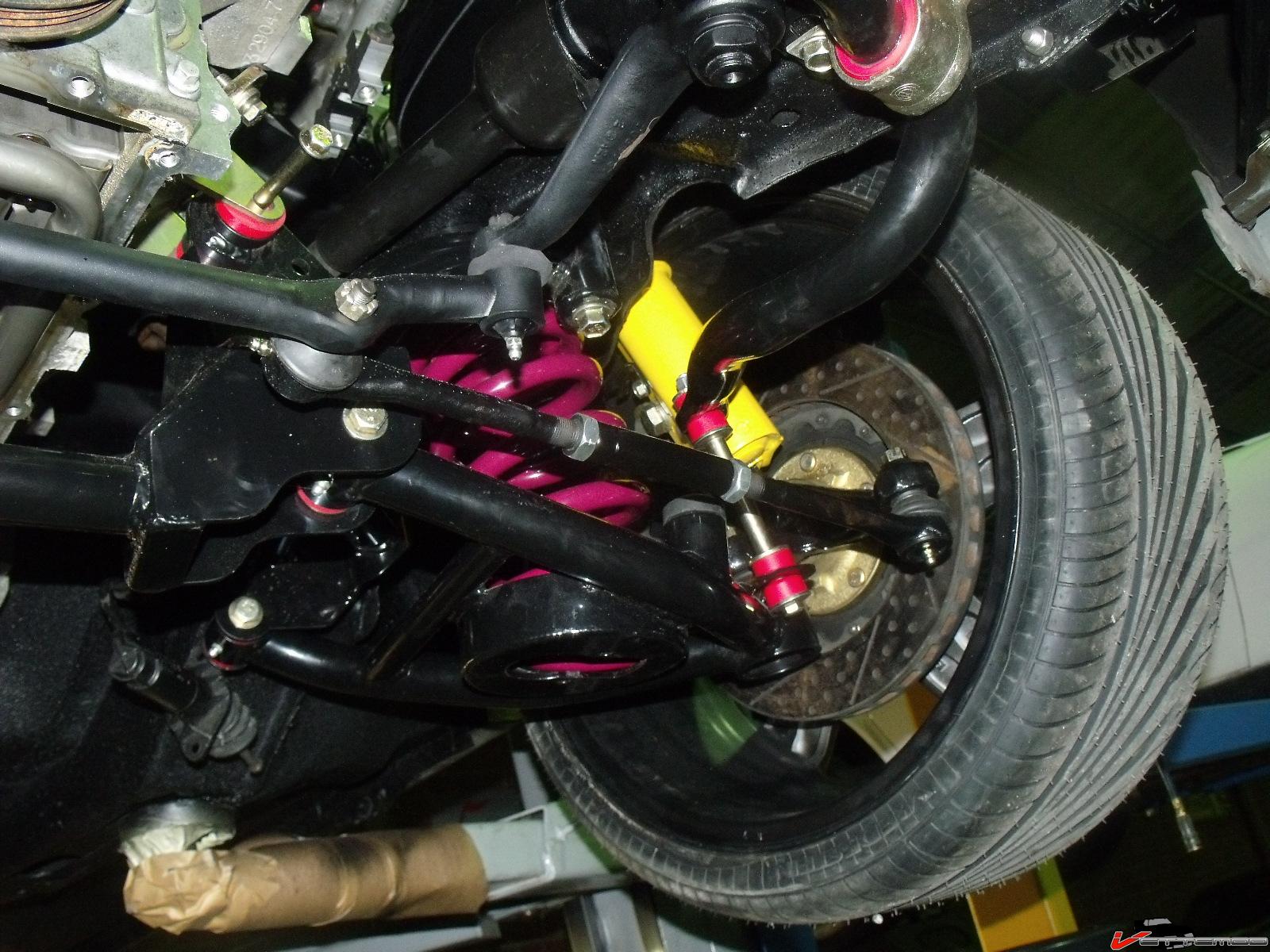

      The rear springs I got from Vogtland are probably wrong... they have pigtails on both ends, are pretty short and don't sit tight around the puck on the axle. Something is not right. Haven't gotten confirmation off the part # yet. I do know that my old set that I put on my buddies car because mine was up on the lift and his needed work anyway...they were different. They were pigtailed on one end.
      the front now has me worried too, the others didn't have so many progressive coils up top and on these the upper 4 coils almost touch and the springs are now very stiff. I had to really squeeze them to get 'em in. Let's install wheels then and see where it settles. There's no engine or trans in the car but it sits ridiculously high. I don't see it coming down all that way. I stuck the LS long block in and it only dropped a little. CRAP!!! Looks like even more trouble. :(
      Yuck!!!
      Something must be wrong about these springs. I can probably cut 2 coils off the top. I'll check w/ all the weight on the car and will determine what to do then.

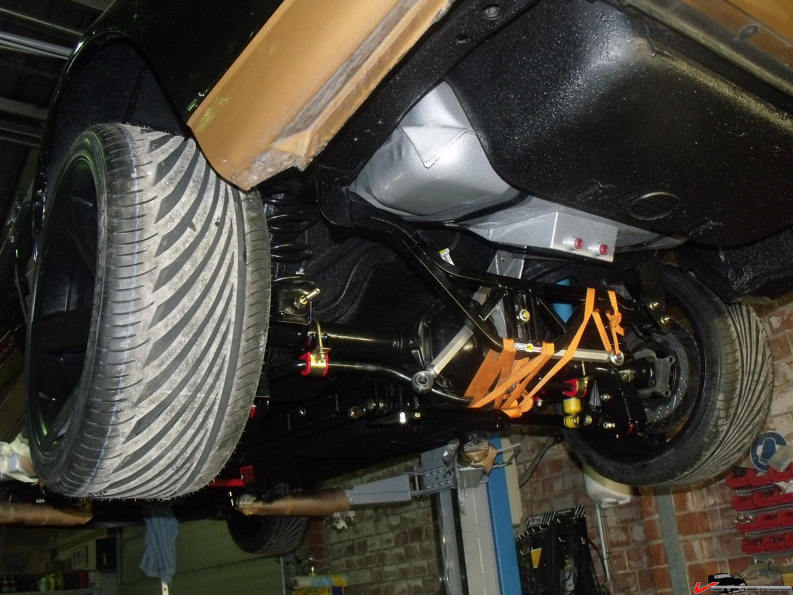

      This is the rear with some cut stock springs, the same that were on there in this pic
      compared...the rear will settje like it did with the black springs.. The vogtlands are shorter and because of the 2 pigtails can not use the isolator. Ugh...

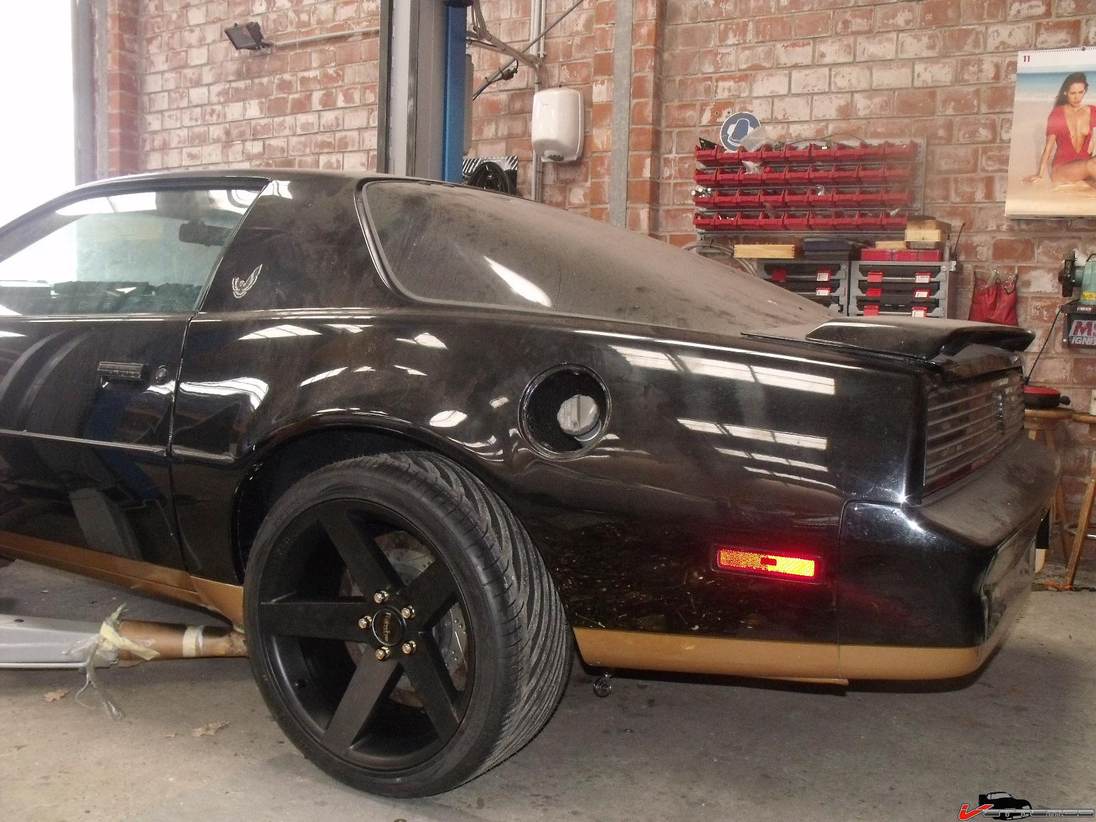

      Now a photoshop of the wheels with a low car..
      This is how it should look, not the gasser look above
