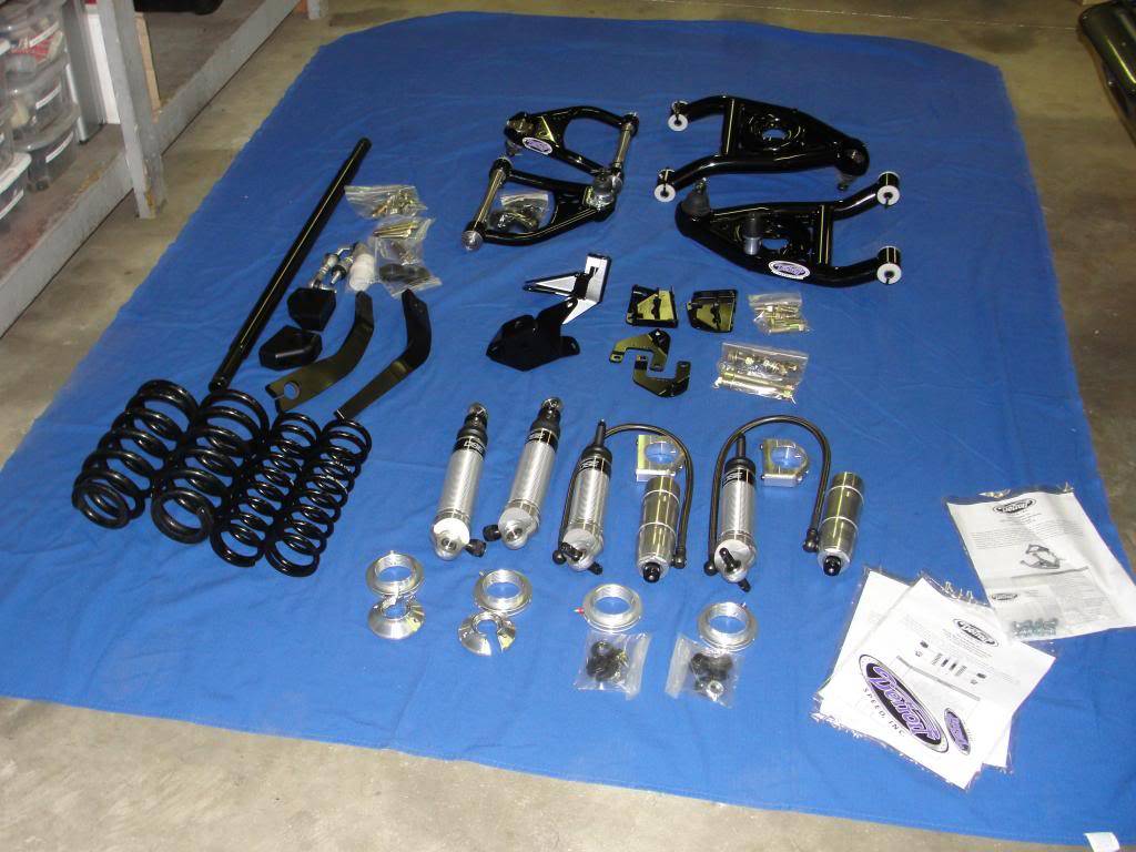

      Time for another change to the wagon! The single adjustable ridetech coilovers have been working great and Deb and Sam who do most of the driving love them. But, the opportunity to make the switch to a nearly complete DSE setup came up and we jumped on it. The new setup will be using AFCO double adjustable shocks and have remote canisters up front. We already have the current ridetech setup earmarked for a future project that should be entertaining for everyone.
      Even though Sam is already back to school he made some time to get things started. (Gotta love the lift!)

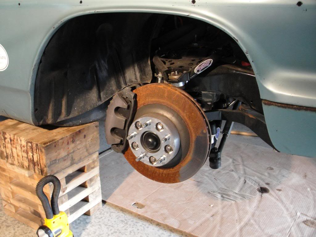

      Up on blocks ready for spring attention.
      Storage in the partially complete shop all winter was not good for corrosion!
      Cleaned up

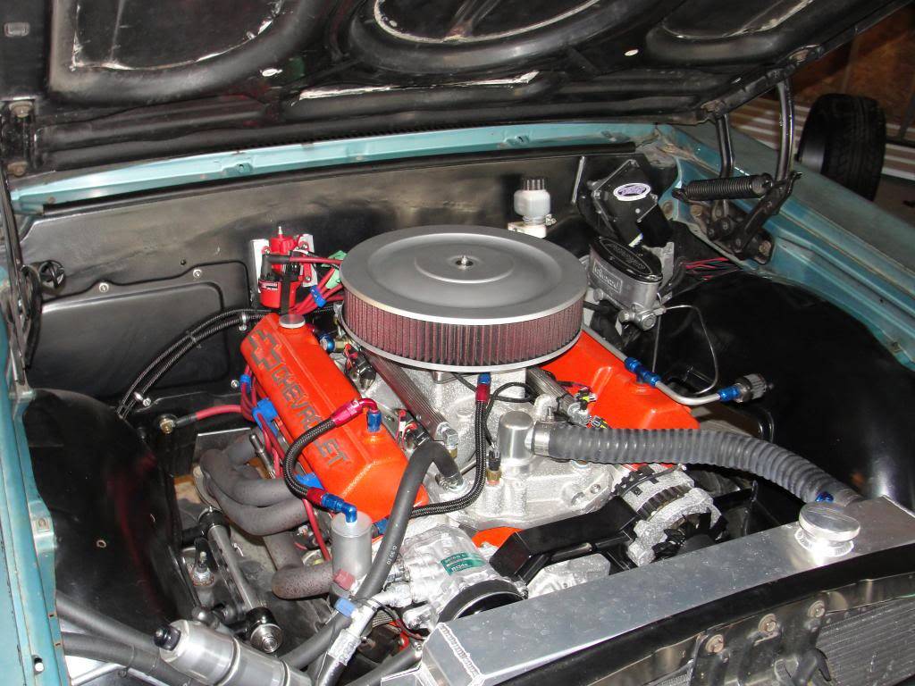

      Not that anyone cares, but we ditched the temporary paper element air filter that we installed two years ago in favor of this K&N gauze type.

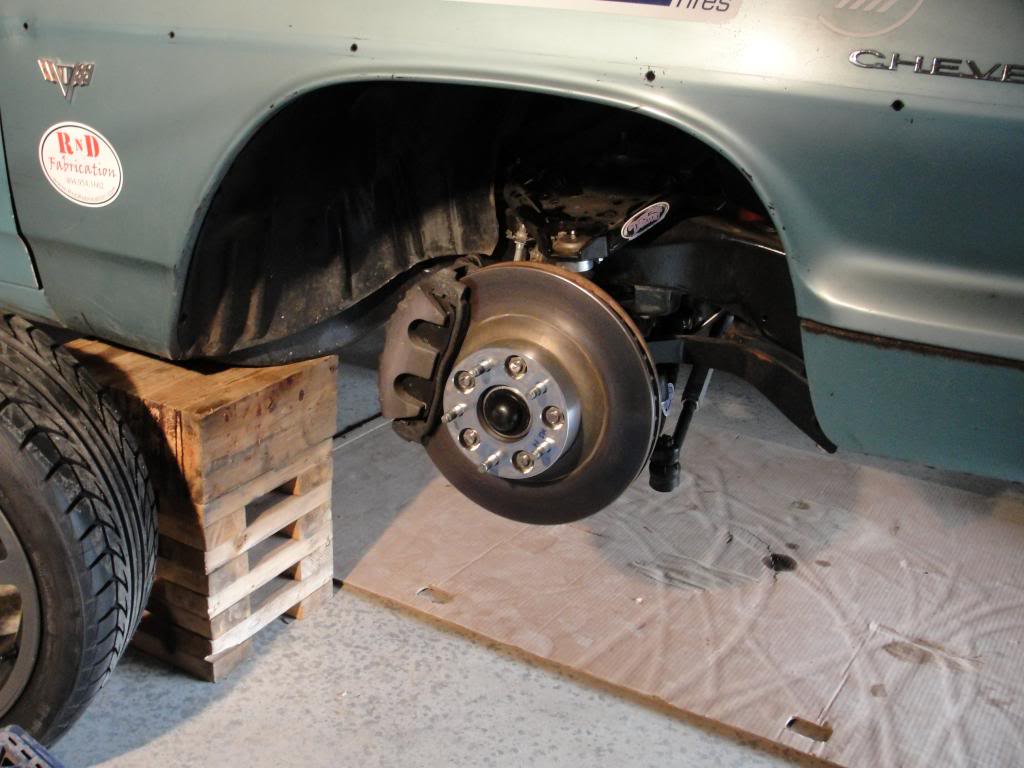

      We decided that the wagon deserved the take off Baer brake calipers from the 66.

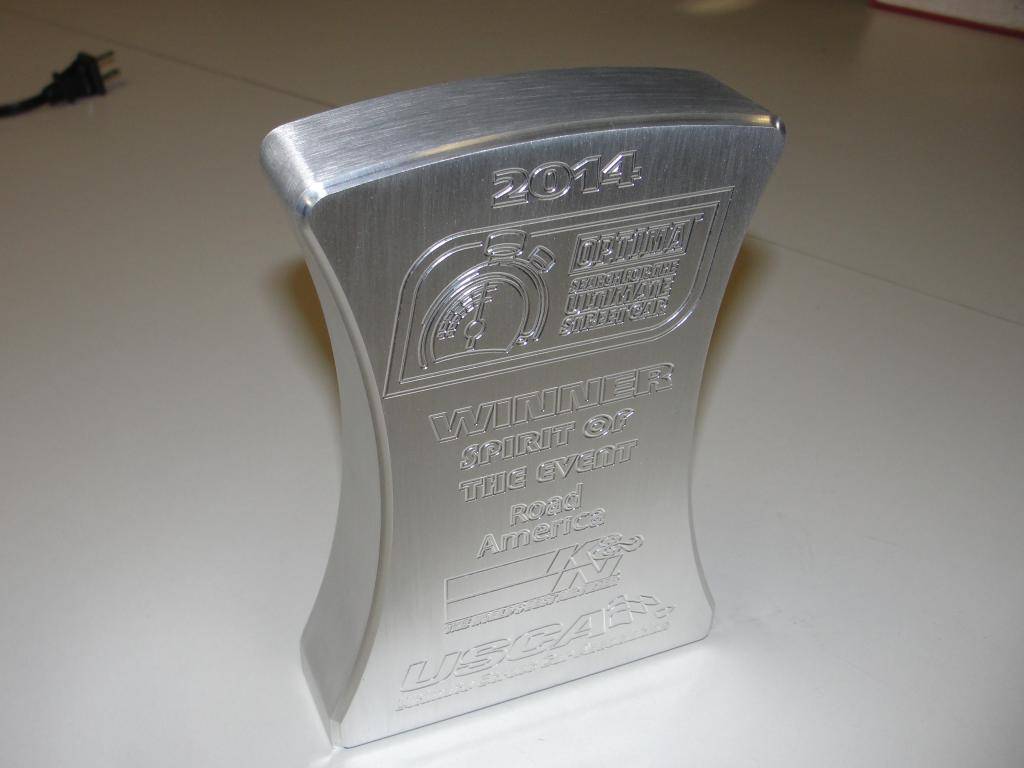

      The Big Big news is from back in mid June when we took both the wagon and 66 up to Road America to run the USCA event there. Bottom line, Deb won the spirit of the event award/invite to optima's Ulitimate Street Car Invitational which takes place in Las Vegas the week after SEMA. Deb and Sam have been running the wagon pretty hard at events since 2009 and although it always surprises people with its ability, it is still not a contender and is certainly not a show car. For that reason, we never thought in a million years that it would get an invite to sit at SEMA and compete at OUSCI. I can't even tell you how proud I am of Deb. Of course, this just means more wrenching for Deb, Sam and I...

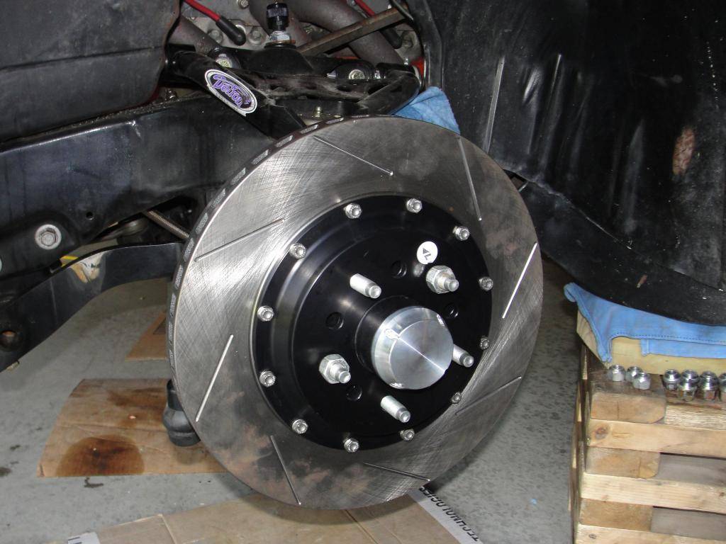

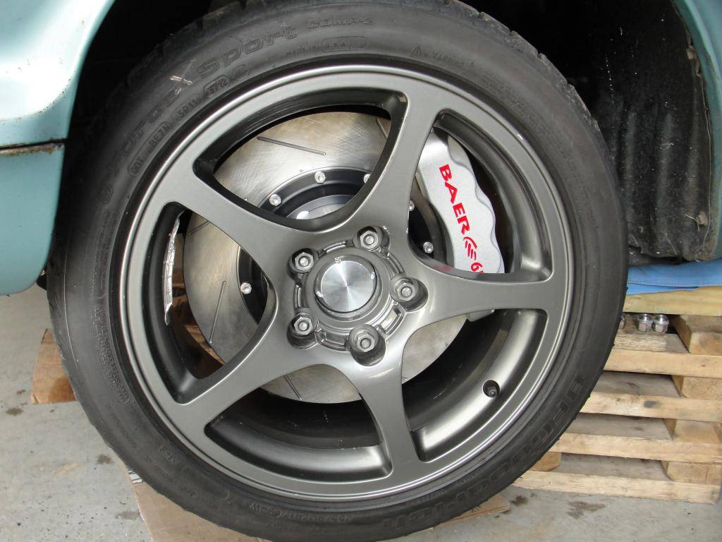

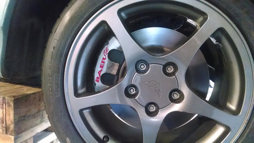

      Ordered her new brakes and they came almost two months ago. Did I mention it has been a very busy summer?
      Baer Pro+ with 14" rotors front and back (same as we use on the 66)

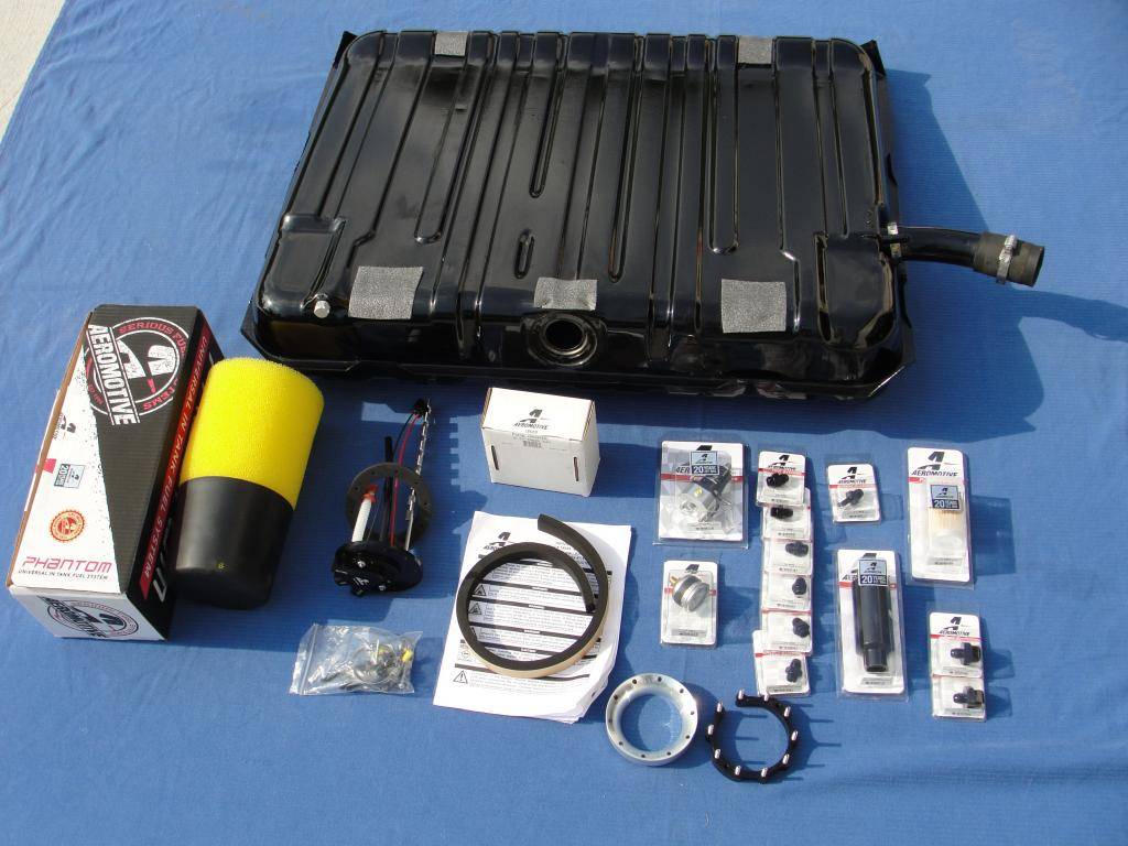

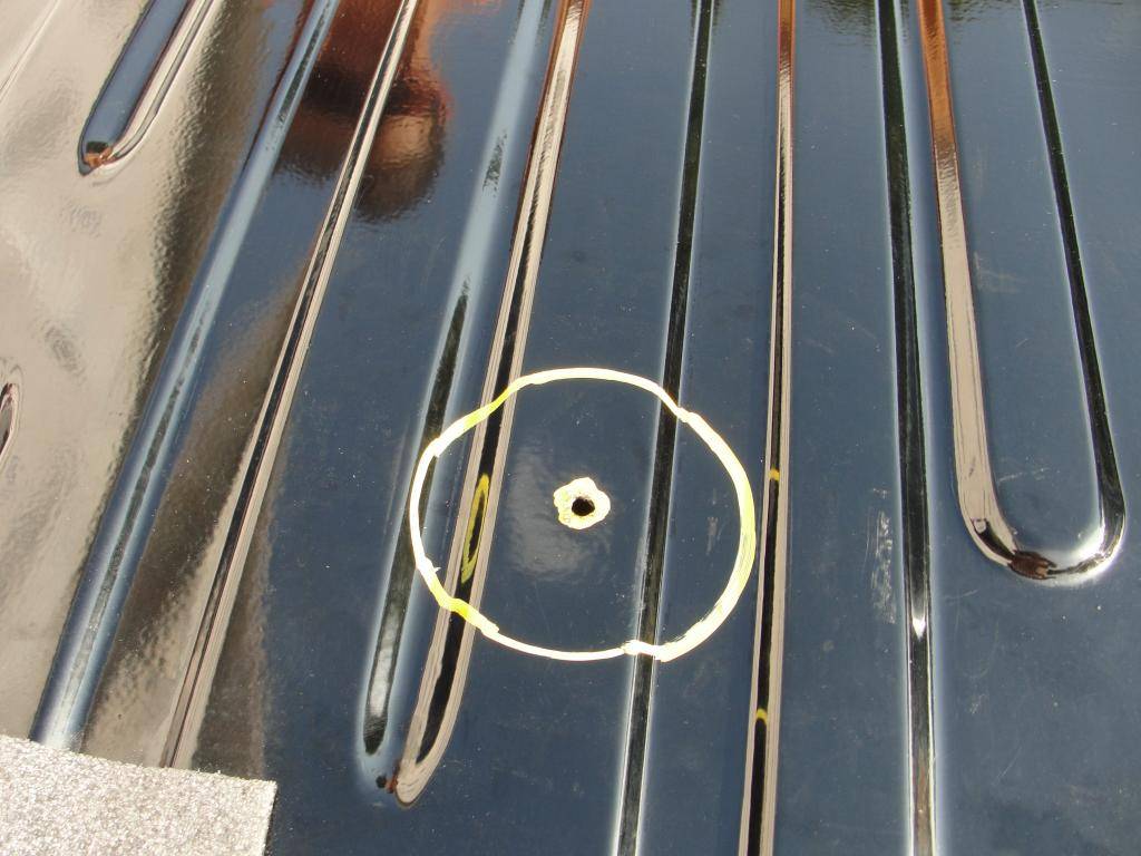

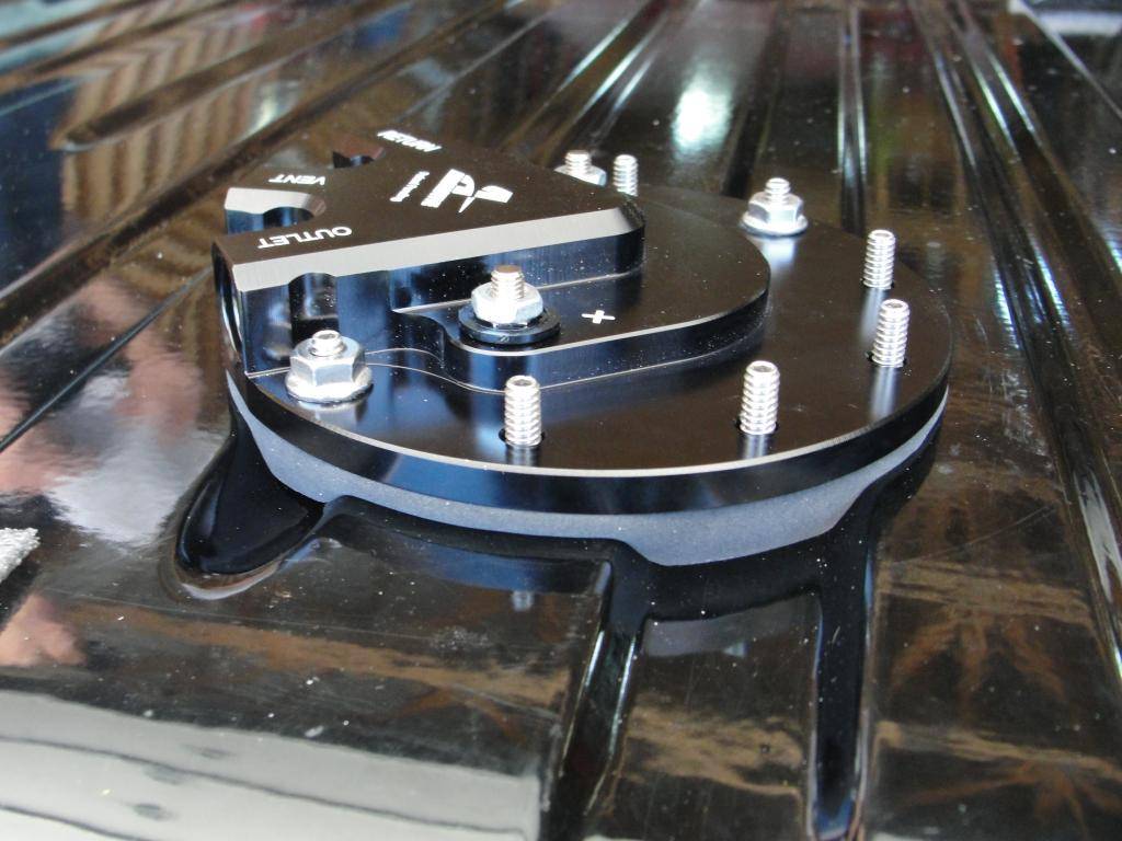

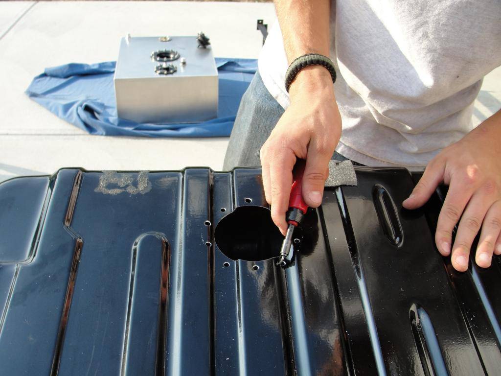

      We decided to pull the Aeromotive fuel cell with the A1000 pump in favor of putting the original tank back in with the Aeromotive Phantom Fuel System installed. Pretty amazing kit to say the least. Almost done, just need to sort out the filler neck that comes up through the quarter panel and finish wiring.

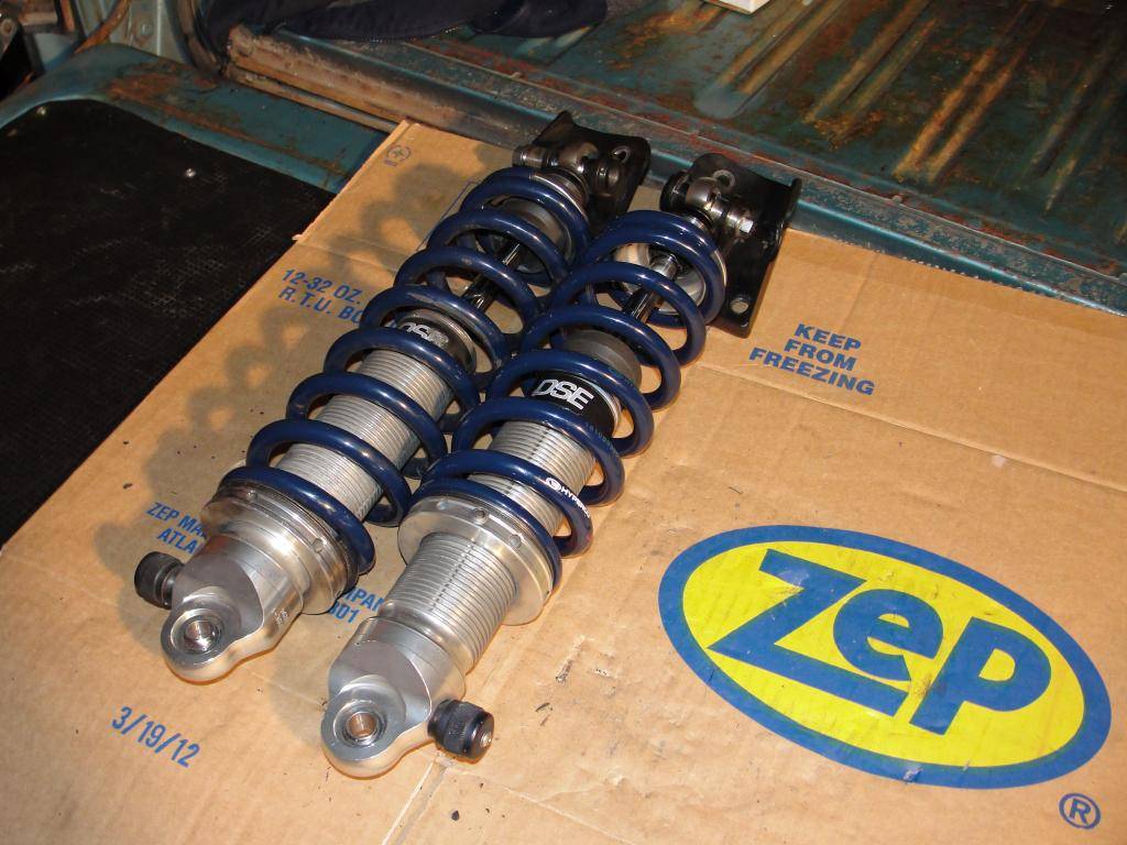

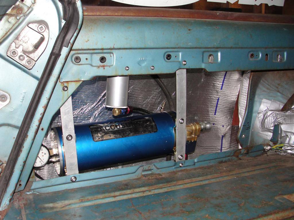

      Two quart accusump installed and have been working on trying to mount one of our previously used oil coolers. No luck on packaging one of those coolers, so I had to order a new Setrab and a small fortune in -10 AN line and hose ends.
      Swapped out our 12" 300lbs springs for 10" 300lbs springs. We had the 12's as low as we could adjust them and the rear of the wagon still sat a little high. The 12's are what we ran with our ridetech coilovers. DSE stuff uses 11" but they are a little card to find, so 10's will do fine.
