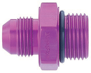

      You know, my Aeromotive fuel pump and filter use ORB fittings. When I ordered the filter mount I talked to the guy at Hamburger and he said it was 3/4 NPT so that's what I've been using. I'll bet money I should have been using ORB fittings!

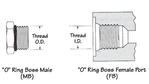

      I think I can see the boss in the picture you posted, but I can't quite tell; NPT fittings have something that looks like a boss, but it's more of a thread starter. The smooth, un-threaded boss at the top of the threads will be a dead giveaway of an ORB though. The only crappy thing is now that you've screwed an NPT in there a few times, the ORB won't thread in nicely either, but hopefully it'll stop your leaking woes.
      ORB
      (disregard the "rear view" for our purposes)
      NPT
      Note the beginnings of a thread in the somewhat boss-like bevel at the top of the threads.
