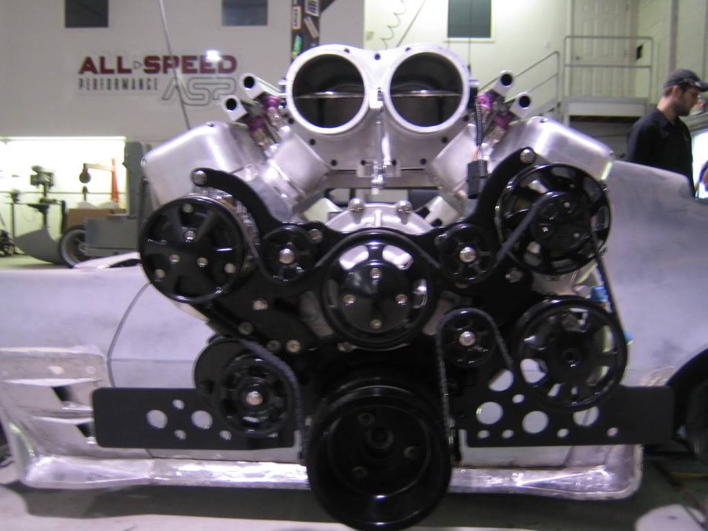

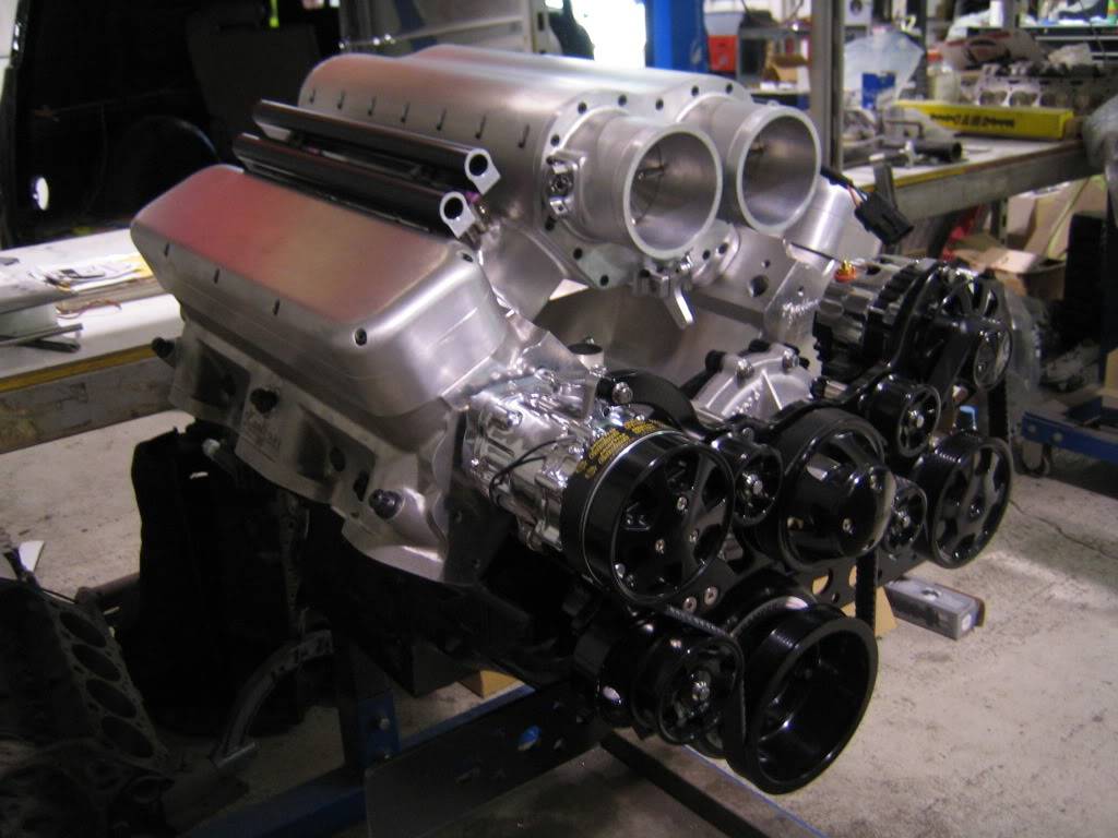

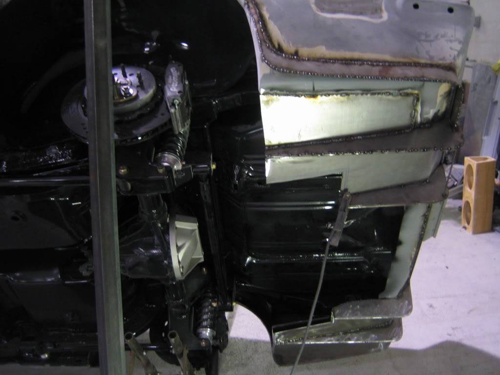

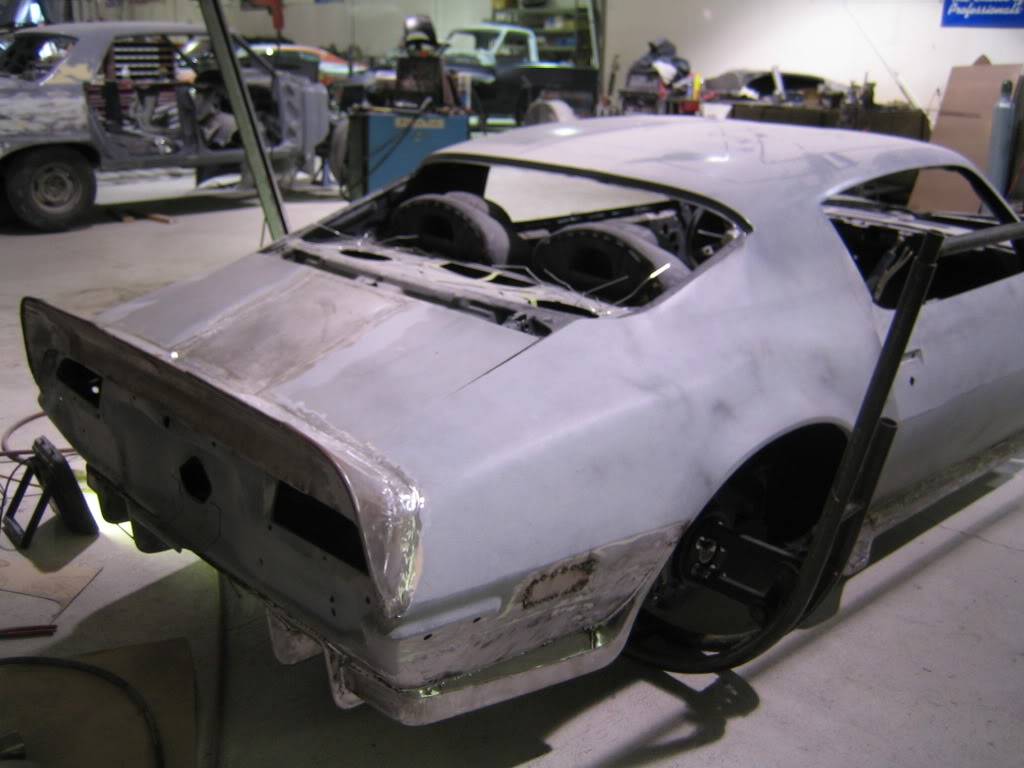

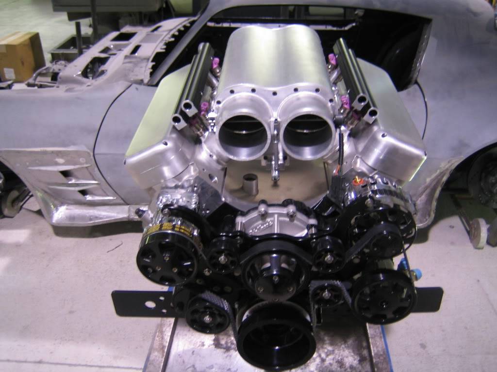

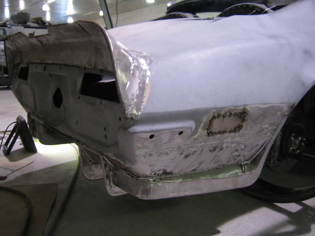

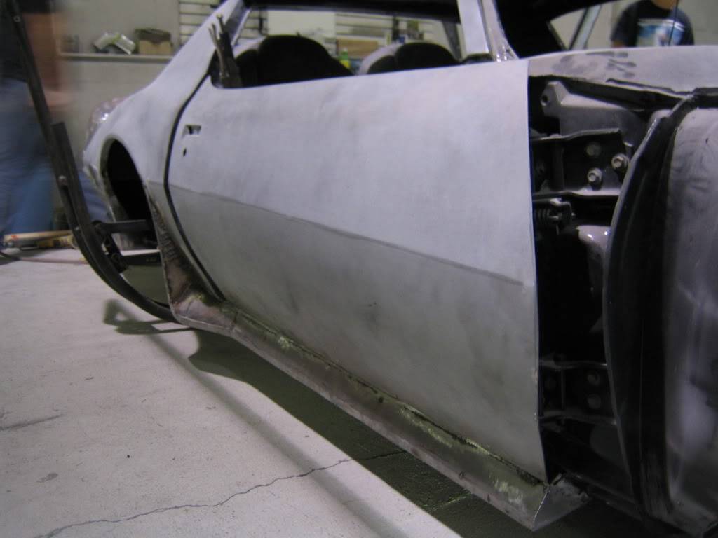

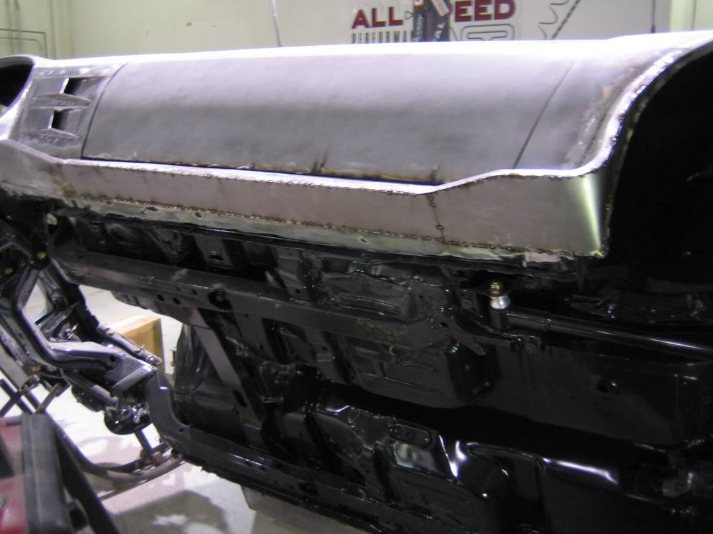

      I just left All Speed and grabbed some updated pictures. They are in the final stages on the body modifications. The rear diffuser is finished and the stainless gas tank has been fit to the rear in between the outer edges of the diffuser. They are finishing the close-out panels on the side skirting and diffuser so that it is one integrated piece.

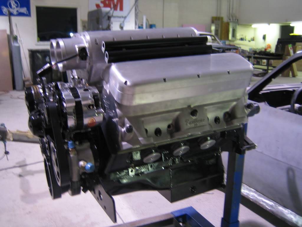

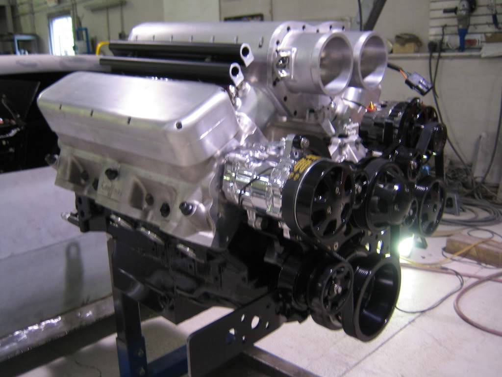

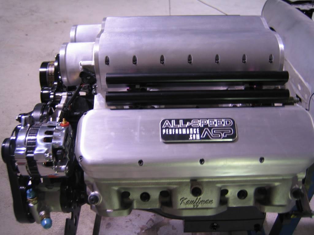

      The Billet Specialties drive system has been installed to the engine as well as the solid engine plates. We are finalizing the decision on what parts of the engine to coat and what to leave natural. We are planning to coat just the center of the intake and the valve covers and leave the rest natural. The turbo plumbing will be all black. I ordered a Ram dual clutch and flywheel set up and Keisler sponsored an upgraded hydraulic set up for the Tremec we are putting in. Thanks guys!
      We are making a plaque for each valve cover that will be recessed into the cover that says “Firebird” and another plaque that will mount just above the hood latch that says “V8”. I wanted an aggressive font, let me know what you think of this. (see attachments)

      Now, I try to leave out my opinion or anything at all remotely critical, but I do have a suggestion on the logo. How about an older Pontiac insignia? I'm partial to the '60s Firebird emblem on the front fender - put that on the valve cover. I don't think the pdf you have there does this increadible engine deserves much better.
      Also, I dig the older 421/checked flag emblems from the '60s. Duplicate that but make it 475! Bam.

      Awesome.....Thats one of the finest pieces of eye candy I've ever seen....I love that billet Spec drive system, just hate the price, lol.

      I think that you are building one of the coolest Firebirds ever. You are going to great distances to keep things clean, but very much modified. I would stay with the clean theme with the emblems too.

      I appreciate the feedback. Maybe I scrap the emblems all together? I had the valve covers custom made so that they would match the milling and hardware of the intake. Based on the feedback I've received on the emblem idea, I am leaning towards leaving them off and keeping the entire engine clean. Agree?

      I've received several requests for the body kit as well as the valve covers and intake. We saved all the templates for the body kit and are considering something in that regard.
      We have the CAD files on the valve covers and individual intake components so we could duplicate. They may need to be modified to fit your heads, we are using the high-flow Kauffman heads on this engine.

      Feedback o nthe engine "look"....I'm really digging the black/milled alloy look of the engine...I'd go with your thoughts on keeping it clean and simple.
      Yeah... I agree! It just looks so good as is. I had mentioned previously that a clear ano or clear/matte powder coat (if that's even possible). If you must go black, then just a hard ano would be cool! With that, you will still be able to see the grain in the AL. If you power coat it, all of that cool machining will be hidden.
      I agree.....keep those items clean. Still, you might want to name the car somewhere under the hood. Are you fashioning a closeout panel for in front of the radiator core support? You could have the entire thing powder coated black, but then an engraved name.....script perhaps as it would match the flowing lines all over the place.....and powder coat the engraved name in dark red or a color of your choice. An item like a closeout panel is easily changeable if you ever change your mind.

      I would not touch the valve covers or intake either. sick as they are!
