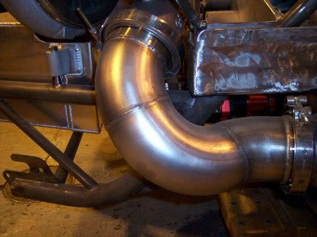

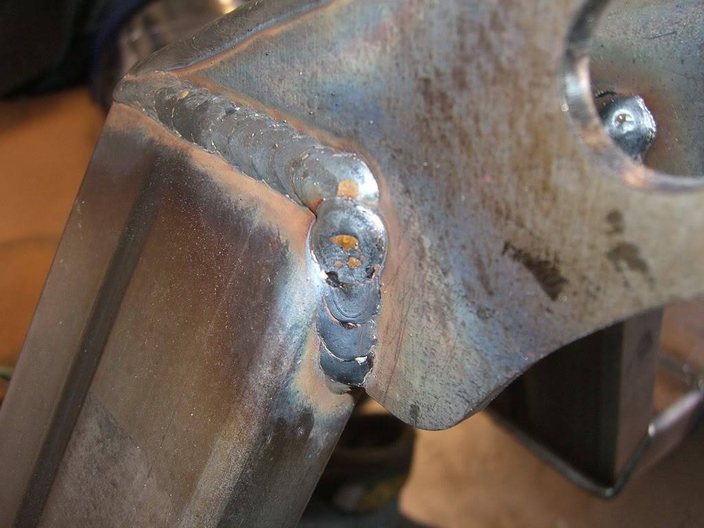

      TIG is NOT the only way to weld 4130, that has been proven time and time again. DOM / 4130 and MIG are more then fine for just about EVERY application except a top level drag chassis. There are a lot of people who only TIG weld chassis and when it comes down to it they really should not. The majority of TIG welded chassis are cold single pass welds that are more dangerous then a decent MIG weld.
      I guess the pictures of MIG 4130 below are not safe enough...
      You have made some very bold statements about MIG welded structures.... care to back them up with more explanation?
