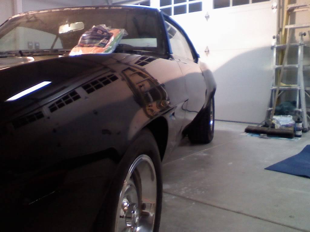

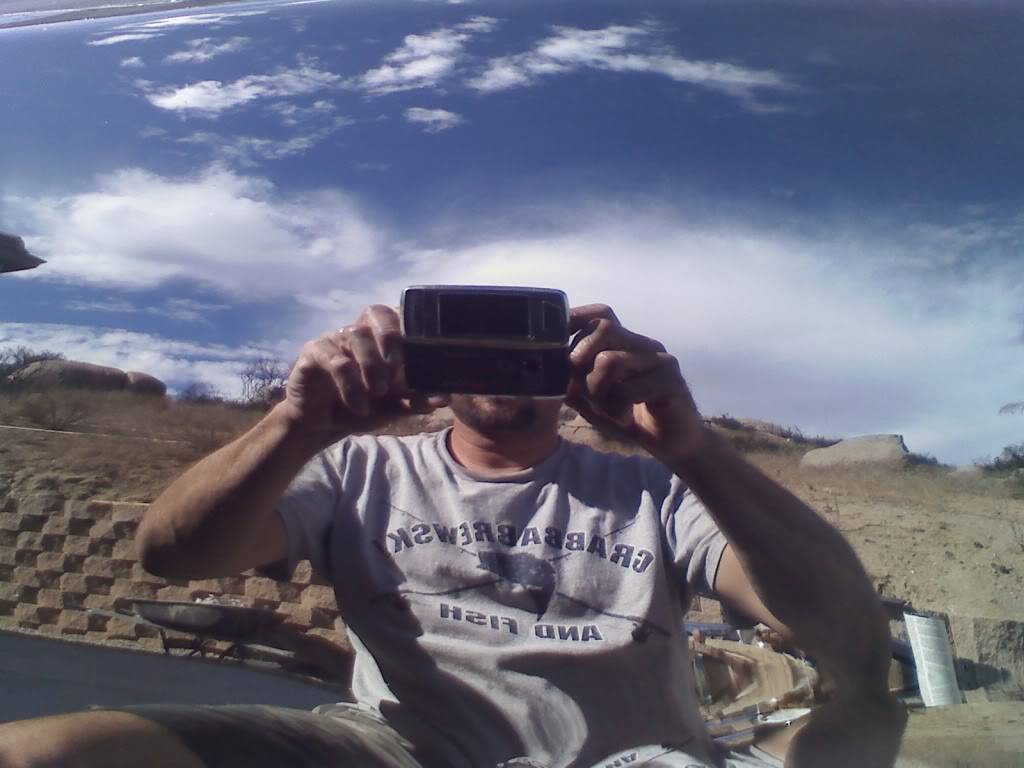

      sanded after paint
      After re-clear and cut and buff.
      Is this what you are looking for?
