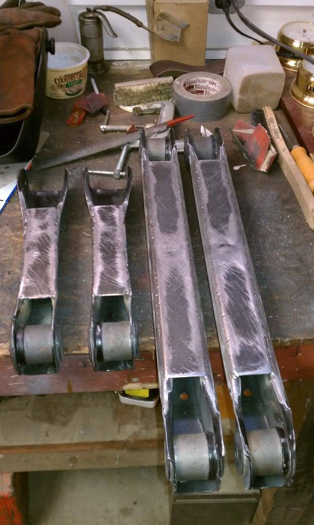

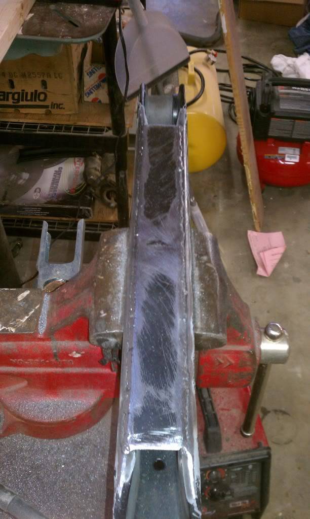

      Since my #1 goal was to have a driver and i didnt have the $$ to get this thing rolling on a great chassis this year, i decided to take the rear CA's out, blast them, install new bushings and box them. This will all be replaced later by an SC&C stage II setup but it worked well enough this year....

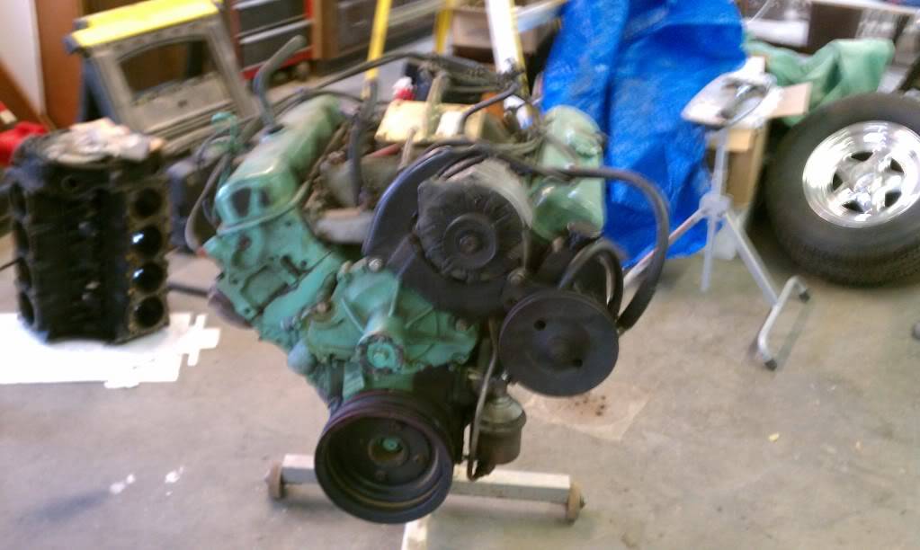

      I picked up a craigslist .030 over 73' 455 with 6X4 heads, a performer, a 750 Q jet, all the accessory drives, starter and all for $800 bucks. What a score. Its not super fast. I would guess it at 375 hp and maybe 425 ftlbs, but it runs GREAT....
      -Nick
      -1967 GTO I drive and race
      -Build threads:
      Waterloo, Ia
      1,408
      With a little elbow grease you turn that turd.....into a nice looking engine!...

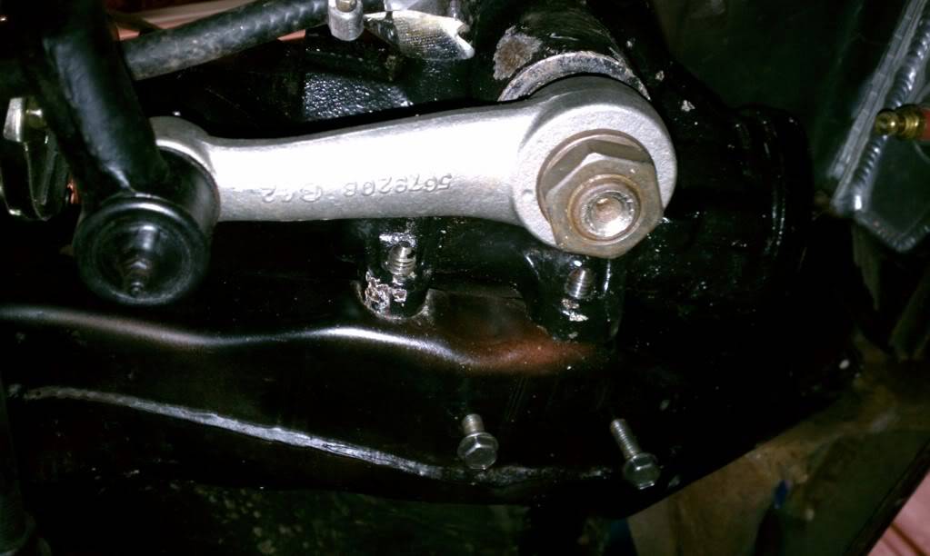

      I needed a PS box so I scored a nice Jeep unit from a junk years, got the Lee fittings, cleaned it up and installed it. What a great upgrade for 75 bucks. 12:1 steering for a fraction of the cost!
