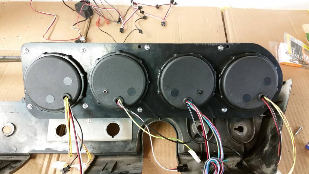

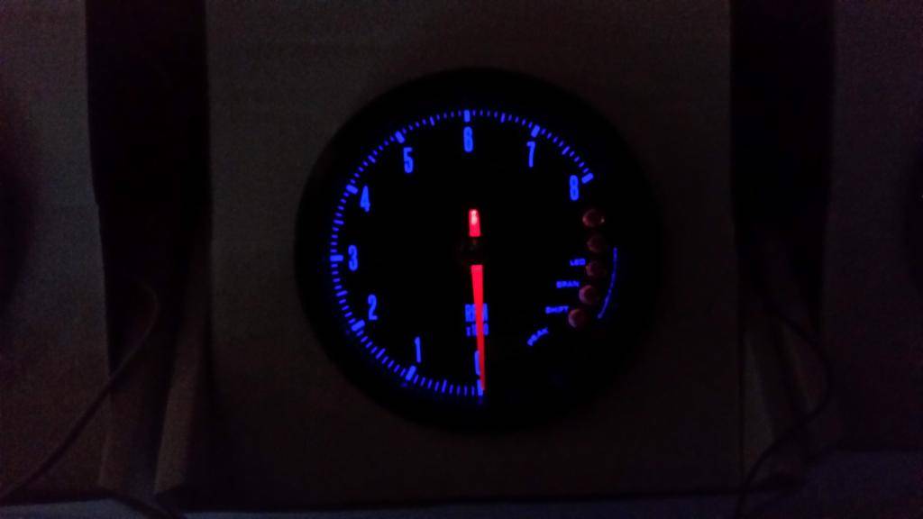

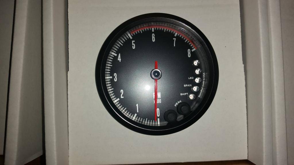

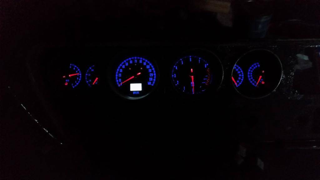

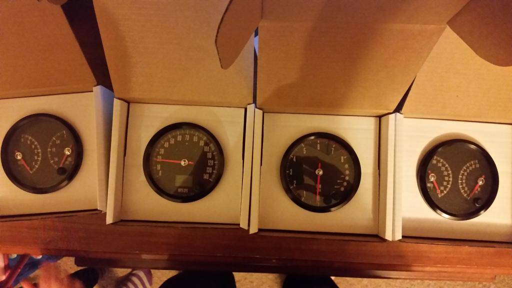

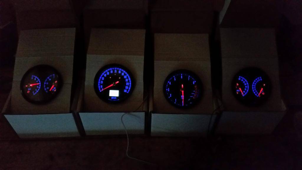

      Got my Speedhut gauges in the mail so I thought I would hook them up fast and see how they look. It took a while to get them but they are very nice quality. Iv'e seen a couple guys fit these behind stock 66-67 GTO dashes without making any cuts and it looks really sharp. Almost factory install clean. I did a Volt/Fuel gauge, 140mph GPS speedometer, 8K tach with programmable shift lights, and a oil/water gauge.
      The layout is kind of similar to that of the stock rally gauges and they come with a dimmer switch that can be mounted anywhere. In the pics the color is turned all the way up. Honestly the nighttime colors are much more bold in the pics than they look in person. I'm not sure if its a glare thing or my phone camera or what but they are much easier on the eyes in person.
      Here they are....

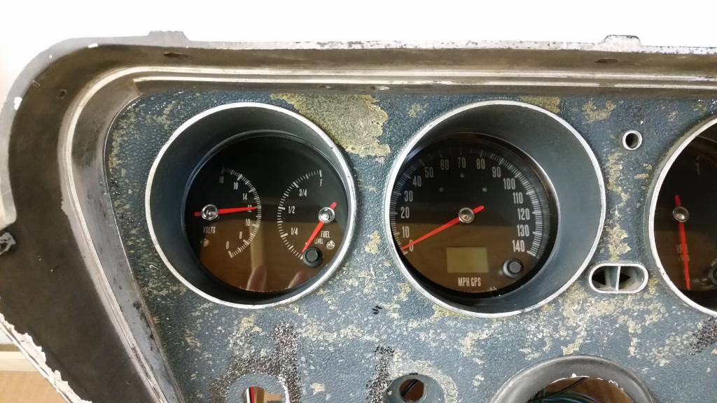

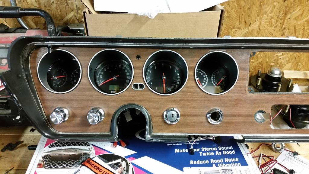

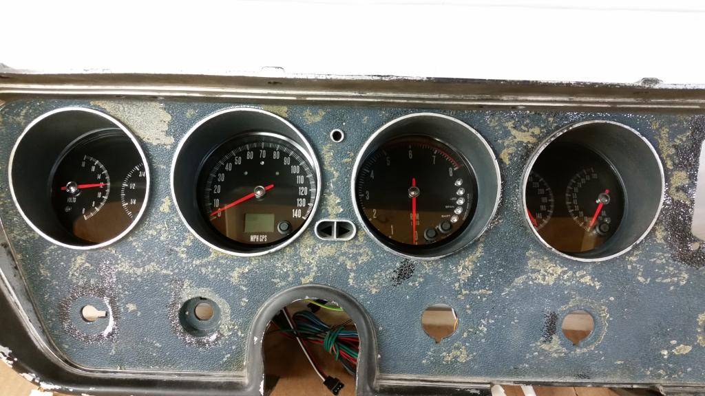

      Today I got the Speedhut gauges mounted to the dash. I'm really happy with how it came out. I used...
      -Template from Bob {Old66tiger}
      -1/4" ABS plastic from Ebay
      -3-7/8" holesaw from ebay
      -7/32 drillbit, drilled at 15* for proper mounting
      -1" #6 screws and washers to mount the panel
      I think it turned out great! Once I got everything set where I wanted it, I trimmed a lot of the excess plastic off around the edges. No sense in having that in the way. I also had to modify the metal bracket that holds the ignition switch and lighter but that was no big deal.
      Next up is spraying the metal bezel and plastic dash! I'm going to use a Krylon satin black and Spaz Stix chrome paint and see how it comes out.
      Here's some pics...

      Quote Originally Posted by Nicks67GTO View Post
      Here's some pics...
      Looks great, just a thought though from my hobby experience (scale models) you might want to use a really glossy black before the spaz stix chrome

      Quote Originally Posted by captainofiron View Post
      Really? What will that do for the spaz stix??
      -Nick
      -1967 GTO I drive and race
      -Build threads:
      it will make it more chrome like, the flat stuff will make it look powdery and not smooth
      basically like not sanding the primer before you shoot color
      Spaz Stix actually sells a base coat for the chrome, but its just gloss black paint

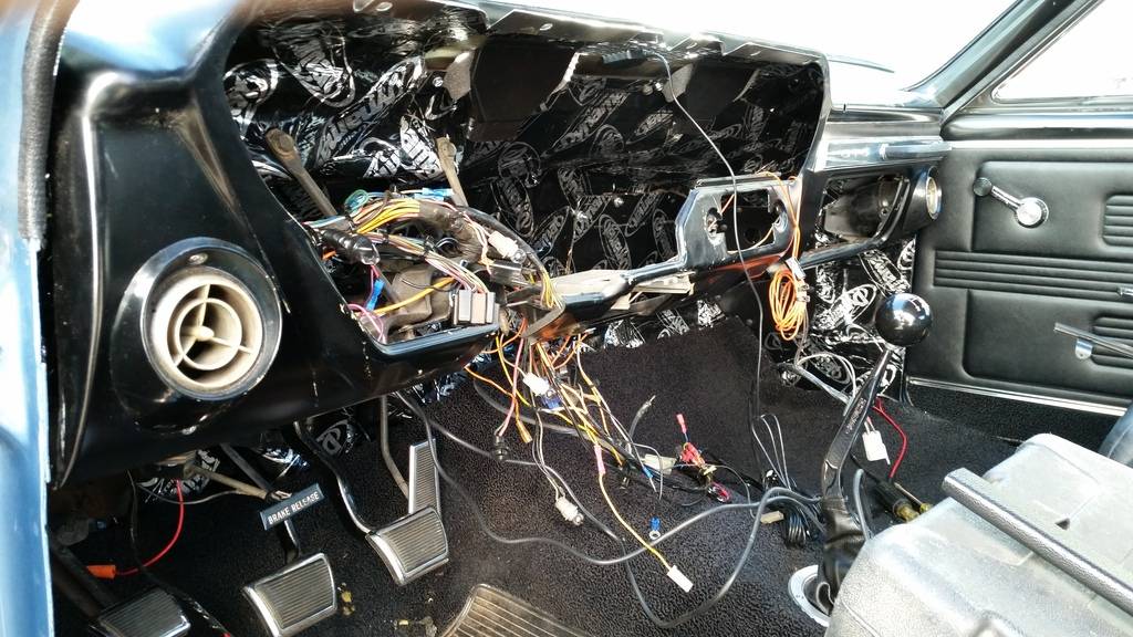

      I got a little work done today. Its really nice out and spring is here.
      So to recap, i'm installing Speedhut gauges behind the stock dash, a Vintage Air Gen IV system, a tilt column from Jim @ GMtilt.com and i'm dynamatting the under dash area. Im going to get to cracking on the vintage Air install Monday....
      Iv'e found that dynamatting the underdash area is a MF'er. It just takes a while. I bought Dynamat extreme off Amazon. I'm still waiting for my tape to get here to finish the seams but the dynamat itself goes on really easy and I can already tell by thumping on the firewall and dash that this stuff kills vibration and noise. There is no more hollow sound. Its a dead thud anywhere I tap....

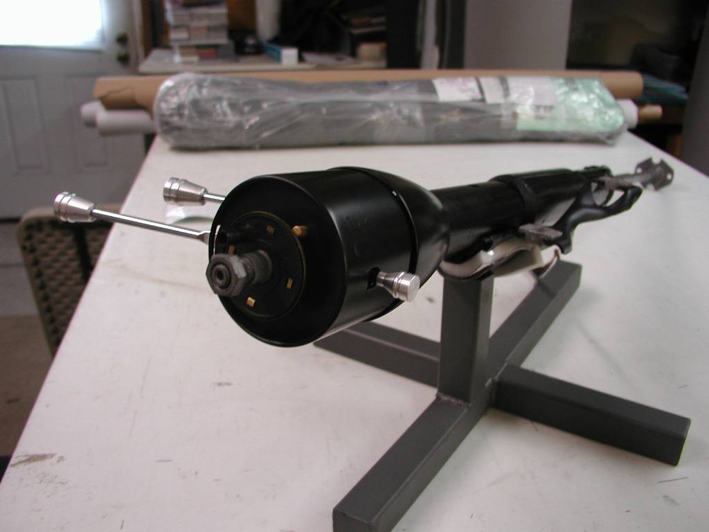

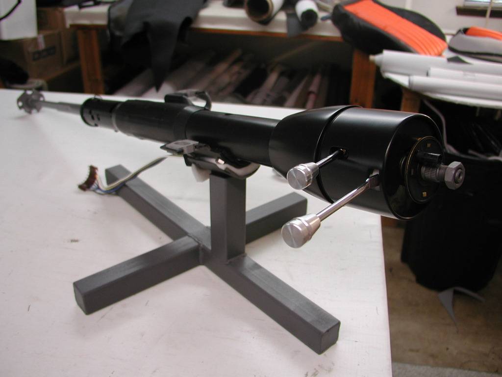

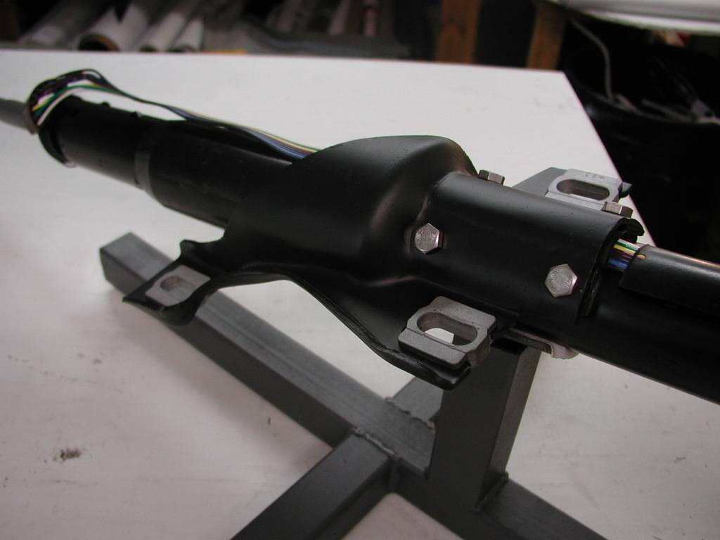

      I sent my beat up 67' stock non tilt steering column off to BirdsandBowties here. His name is Jim. He owns GMtilt.com He specializes in converting stock columns to tilt. When he does them he installs new guts, wiring, switches etc, paints the column, converts it to tilt, leaves the collapseable internals, rebuilds everything and the finished product is top shelf. Its supposed to ship out Monday. These are a few of the shots he sent me the other day....
      I also got a peek of what the dash will look like with my new gauges. Im really excited. I think this turned out great.

      The dash and column look great. Will you be able to install the VA without pulling the dash completely?

      The only thing left in the car, as far as the dash goes, is the steel structure that's welded in. I wont be pulling that but I would like to get the VA in first just for ease of install. In the VA instructions it doesn't say you have to pull the dash though, so i'm pretty sure it can be done without issue. The VA unit actually bolts up to a plate they give you that attaches to the firewall and blocks off where the heater core used to be.
