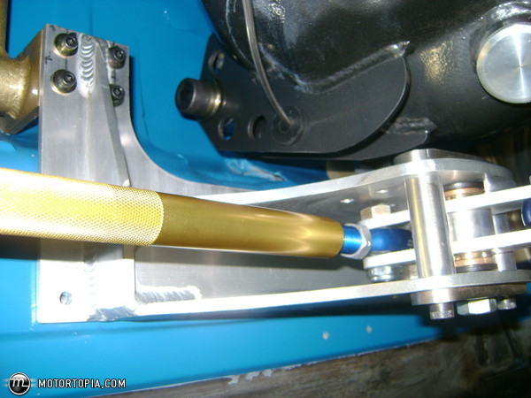

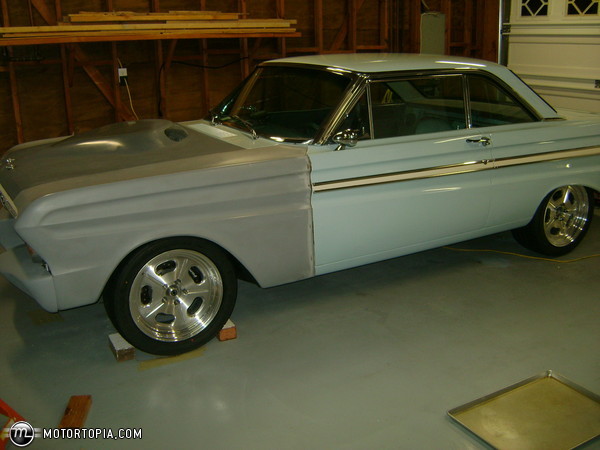

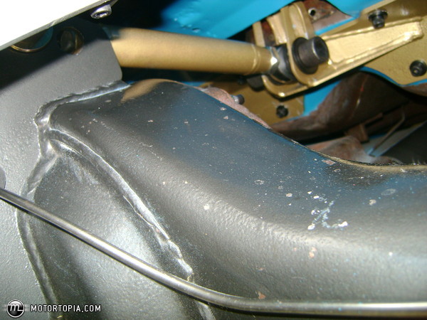

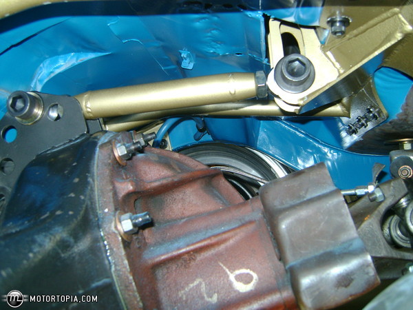

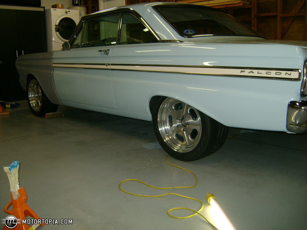

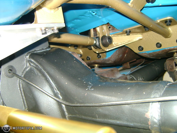

      The car is on the ground with the suspension under it. The coilovers are actually holding up my car. Im super stoked right now. It was a long evening but I made great progress. Obviously not complete, but here are the pictures.
      There is more work to do, dial in ride height, link lengths, watts geometry, UCA angle. I still need to modify my fuel system it used to be where the watts cradle currently mounts.

      Nice to see a watts link that actually has the links at the same angles. That aluminum mounting brackets is the **** too!!
      Word. Thank you! The watts system only weighs 8.4 pounds.
