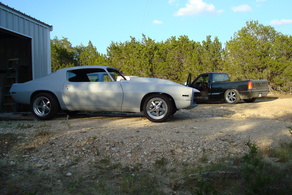

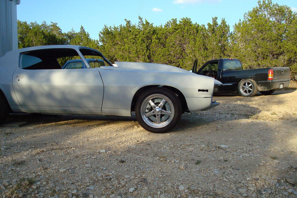

      The Car lasted a couple of weeks and then the cam went flat from him trying to start it and only run for 10 seconds while break in.. So I pulled the motor and decided I was going to rebuild the motor, the bottom end was good. So I bought a Cam, lifters and pushrods and started there.. I also Ported and Polished the heads. Well my luck sucked and the motor in my daily went south and I had to use everything for the Camaro in the 62' C10 and when I got that motor installed in the Truck it turned out to be just to much motor for a daily driver(283 bored .030 with 480 lift cam and 11.2 to 1 compression), it makes 430hp at the crank @ 7200 rpm.. So the Camaro when on the back burner while I paid off my new daily driver. I bought a 2000 GMC Sierra 4.8L V8 hoping I wouldnt get the bug to mod it.. Well, I did and this is what it looks like today..

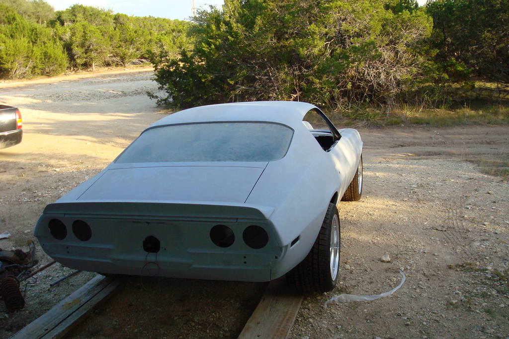

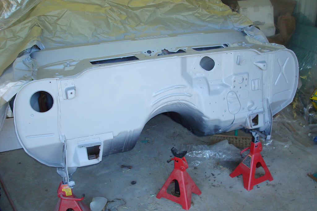

      So that took me five years and then I started working on the Camaro again..I started with repairing the windshield and back window area. Then new quarter and trunk extensions on along with some patches for the passenger quarter..
      Back Window.
