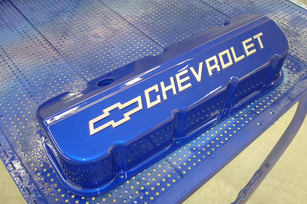

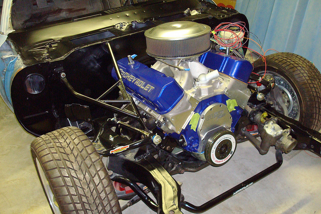

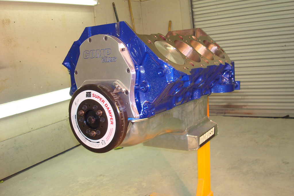

      The block and valve covers painted..

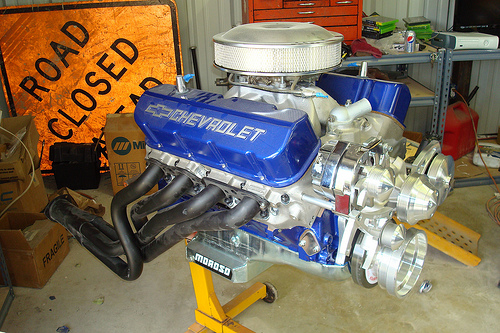

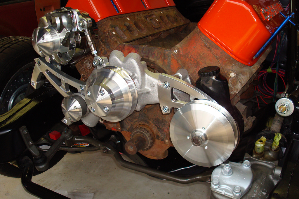

      and the mock up motor with the March Performance Kit and Hooker headers on it.. I had to swap out the 20150 power steering bracket for the 20151 bracket. It should be here sometime next week..
      Dripping Springs, TEXAS
      356
      I made the needed adjustments on my passenger G-Brace to fit the Tall Big Block Valve Covers.. I think it will work just as good as before, but now I might have to rethink where my Downpipe is going to go..

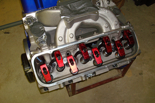

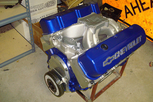

      I picked up my motor today and my Valve Covers dont clear my rockers, this is the first time I have ever heard of a valve cover hitting the side of a rocker and not clearing.. To say the least I am not a very happy Viking right now, I would just like one easy day with the %#$&ing car!!!
      Jan 2010
      Elk River, MN
      676
      Quote Originally Posted by Throttle View Post
      We had those same valve covers on one of our vintage motors, another BBC. We had to grind small reliefs inside for the rockers to clear them. You may also want to clear your valve cover gaskets depending on how close they are to the rockers, ours just got chewed off.

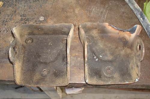

      had to modify the motor mounts to clear the headers..
      DSC02007 by throttle_junkie1972, on Flickr
      DSC02008 by throttle_junkie1972, on Flickr
      painted..
      DSC02009 by throttle_junkie1972, on Flickr
      rebuilt motor mounts..
      DSC02011 by throttle_junkie1972, on Flickr

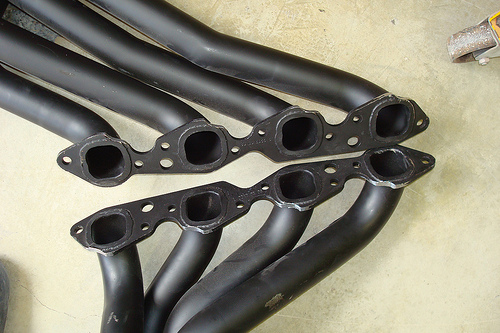

      trimmed the headers to clear my head studs..
      DSC02003 by throttle_junkie1972, on Flickr
      DSC02004 by throttle_junkie1972, on Flickr
      headers test fit..
      DSC02005 by throttle_junkie1972, on Flickr
