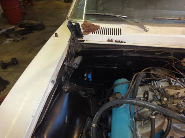

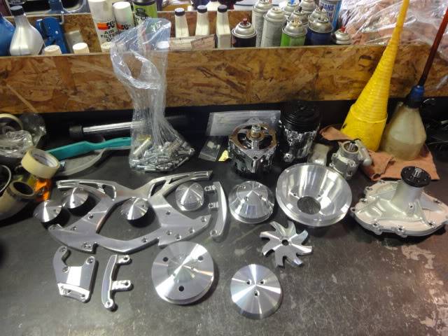

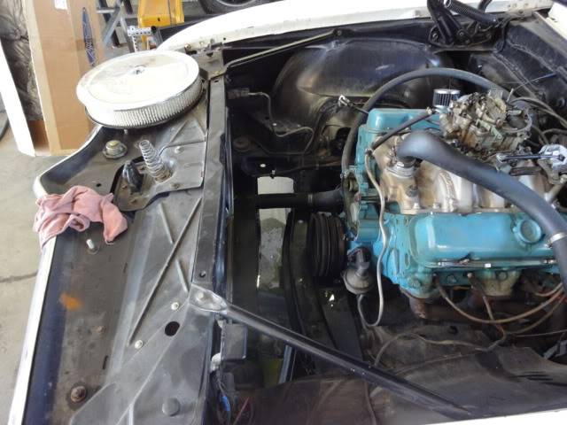

      Been workin on the 67 lately. Took all this off
      Making way for this finally

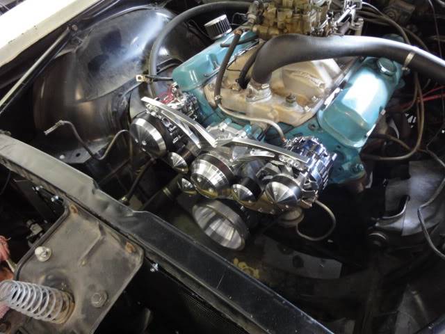

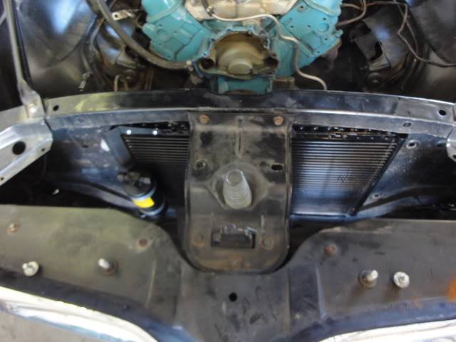

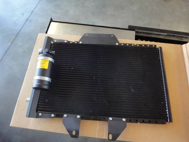

      Decided to do the AC, radiator and belt drive all at once. Condensor assembled and installed

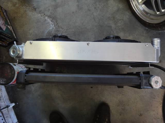

      Radiator mounting tabs are wider than the stock ones so I'm still working on making new holes.
      March set up is all in. One thing I like about this is the way the belt is routed you can use everything with or without power steering and you just need a different belt. So for now I'll run it w/o power steering until I get the front suspension built later on.

      What radiator is that?

      Quote Originally Posted by Pzary3233 View Post
      X2, really dig it. What serp sys is that, March?
    8. #88
      Feb 2006
      Idaho Falls, Id
      1,341
      Ron Davis radiator I bought used off the forum. No over flow tank so I'll figure that out later. The serp system is a March Style Track.

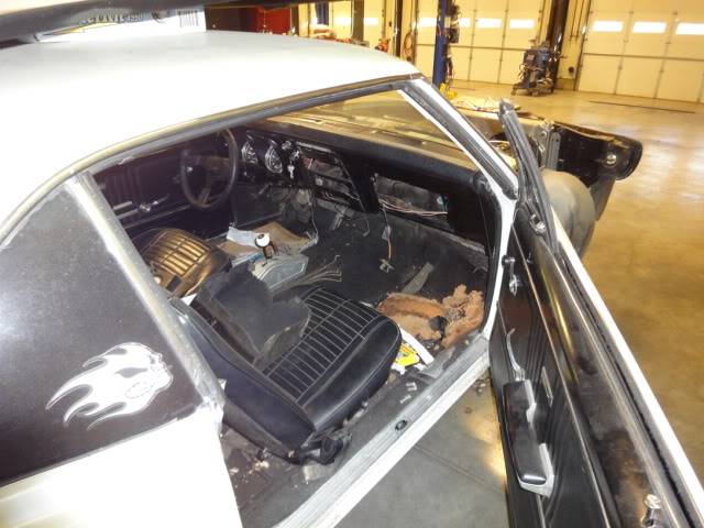

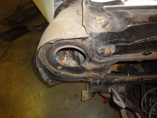

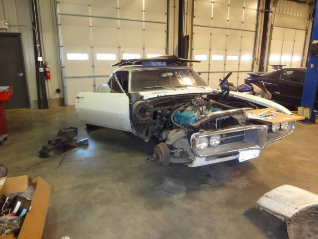

      Been busy with work and messing with my motorcycles but finally got back on my AC install.
      Took the fender off
      Don't ya just love mice? Poor little guy died in there. Musta been living there a while cause the pile of poop was HUGE lol. And I don't know where he was getting it but there was a bunch of corn in there. Musta been some bags of seed corn somewhere near by
      Gotta clean up this mess and get the new stuff in
      Traven

      T, did you had a hard time with the two screws closest to the grille when removing the fender?
      Cliff
      1968 Firebird
    12. #92
      Feb 2006
      Idaho Falls, Id
      1,341

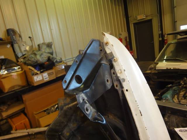

      Quote Originally Posted by CliffS View Post
      If you're talking about the 2 phillips head screws up top then yes. I had the fenders off this thing in high school and couldn't get those out so I just left the little filler pieces attached to the fender and took those off the core support
      Traven
    13. #93
      Feb 2006
      Idaho Falls, Id
      1,341
      Like so
      Traven
    14. #94
      Amsterdam,The Netherlands
      880
      Country Flag: Netherlands
      They are a pain in the ape!! LOL nice solution!!
      Cliff
      1968 Firebird

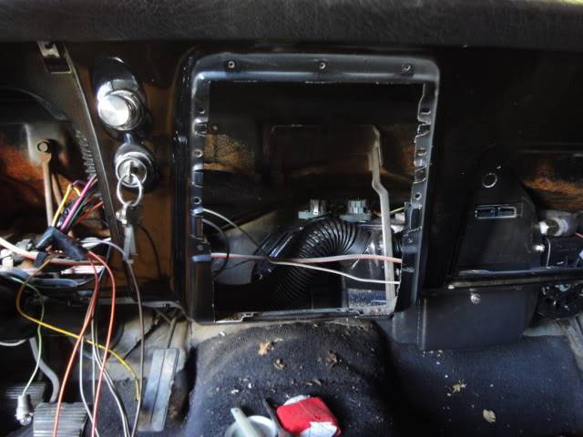

      Well evap assembly is in. Later on I'll do something fancy with the firewall

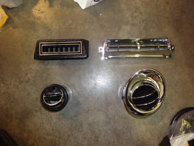

      I knew I wouldn't like the vents with the kit so I had them send me reproduction Firebird vents too, but I'm not really liking them much either.
      Anyone got any suggestions for some good looking vents? I kinda like the newer Mustang and F150 style vents. Seen the billet specialties vents but don't love those either. Audi TT vents are kinda cool lookin. If I don't find something I'll use the original style vents but I figure I'll look before I go cutting holes.

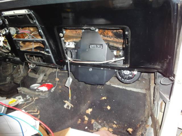

      1,341

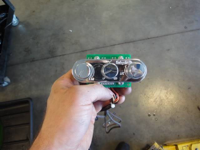

      Decided I'd cut a hole for my controller
      I don't know, think this hole is big enough?
      Traven
