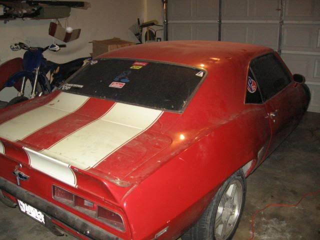

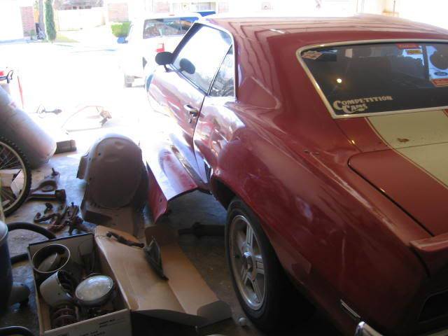

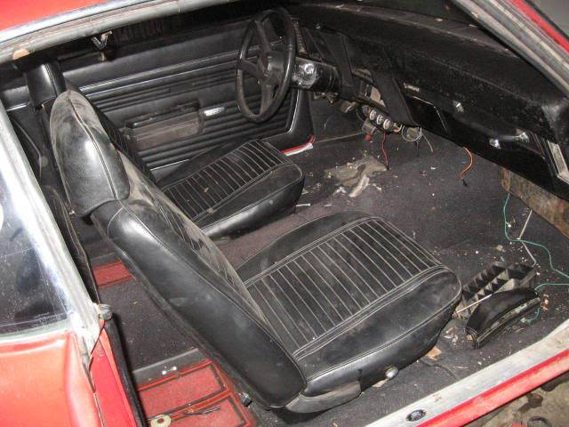

      I started a tread some time back in the LSx section, but I figured I might as well start a project thread as this thing has snowballed. I building my first pro-touring car, a 1969 Camaro with a LS1/T56. I'm 25 yrs old and will be completing all the work in my garage with a few buddies to help out. Hence the name TrialRun, as this is my first go around with a project of this cabiler. To say the least this will definitely be a learning experience for me. I sourced a 69 Camaro that I found locally here in San Antonio on craigslist.com (I love this site). Car was listed with no photos and a vague description. After emailing the seller several times I was able to check out the car two months later. The car had been sitting in his garage since 1995 and the front end and sub frame completely disassembled, motor/trans was pulled and sold. The sub frame, inner fenders, control arms and spindles were blasted and primed; seller was planning on doing a frame off. Body was still straight with minimal rust issues and all the parts were in the car or in boxes. Long story short, I came back out the following day with cash and got the car for $4,500 (I still have a grin on my face from this find).
      I originally anticipated to build this car on a budget, but that quickly went out the window once I started ordering parts, might as well do it right the first time around, at least that’s what I keep telling myself to justify all these purchases.

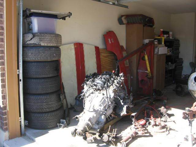

      I wanted to give a special thanks to Frank @ Prodigy and Tobin @ Kore3, these guys both took the time to answer all my emails/phones calls and explain the pros and cons of each part in more detail than I probably ever wanted to know. Here is what I have on picked up or have on order so far for the build:

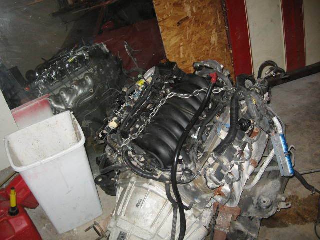

      -2000 LS1 w/4L60e out of a wreaked WS6 (auto tranny is for sale)
      -6 speed t-56
      -Stainless steel bolt kit from Prodigy for the entire exterior of the car
      -Chris Alston G-bar rear suspension w/ coilovers and weld in brackets
      -Adjustable variShocks - front
      -Hotchiks front drop springs, sway bar, sub frame connectors, front steering kit and tie rod sleeves
      -DSE mini tubs and firewall filler plate
      -Hooker long tube headers for the LS1 conversion
      -Carshop motor mount adapter plates
      -Helix tubular upper and lower control arms w/ upgraded bushings and heavy duty ball joints
      -WS6 radiator, dual fans, hydraulic system for t-56, power booster and master cylinder
      -tires are 18 x 8.5 front and 19 x 10 rear – will be running Z06 wheels
      -kore3 billet hubs
      -c6 z06 6 piston calipers, hawk hp pads, 355 mm rotors up front
      -stainless brake lines all around
      Need to order or find:
      -ls1 rear brakes
      -gauges
      -steering box and link
      -send harness to speartech
      -Figure out the fuel setup - this has been keeping me up at night
      -lots of misc stuff that I haven’t even started learning about, but I’ll get there as the build progresses
      Fabbing up:
      -trans cross member
      -exhaust
      -plate for gauges

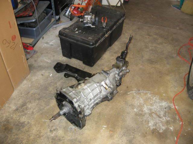

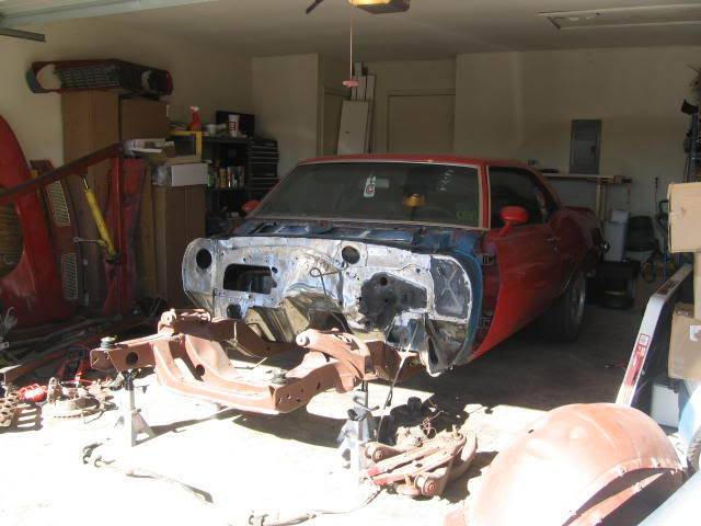

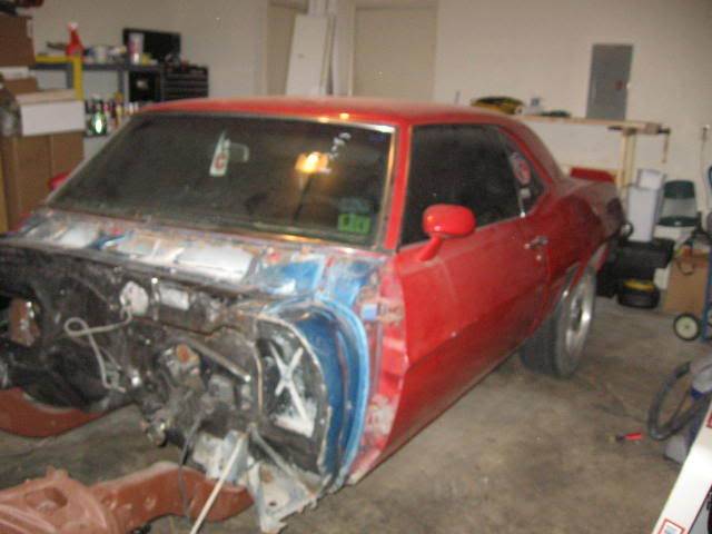

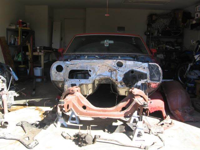

      Sorry for the long winded post, on to the photos of how the car sits as of now, more photos to be updated as the build begins:
      Thanks for looking

      Congrats, that was a good deal. Do you have to strip the body, what kind of shape are the floors and panels? Plus you now have to feed us pictures of the progress.

      L & R front floor pans, radiator support and 1/4's need to be replaced, fenders need patch panels. I ordered all the replacement panels from goodmark except for the 1/4, which I'll order once I send the car off to paint...way down the road. Trunk pan was actually still pretty solid.

      man nice start..seats look to be in great shape could prolly get decent money for them if you are going with racing seats..

      HEY! welcome to the club! im 22 and finishing nup a 69 camaro build as well. Unfortunatly my budgets a bit smaller so i went with an LT1/T56 combo as the LS1 was a lil over budget.
      This is very cool though and i will definitly keep an eye on it.
      Oh, what modifications are you planning for the LS1? head/cam package? or just basic boltons

      Thanks, i've actually been following your build too. The LS1 i'm putting in is going to be stock with the exceptions of a few bolt-ons and maybe a cam. However I picked up an extra bare block that I will be building on the side that should be a beast.
