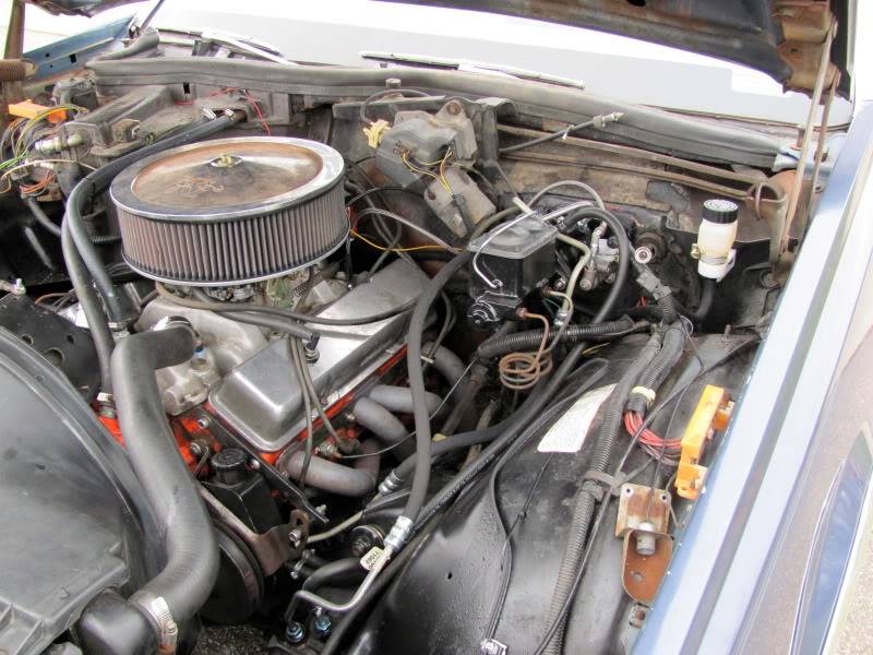

      Well I have finally driven the Caprice with the 4-speed
      Everything is finished except for an alignment.
      BUT
      the power brakes have no power assist. I replaced the New power steering pump and the NEW hydraboost unit still no power to the brakes. The power steering is ok but there must ait trapped in the hydraboost unit
      frustrating
    3. #63
      Dec 2008
      Wisconsin
      48
      The good news is the power brakes finally work. The air in the system finally worked its way out. This took between 60 and 80 miles.

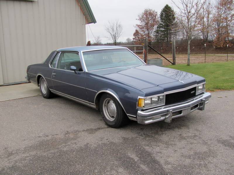

      Here are some shots of my Caprice. This has a mild 350 and a Super T-10. It can't get out of its way because it has 2.41 rear gears..... for now. It does well for mileage on the highway.
      The clutch set up and the Hydraboost are the same as in the Impala.
      This is my winter lowrider.

      Happy to report the Caprice is doing well as a winter car.
      I cut 1/2 coil out of the stock rear spring and put hoses back in
      It helps with the 350 lbs in the trunk.
      So far Dec has been an exciting month. 18-20 inches og snow last week and then temps in the -0s. I'm glad to say the aftermarket hot rod parts seem to be holding up well. .in this car I used the latest version of Howe racings stock clutch release bearing. The T-5 version is what fit behind m my stock replacement clutch and in front of my Super T10.
      This latest version is better than the previous ones offered in that it can not be over strocked. Also the o-rings are at least
      twice as thick as earlier offerings.
      For about a week before the snow/salt hit here in So Wis I was able to drive the Caprice and the Impala back to back
      Kind of like having sisters.... similar yet so different.
      I guess the Caprice is like the slower slightly retarded version
      of the Impala. Still its cool havin a beater with a Hurst shifted 4-speed and headers/flowmasters. Almost makes winter ok. And whiping dounuts is too cool.
      Future plans for the Caprice involce 3.08 rear gears and a posi unit.
      As for the Impala
      Winter updates will probably include a Hurst shifter for the T-56 and an update for the rear control arms.
      Right now I' m looking at the Global West lowers. They dont offer an upper yet but they have uppers for the '73-77 A bodies which may work
      will need to check into that.

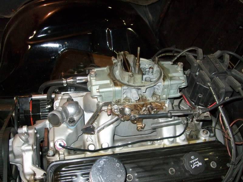

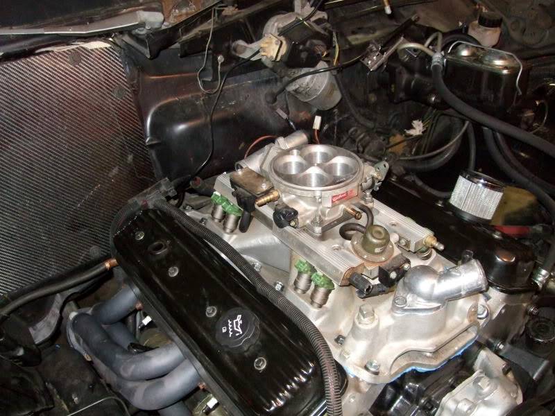

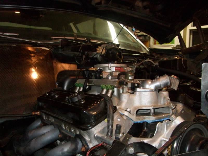

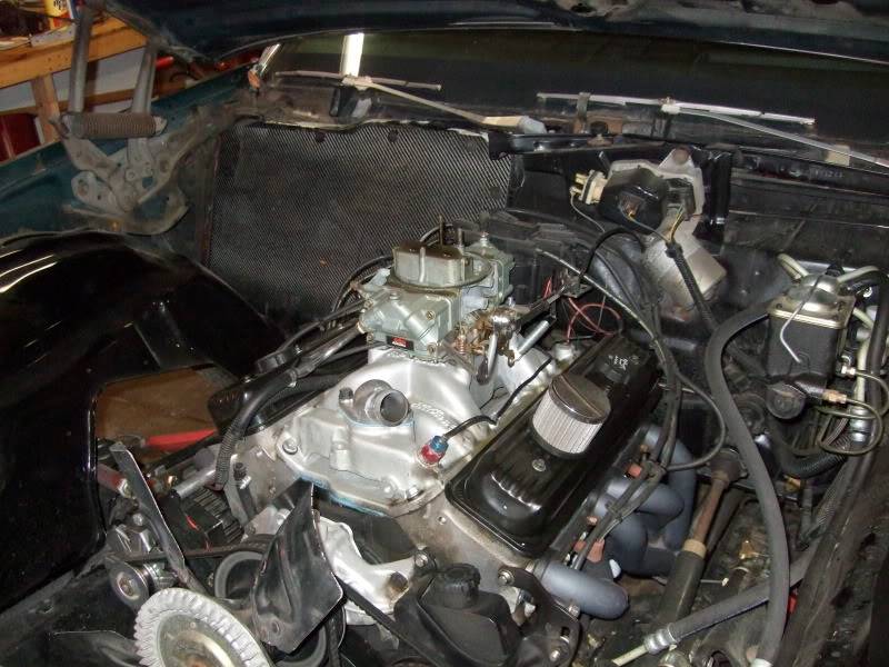

      Here are some pictures of the Pro-Flow intake as we removed the old and sealed it up with the new. The system is really straight forward. It only takes 2 wires from the fuse box to make this happen. A constant power and a keyed ignition wire. If I hadn't had the LQ4 for my Nova I would still have this on a small block in there.
      Before:
      After:

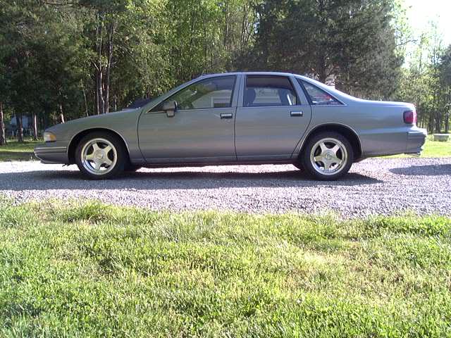

      just a note, Next time you reseal the intake,Not sure if you have done it already, but pick up a can of Right Stuff sealant from permatex It looks like a squeeze cheese can Works 900X's better than regular RTV.
      Also you might want to try some MOOG CC627 rear springs, They are a cargo coil for a g body. and alot of impala and 94-96 caprice guys use em to lower the rear of the whale caprices and still be able to haul stuff in the trunk.
      Compairo from My 94 I used em on
      Before 1 coil cut off the front 9C1 coils stock rear springs
      After the 627's
