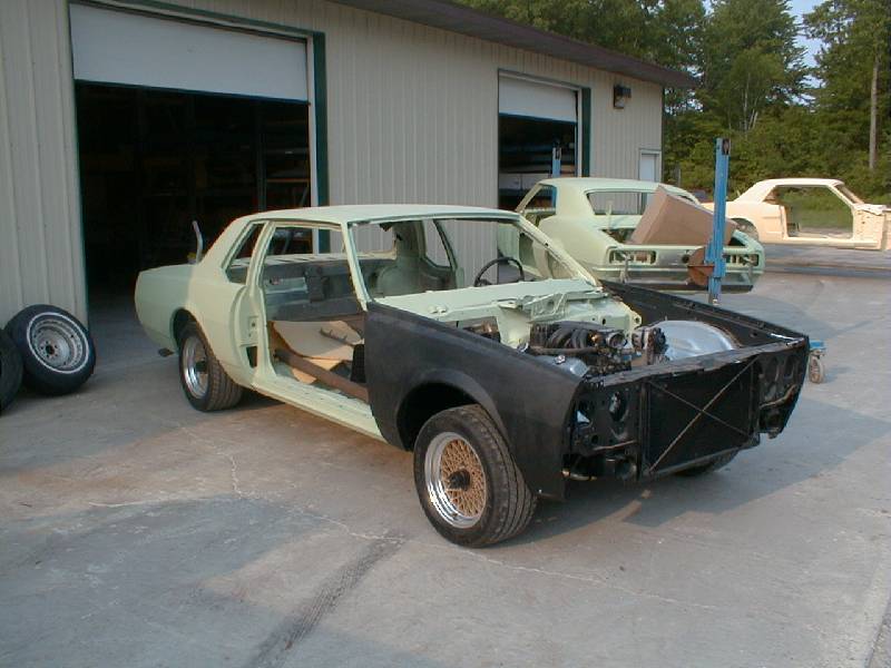

      This is cool as heck, not sure how I'd missed it. I've got a '77 Caprice coupe that's been in the works since about '98. Here it is in '01, and more or less how it still sits:
      I really like how you've got it sitting. The stance and wheel/tire combo gives it a really tough look. Can't wait to see how it comes together.

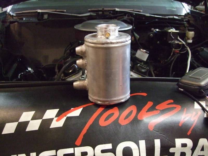

      will be working on the Imp this weekend. I have a new tc style steering pump from unisteer and need to measure for the AN lines and the placement of the remote tank.

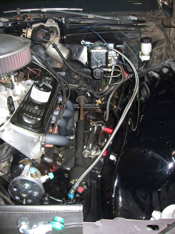

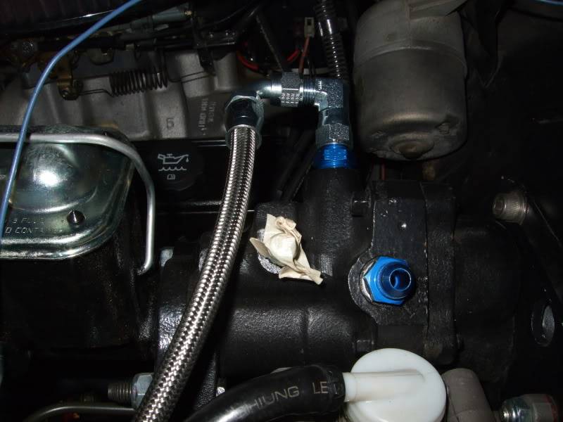

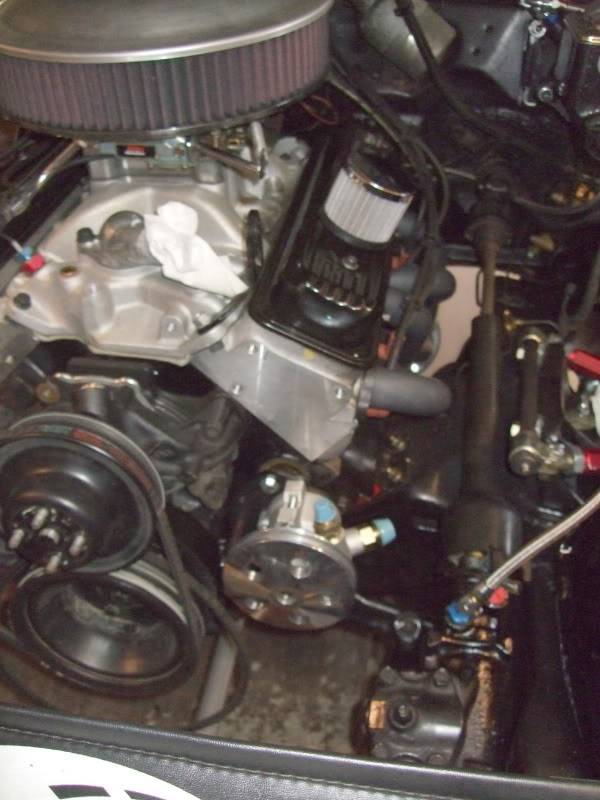

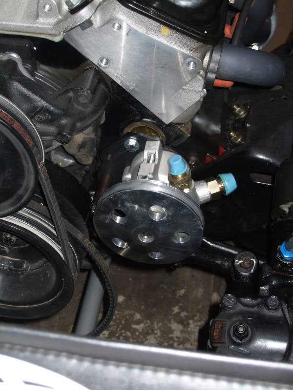

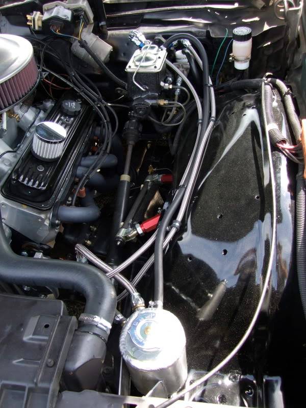

      I was down at Matt's yesterday and grabbed a couple shots of the new Type II power steering pump, reservoir and braided lines.
      I'm sure he will be along soon to post comments.

      in the pictures it looks like the braided line is run to the wrong port
      Don't worry its only mocked up right now
      This weekend I will finish up the plumbing and swap
      the intake on the ZZ4. I have an
      Edelbrock air gap performer RPM which shoul be good for 20 hp over the stock ZZ4 intake. Other than that I'll leave the ZZ4 alone. I have a 4 bolt 400 block and crank and one day it will live in my Impala.

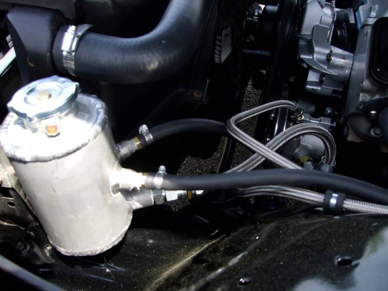

      Here are some pics now that Matt's Impala is back on the road.
