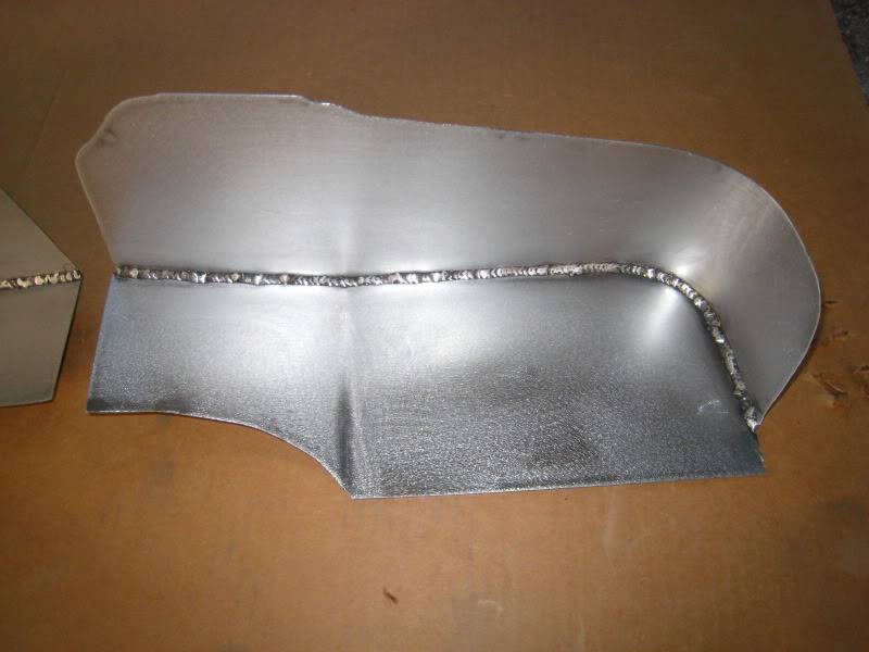

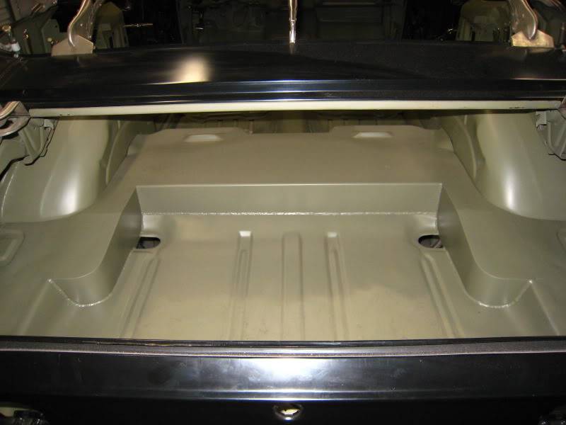

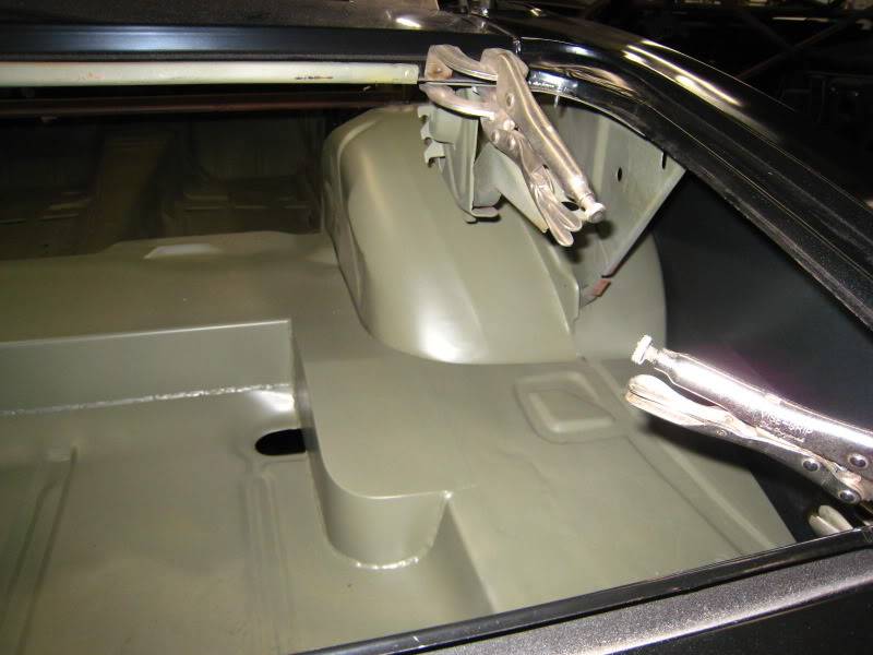

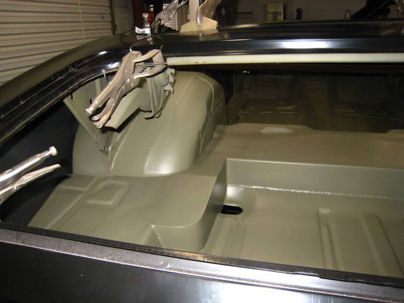

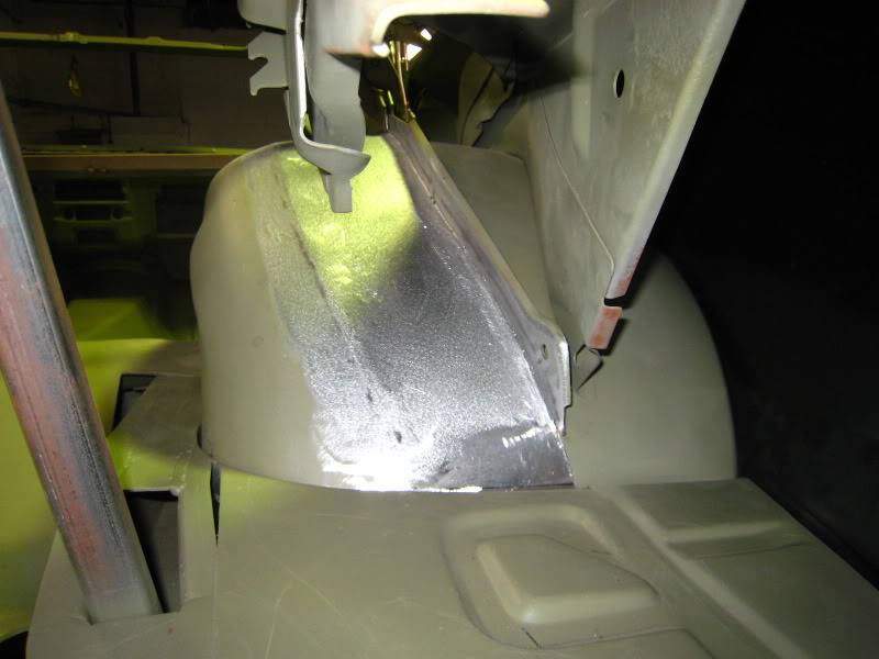

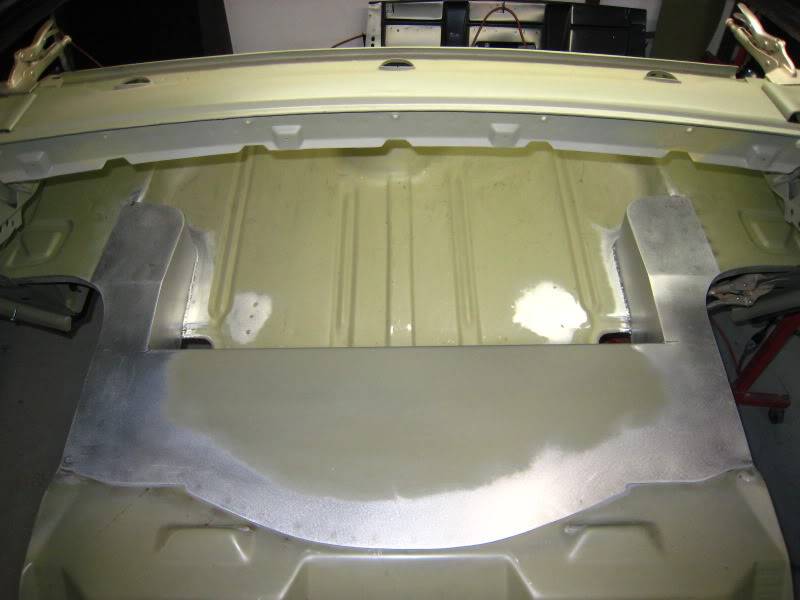

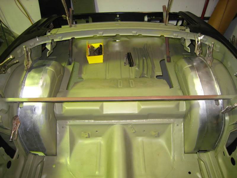

      67spedfreak, I'm doing a 67 vert along the same line as your, my body is not as bad. I'm interest in the suspension, your metal work, and all the choices you made in your project. Why did'nt you use mini tubs? why did you box in the trunk? maybe to have more room for the axle? what are the boxes on the side of the inside of the trunk? I'm just starting my project.

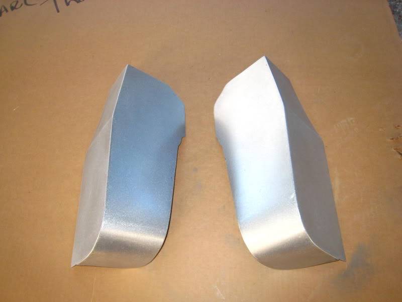

      The frames raiils in my vert are Custom by Mikes custom cars. I made my own tubs because it was a 4in stretch over stock and the DSE tubs are only 2.75.
      The closeouts in the trunk cover the narrower frame rails. And yes I modded the trunk floor for more Room for Plumbing and exhaust and stuff.

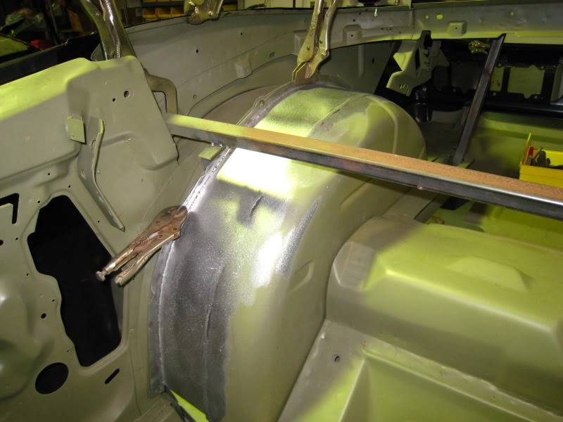

      Well I made some time to work on the vert !
      I am in the process of building a custom rear suspension.
      Here is a pic, not much progress yet but I think it will be pretty cool !

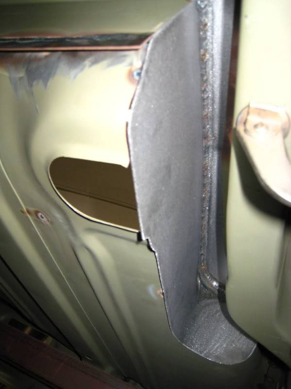

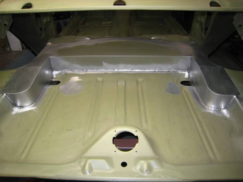

      After removing the bulkhead I capped the frame. I am basicly raising the frame and adding a couple crossmembers for upper fourlink mounts and a shock crossmember.
      Here is a picture of the frame extensions I am building.
