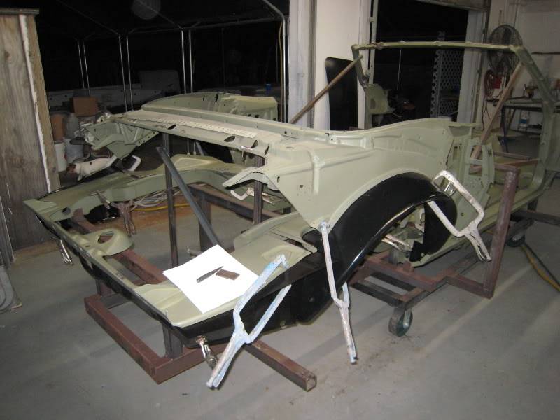

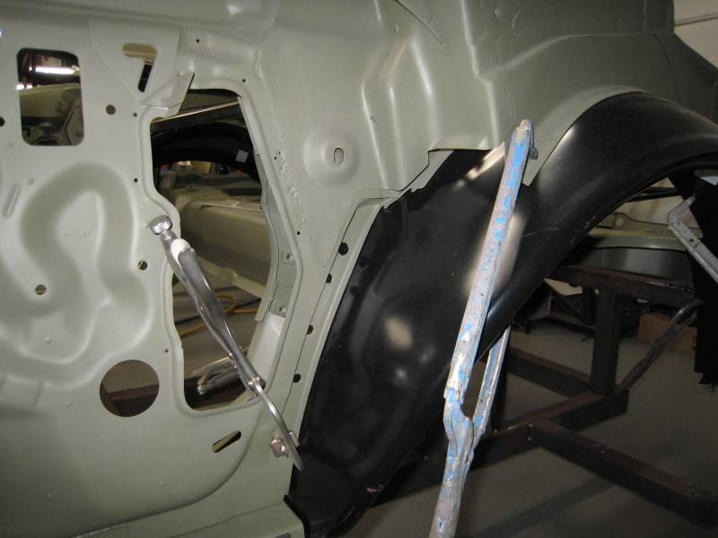

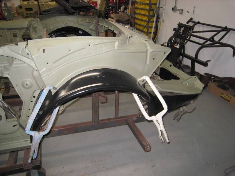

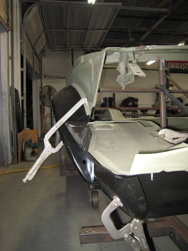

      We started fitting the quarters and tail panel today.

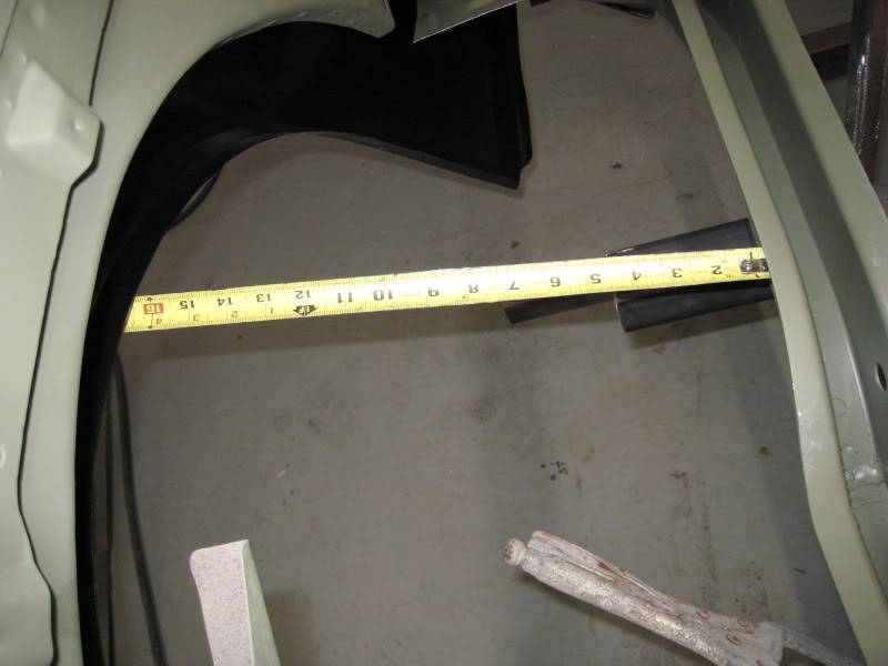

      After finding that the reproduction trunk floor was 3/4 to short I wanted to be sure we had our front to back measurement right before welding the trunk floor, rails and floor.
      I'm pretty happy with the fit but with most repro parts it's going to need some tweaking.

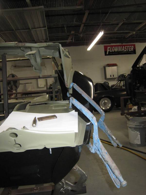

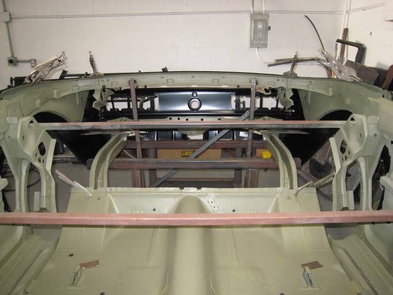

      couple more
      Lots of room for 355/19 meats

      They look like they fit good. Wow thats a lot of room.

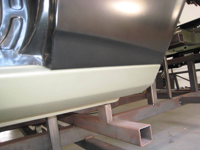

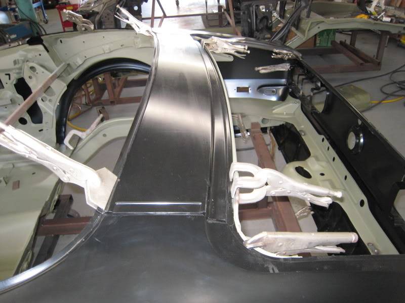

      Fitting outer wheel houses and drop offs.
