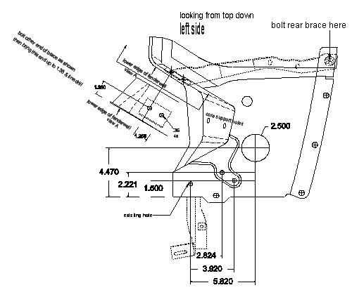

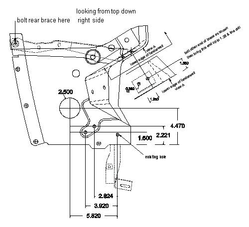

      I just did this but am not finished and did it on a budget. I was able to locate good GM used Rt. & Lf. capsules for $300.00 including chrome grilles. But if you buy 2 new ones it will run about $350.00 for repros and you will need 2 chrome grilles for $120.pr., a RS grille about $170.00, RS fender adapter brackets unless you have RS fenders currently $25.00 to attach the capsules, the back of the capsules attach where your current housings do on the radiator support. I do not currently have the DSE motors and just manually operate them for now. I removed the bellcrank part that hangs down so I did not drill a hole in the inner fender which is where that hangs through. It was easy to install by just looking at the parts once you have them. I will post some pics of what it looks like later.

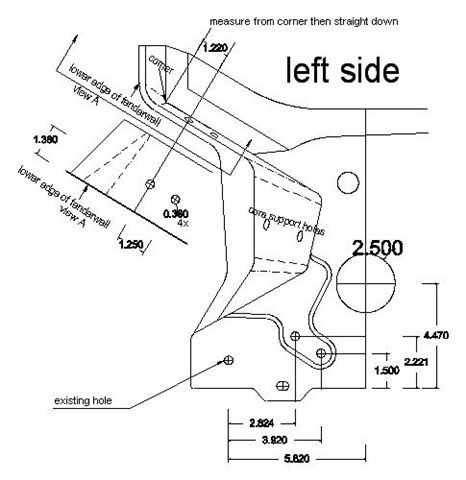

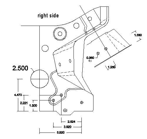

      Here are some templates if that helps Jeff.

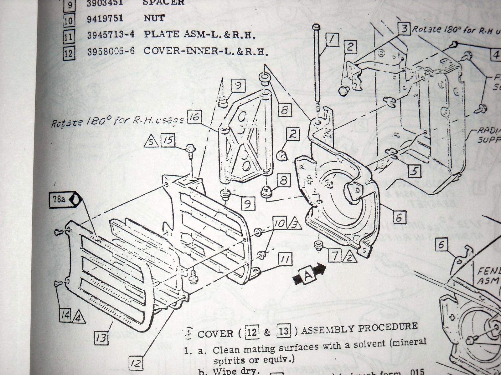

      These assembly diagrams may help.
