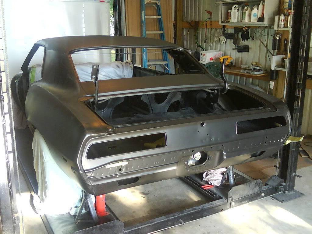

      Hi Guys,
      I have some of the major bodywork complete on my car and the entire thing has a coat of dp90 on it.
      I am wondering if I can do the bodywork over the next month or so and then prime the whole thing. I am looking to do the tailpain this weekend, quarters next, roof, etc. and then prime the entire car.
      Is it safe to leave the bodywork without covering for around a month or so?
      Here are some pics for reference...

      By the way... i plan on using all metal on anything deeper than 1/8" and rage gold on the minor areas. Some of the car will be then covered in glaze and blocked out.
      1,027
      as long as the car is under cover and see's no moisture then yeah you can leave the body work open, if your nervous just dust a coat of dp90 over it
