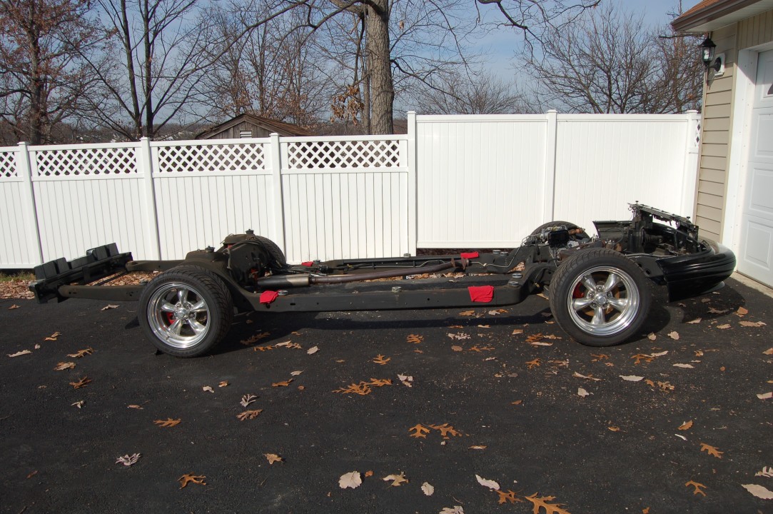

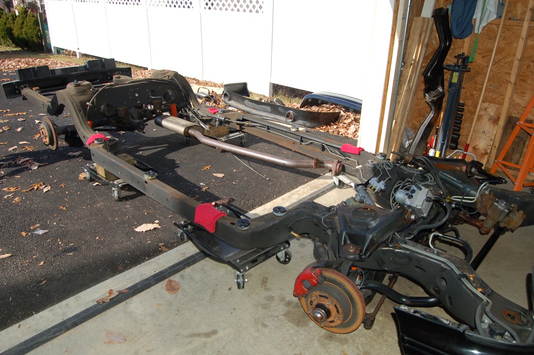

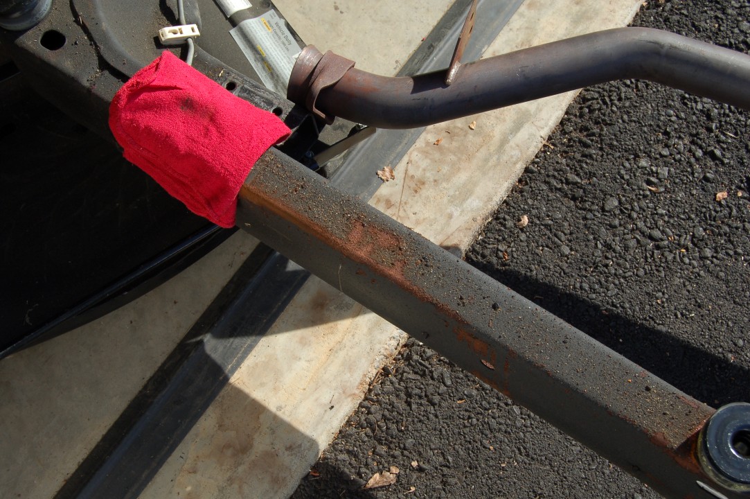

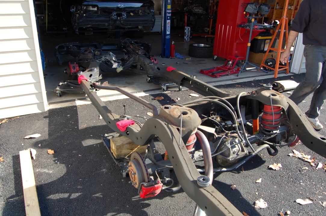

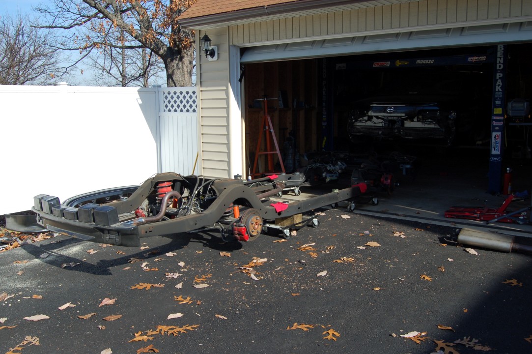

      Here are some more photos of the frame after removing the body.Name:  1.JPG
Size:  259.9 KBName:  2.JPG
Size:  293.8 KBName:  3.JPG
Size:  254.8 KBName:  4.JPG
Size:  303.3 KBName:  5.JPG
Size:  273.9 KBName:  6.JPG
Size:  300.8 KBName:  7.JPG
Size:  293.5 KBName:  8.JPG

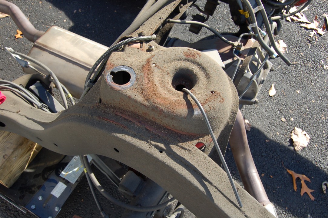

      Hey dont knock that waxy under coating if the manufacturers went BACK to using it these newer cars wouldnt be rusting in areas the dont need too. The yshould at least make it an option,,,I see cars and trucks that are severely rusted and ones couple years before that are coated and look factory fresh.
      Cool car though, inline tube also sells brake lines, honestly I always preferred doing my own, I am a tech an bought a hydraulic flaring tool and hand bend my own lines as well as customers cars too.
      I got an email yesterday from Summit Racing that the Classic Tubes brake lines will be here on Tuesday. Heading off to the garage and getting to work.
      Lee - I used to have a 78 Monza HB that I put in a SB 350, but it went to waist (rusted) after years outdoors. I wish I was building that car up instead of the Impala SS. I agree that the "wax" does a great job at the beginning, but it dries up and then rust starts, just see the above photos.

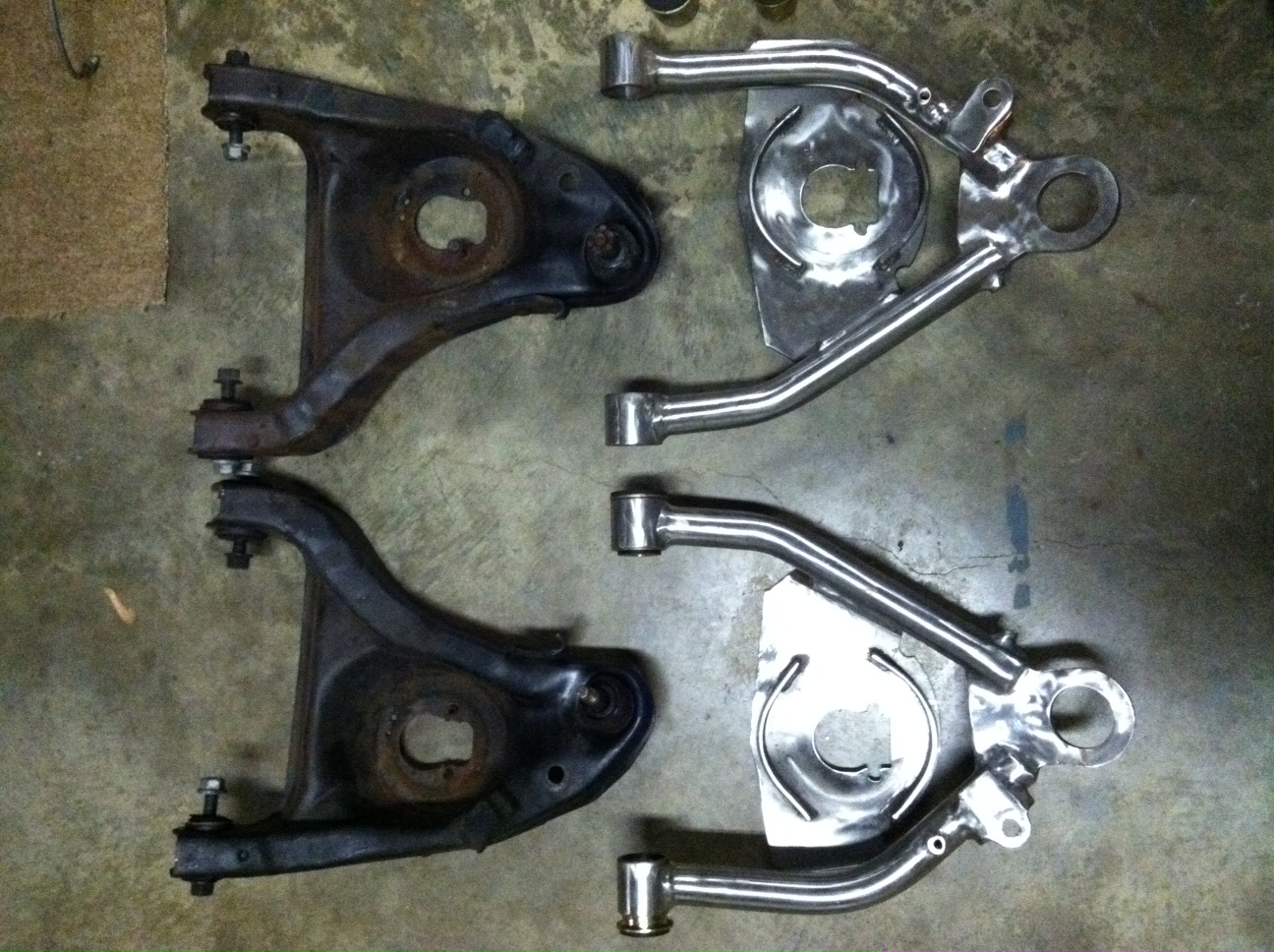

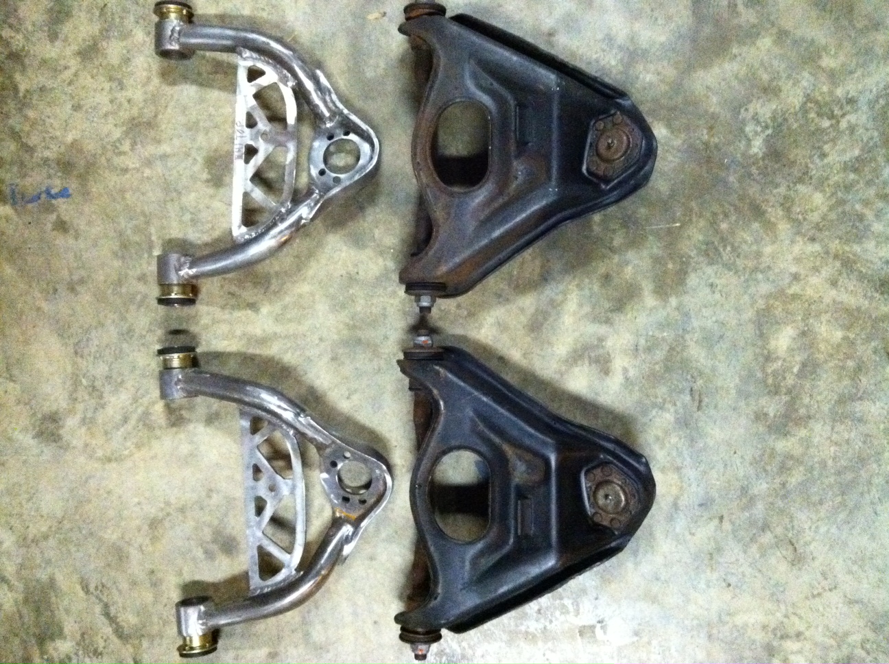

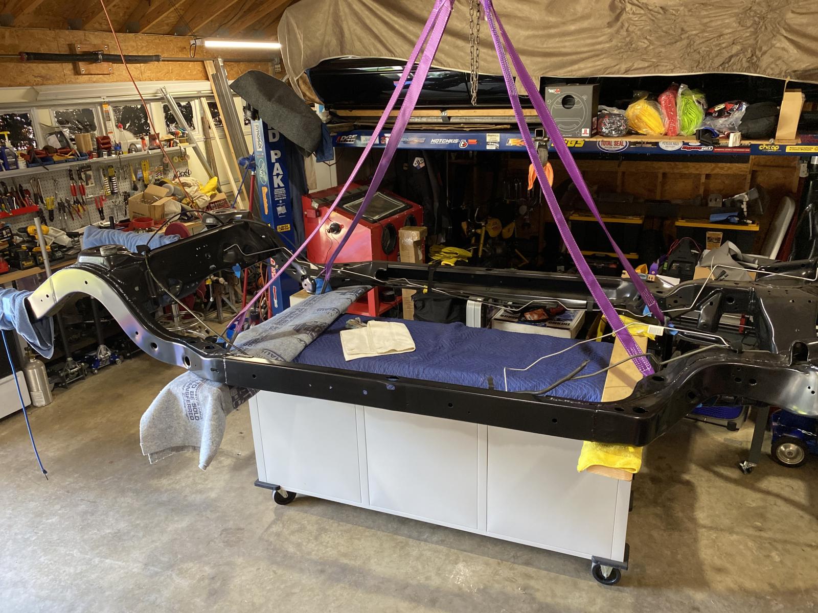

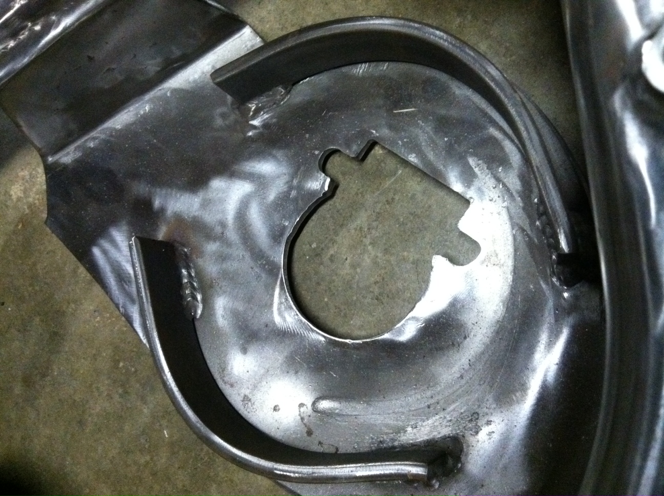

      Here are some photos of the my custom tubular control arms. .Name:  UpControlArms.JPG
Size:  629.2 KBName:  LwrControlArms.JPG
Size:  574.7 KBName:  LwrShockBase.JPG

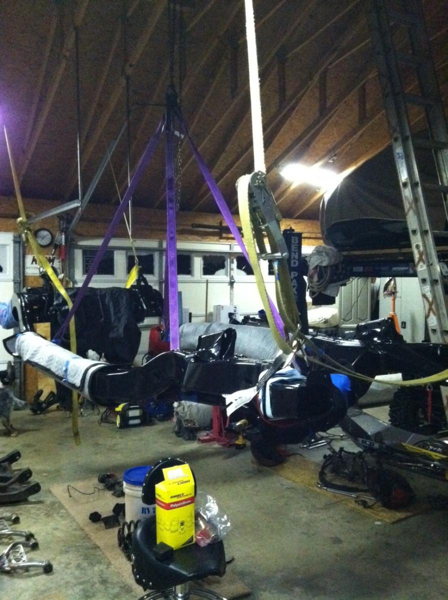

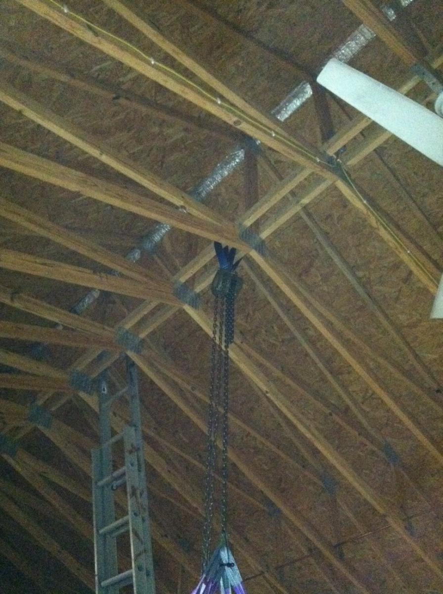

      Also two pictures of me transfering the frame over to a hoist from some temporary straps.
Size:  152.0 KBName:  GarageHoist.jpg

      Quote Originally Posted by SSTuner View Post
      I have never seen a car that had vented rear rotors, most always they are solid. pretty cool.

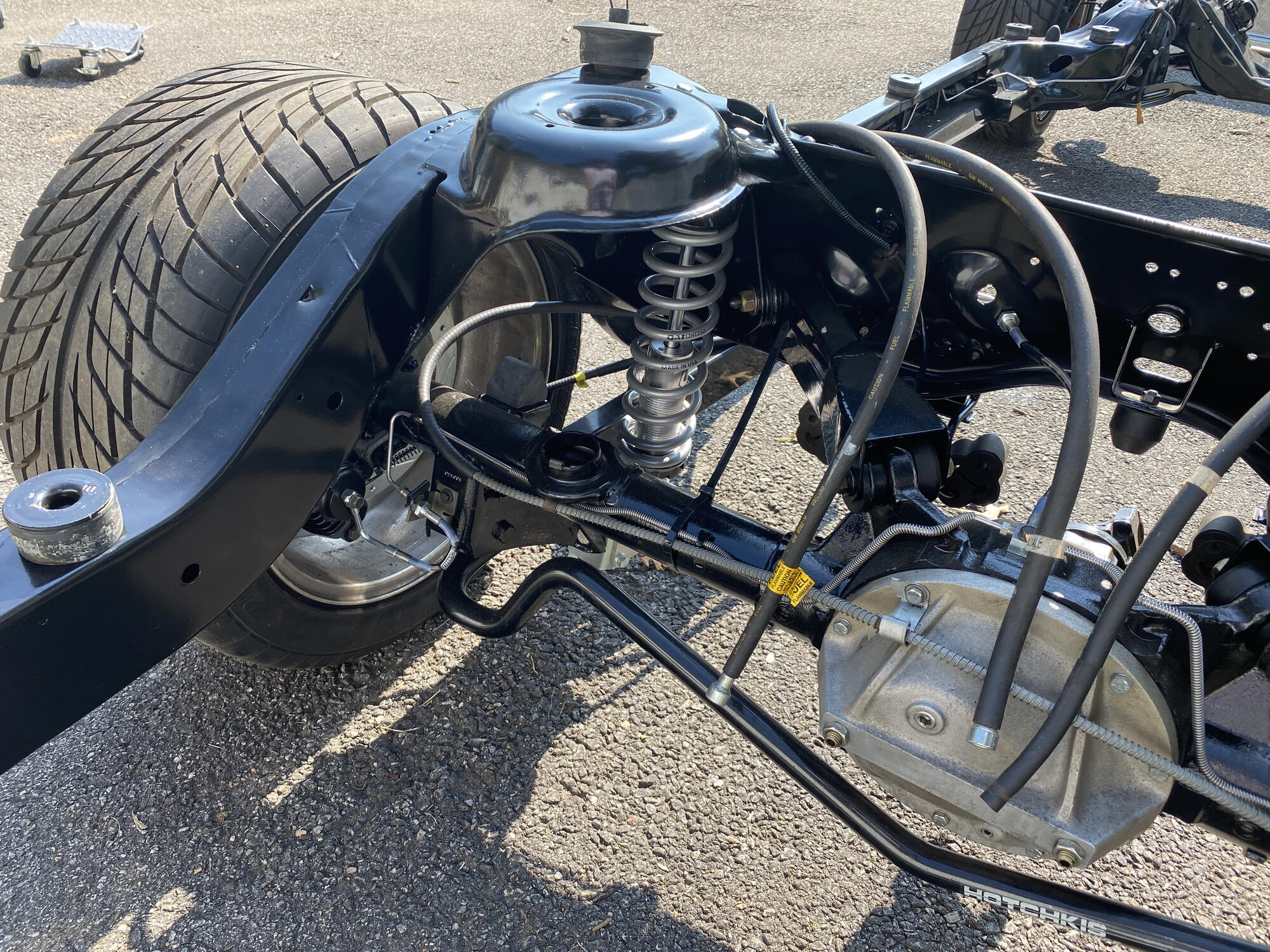

      Believe it or not I'm finally putting "Mistress" back together after all these years. Here is a photo from yesterday. Just ordered a complete QA1 suspension system. More photos as I progress.

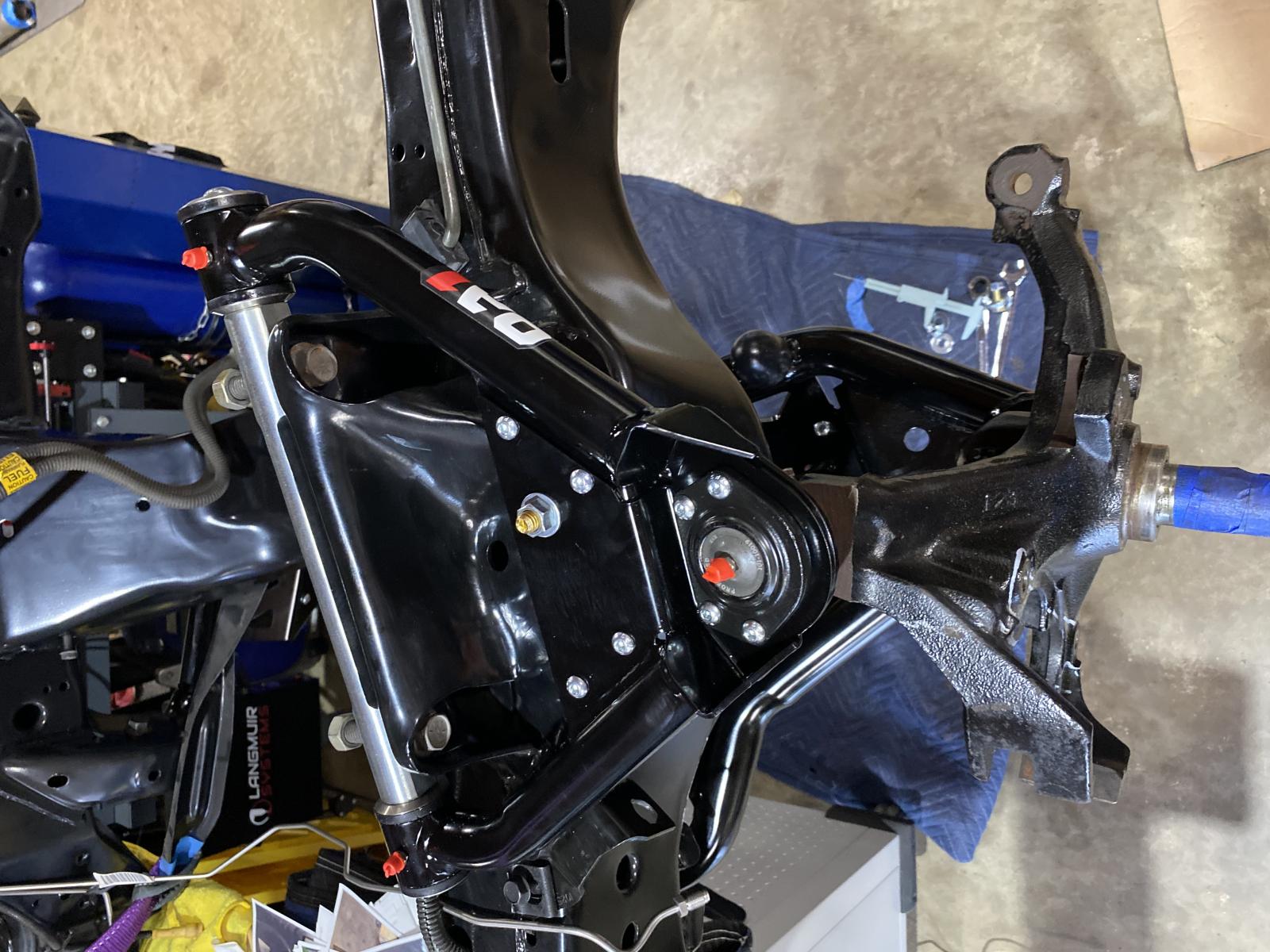

      Received the QA1 front control arms and here is a photo of the test fitment. Still need to cut the spindles and drill them to accept the Kore3 adapters.

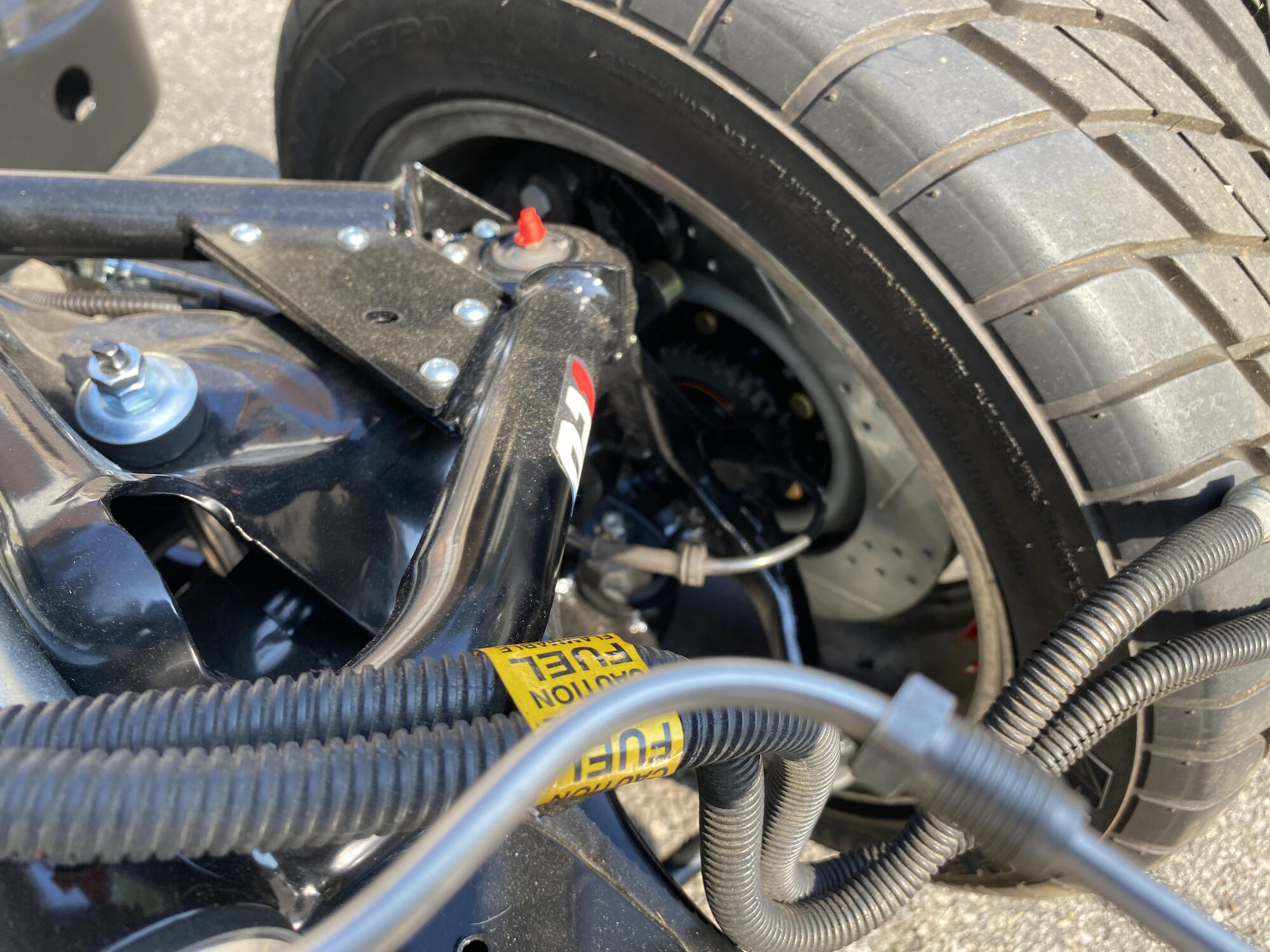

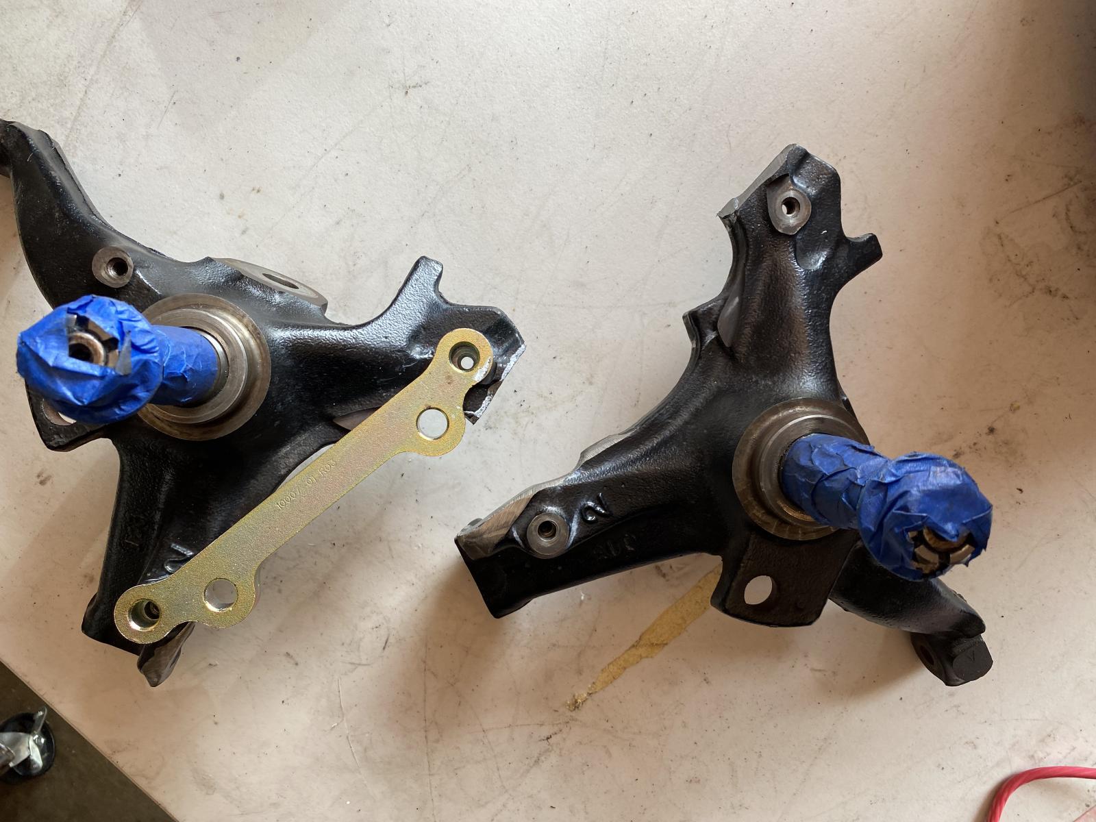

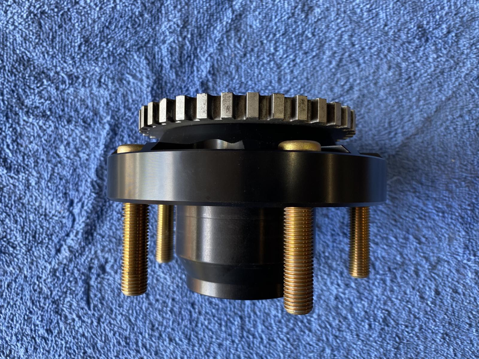

      Updates: Installed ABS Toner rings on KORE3 Hubs, modified spindles for C5/C6 caliper adapters.

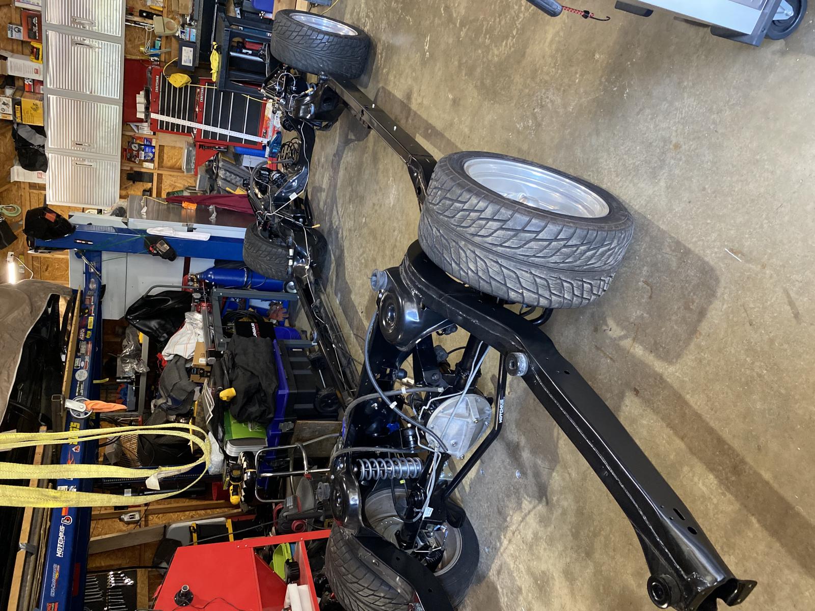

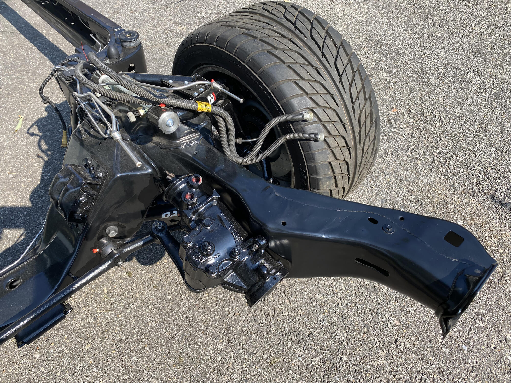

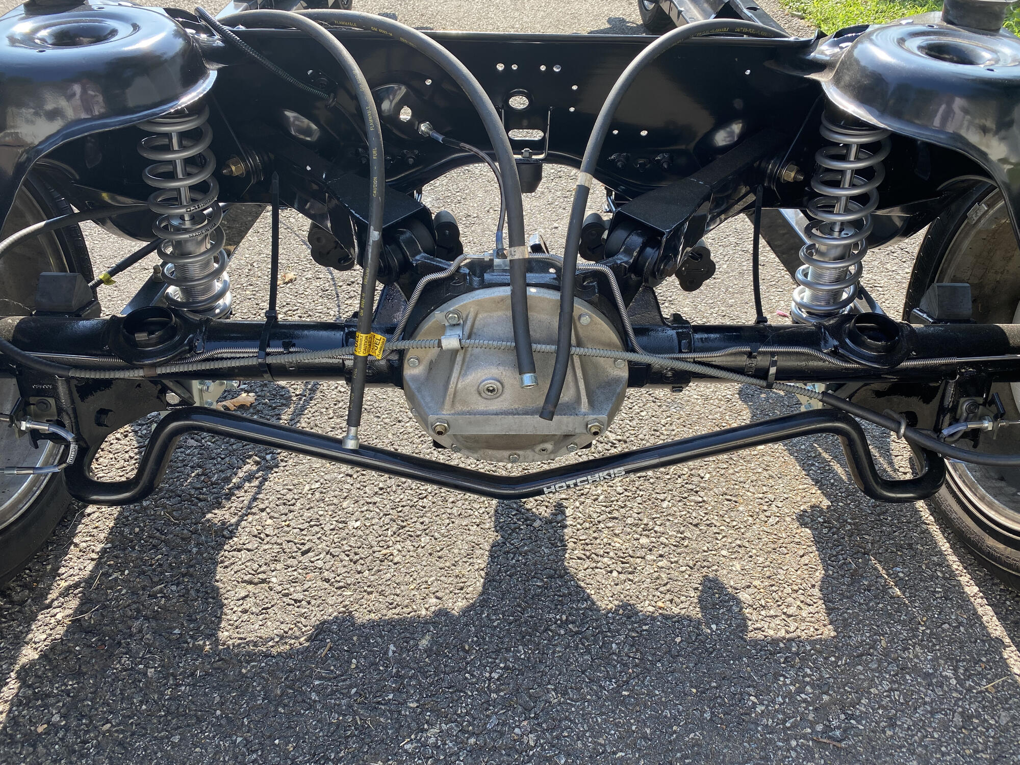

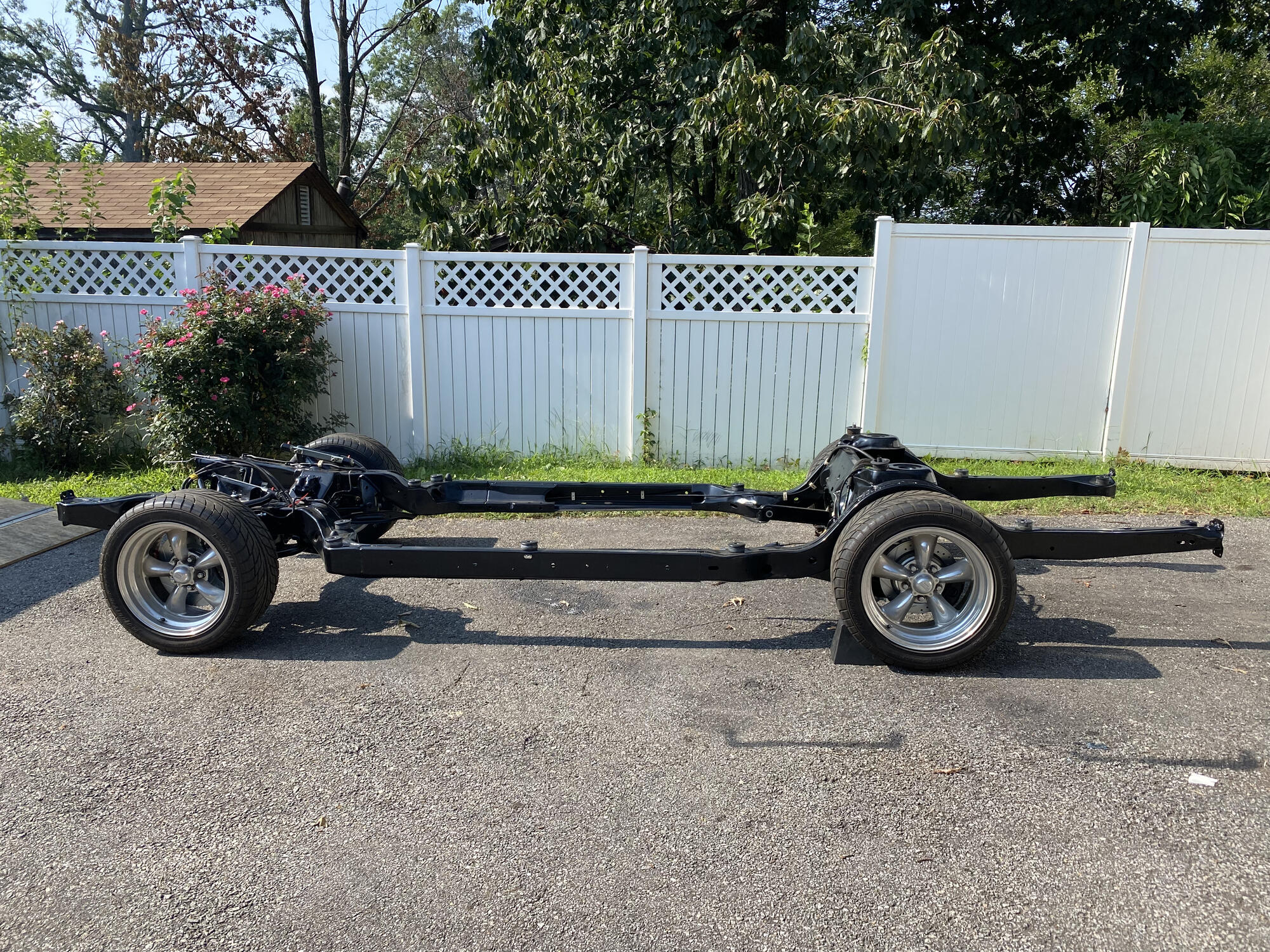

      Finally, Mistress is on her tires

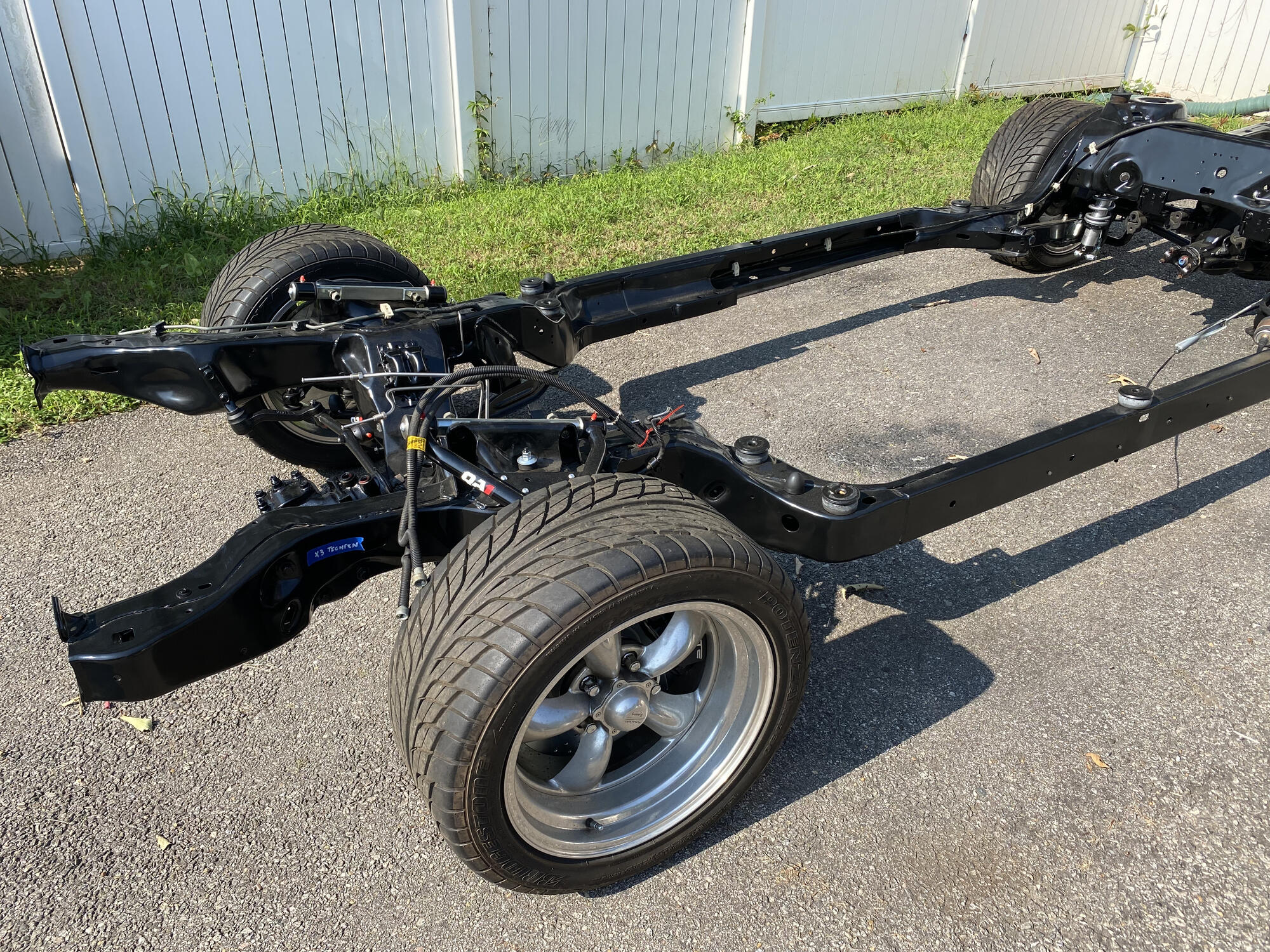

      "Mistress" is out of the garage for the first time after 17 years inside. Soon body will be installed.
