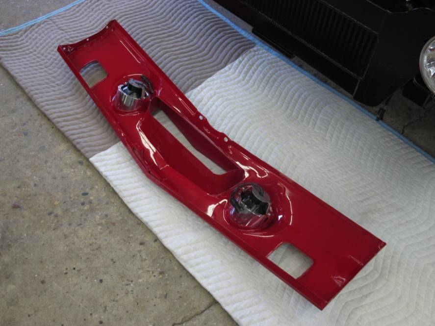

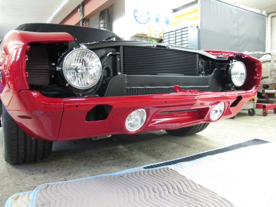

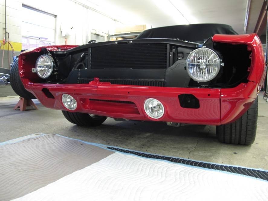

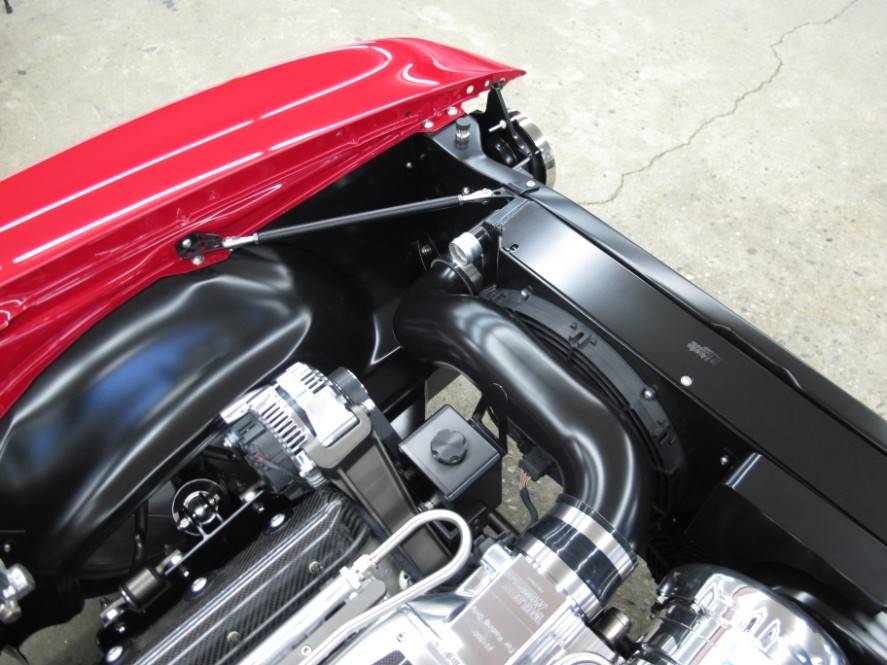

      Here are few more with the right finder on. We also got our custom one billet power steering reservoir all in stalled. I have the header panel, lower valance panel and cowl panel all ready for paint so I'm hoping to have that stuff painted real soon.

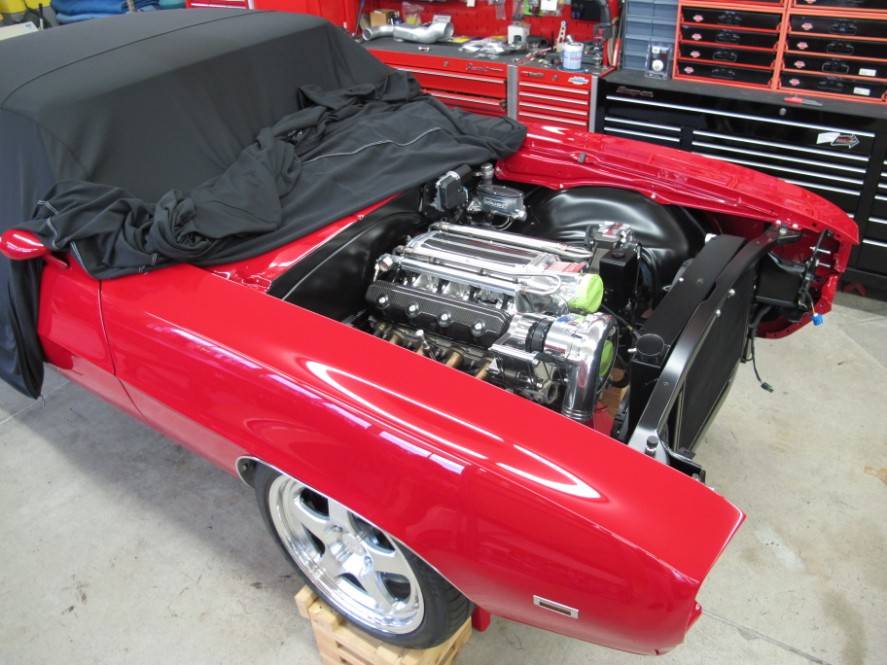

      Seems like I've been able to keep the momentum going and I'm getting stuff done. I don't have much to do in the engine compartment. I took the car over to the interior shop to have the headliner installed. Now we can finally install the windshield, rear glass and all the stainless trim.

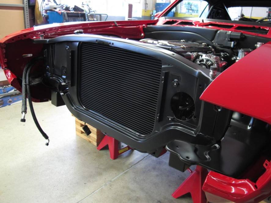

      Quote Originally Posted by Jamess113 View Post
      Hi love the build the car looks unbelievable just wondering about the ac hoses are they got covers or are they the actual hoses
      Cheers nick

      Quote Originally Posted by wiked1 View Post
      Cheers nick

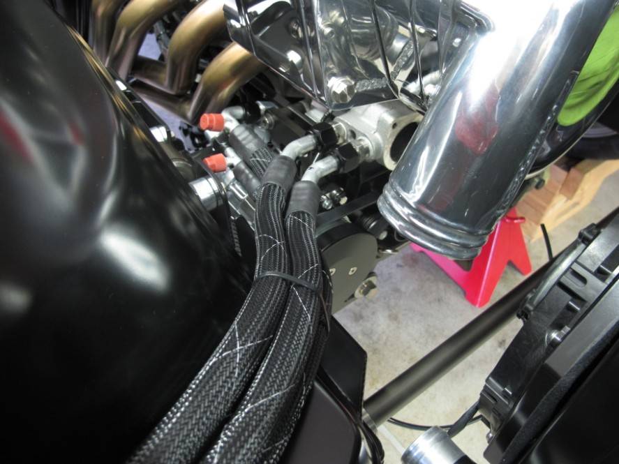

      Thanks Nick, Yes the hoses are covered with a nylon flame retardant covering with adhesive backed shrink tubing on the ends. It's pretty easy to do.

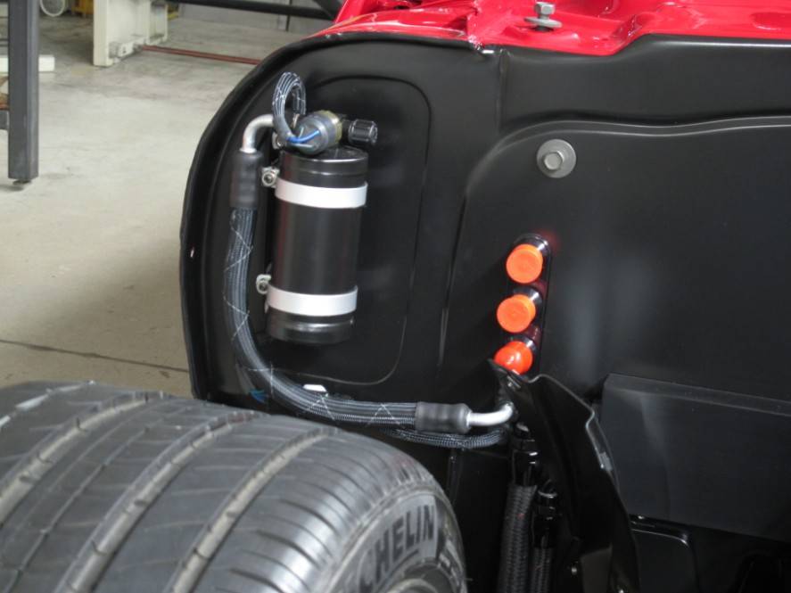

      Love the car absolutely beautiful, I have a couple questions if you don't mind.
      1. Where did you get those brake and fuel line clamsp?
      2. The black box on the lower part of the passenger firewall what is that oil cooler?
      3. The coil pack relocation on the oil pan where do they sell those?
      Thanks justin
    19. #139
      Nov 2007
      Manchester NH
      299

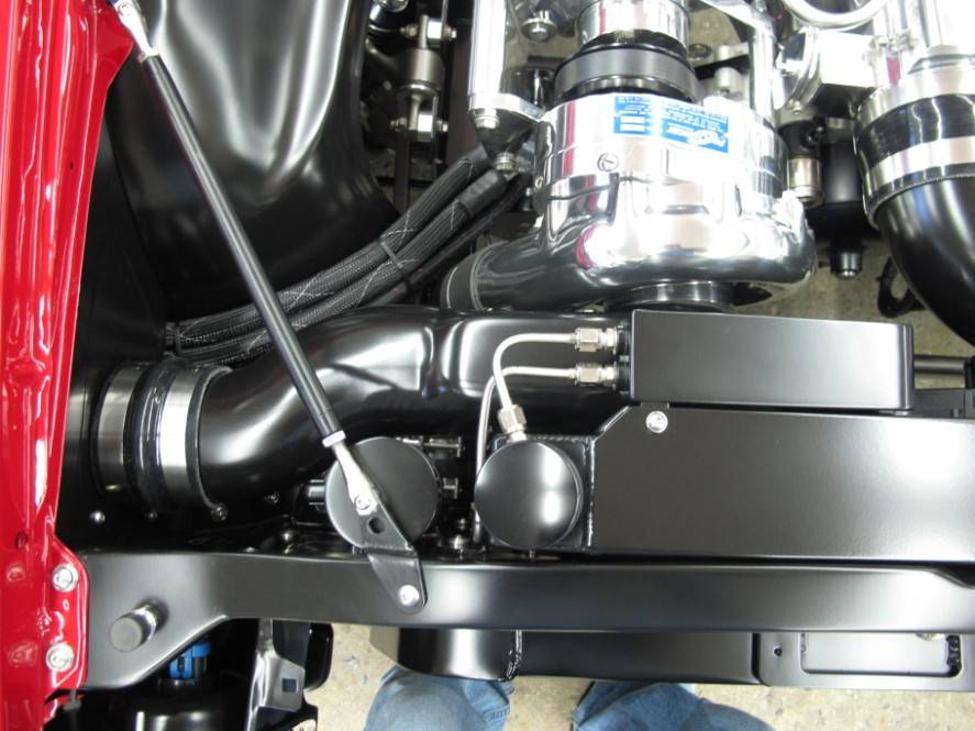

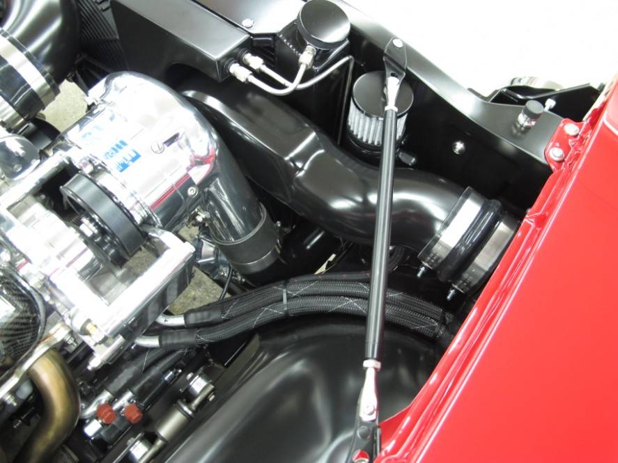

      Quote Originally Posted by jsacra View Post
      Thanks justin
      Thanks Justin!! I'm glad you like it. I don't mind at all.
      The brake line clamps come from Godman Hi Perfoaramnce. http://www.godmanhiperformance.com/i...ategory_id=149
      And the fuel line clamps come from Kugel http://www.kugelkomponents.com/zenca...index&cPath=18
      The black box is an aluminum fuel log, It has a Y that is -10 to 2 -8's and a separate -8 return.
      We made the coil brackets.
