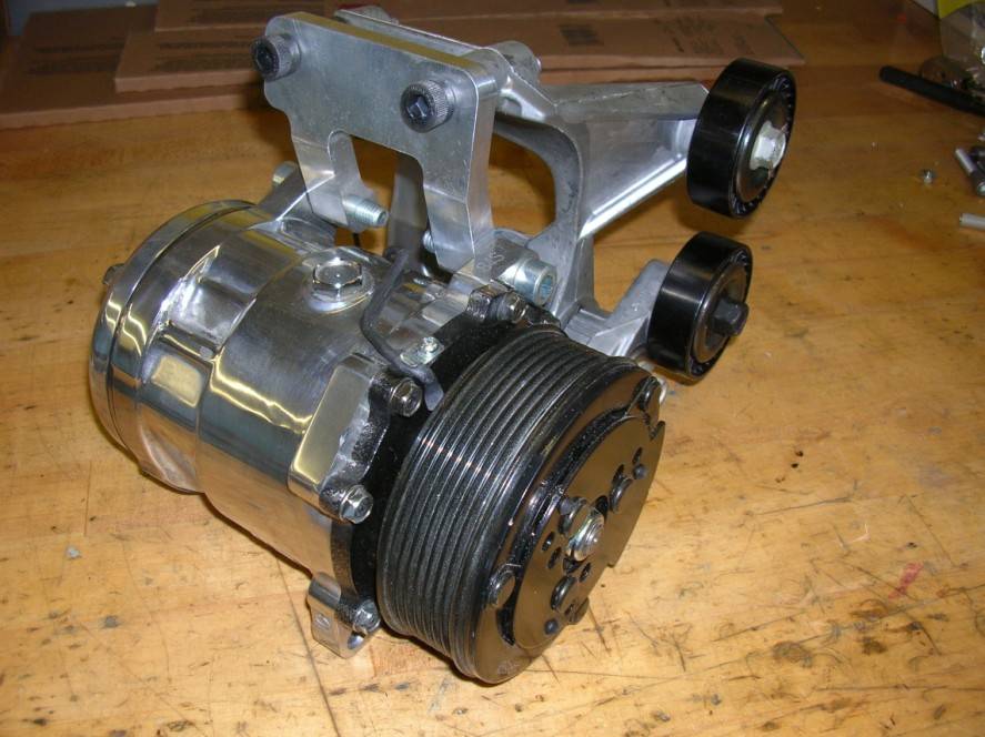

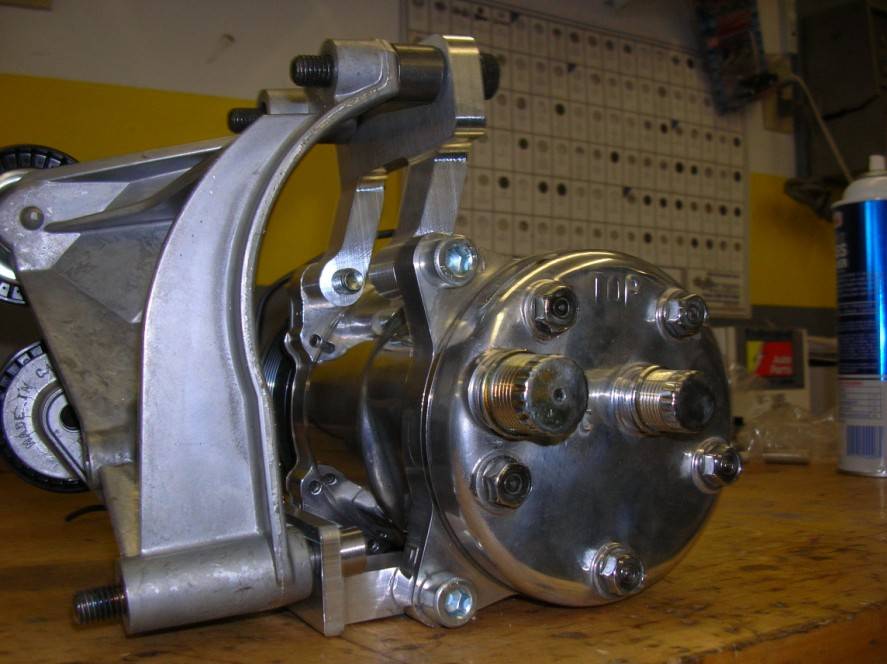

      Jay, what ac bracket is that? Is it the vintage air bracket?
      Thanks,
      David

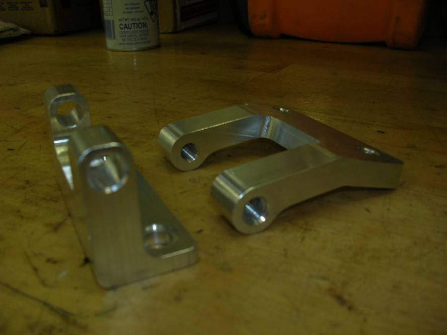

      Here are few pictures of the A/C brackets. I didn't end up using that A/C compressor though. I couldn't get the beadlocks to fit around the frame and header the way I wanted. You can see the compressor I use in some of the other pictures.

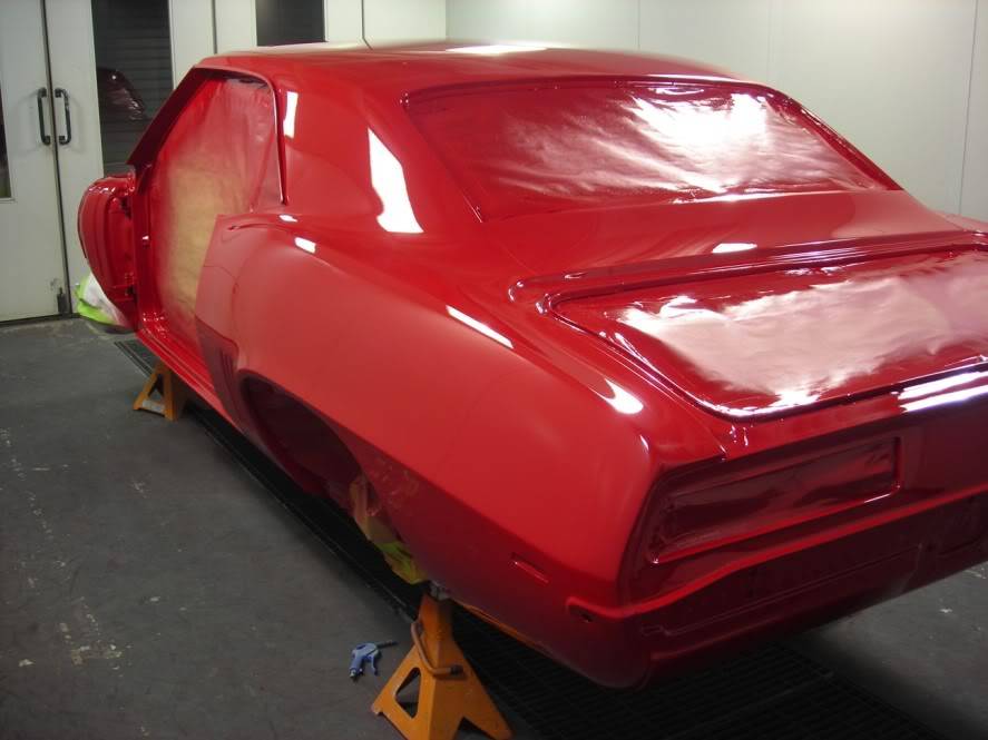

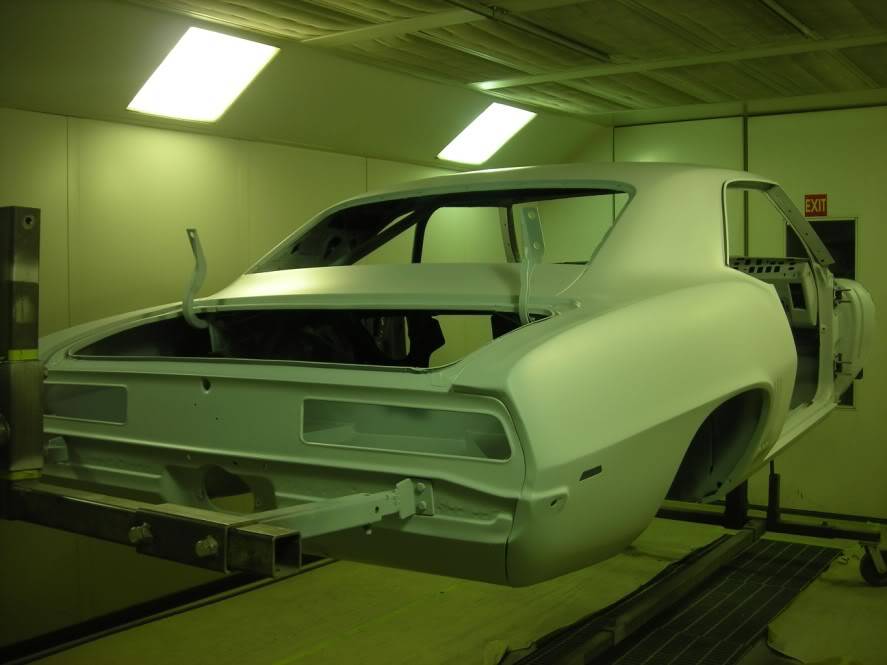

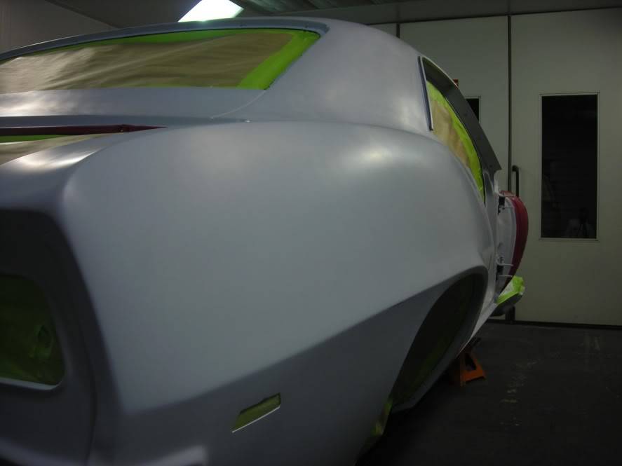

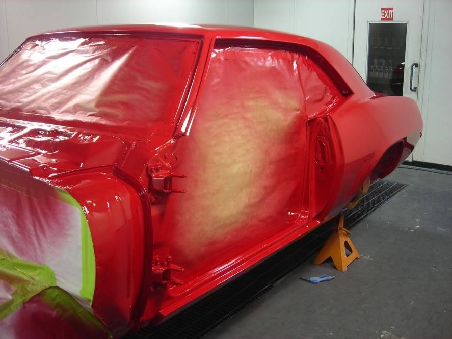

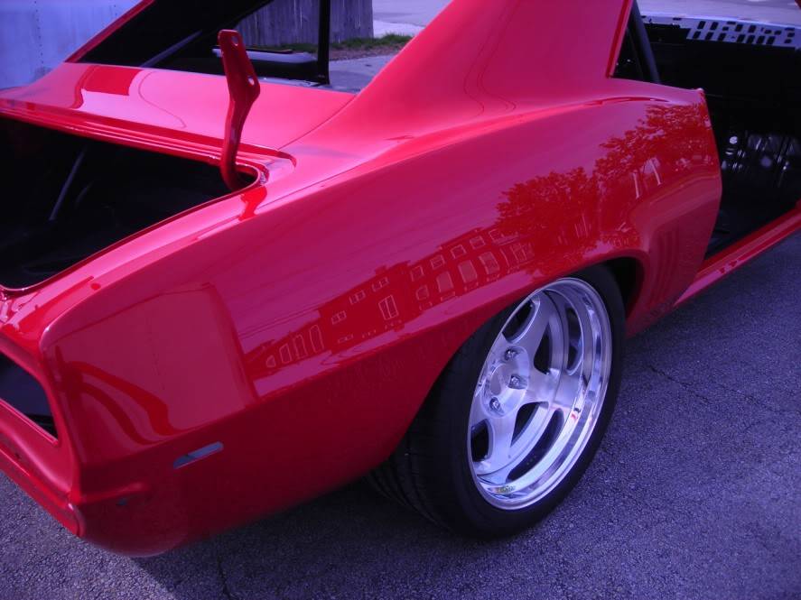

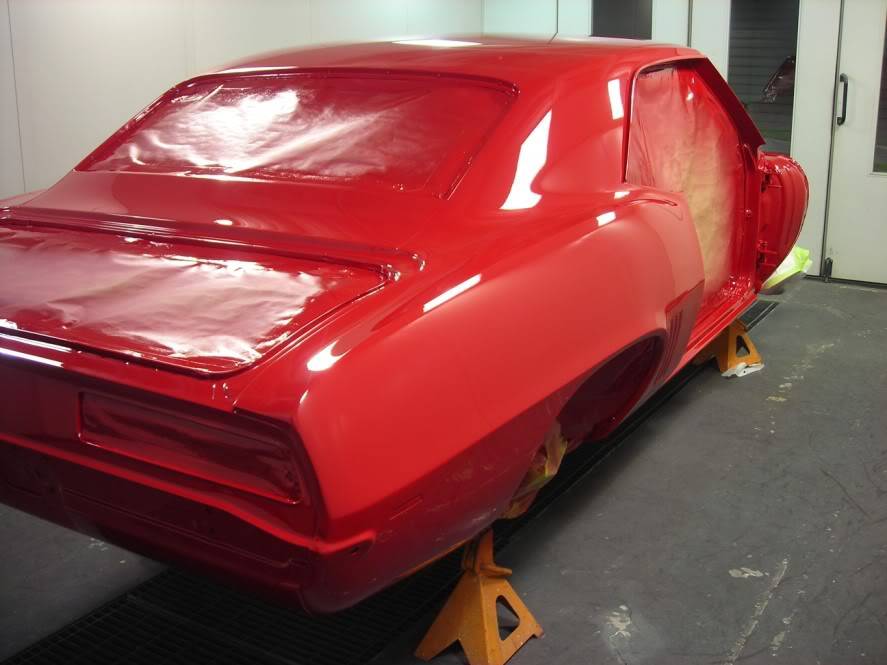

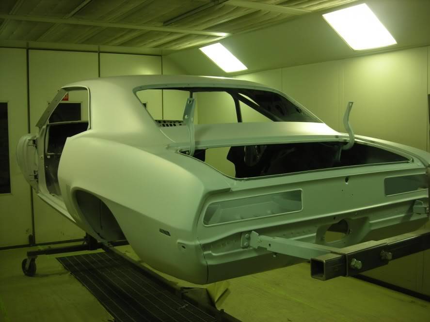

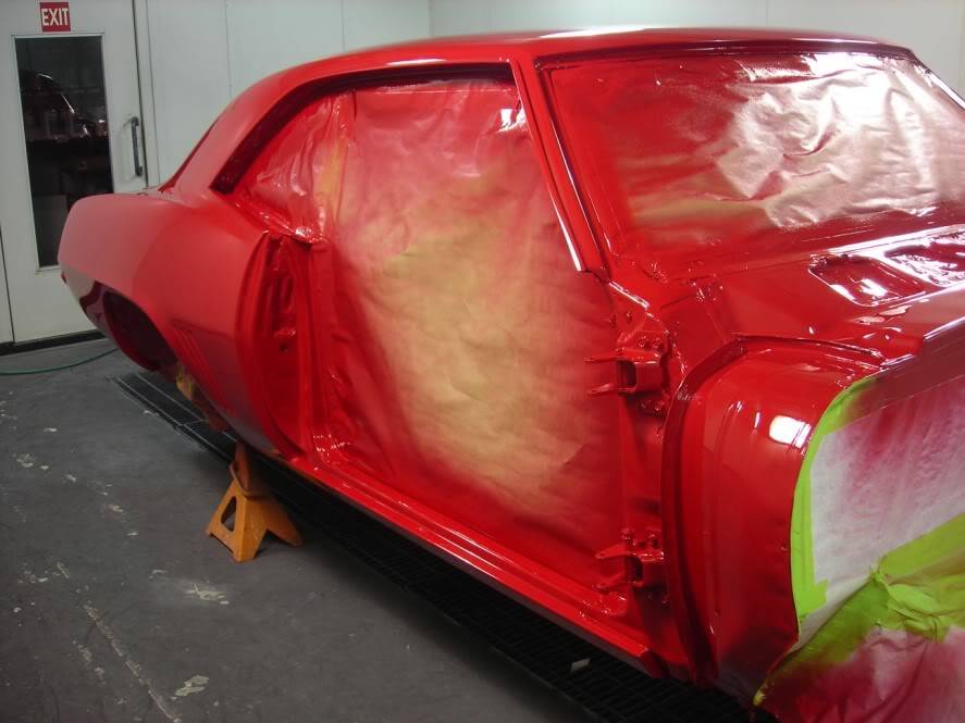

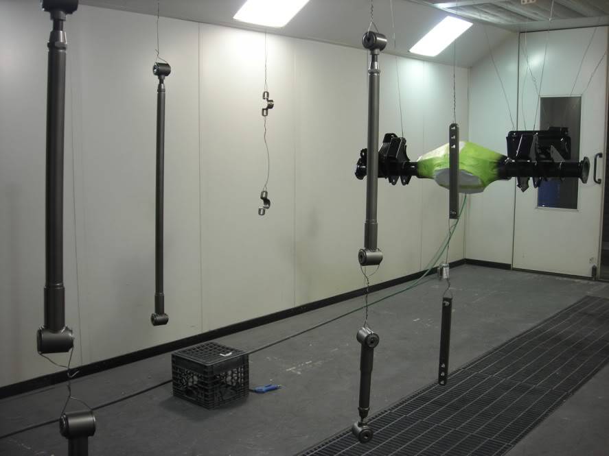

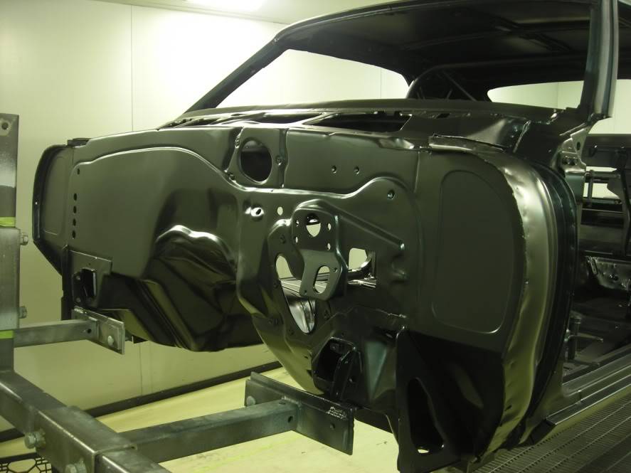

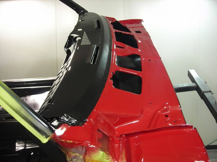

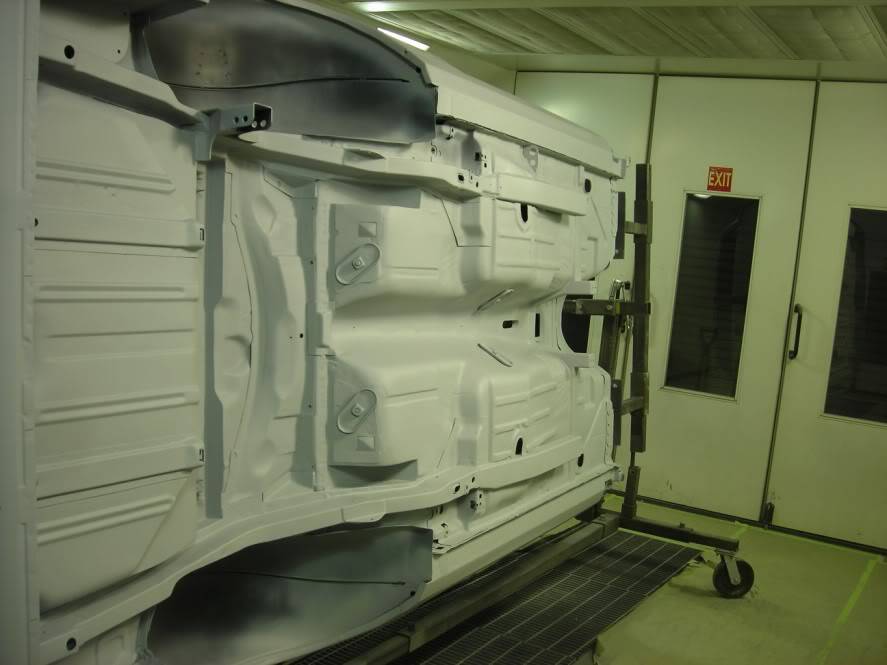

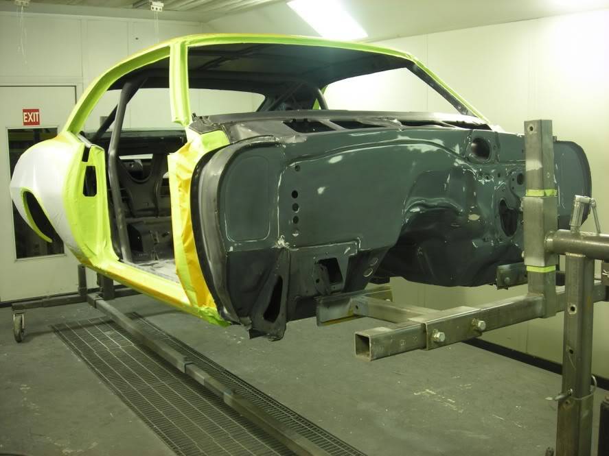

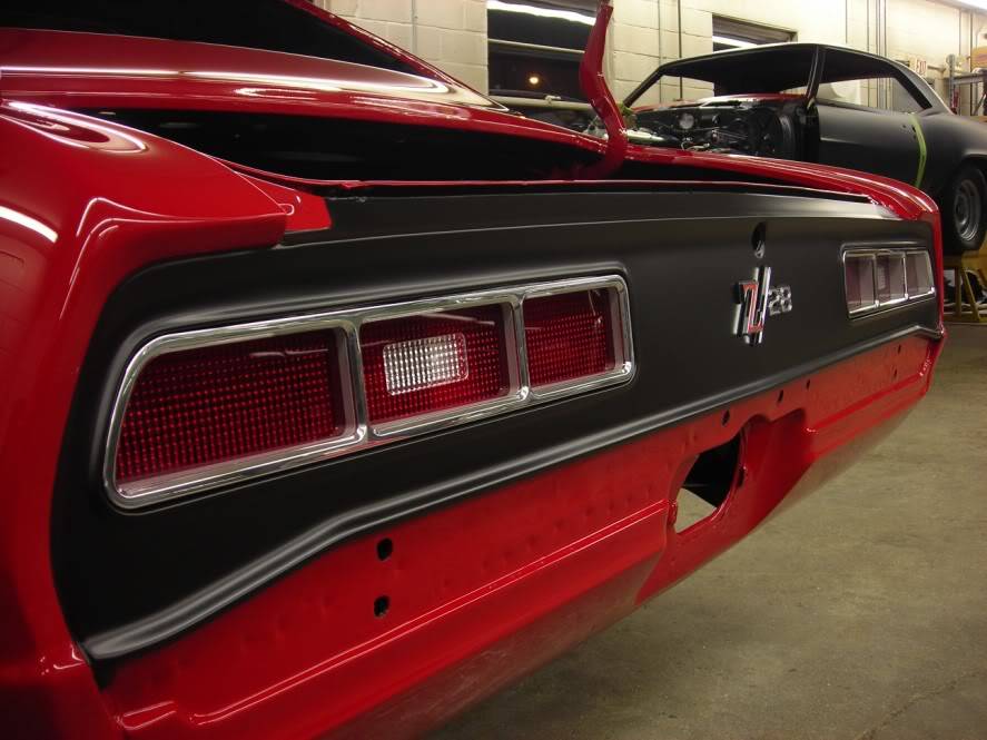

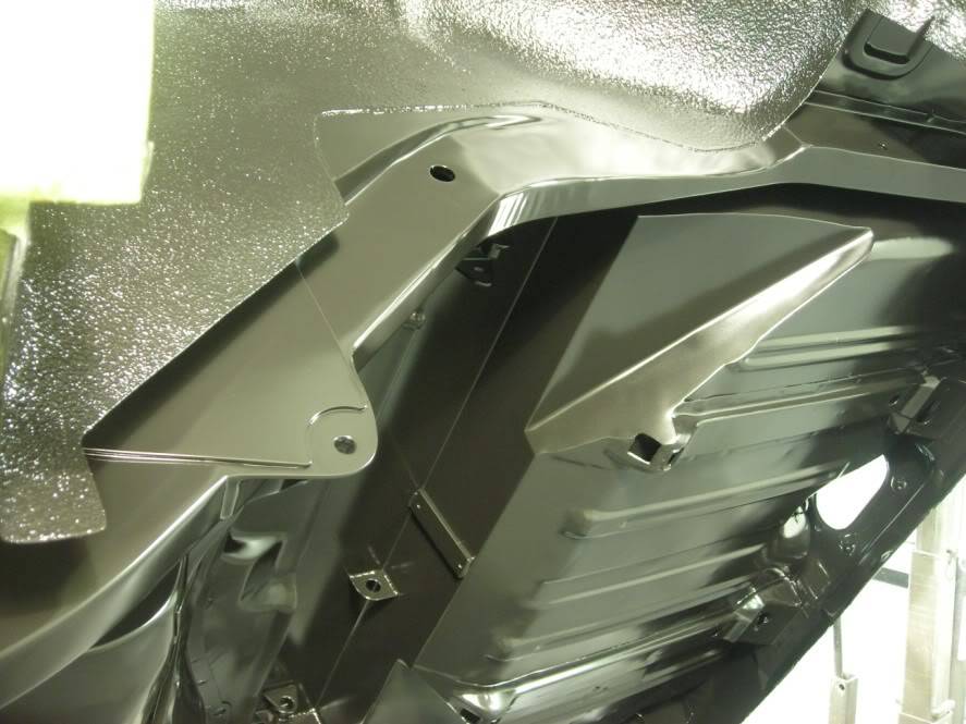

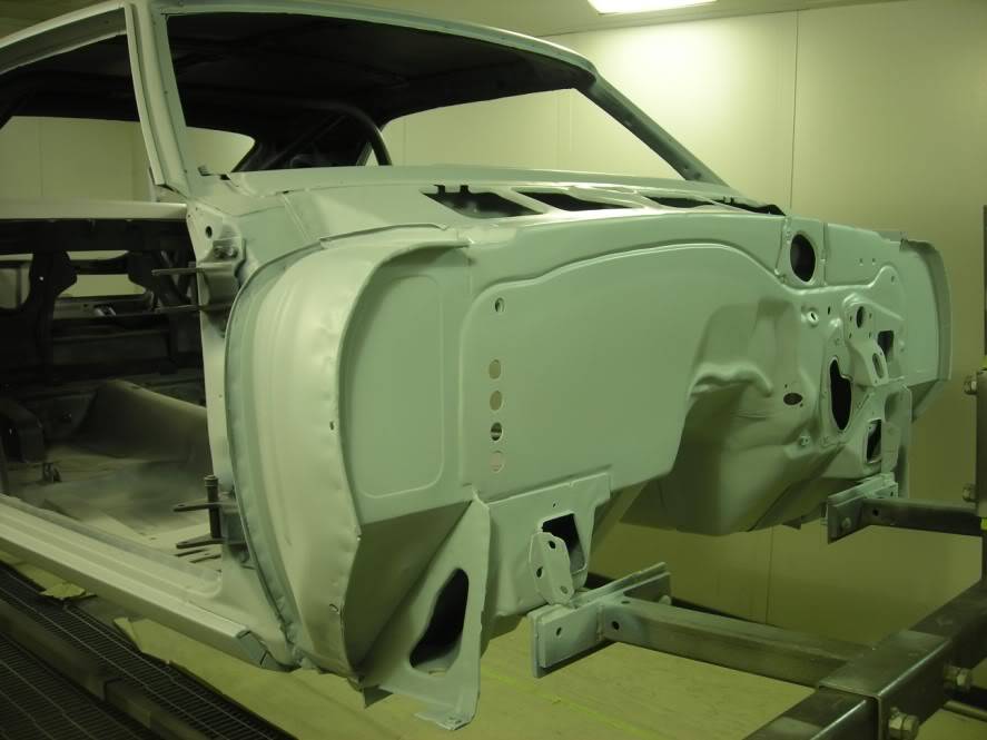

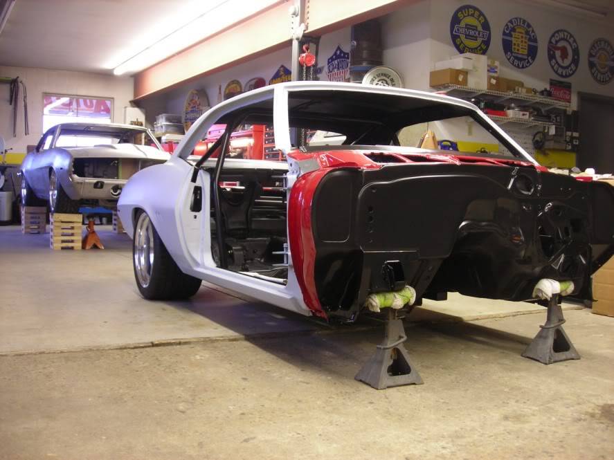

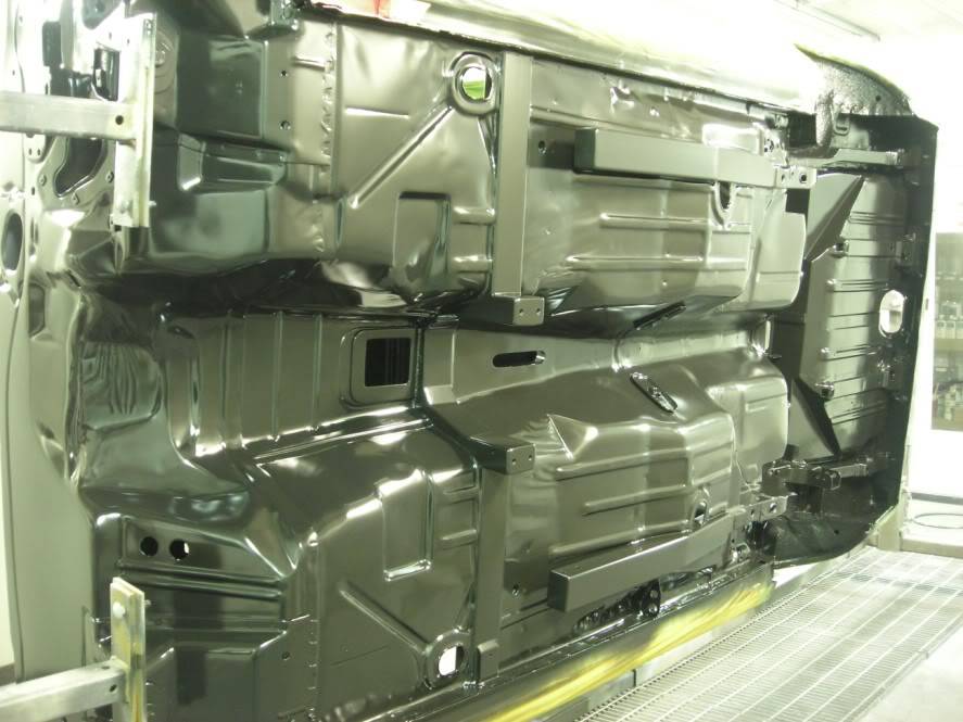

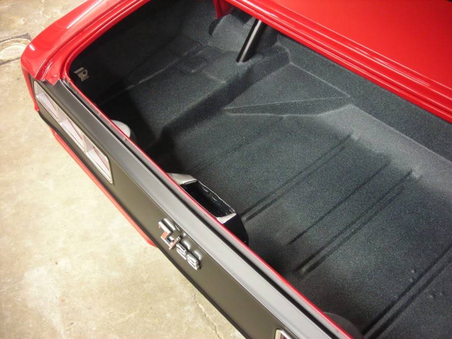

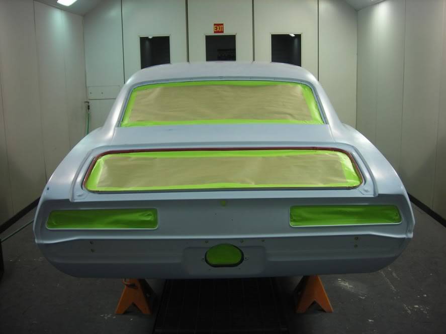

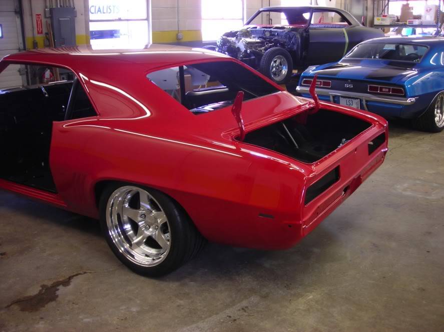

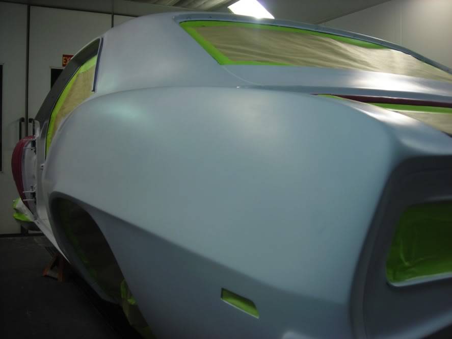

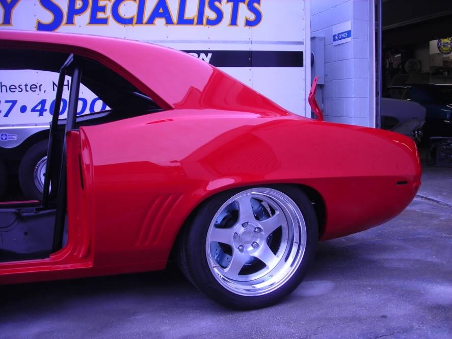

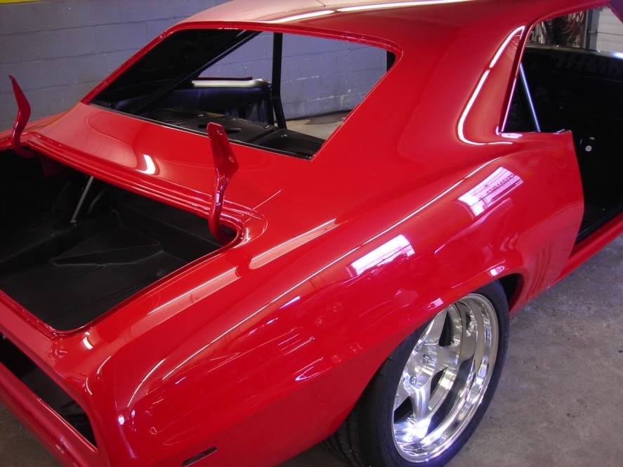

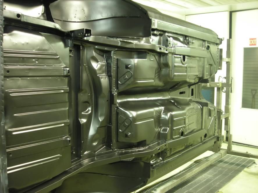

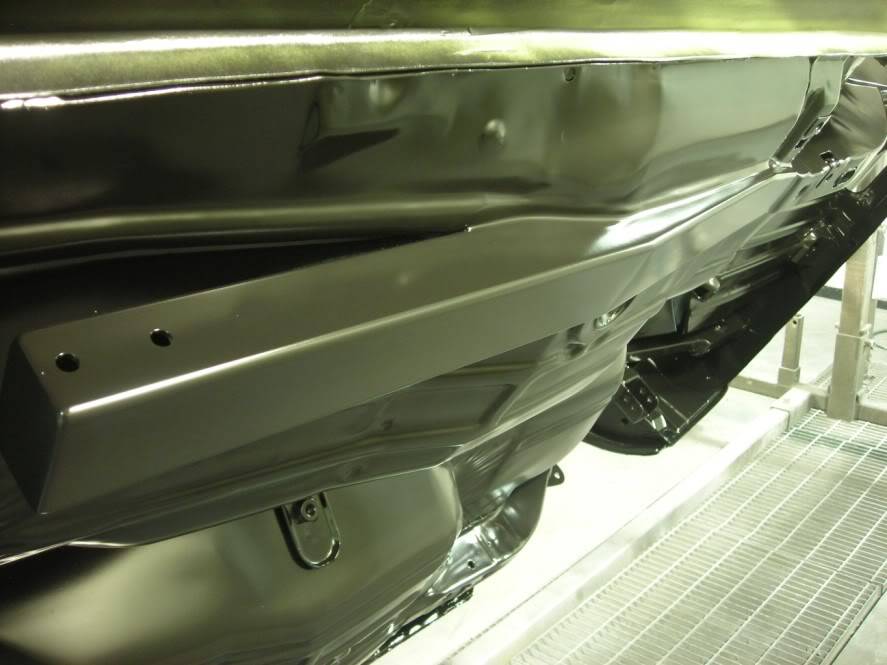

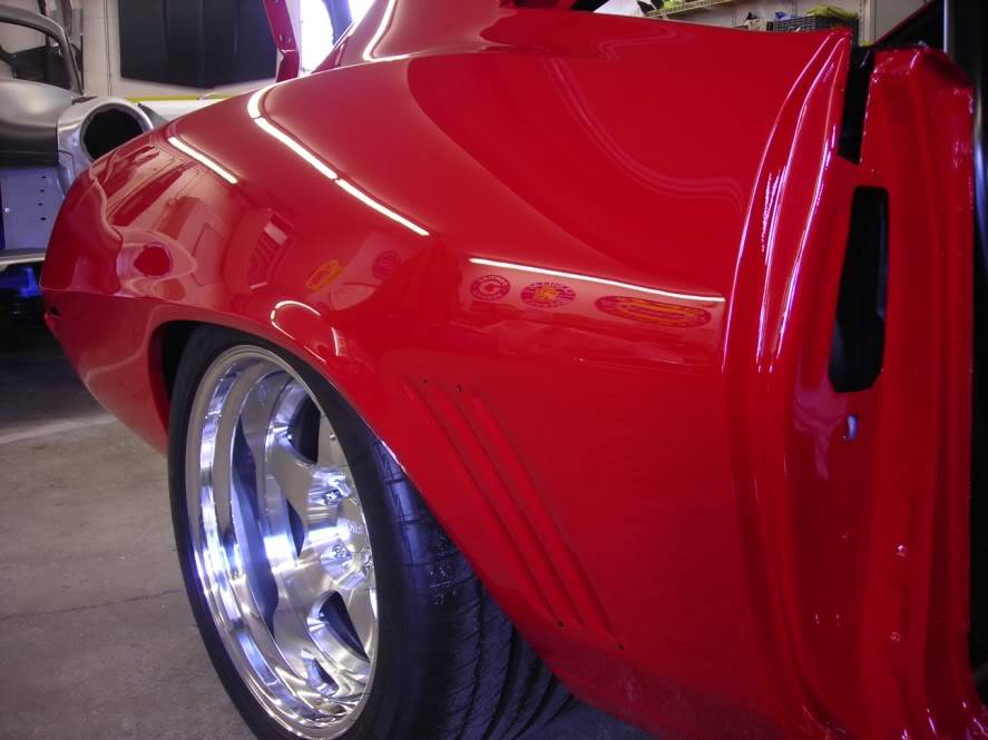

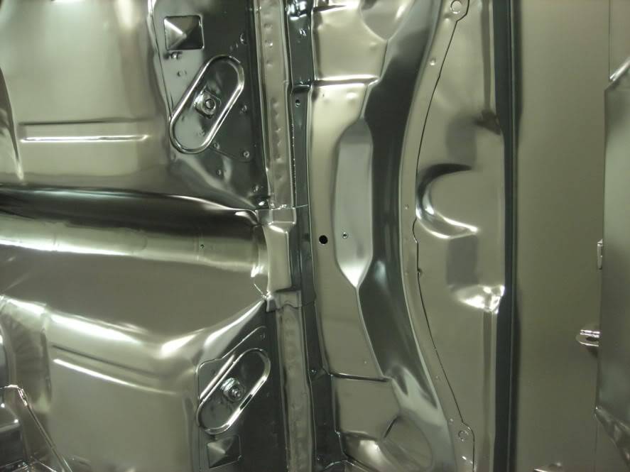

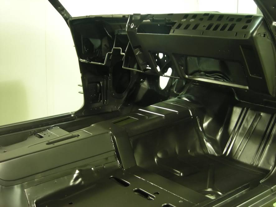

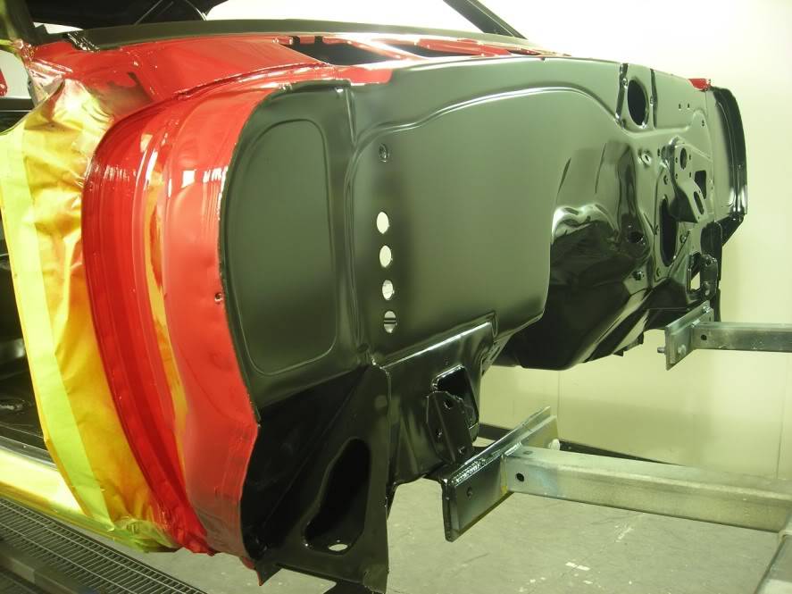

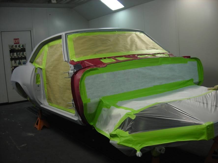

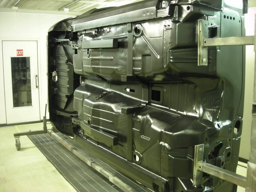

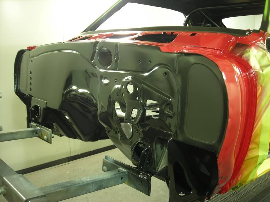

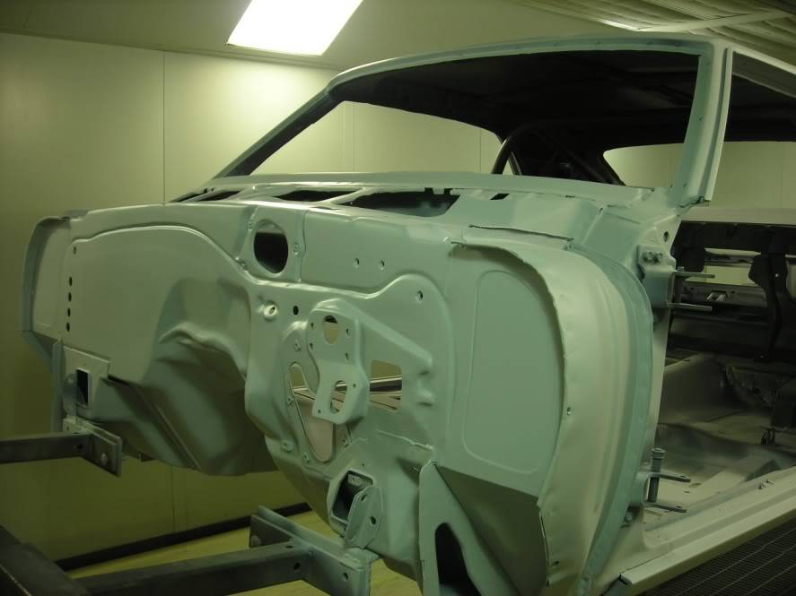

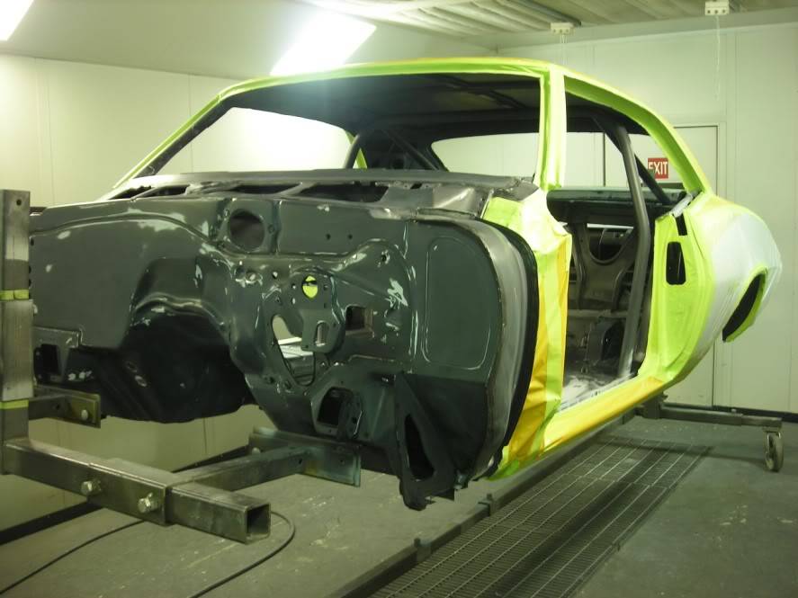

      Thanks guys! Here are some pictures of the shell in epoxy and fill primer and finally some paint. The bottom is painted in a trim black with PPG DCU2060 clear. The red is 2012 GM Victory red.

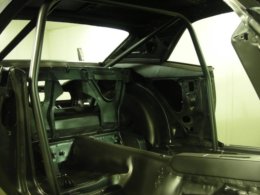

      Did you fab the roll bar or buy it? If the later, who'd you get it from? Nice and clean!
      Nov 2007
      Manchester NH
      299
      Quote Originally Posted by rlodad View Post
      Thanks! It's a DSE. I had them bend the removable harness bar for extra seat clearance. I don't have any pictures of mine with removable bar but here's a picture of the last one I installed. The one in my car look just like it.

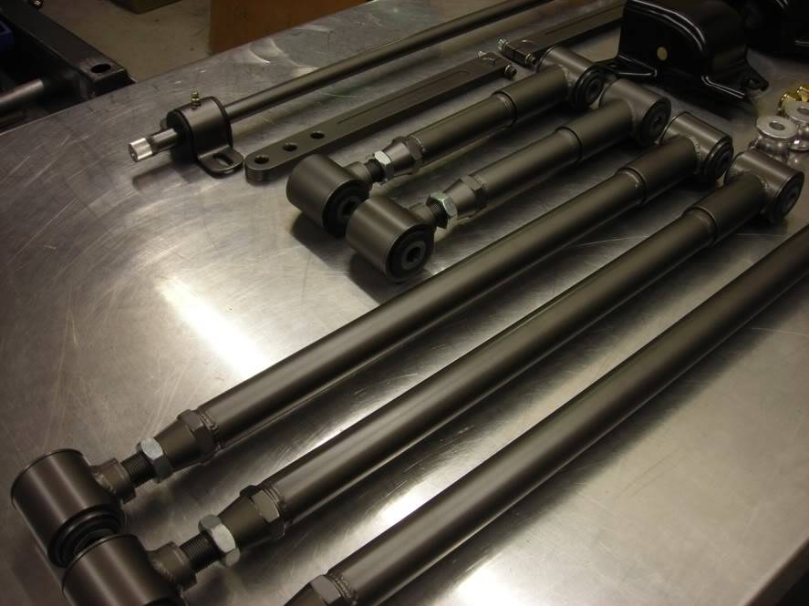

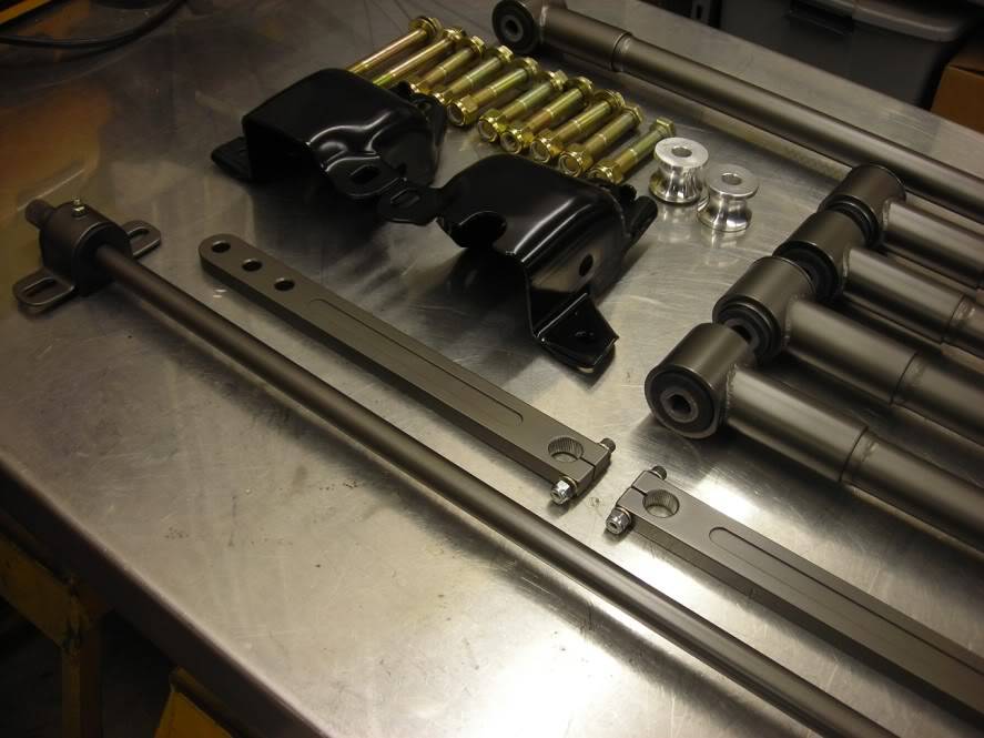

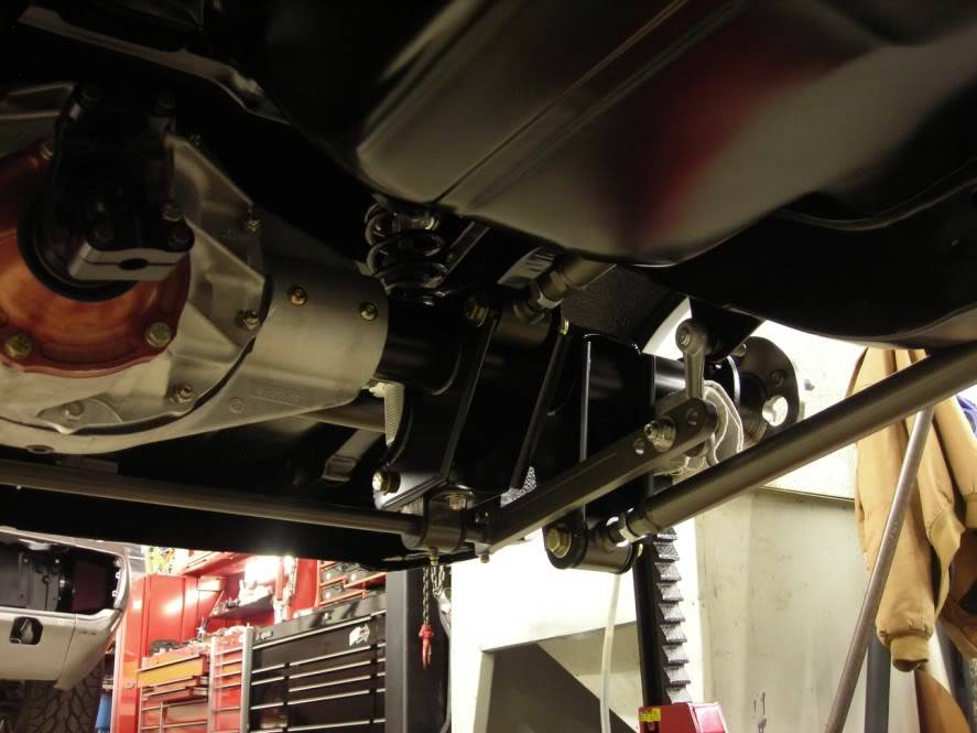

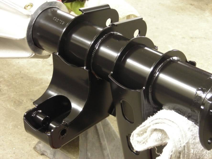

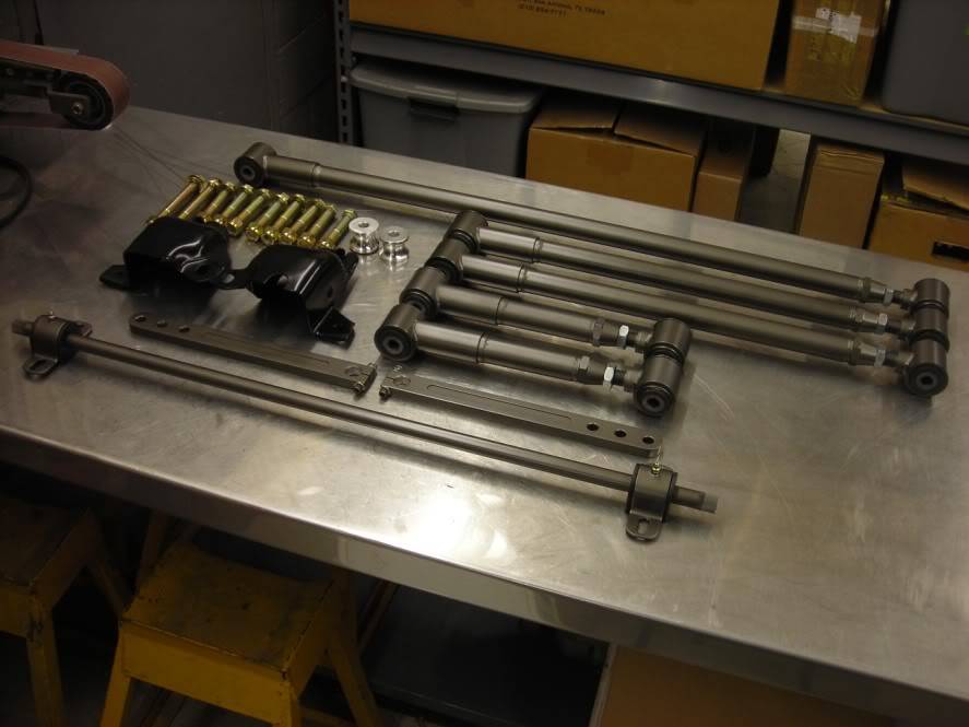

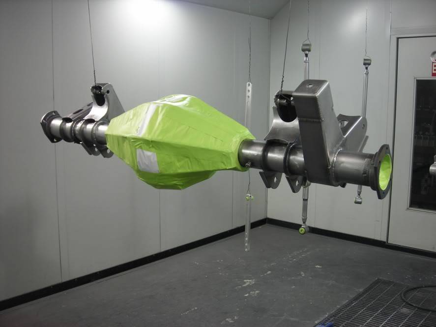

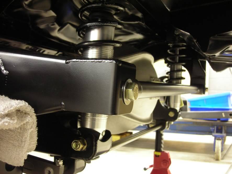

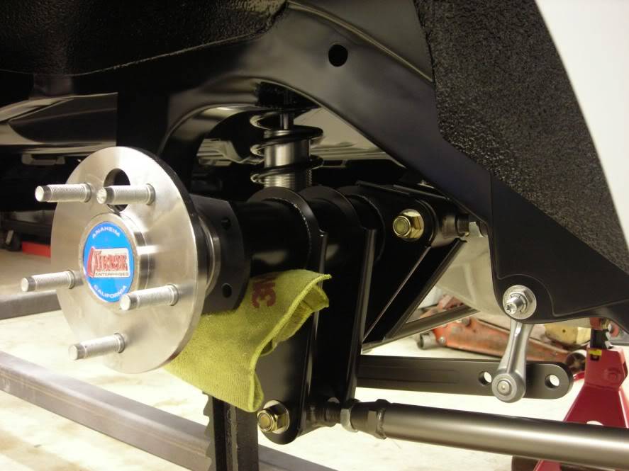

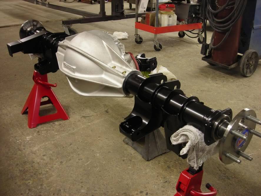

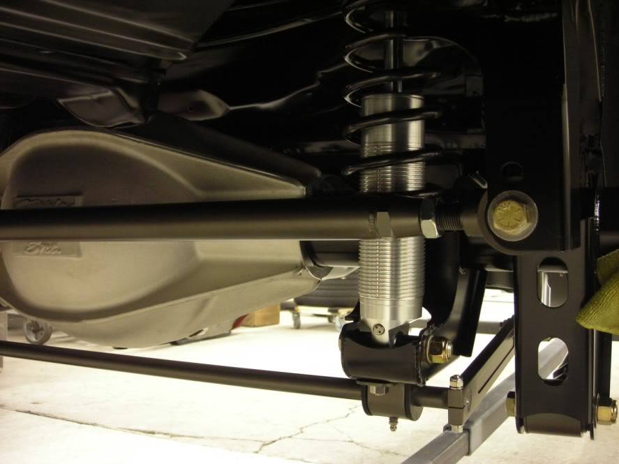

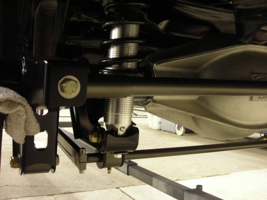

      Here's some more pictures. The rear is a Currey 9" housing with an aluminum center. I'm running a Strange Aluminum 3 member with 4.10's and a True Track. The suspension is a DSE Quadra-Link with a Speedway splined sway bar. I would have run a DSE sway bar but they didn't offer one when I was putting it together.
