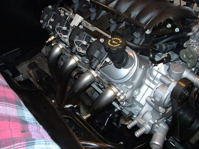

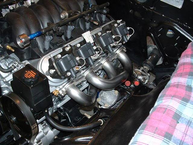

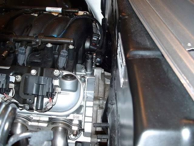

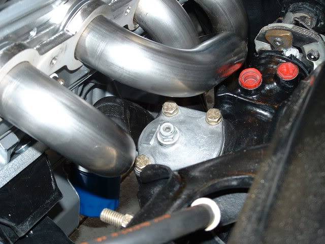

      Santa brought a late present to my house. These are Stainless Works headers part #CALS1B for the stock steering box. The quality of these headers is amazing and they fit like a glove with the S&P motor mounts. Here's a few pics. I highly recommend them. And I must say I highly recommend the S&P motor plates too. The one drawback is that they do keep the motor a little more forward than other plates do but for a street car I think it's worth it to sacrifice the little bit of weight transfer advantage for better fitment of your parts. I also had no issues with my alternator to frame clearance either.
