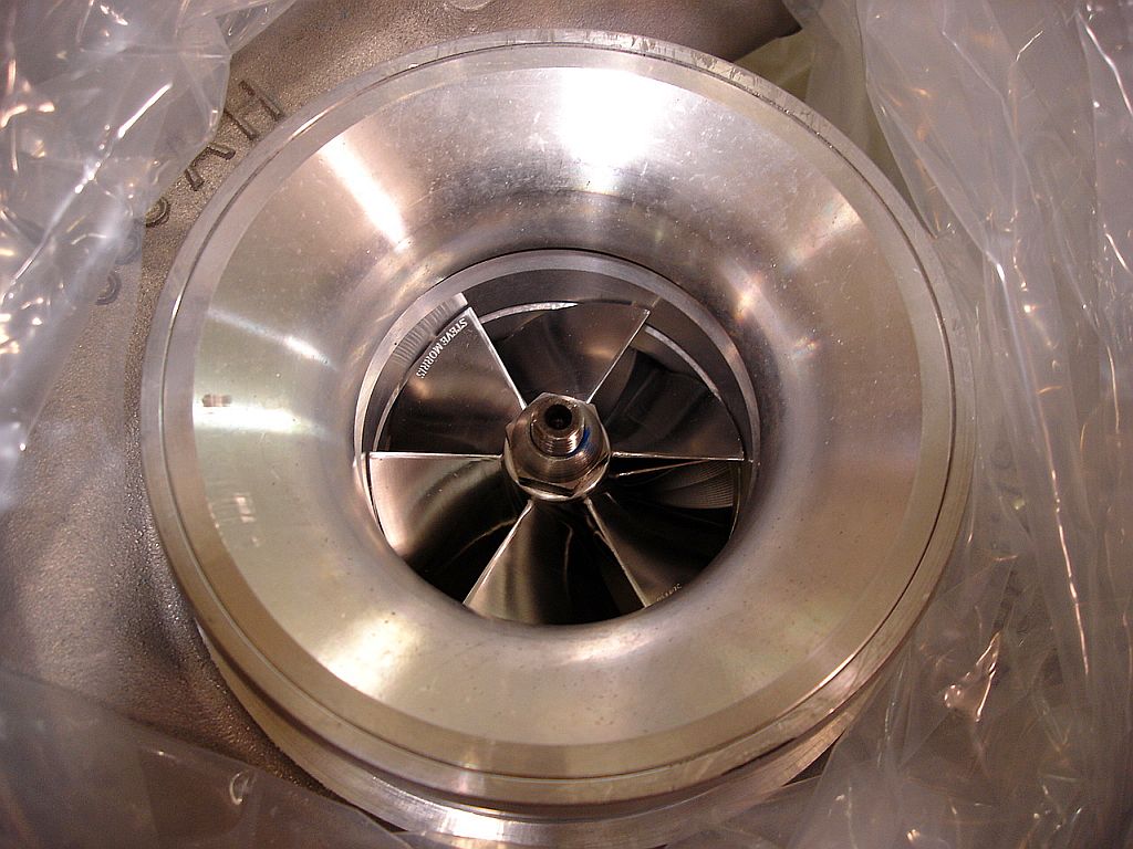

      I sold the Procharger F1-C. And had Steve Morris set me up with a pair of 75mm billet compressor/race housing, 87mm turbine/1.0 A/R S/S turbine housing BW400 frame turbo's. V-band mount. Also had Steve spec the camshaft with Bullet. All that stuff is sitting in boxes at the shop.

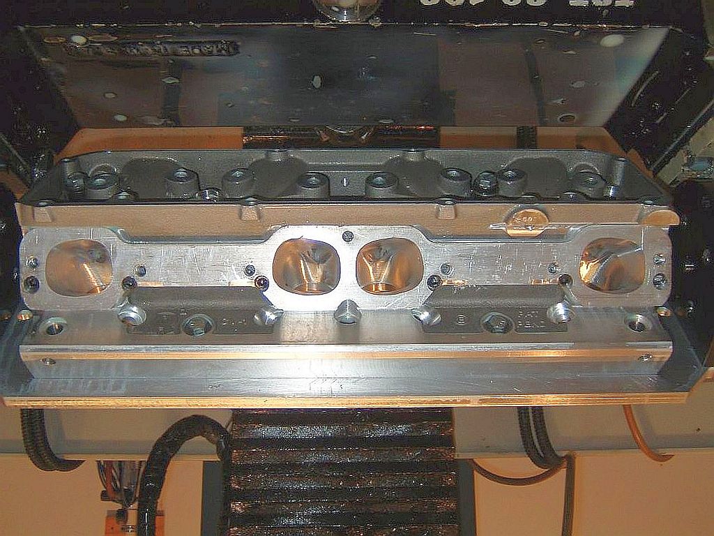

      I had the Roland Racing CV-1 Pontiac cylinder heads converted to the race-plate exhaust setup for turbo use. This removes the standard turn down exhaust ports and exits the exhaust ports in a much more efficient way, especially for turbo mount headers.
      So the engine in its current configuration will be a twin turbo 555ci. On the S/M website there are a bunch of dyno runs. One of these dyno runs is a 455 Pontiac with 2 small turbo's. A road race motor Steve was freshening and making a few changes to. Camshaft, etc. This engine made 700ft lbs
      at something like 2200 rpm. When I was working with S/M in getting the turbo's and camshaft spec'd for my project, I specifically referenced this engine and said that kind of power band was exactly what I was looking for.
      So here is what a prototype CV-1 head with the convertible exhaust mod looks like.
      And a shot of one turbo still in the box. waiting patiently.
