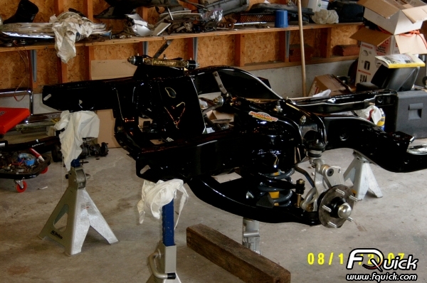

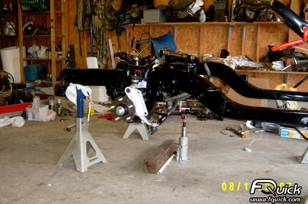

      Subframe Assembly
      I finally got my subframe from the powder coater yesterday and I began Installing my suspension!

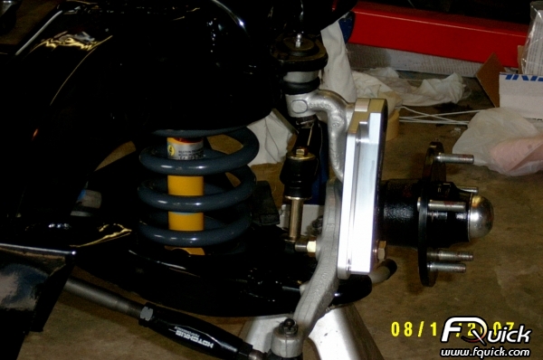

      Subframe Assembly
      I finally got my subframe from the powder coater yesterday and I began Installing my suspension! Global West UCA, Hotckis TVS System, Speed Tech big brake brackets. These parts are really high quality. Everthing bolted right up. Was very easy to install.
      Just a couple of questions. I'm stumped. Which camaro frame brackets do I use? I'm going to put an LS1 and camaro made three or four different engine frame brackets
      Any help would be of greatfully appreciated.
      Thanks,
      Sam

      looking good.i'm using the ats mounts on mine.they are a little more expensive than the others but are high quality and from what i've read they sit the motor in a good spot.

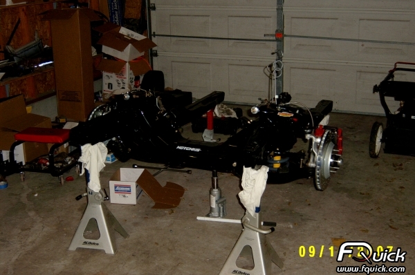

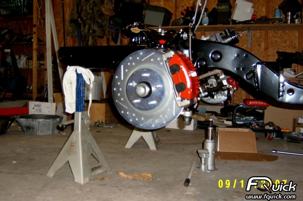

      Subframe Completed brakes installed!!
      Well I finally completed the subframe and got my big brakes installed
      Speedtech big brake bracket
      Brembo C4 heavy duty drilled and slotted rotors, 4th gen calipers with a little bling.
      Subframe done with brake lines installed. All I need is a body
      On another note, I scored a really good deal on a 2002 Ls1/T56 with complete rearend for $800.00. Pulled the starter off and found a 3" hole in the block. So I found a good ls1 block and located a good engine shop, perhaps you guys heard of them, Nickens Bros Racing Engines in Conroe, Tx. They're just 30 minutes from me. Took both engines, complete and short block to them and David Nickens said no problem. He said he has built about 200 ls1 engines. He even asked how much horspower I wanted, 1000? I said 450 will do he said no problem. Woo woo!. They just had a write up in Car Craft this month, built a 650 hp LS2 in a Caddy CTSV. Can't wait to get the engine mocked. I'm in good hands

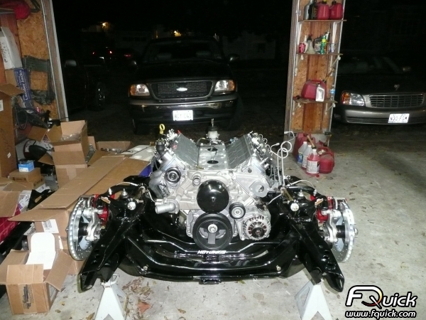

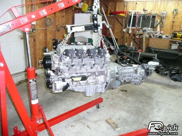

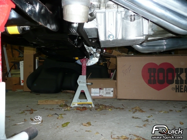

      Finally progress!!!

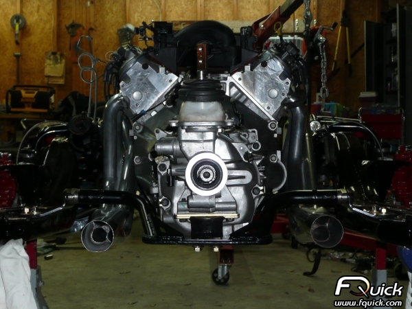

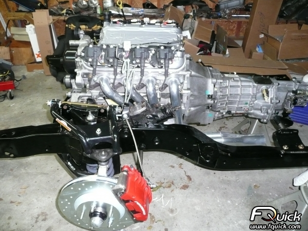

      Finally have some progress to report on my 69 firebird vert. Got the engine back from Nickens Bros Racing engines last Monday.
      Balanced, blue printed, 241 heads ported and polished, comp cam 228/230 lsa 114+4, LS6 intake. According to the engine builder should be making around 470HP with a decent tune.
      Found an 05 GTO t-56 from a guy in Pensacola, Fl and met him in Lafayette for the purchase. Tranny is in perfect shape.

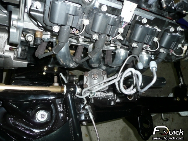

      I used carshop engine adapters, energy suspension engine mounts, and ATS transmission mount. Everything fit perfectly.
      Hooker headers cleared the stock streering box.
      I like the way the headers are tucked up out of the way. The ATS tranny mount is an exellent product and I like the clearance it gives for the exhaust.
      S&P modified the oil pan and with the combination of the Carshop engine mounts there will be no clearance issues with the steering linkages
      Hopfully next week I'll have the body back from the bodyshop and we can get this baby back as a roller.

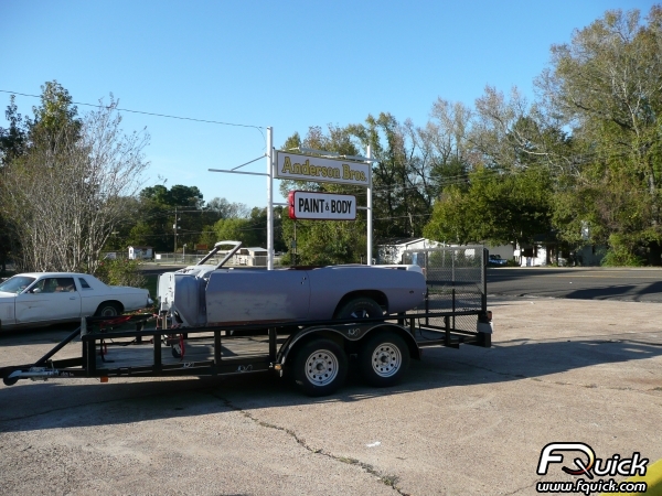

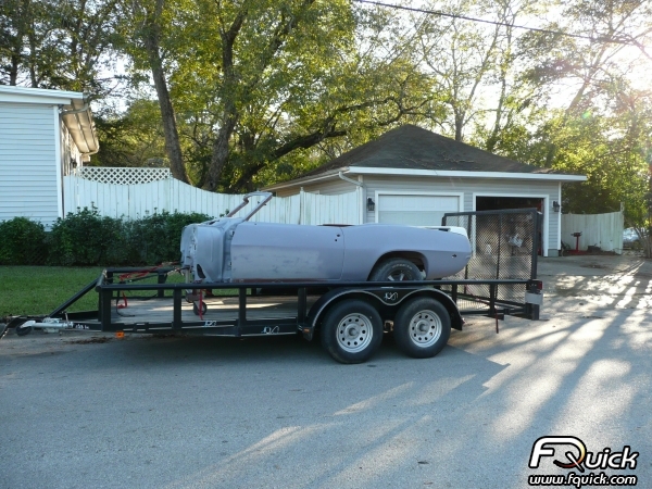

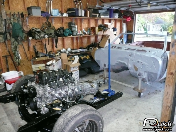

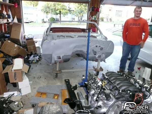

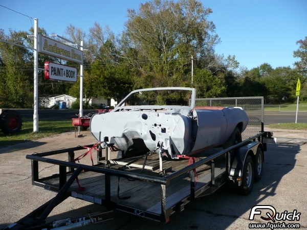

      Got the Body Back!
      Finally, the body work is completed, well almost.
      Picked up the body today from Anderson Bros. Paint & Body.
      Next step is making this baby a roller.
      If I don't start putting this thing together I'll run out of room for all the parts boxes.
      The game plan is to reconnect the body and subframe again and to mock up and fit all the pieces. Do what fabrication that needs to be done and then break it all down again and send it back to the body shop for final paint and then put it all back together so there won't be any suprises. Well... thats the plan anyway. Stay tuned
      Sam

      Dolly thing
      LOL! Just thew that together from some scrap metal laying around. Wasn't very hard took about 20 minutes. I went to our local Tractor Supply and picked up some casters, I think they were 6 or 7 inch. Used the old body bolts to mount them to the front body mounts. It really makes it easy for one or two people to roll the body around.
