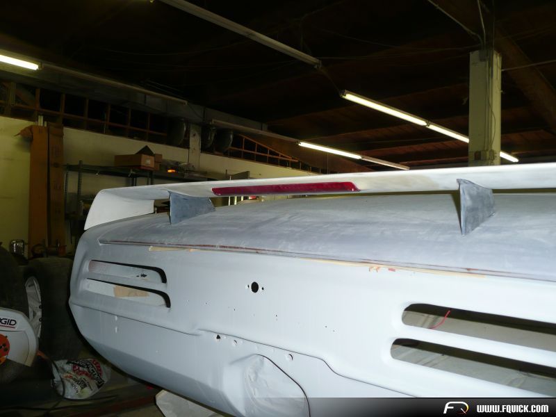

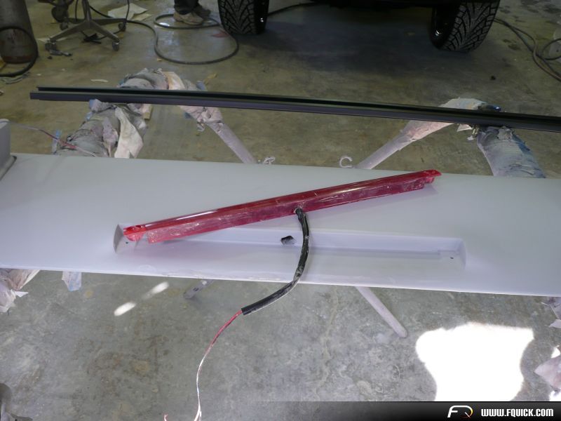

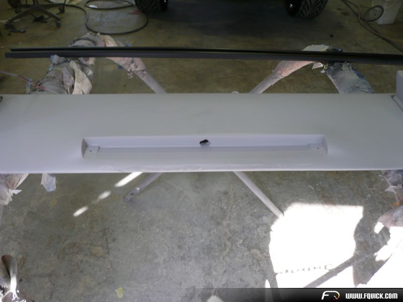

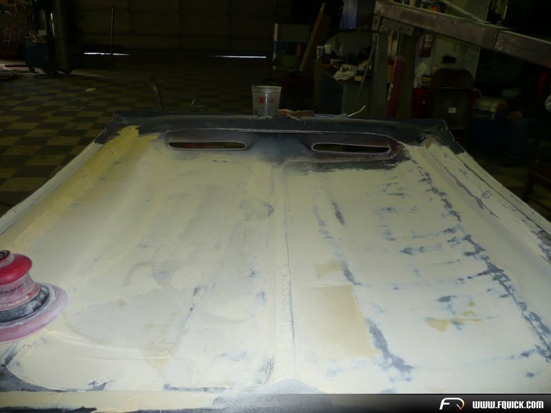

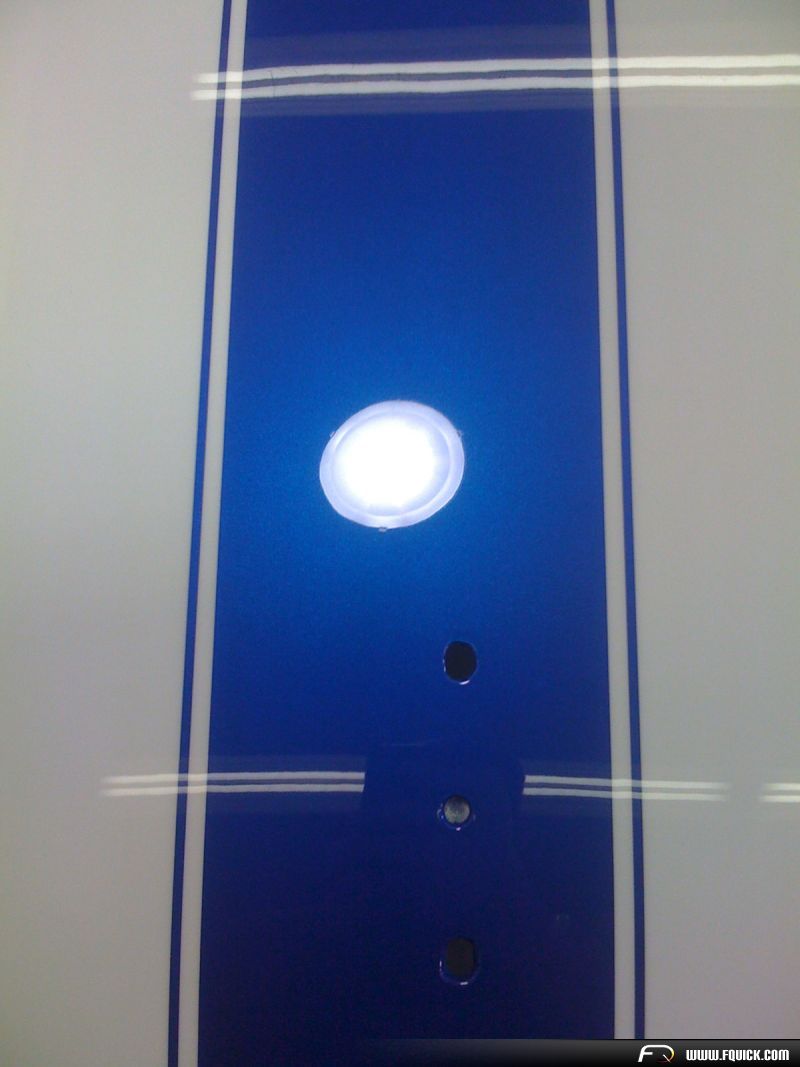

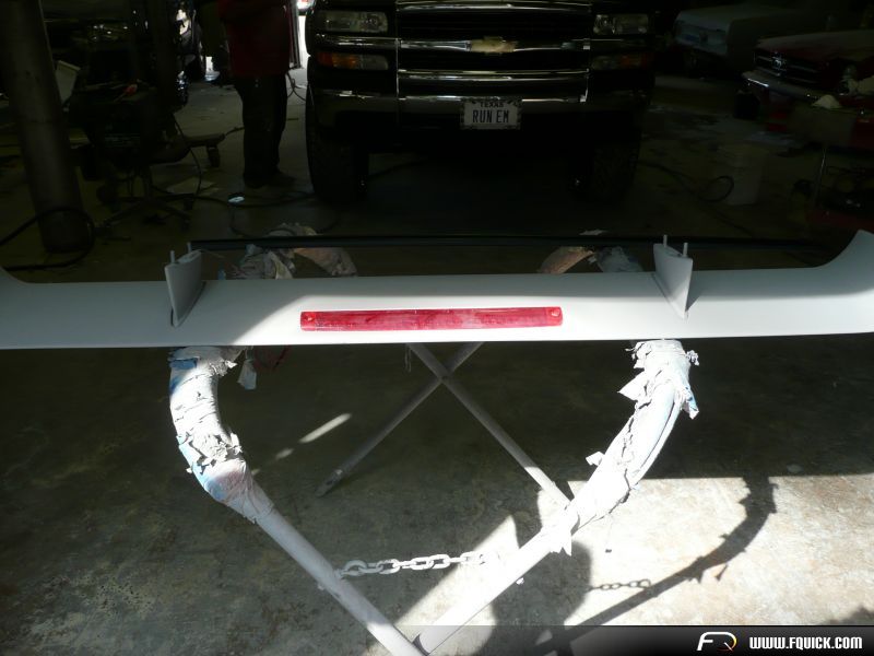

      Just a little update
      Well its been a month since my last update and I thought I would show some of the progress. Finished the gaps on the fenders and hood and completed the third brake light in the spoiler.
      Third Brake light is completed primed and ready for paint.

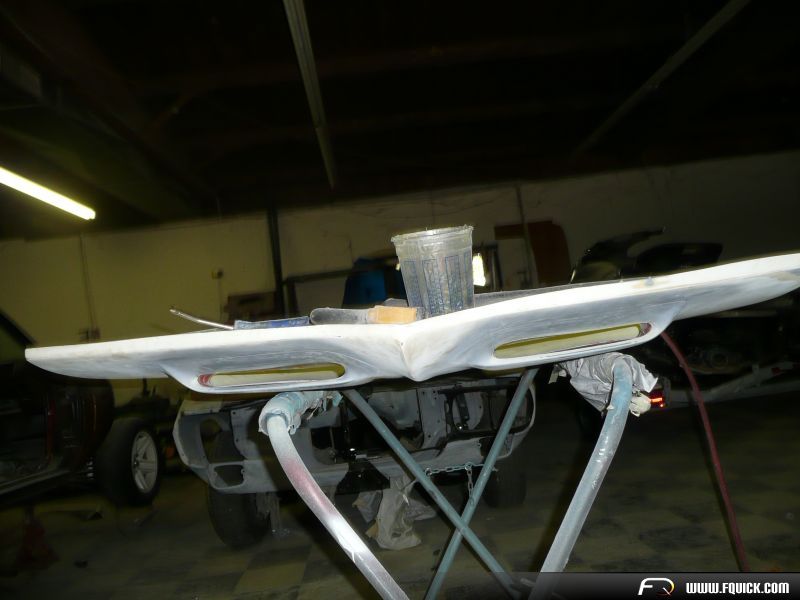

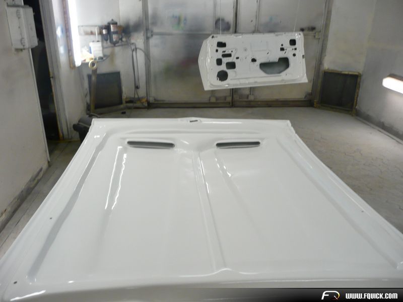

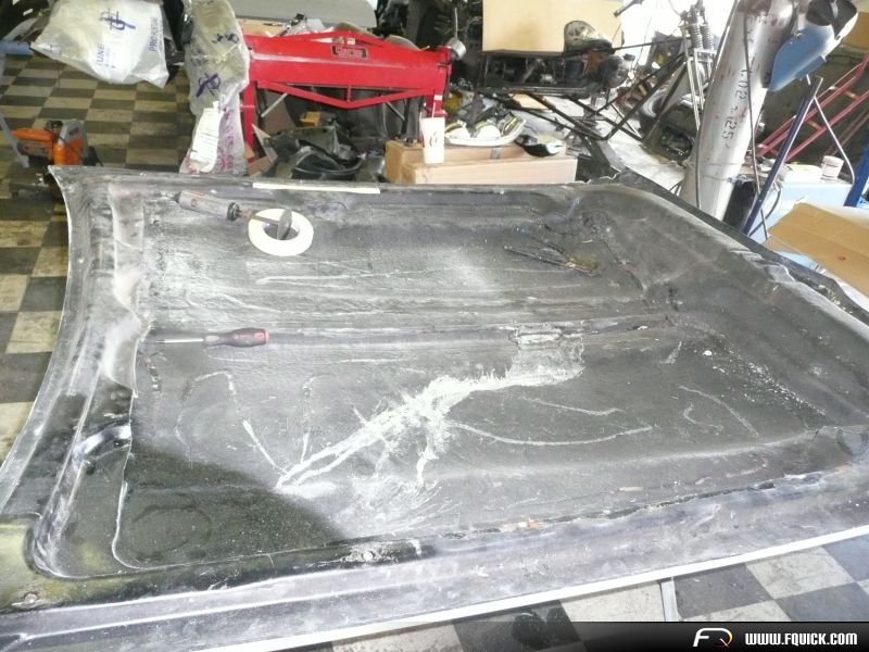

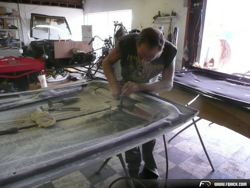

      Prepping the underside of the hood

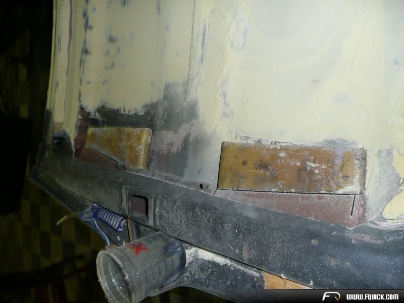

      Getting ready to cut the opening for the ram air scoops.
      Scoops are now opened so we can make some tube extensions

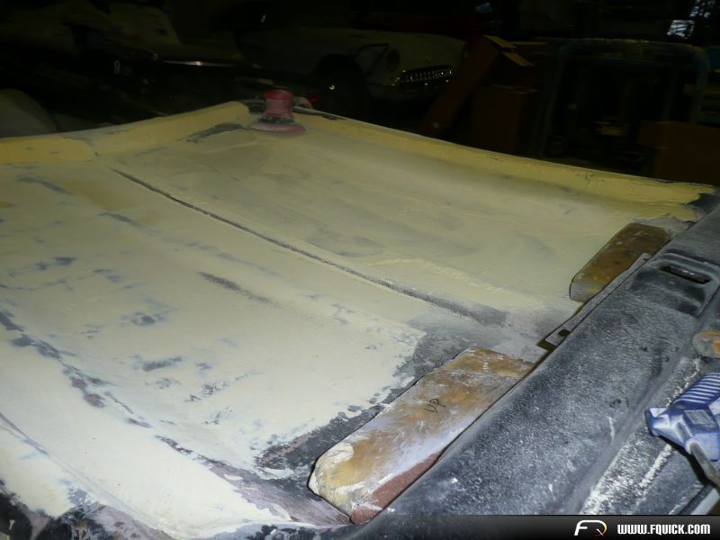

      We made some scoop extensions from a mold of florest's blocks. Wrapped them in wax paper for a releasing agent and the wrapped them in fiberglass
      Prefitting the scoops to the hood.
      Now were in the process of sanding smooth the underside and will then glass the scoops into the underside of the hood.
      We haven't decided how we will route the ram air induction as of this time. We probably wait until I get the engine installed and the tubing routed. More than likely we will use a twin tube design and route the ducts to the sides of the radiator for cooler air.

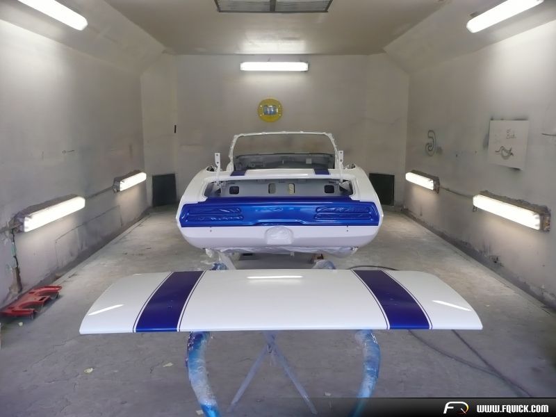

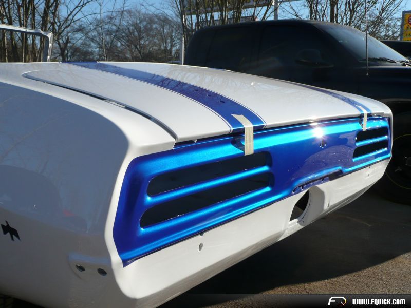

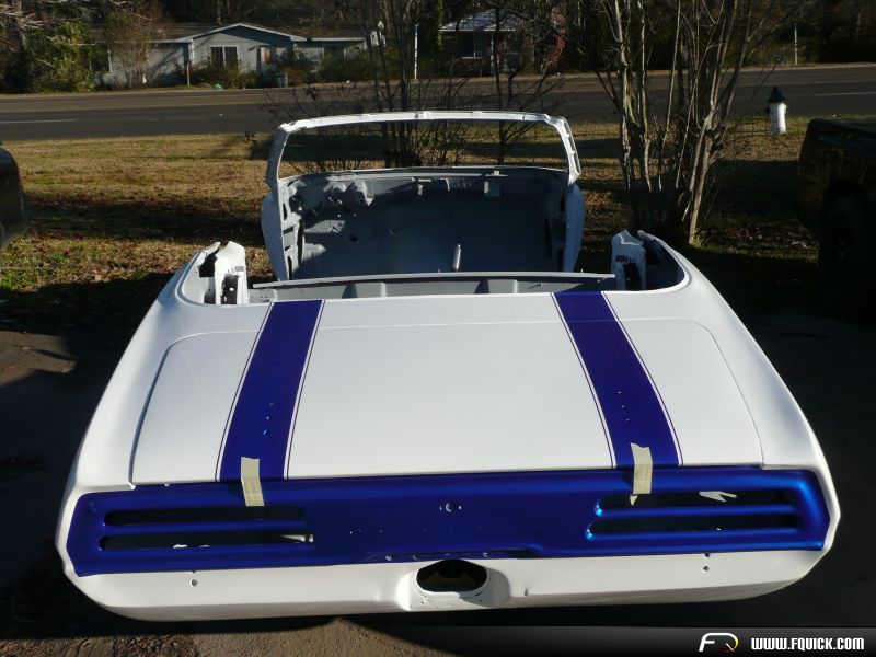

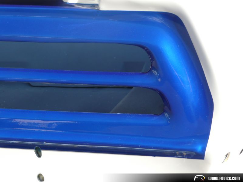

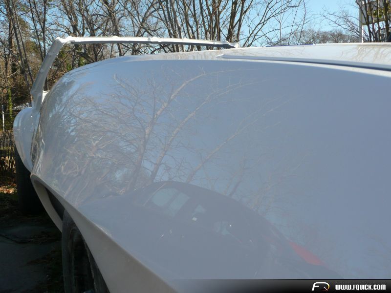

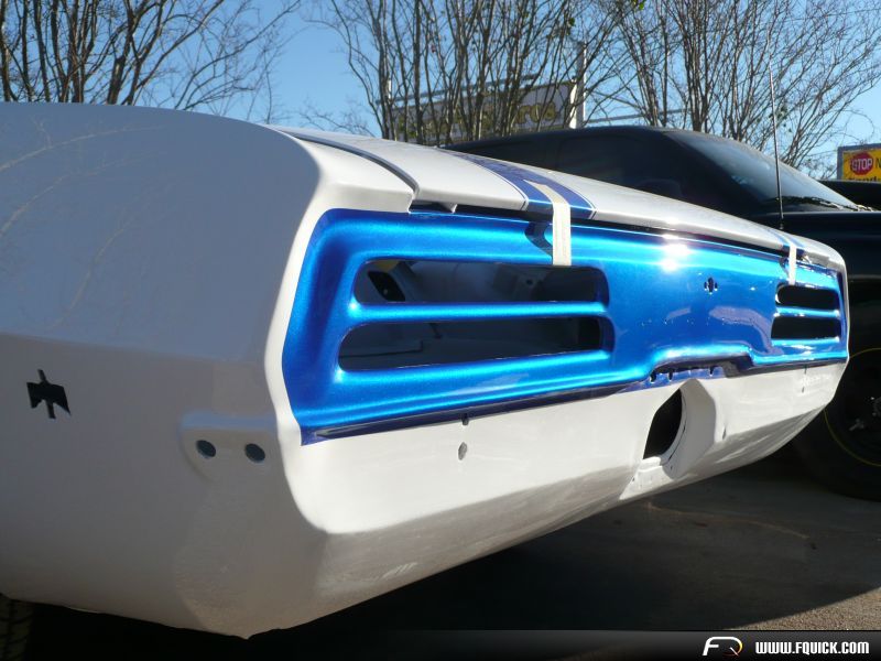

      Houston..... We have Paint!
      Well it's been almost 3 months at the body shop and I'm finally seeing color. Here are a few shots I took recently:
      Here is a few teasers
      I'm am really excited. It feels like the corner has turned and I can't wait to start assembly. Hopefully I'll have it running by May.
