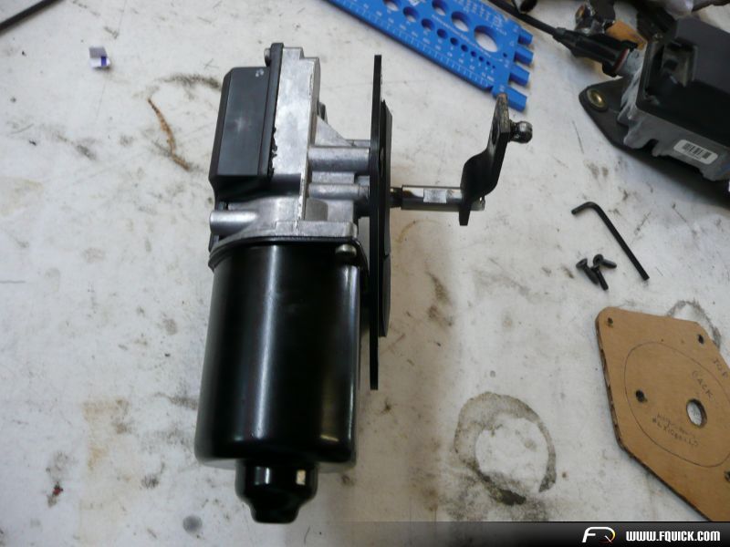

      wipers

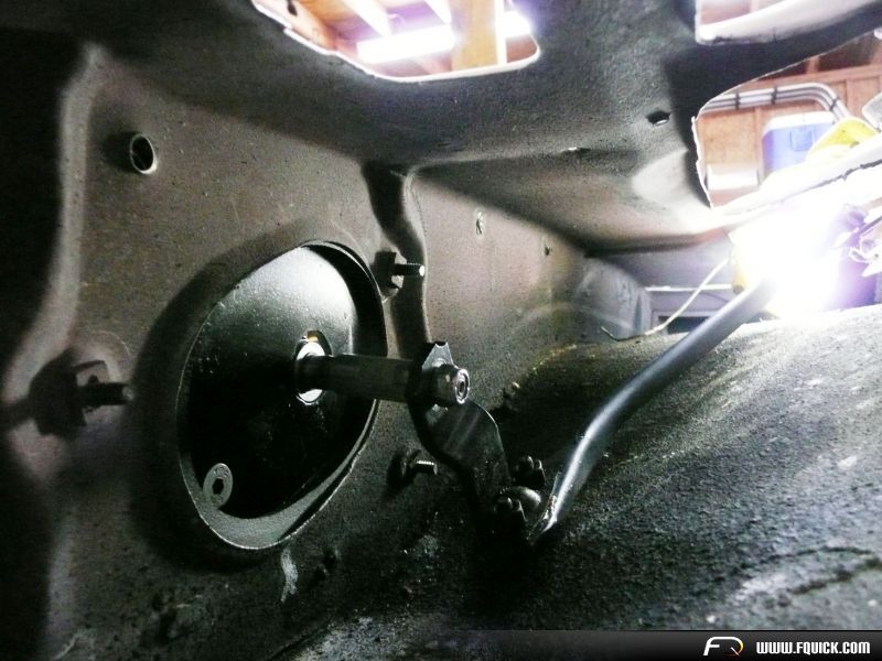

      Quote Originally Posted by SamHatco View Post
      This is a picture of everything assembled
      And here is a picture from inside the cowl with the motor installed and the wiper arm transmission installed. It looks close, but there is about a finger's width of room when the arm rotates
      Hope this helps
      Sam
      Damn nice work Sam!!!

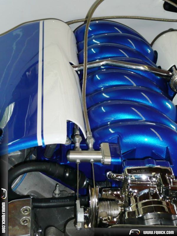

      Quote Originally Posted by zman1969 View Post
      just have one word: SCHWING!
      Oh Sam, I hate to , but that throttle body is kinda BLAH now - billet one?
      Got a delivery from Street & Performance yesterday. I think this looks a little better.
      What do you guys think?
      Sam
      Intake and stripe color is HOK Oriental Pearl Blue. White is toyota super bright white. Pictures do not do the engine justice, you just want to stand a stare, it really pops!
      I'm looking at a blue for my Dart and was thinking the Viper GTS Blue but I really like the blue you used. Is the Oriental Blue on the engine the same as the blue stripe on the car? I've been looking at the HOK color charts and it shows the Oriental Blue over a metallic base. Can you tell me which base you used?
      That is a hot color and your car is amazing! Great job!

      Quote Originally Posted by wellis77 View Post
      Thanks for the compliment. Yes it is. The color is over a silver base I believe. Hope this helps
      Sam

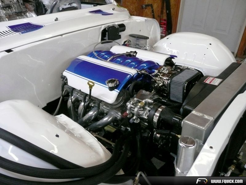

      Sam
      Hey Sam this is one nice build, beautifully done.
      May I bring your attention on something.
      I see your air filter is near the rad, it will probably suck in hot air into the engine.
      Last month, Super Chevy magazine adressed this with a Camaro and changed the air intake so cooler air would get into the engine.
      Got a few HP in the process.
      Maybe you should check this out.
      http://www.superchevy.com/technical/...ake/index.html
      Again beautifull car my son is crazy about birds and we enjoyed your build. Keep it up.

      Quote Originally Posted by 1Michel View Post
      Thanks! Yes I know this isn't the most efficient way to get air into the engine, but I needed something quick. My future plans are to utilize the hood scoops on the trans am hood. Make a y shaped intake tube to both sides of the engine and fab some type of ram air system. This is just to get me running. I've been working on this thing for 2 years and its time to git r dun.
      Sam
      Yes I know the feeling LOL and I didnt want to critisize, your doing on heck of a job.
      I remember you cutting openings on the hood too and when I read the part in the magazine I thought about your car. they gave the same reason too, LOL we'll get it running and see later.
      Again, super nice project.

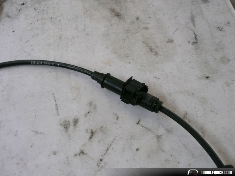

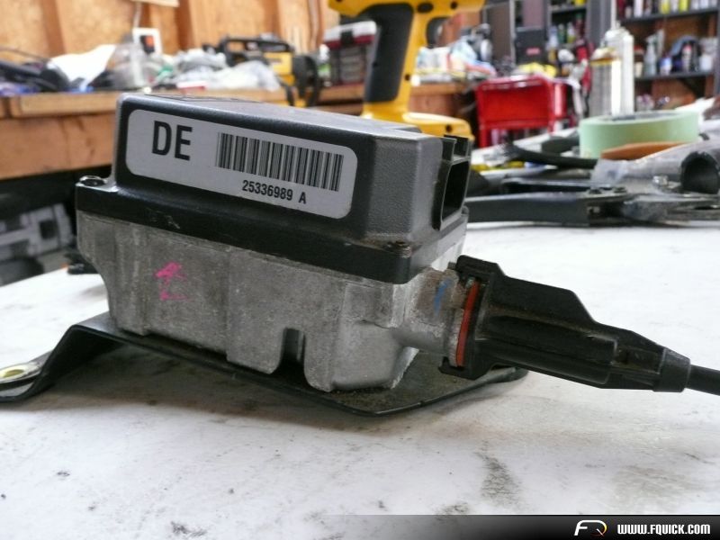

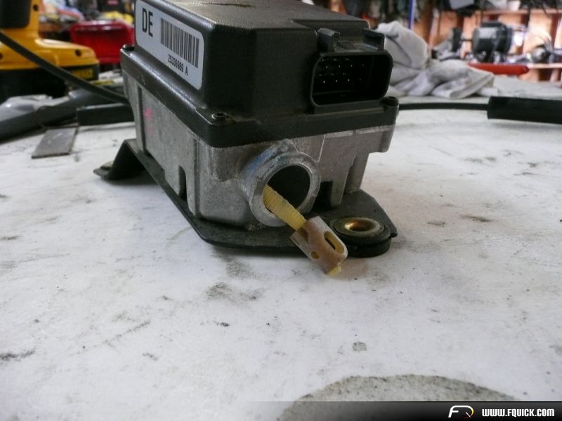

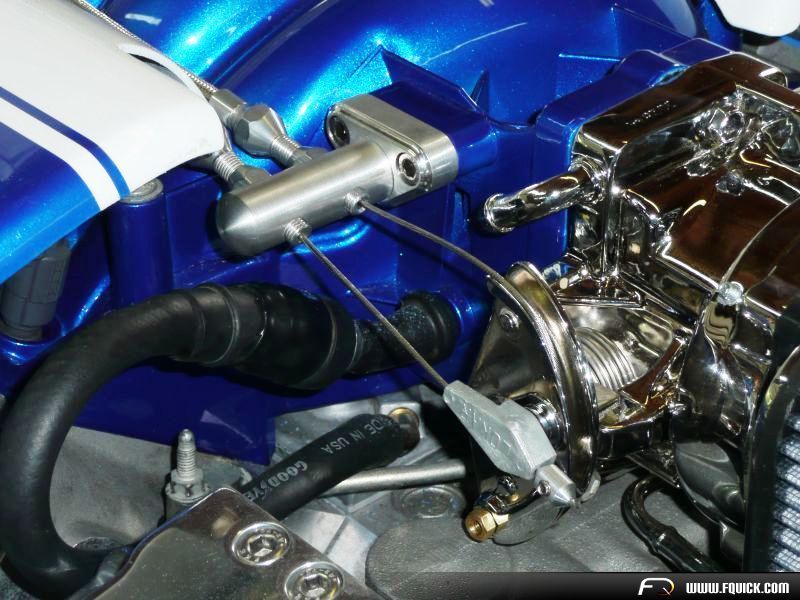

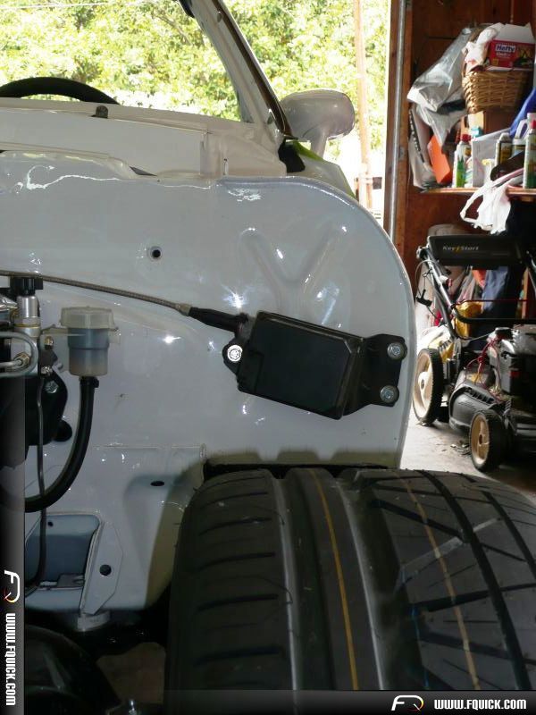

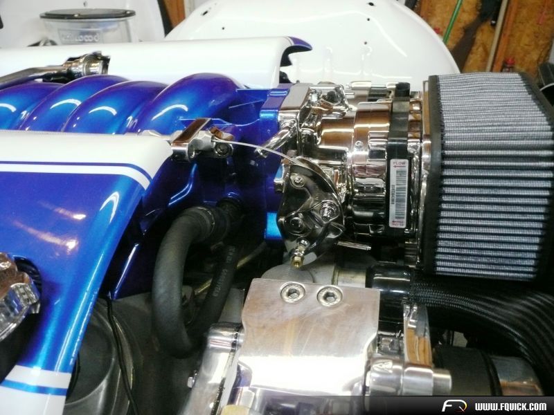

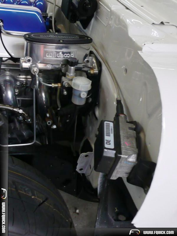

      Cruise Control Installed
      One of the items on my check list to do was to see if I could get a working cruise control. I plan on driving this car on long trips and thought it would be nice to have cruise. With that in mind I picked up a cruise control module from a salvage yard for about $30.00. Evidently there isn't much demand for these. Anyway, I studied how I wanted to incorporate the cruise control into my build and this is the solution I came up with.
      Here are some pictures of a cruise control module used by GM for the last 10 years or so. This one is from an 04 GTO
      This is a partial picture of the cable
      I wanted to keep the engine bay as clean and uncluttered as possible and after looking at the passenger side fender I decided that there is too much stuff going on with the a/c and heater lines to try and locate the module behind the fender. So I decided to locate the cruise module on the driver side between the wheel house and the firewall. Well the cable was nowhere near long enough and it looked awful. I gave Lokar a called and talked to one of their technicians and he asked me to e-mail me some pictures of the control module, the same ones you see here. He promptly got back with me and said there was no problem making up a cable to adapt to the GM controller. He told me all he needed was the cable so I sent it to him. They made up a 48" cable for me and here is the installed pictures. The people at Lokar were very easy to work with. It was a pleasure doing business with them, I highly recommend them.
      I think it turned out pretty nice. Once the fender is installed with the controller located behind the fender on the driver side the only thing visible is the cable and it blends in with what I have done so far.
      Next up the wiring, ugh.
      Sam
