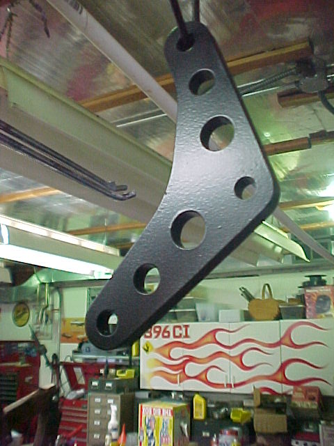

      Put some time into the A/C Bracket build. Spent around 3 hours getting the compressor lined up with the pulleys and set at the same angle in the chassis.
      Trimming the laser cut brackets and making the spacers so everything lined up correctly took some time.
      I used an angle finder to make sure the pulley matched the angle of the engine, so it is square. A straightedge on the pulley let me line it up fore/aft.
      After a bit of welding I have a functional bracket.
      The bottom bracket in place with it's spacers.
      I'll run it and the alternator pulleys thru the blaster tomorrow and get some primer on them.
      Now, with this done I can get the front suspension installed.

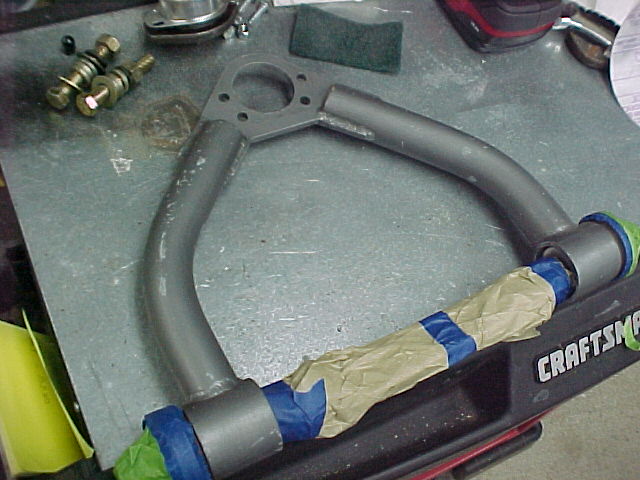

      Hit it pretty hard out in the shop today. Pulling together the front suspension stuff, I had to repaint the upper arms as they had a hard life during the build stage. Lots of scars and scratches from years of mock up and mock down...
      Looks better with fresh paint.
      Painted the upper ball joints as well and I am ordering Grade 8 bolts for the UBJ's instead of the cheap azz hardware that came with them...
