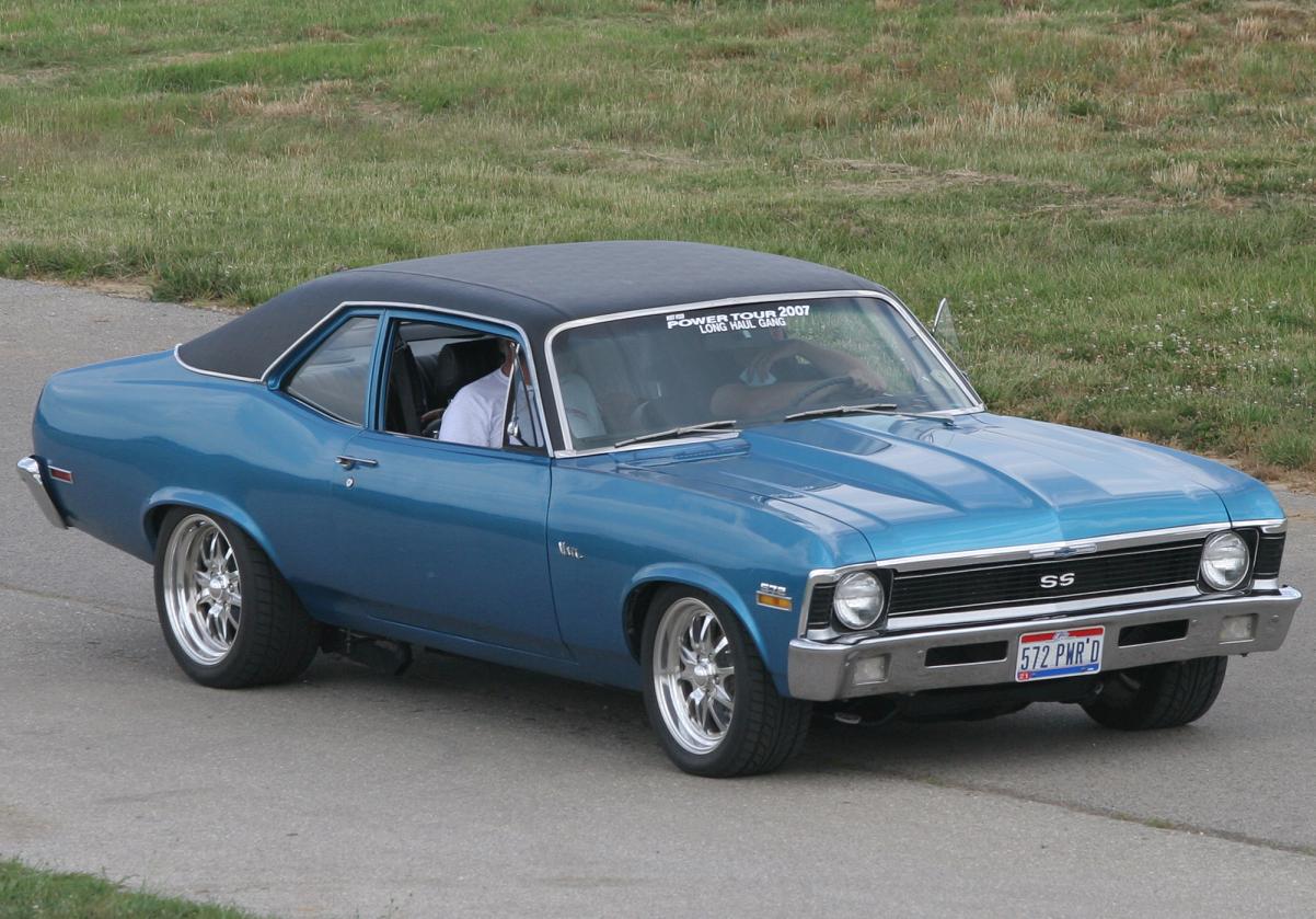

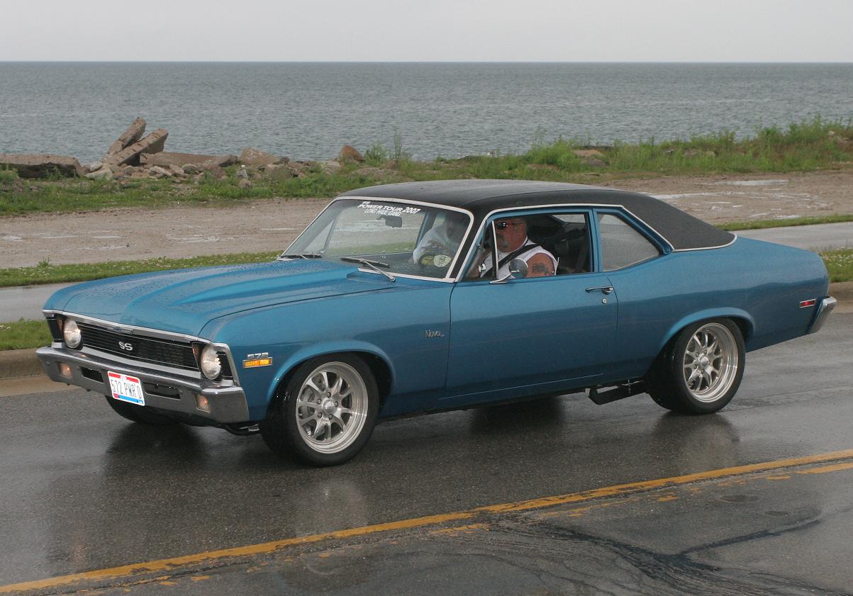

      lookin good! luck sob ....got to go on the power tour!!!

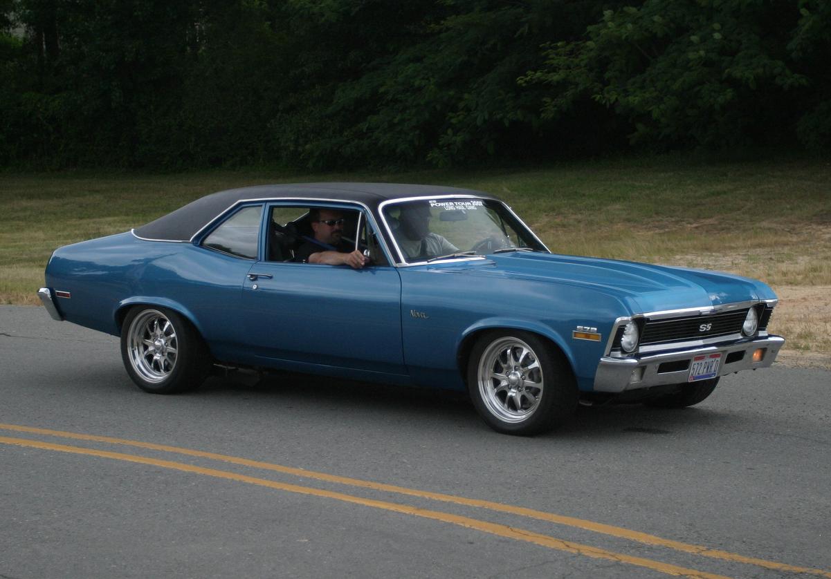

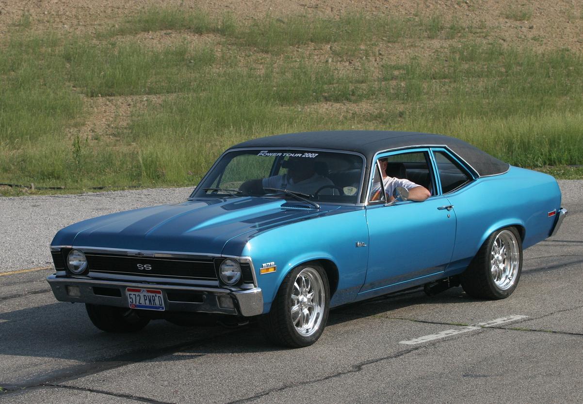

      Lookin good Dan. Defintly a awsome example of a pro-touring Nova.

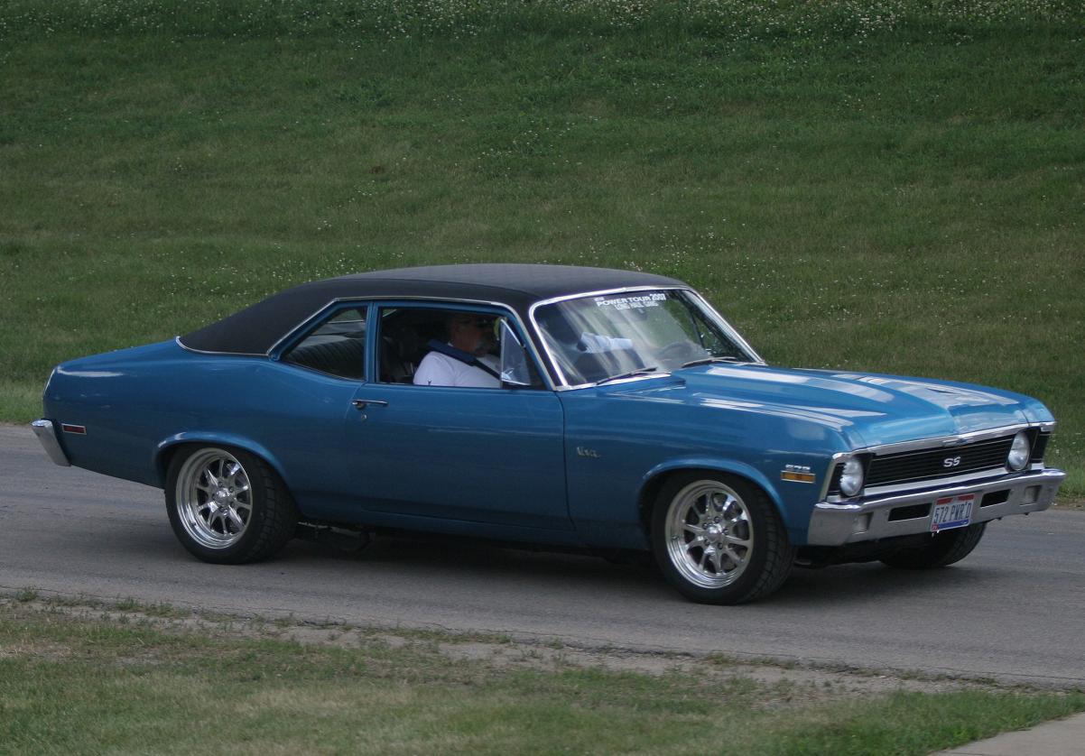

      Dan you nailed the stance w/ your new setup. What were your impressions of the car after all your updates?
      71' Nova - LY6, T56
    8. #168
      Delaware, OH
      1,379
      Quote Originally Posted by NvrDun71
      Thanks! Overall driving impressions were consderably better with the new uncut front coils and tubular As. It's amazing how much better the front end rides with UNcut Hotchkis coils. I guess cutting the coils changes the spring rate somewhat. All-in-all I'm pleased with the suspension setup and the nice thing is that it's just a bolt-in setup with a good alignment (following GWs alignment specs).
      Did you get your new wheels yet?
    9. #169
      Houston,TX
      1,159
      Quote Originally Posted by dhardison
      Awesome man, a bolt in affair w/ no coil cutting really makes it nice. Looks as tho the DSE lowers gave you just enough extra drop w/ the drop spring pocket since you didnt have to hack the front coils down. Front wheels are on order, it started out as a three week build time that has turned into 5 weeks going on 6 so far, so hopefully any day now. At least the tires are here I guess....
      71' Nova - LY6, T56
    10. #170
      Delaware, OH
      1,379
      Yeah, actually the pockets in the DSE lowers were too deep for my tire/wheel set up. I had to install a pair of GW aluminum springs spacers (3/8") to gain a little tire->fenderwell and header->ground clearance (I may have already mentioned this to you - old age is a b!atch ). It sure did look bad-a$$ sitting down low though! I had to go with GW uppers to clear the tall-deck headers. Hope you get your wheels soon!
