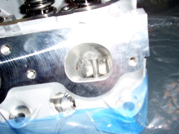

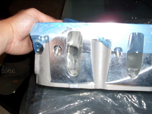

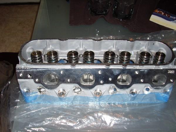

      well its been a while just thought id throw up some pics of the heads going on this car :
      and
      and
      these are Livernois CNC stage 2
      just got these and I am ready to build the motor now!!

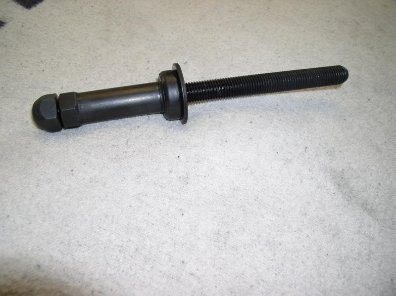

      Ok making some progress - on my own - not my body man - have gottem motor assembled from the shortblock
      to a long block - seems to go pretty easy but its no SBC or BBC - oil pump, cam timing chain-pretty straightforward but theres no dowels to locate front or rear covers or oil pan - basicly rear cover is centered by the crank- bolts left loose then front cover is installed and balancer- that centers front cover then oil pan goes on- then bellhousing is bolted up and tightened down then front and rear covers are tightened - of course mt U/D pulley hadent arrived when i was ready so i used stock balancer to get assembled- then had to pull - which is a PITA even with the right puller. I did buy a tool from a guy on LS1Tech that makes installing them a dream- cost 44$ shipped - check it out:
      pretty neat deal and pushes it on like butter if interested heres the link : http://ls1tech.com/forums/showthread...ight=installer
