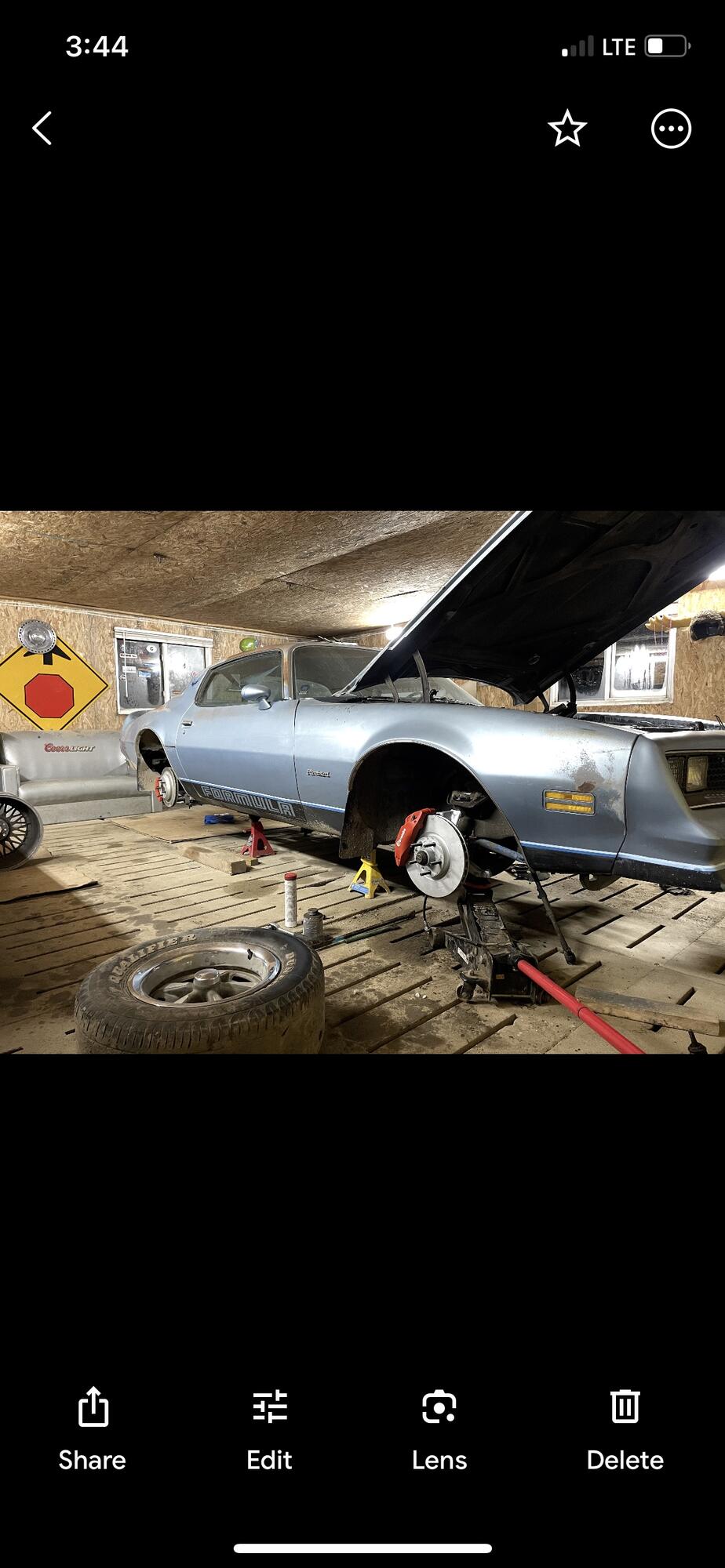

      Hey guys.
      Im running a 1 1/8 wilwood master
      C7 corvette front brakes
      C5 corvette rears
      Can that go thru the stock proportion valve of my 77 firebird. Im under the impression that the front is not getting all the fluid it needs.

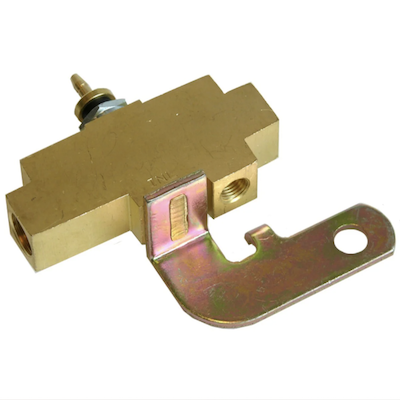

      Inline Tube sells a combination valve that was used on '70 Cutlass models (A-body) disc-drum cars and '70-'72 drum-drum brake cars. This valve does not have the proportioning function built-in. The '70 disc-drum cars used a secondary valve at the rear of the car to handle the drum proportioning for the rear wheel cylinders; the '71 and later valves were called combination valves because they were both a distribution and proportioning valve.
      I don't know if this part is similar to the 2nd gen F-body so do your homework, the part number is PR107 and sells for around $80. I'm using this valve along with a rear proportioning valve at the master cylinder on my '72 442 convertible project; C5 front w/13" rotors and '01 Blazer w/11.6" rear discs.
      Here's a pic of the valve from Inline Tube.
      Rodney
