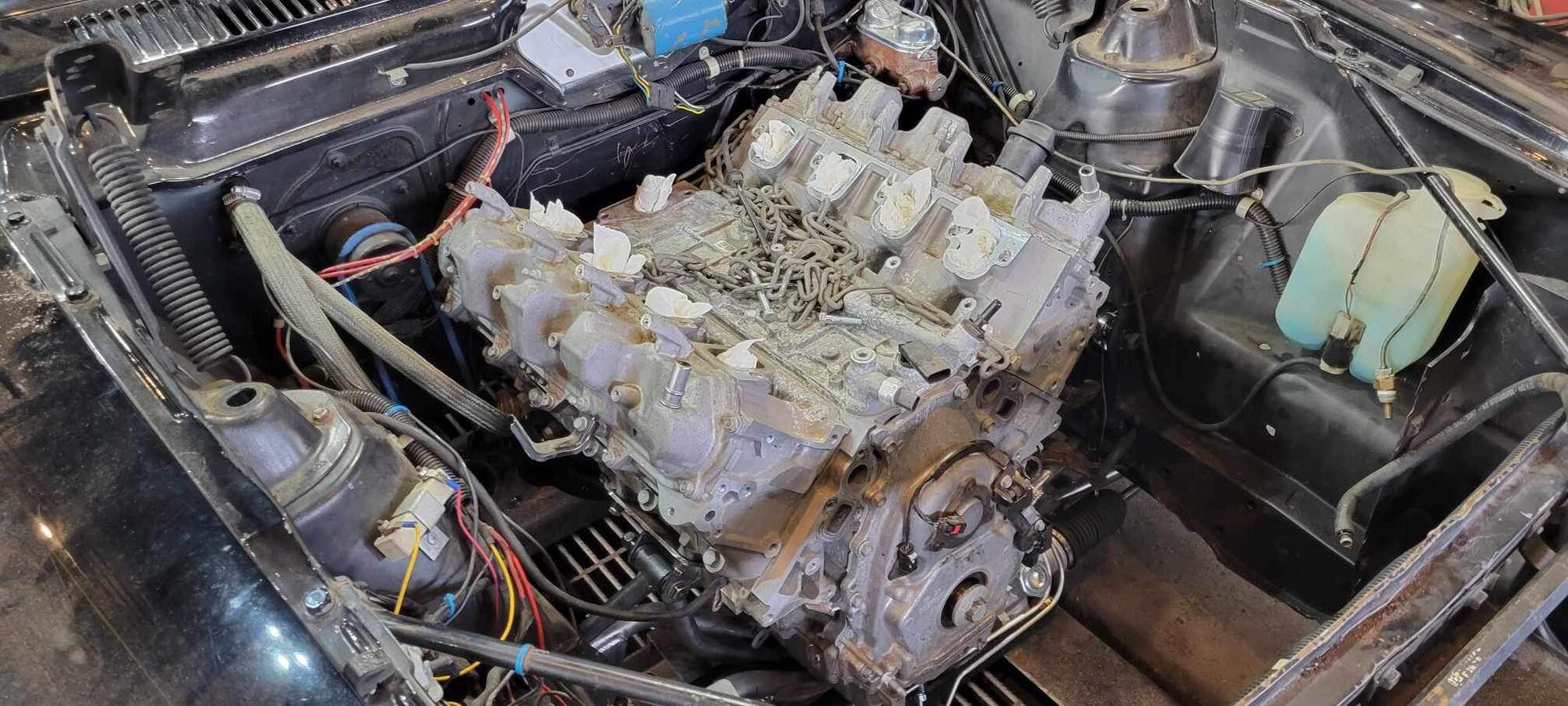

      So, after years and years of being gone from this forum, I'm back!
      This summer I bought a 70 AMX that had some custom metal body work done years ago so it was, IMHO, a perfect candidate for a pro-touring project. The 390\4 speed needs some love and instead I have opted to give my 2018 Denali donor 6.2L L86 a new home in it! I have the BTR Stage 2 Cam, dod\afm delete, blah blah blah. Ill ditch the 8l90e trans and look for a TR6060 or Super Magnum T56.
      Dropped the coin today on the Control Freak full suspension\steering\braking upgrades and that should be delivered in 2-3 weeks.
      Is this possibly the first 1st gen AMX to get the pro-touring treatment? I did a search here for AMX and came up with nothing?! Wish me luck (and help me find a turn-key trans!) lol

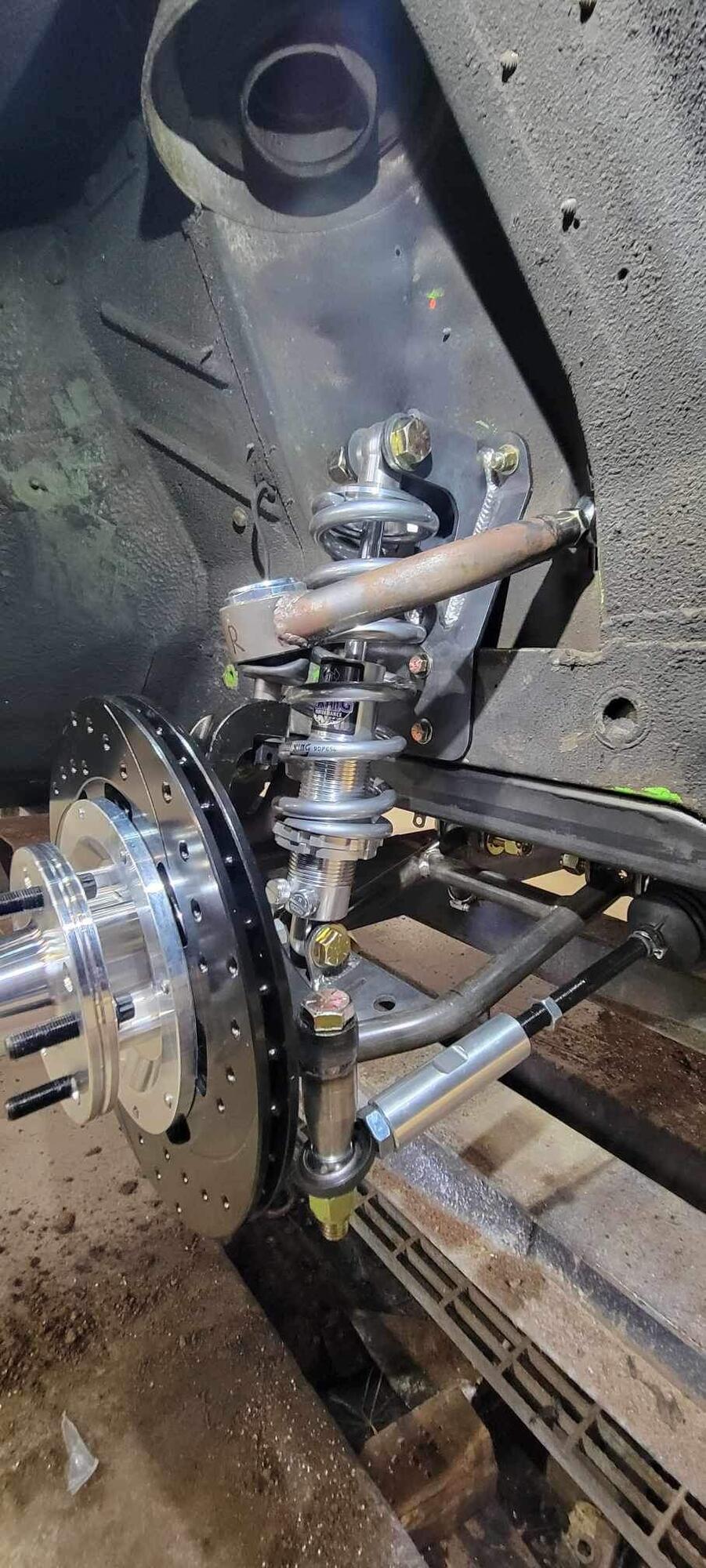

      390\4 speed coming out this week. Control Freak package should be to the shop in a week or so. Trying to get a t56 ordered up with all the kit needed to install asap. Im in contact with a few trans shops but if any sponsors here that can help, let me know.

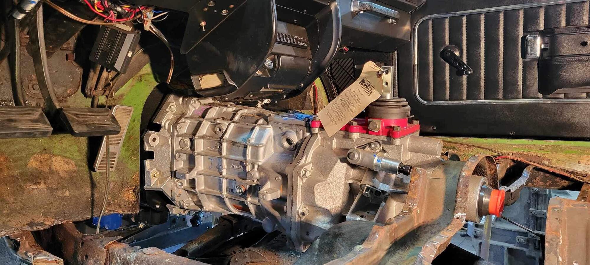

      New Tremec ordered and old 390/4 speed sold FAST to a dude that couldn't drive cross country fast enough. AMC guys are fanatical! lol

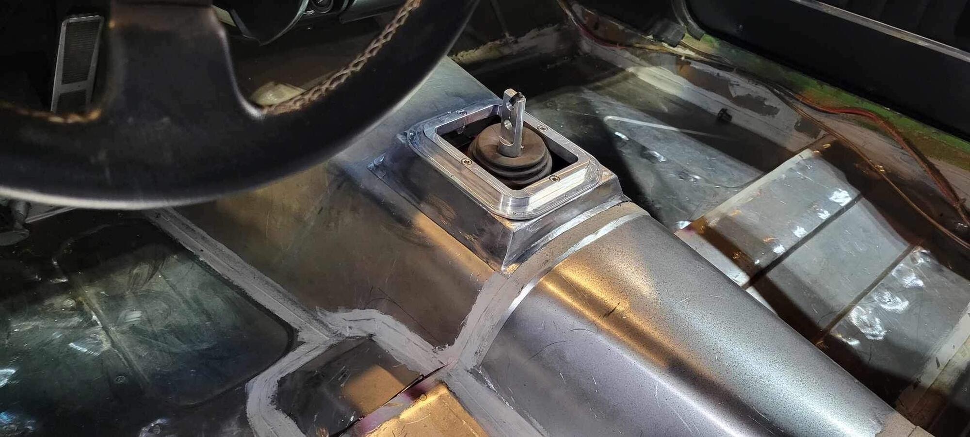

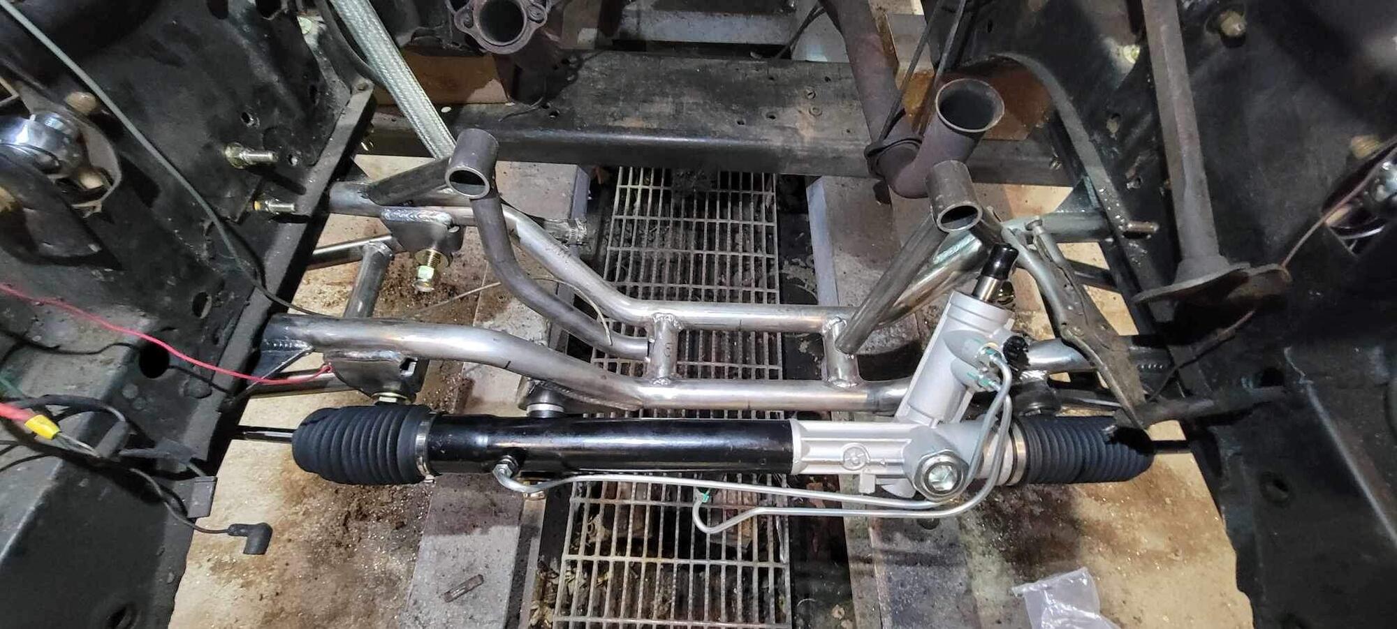

      Mockups are done.. found some unsurprising rot that needed to be dealt with in the inner rockers.

      New floors and inner rockers done. Suspension just about all mocked up with L86\T56 Magnum. Soon off to next shop for undercarriage prep and coating then final assembly. Playing with the idea of adding a LT4 blower while it's at this stage.
