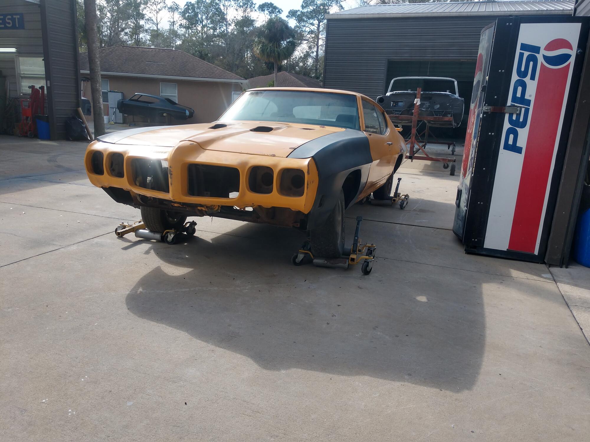

      Hey guys. I sold my Hurst Rambler today so I figured it would be a good time to start building the Judge. I plan to keep the body fairly stock since it is a real Orbit 70 Judge. I'd like to add coil overs , probably something like an LQ9 and a TKX. I like the look of stock style Rally 2 wheels and found a couple options. Unfortunately they don't come in anything over a 9.5" wide. I was thinking maybe 18" front and 20" rear. I'd love to stuff a 305 in the rear, but it won't happen on a 9.5" wheel, so unless I go for another style, a 295 is probably a big as I can go. I have to restore the car too but I'm hoping it won't take too long. Any recommendations on coil over kits? I'm trying not to break the bank on this one and will not be doing any sort of racing, I just want a good tight ride and I like the height adjustability of the coil overs. And if anyone has seen a nice reasonably priced wheel that might look good I'm open to others. I found a 295/30/20 at work and there is plenty of room. US Mag or Rev 9 is what I was looking at for wheels.

      Ok. I finally got the outer wheelhouses and quarters finished up. I've been looking at different options for the drivetrain. I had talked myself into a LT1 and a 10 speed, but last night a deal fell into my lap on a 2012 Corvette. Obviously I can't use the trans so I'd have to get that figured out. Probably go with a TKX. Does anyone know if I could make the Corvette brakes work on my car? I see some F and G body conversions, but I don't see anything for an A body.

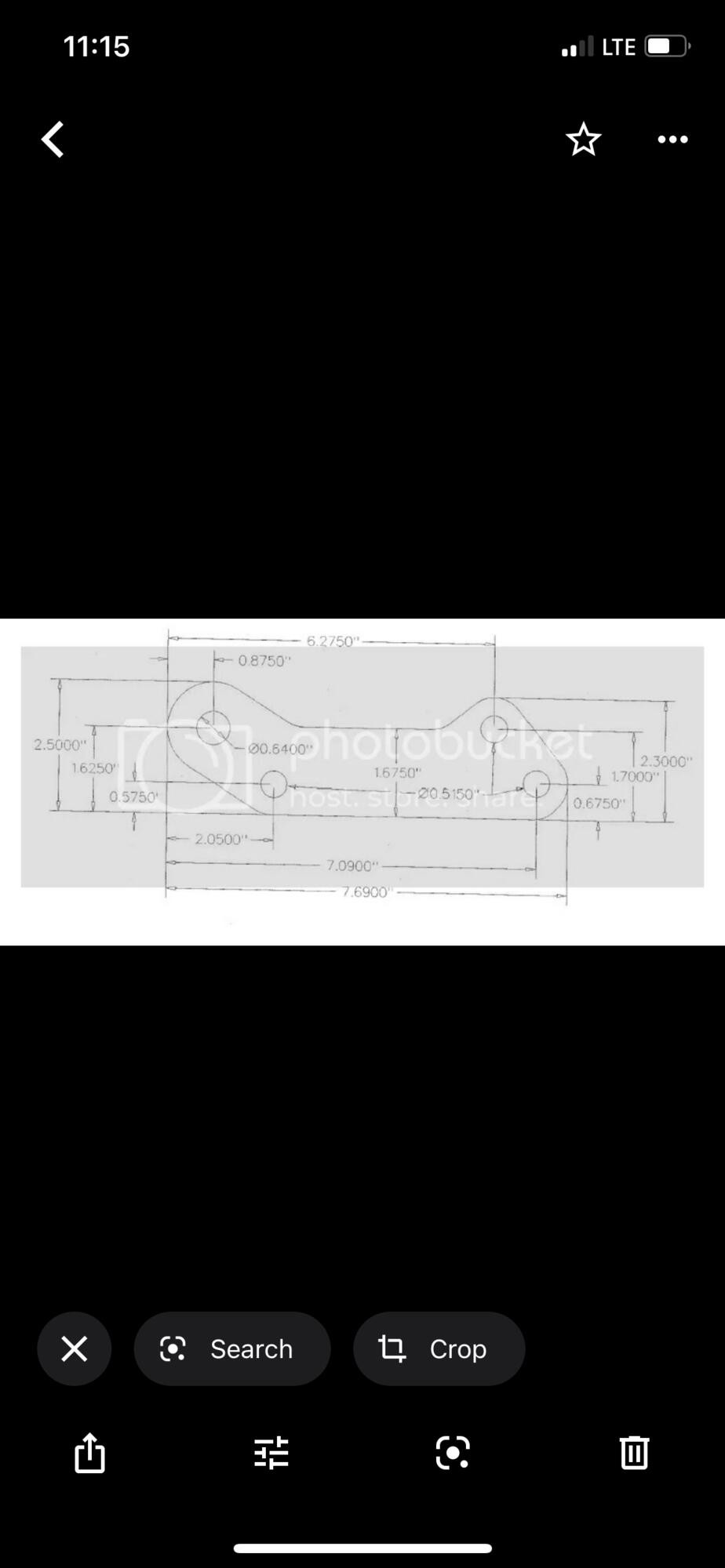

      There is a template on the internet but now i cant find it. I used in on my chevelle. If you have access to a laser cutter. It also requires a small bushing and you need drum brake hubs. Ill dig for some pictures if i still have them
      You can also machine down ur old discs brakes to hubs. Press in bigger studs and use the corvette rotors

      Interesting! We do have a small machine shop at work. I bet my guy could machine them for me.
