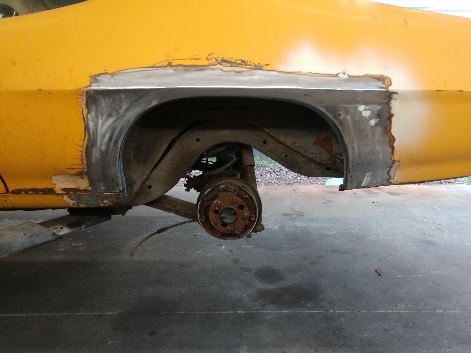

      Ok. I almost finished the outer wheelhouse and partial quarter panel replacement. Time to start moving forward. As I mentioned earlier, I picked up a 2012 Corvette with an LS3. I've been looking at motor mounts and swap kits. Anyone have any recommendations? Some of these (for example Sikky) can be pretty pricey. Others, like a Hooker headers kit, are not too bad priced. Anything special I should be looking out for or to be careful of? I'm still not 100% sure on the trans yet, but it's looking like a TKX is at the top of the list. I super don't want to modify the tunnel, but unless I run an old 4 speed I'm not sure I can avoid it.
      Apr 2016
      245
      Holley clamshell motor mounts and transmission crossmember, speed engineering headers
