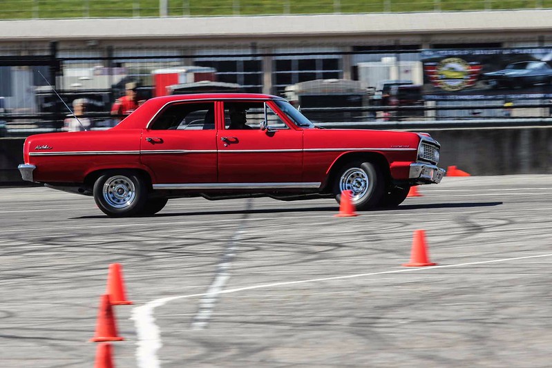

      Starting with front, from my experience.......I've done a handful of different things with my rig....Stock front lowers and spindles/SPC uppers/hellwig 1-3/8 sway bar/SPC springs, then upgraded to UMI rod end uppers/CPP tall spindles/stock-style tube lowers to now (hasn't run yet) keeping UMI rod end uppers/QA1 coilover lowers (because UMI is backordered), Speedtech aluminum AFX spindles, ABC performance sway bar and ridetech triple adjustable coilovers.
      I can attest to KYB Gas-a-just Shocks, some lowering springs, polyurethane bushings and any decent sway bar to be SOLID for ALL street driving and OK for an autocross event once or twice a year. This is a relatively inexpensive option as well. You aren't going to turn many heads on the track but itll at least not be a handful out there.
      That setup above upgrades with tall spindles and rod end uppers/poly lowers on coil springs, with UMI tubes out back got me 16th overall in the Grand Champion class at LS Fest 2020 on my second ever racing event, so I'd attest to that being a OK setup for autocross once or twice a month. But its a little more expensive, and I wont even touch on brakes/wheels and tires which were a HUGE difference.
      As for steering....highly recommend the tried-and-true jeep cherokee box. Quick ratio with internal stops. Cheap and available from oreillys/napa/autozone, requires a different rag joint. I also recommend a flaming river intermediate shaft and bump steer kit (if the cars lowered), both of those things do HUGE HUGE things for wheel feel and smoothness......
      TLDR::: Front upgrades come first, and if you run out of budget then put some poly bushings in your stock rear arms, or BUY MY OLD STUFF and some new bushings for em, UMI adjustable uppers/stock length lowers. Serious about this, i want them gone. Also have CPP spindles, C5 brakes and some other crap too.
      It depends on what you do with the thing! For a driver you don't need to go crazy whatsoever.
      I personally strive for some Ultimate Streetcar events and autocross every week if I can so I went with the best I could up front and built a custom 3 link/Watts link for the rear to maybe compete with some camaros and corvettes.
      Just my .02
