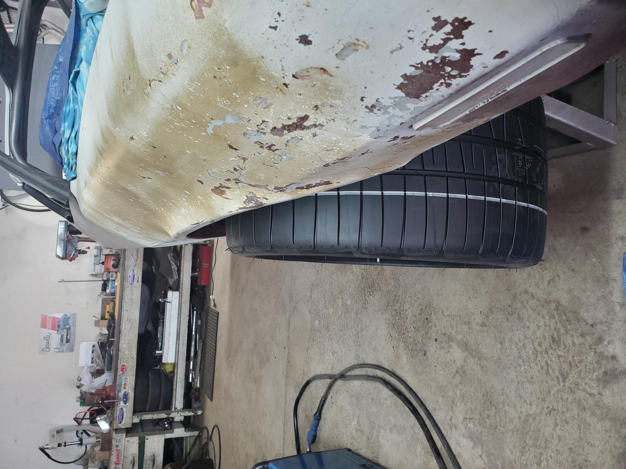

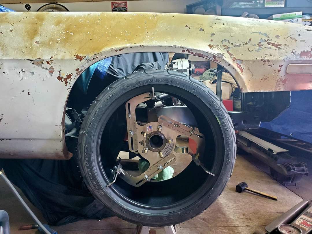

      Just a little late getting back to you... I did install the global west coilover mounts. I have the speed tech low clearance upper control arms, lower control arms and afx spindle. Car has not been on the road yet so no review on how well it works. The shocks that came with the chicane kit from speed tech were the viking coilovers. These have a extended height of 14.25 inches and 10 in compressed. Installed with everything mentioned, the ride height was too high, so I will need to find a shorter shock to drop it back down 2 inches.
