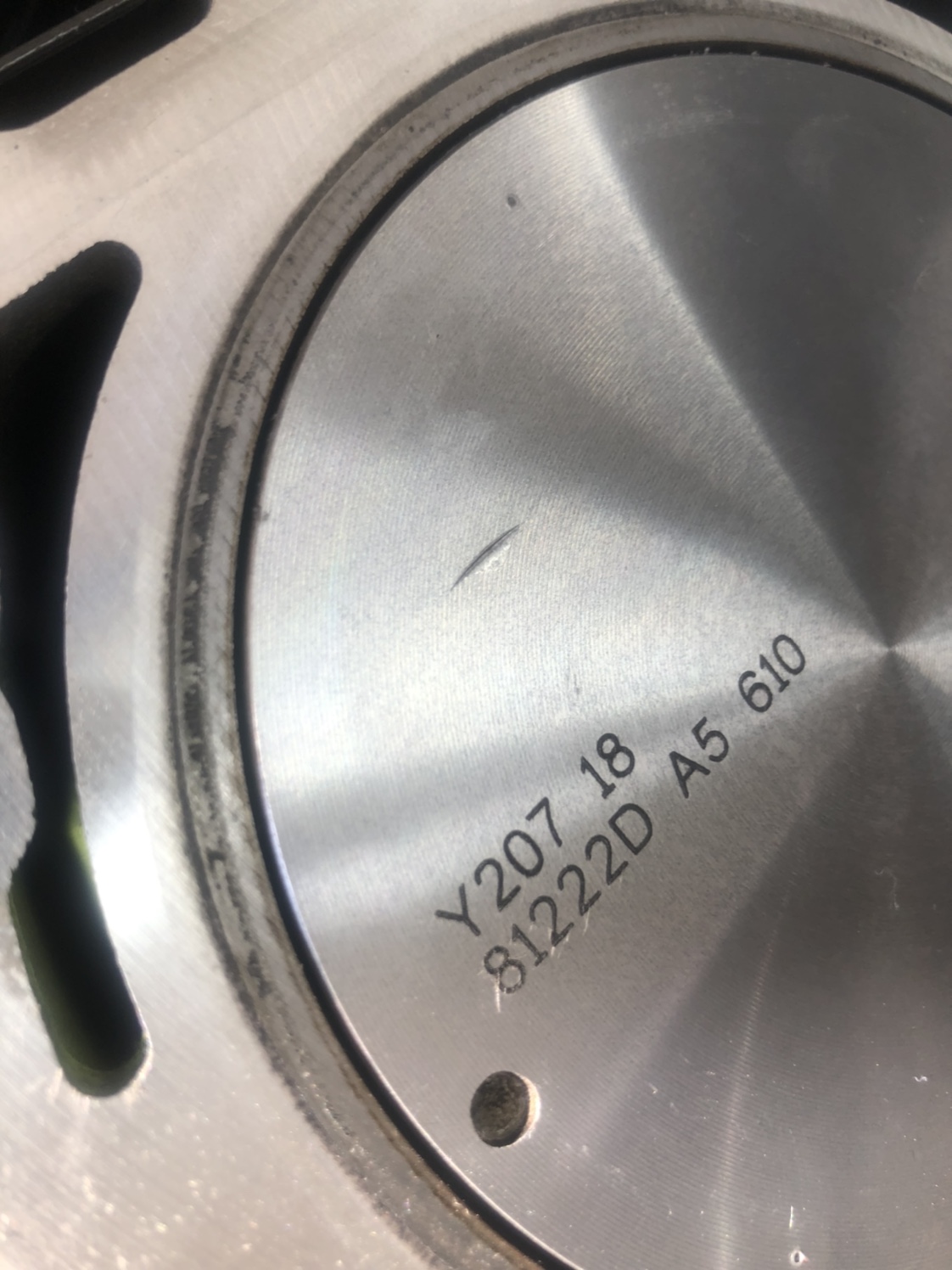

      Finally pulled one head cam looked good as i spun it around. But my valves ever so lightly hit the pistons. Good thing is the valves arent bent and seat fine
Size:  334.5 KBName:  64634732529__E05BA1ED-0817-4937-B3C5-496F61819C52.JPG

      Always a good idea to check PTV clearance when swapping cams. That’s why I asked way back in the beginning of this thread. There is a ton of information out there on how to do it. The springs etc are cheap.

      Just pulled passenger head and only piston #2 has the same mark on the intake
