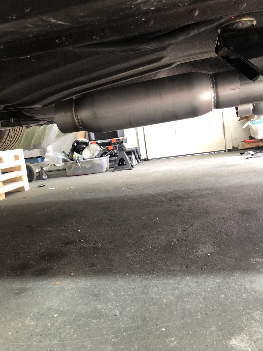

      I did notice black marks underneath by the header collector i have the exhaust rigged for tuning purposes only. Could that make a tick noise or is it too far down Name:  64003717164__D2E61D25-B0E0-460A-B94A-8ED9668A6438.JPG

      The exhaust pipe is pretty stiff. U can see i used safety wire to tie it up and with the cam the engine rocks alot while idling. Maybe the tick is coming from the header collector that may have worked loose

      Sounds internal to me and that rocker suggest the head has to come off and its lifter related.
