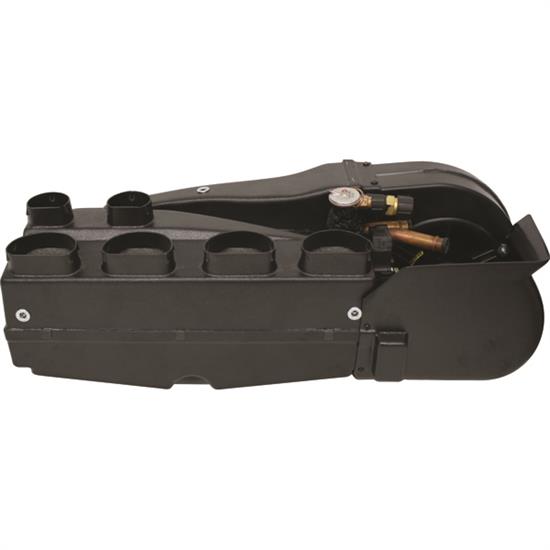

      That appears to be a Gen 2 compac. I have had several of them. In the summer, you need to run the fan on high or it will freeze over even at lower demands. I have made several trips with these units and after around 75 miles, the evaporator will freeze at low or medium speeds. If all you do is short trips, you won't have this problem. This is only an ac problem. I have visited with the Vintage Air techs on several occasions and have found out that is a downside of Gen 2 units. If you have space, you might consider a Gen 4 unit. I have a 2000 Dakota RT and the blend doors have lost their sealing sponges. I have yet to find a source for those parts. I may do what you are doing but I will look at the larger units to see if that's a good fit. I'm sure the waiting is tough for you. I hope somebody get's in gear to get your truck moving forward. Best wishes on your project.
      On the sealing foam, you'll likely have to find a sheet of something similar and make your own. Amazon has some promising products, search "open cell foam weatherstrip sheet". A little tacking spray will hold it all together.
      My unit is actually a Vintage Air 61005-VUX-A Vintage Air Gen-II Super Cooler. It has 4 dash vents, not 3, plus the defrost vents. I appreciate the warning on the Compac, it's actually what I traded in to get the Super back in 2021. I'd actually bought the Compac for an El Camino project about 25 years ago and never used it. It sat in the attic, forgotten, until this project came along. Have you heard anything about the Super unit having similar problems?
      When the truck comes back and I get to installing the air I'll be working out a way to use air filters, and thanks to other advice on this board I will be installing it in a way to make it easy to remove for repairs. I had to replace the evaporator on my 2005 Dodge, after I worked on the air I discovered it had a pinhole leak, and that was a mess - required removing the steering wheel and the entire dash.

      All the GENII units have that problem. Getting the capillary tube installed properly goes a long way in preventing freeze up. As noted earlier, turn the temperature warmer instead of turning down the fan speed. The only fool proof way is to hide the thermostat that controls the compressor and set it so it can't blow colder than about 42* under any circumstance.
      The GENIV/V units are light years ahead of the GENII and I put them in everything I can.

      Thanks, I'll think about the Gen2 vs Gen5. A lot will depend upon how much room is behind the dash when the time comes. I plan on an aftermarket dash for it, most likely one of these two.
      I believe I have found a generic solution to any HVAC system freezing up.
      https://s3.amazonaws.com/s3.supplyho...oduct-Info.pdf
      This is a simple switch that opens at 36F, then closes at 46F and it goes inline with the compressor relay wire. The Honeywell Trol-A-Temp Freeze Protection Control, Model FPC is 50-80 bucks, but it may be available for less, and there may be other brands.
      I'm going to go with my Gen2 unit mainly because I've already got one sitting on a shelf in my garage. Plus, it's a couple of inches narrower than the Gen4/5 units I looked at of the same capacity so it'll tuck into the firewall closer. But, I do like the 3 button switch on the Gen4/5, and would go with it if I didn't already have a 2 on the shelf along with a plan to deal with the freeze-ups.
      EDIT - I ordered one of these switches tonight. When it comes in I'll test it with a multimeter and an ice cube.

      You are going to hate that 10 degree swing in vent temperature.
      The unit already has a temperature control switch, and it is adjustable. Get the capillary tube installed properly and it will all be fine as long as you never turn it below freezing.
      I plan on installing the capillary tube when the time comes, this will be like a hard limit switch on it that is inline with the thermostat wiring to the compressor. I can't count on being the only one who drives this, although for the first few years I will be. The temp swing was the tightest I was able to find and I wanted a way to protect the evaporator against freeze-ups. I'd rather the temp from the vents vary than the evaporator freeze up and not blow cold air at all or worse, be damaged. But, that's a worry for a long time from now.
