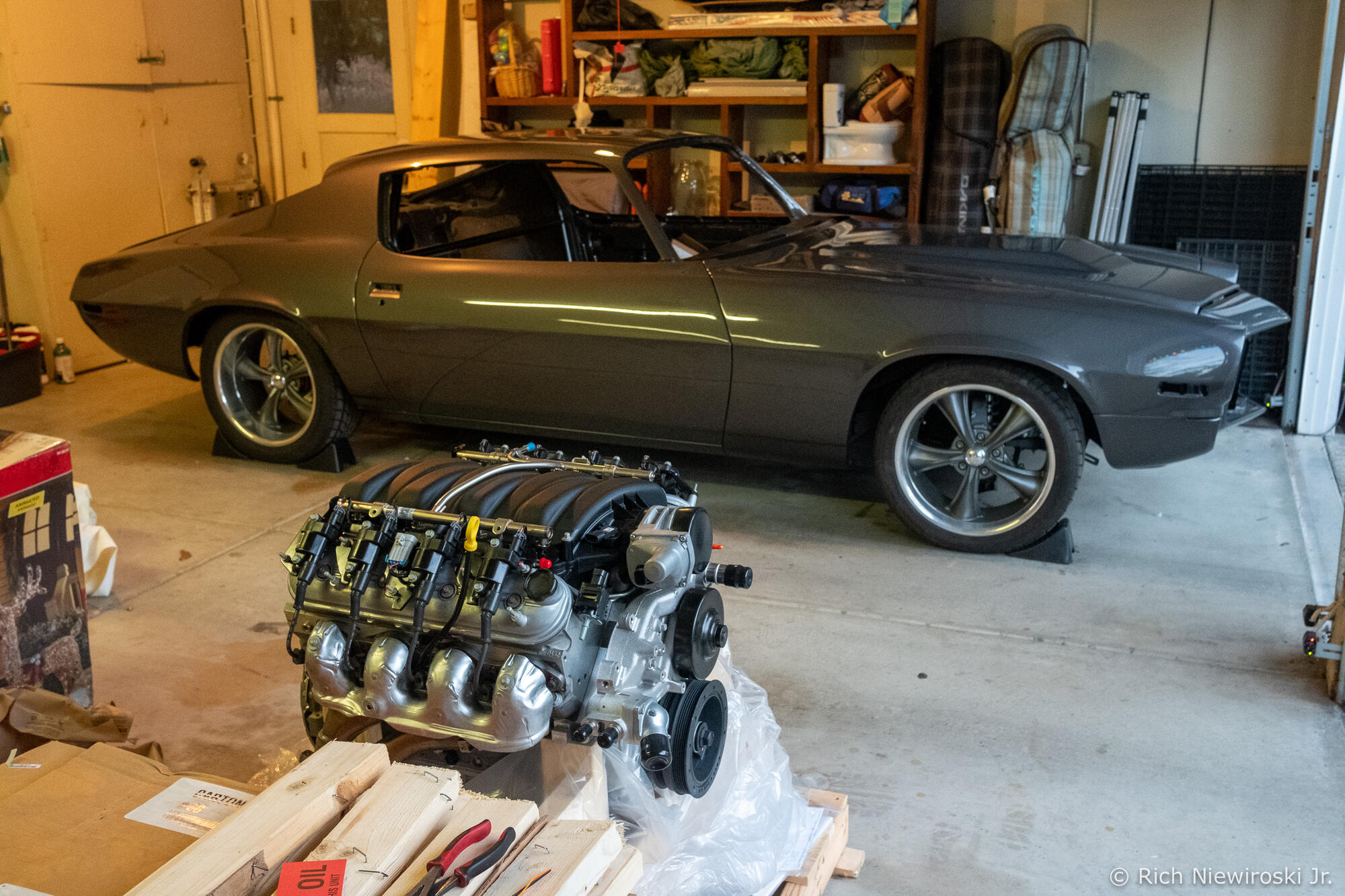

      Hey all. I could use some help figuring out how and where to cut the trans tunnel for my project. You can read where I am in the build here, but the TLDR is... I'm doing a second-gen Camaro. I have the a completed body with paint done. It's mated to a fully assembled and complete Speedtech ExtReme subframe and torque arm. The rear is complete. Mini tubs are installed. The transmission tunnel is installed. It's sitting on wheels that won't be used on the completed car. I have the following parts in hand, but not installed: LS427 engine, T56 transmission, clutch, bell housing, brakes, AC, steering column, and some other smaller things.
      It appears the next bit of business is to mate the engine and trans and get them into the car. I don't have a lift, so they'll be going in through the engine bay. I've been told it's going to take several runs of placing it in and pulling it out to make sure everything is set. No problem there. What are all of the dependencies I need to address before the pair can sit inside the body "permanently"? I'm talking about this like, I know I'll need to make a cut in the tunnel for the shifter. Would love to know how I go about determining where the cut is made and what kind of template I should use for it. What other things must happen before the engine/trans can "finally" be placed?
      Any and all feedback is welcomed. Thanks.

      Ok, so besides getting the assembly together and getting it actually into the body, it sounds like I really just need to worry about the tunnel cut for this next step. So a couple of questions here.
      • Should I installed the clutch, bell housing, and trans on the engine with it on an engine stand (don't have one yet)? On an engine hoist (do have one)? Is the crate that the engine comes sitting on good enough to support that installation?
      • Would it be easier if I just removed the front end with radiator support entirely? Or is that not worth it? I don't mind putting in this time if it makes it easier, but I'm not sure of the value of this.
      • I'm guessing when I'm putting the assembly in, I'm doing so without the trans support crossmember? After I get the motor bolted in, do I put the support back on to determine where the cut should be made?
      • Can you give me a little more details on the logistics of "seeing" where to make the cut? I'm guessing it will probably make sense after I have the trans in, but I'm just having a hard time understanding if there's enough room to see where it should be made.
      • In terms of the actual cut, I'd rather leave it large enough for maintenance in the future. Is there some sort of template I should be following or do people just make it?
      • After the cut is made, the assembly is in, and the shifter is reattached, what's used here to "seal" the cabin from the outside?
      Thanks so much for your time on this.
