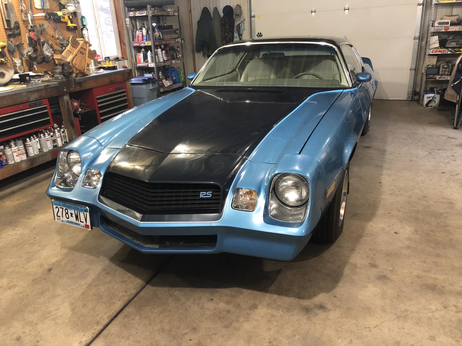

      Couple of picsName:  IMG_0449.jpg
Size:  238.4 KBName:  IMG_0450.jpg
Size:  246.7 KBName:  IMG_0449.jpg

      Looks cool and a good starting point!
      Minnesota plates... how's the rust situation?

      Car was Ziebarted when it was brand new. So with that and the low miles it's totally rust free. Pretty crazy for a MN car. The down side of the Ziebart treatment is it's on all the bolt threads and makes them bind up as I remove them.
      Tonight I'm working on getting the front bumper off. Then the complete front clip.
      Earlier today I redid the head liner. Typical glue released on the 40 year old head liner. Easy fix. New marine vinyl from the local Johann's fabric shop. Total cost about $40.
      When you do the math for a 1980 Camaro with 28000 miles that's about 700 miles per year.
      Sorry about the double pic post. Just getting the hang of it.

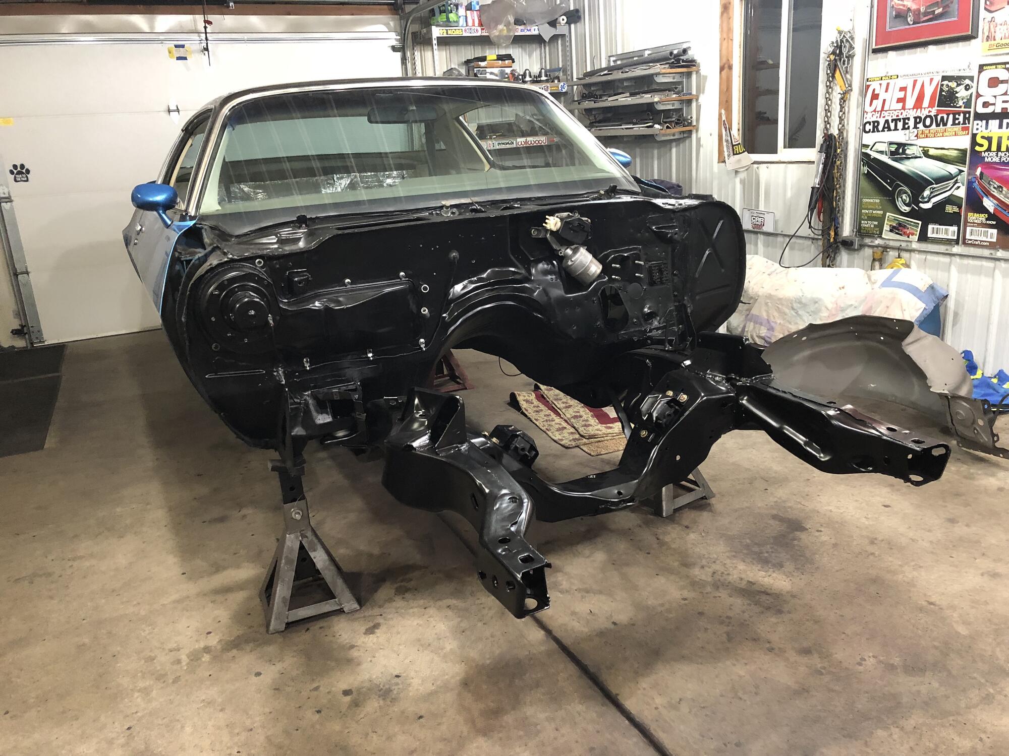

      Project update. Subframe back on. Test fit for the L92. See attached pics.Name:  IMG_0512.jpg
Size:  381.0 KBName:  IMG_0516.jpg
Size:  399.6 KBName:  IMG_0512.jpg

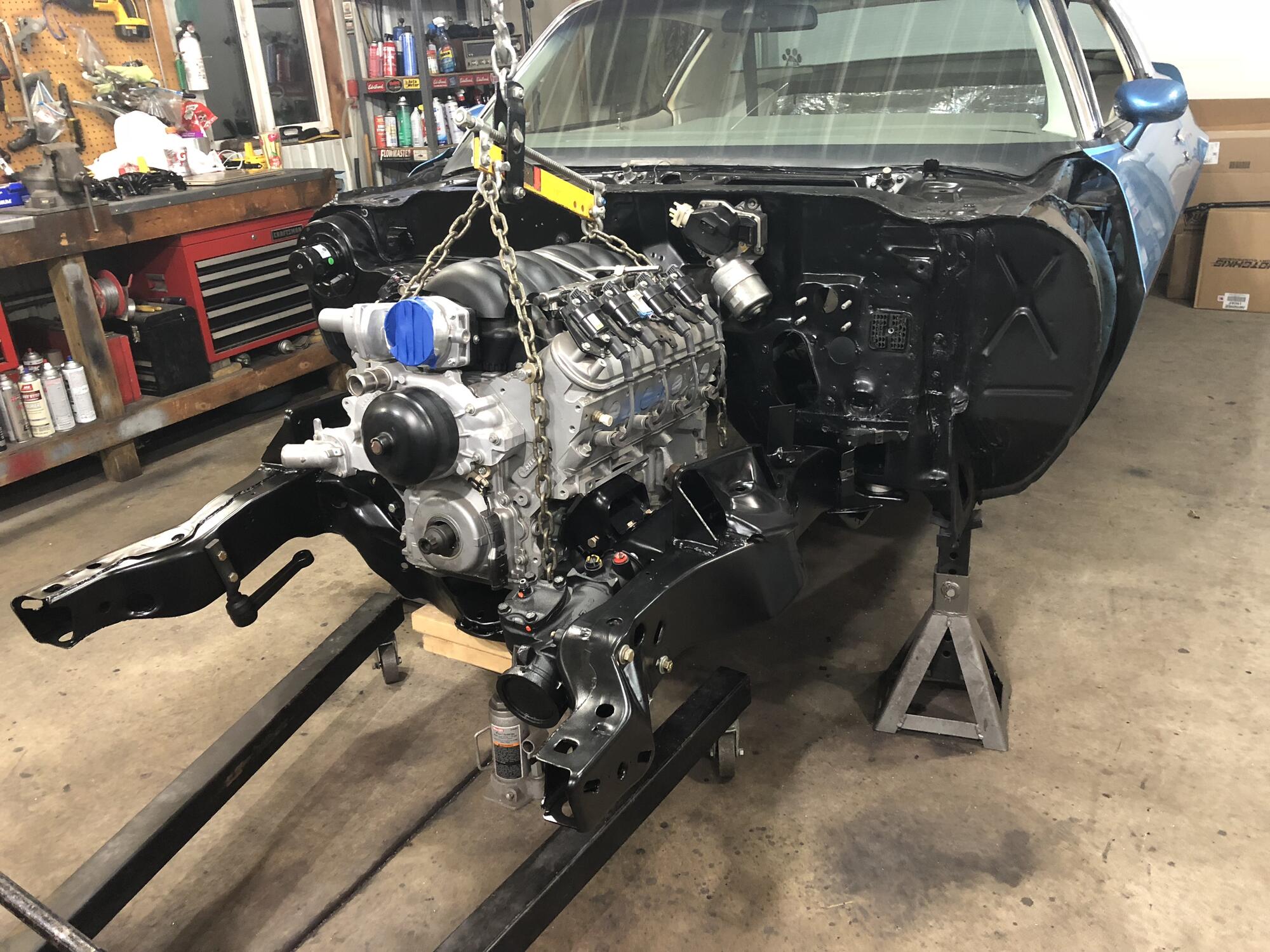

      A bit more progress. Engine in for good? Engine wiring harness plugged in. Exhaust back on for good. Starting on the wiring on the inside of the car with the ecm and dash wiring. Bumper support back on. Hope to fire it after deer hunting.Name:  IMG_0574.jpg

      That's totally awesome cannot wait to see it progress.and a great foundation.

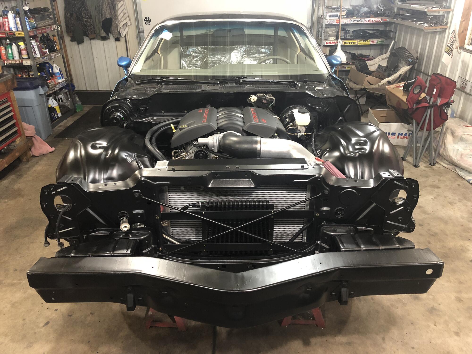

      More progress. Starting to look like a car again.Name:  IMG_0587.jpg
Size:  398.7 KBName:  IMG_0588.jpg

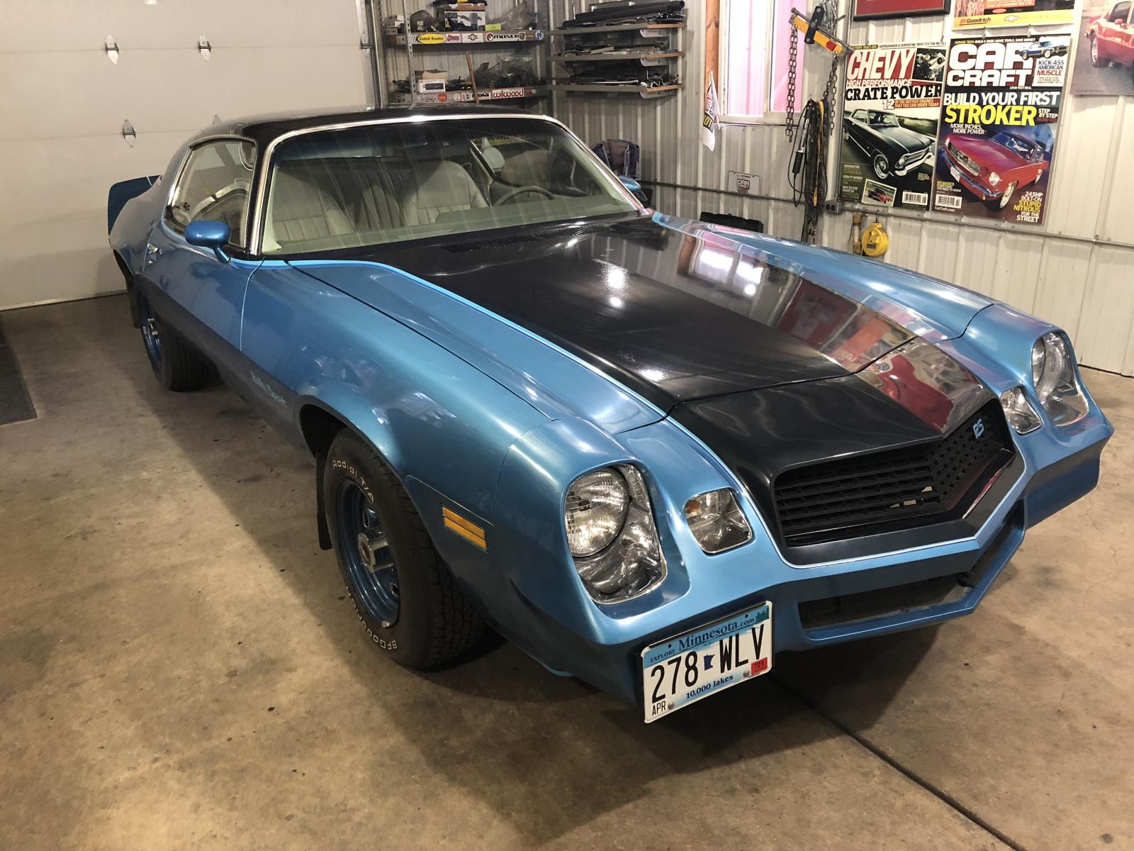

      Man I can't believe it's been so long since I updated the progress. 95% done needs a tune and front end alignment. I've put a miles on it. Seems to be pretty snappy.Name:  IMG_0654.jpg
Size:  330.4 KBName:  IMG_0654.jpg

      Looks great!! Very clean install!!

      So I had a "drive" tune a couple of weeks ago and front end alignment yesterday. It runs and drives great. I really considered the Holley system but my engine/trans combo is pretty mild and I've such good luck with the OEM GM stuff I went that way.
      We have a couple months to enjoy. It sits a little low in the front so I'm debating a coil over conversion or just some spacers. $600 bucks or $30 bucks. LOL.
      The alignment guy loved working on all new parts in the front end. I took a gamble on Summit tubular upper and lower a-arms. They were able to dial in 4.8 caster with the proper camber.
      I still chuckle to myself that I could find a 28K original mile no hit Camaro with zero rust in MN.
