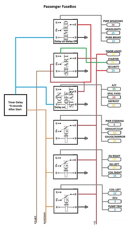

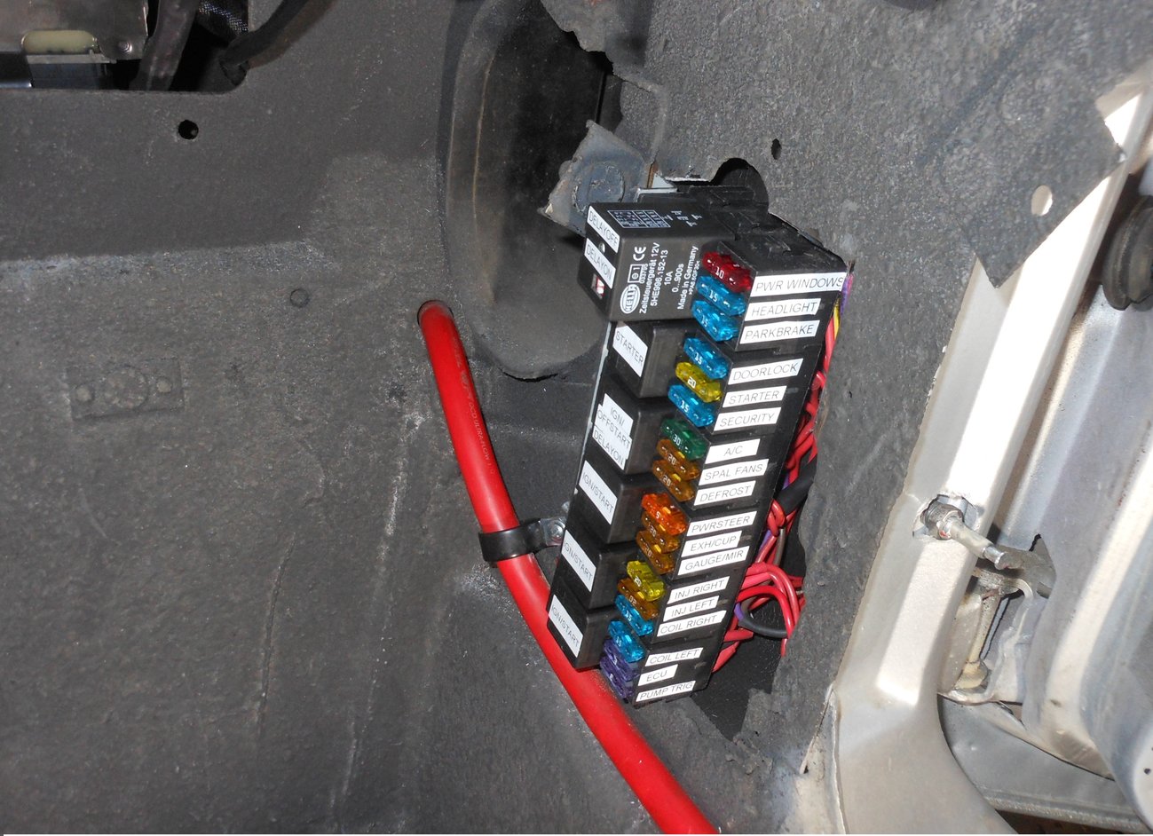

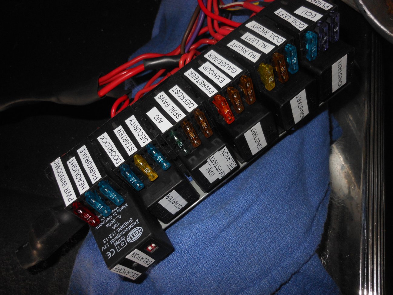

      Here's how I did it-
      The fans & AC get power after a delay (mine is set to about 6 seconds -but adjustable up to a minute) after the starter is run - just like the delay on new cars.
      If you try to start- then turn off the ignition -it will reset the timer.
      I have ignition power- ignition & start power- and ignition delay -no power start-
      And also added a ignition timed output- Hella relay (up to 15 minutes after you shut off car) for Power windows /headlights.
      This is a second fusebox for all my add-ons-

      That's a good way to do it instead of something based on engine run. I hadn't thought about using a delay timer since I'm all solid state programming with no fuses or relays. I wonder how I could adapt that idea, I'll do some research.
