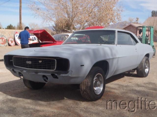

      I guess I never started a build thread for my car, so today seems like a good day to start.
      For me it's very slow progress. I bought the car in 2012, while I was living in WY, and didn't start doing anything to it till 2016. Then I moved to a new house up there, and lived a couple of years, then ended up moving to AZ in July of 2018. Been busy working and moving it seems, so now time to focus. I won't bore you with anymore of my life. Lets get to the Nitty Gritty.
      Bought the car off of Ebay. Drove to El Paso TX from WY to pick it up. I only have one pic of the car from when I bought it, since my other computer crashed, and I haven't been able to get the pics off of it yet.
      I'll start off with a few basic pics and some as I have time.
      Ebay pic of car, and what it looked like when I bought it.

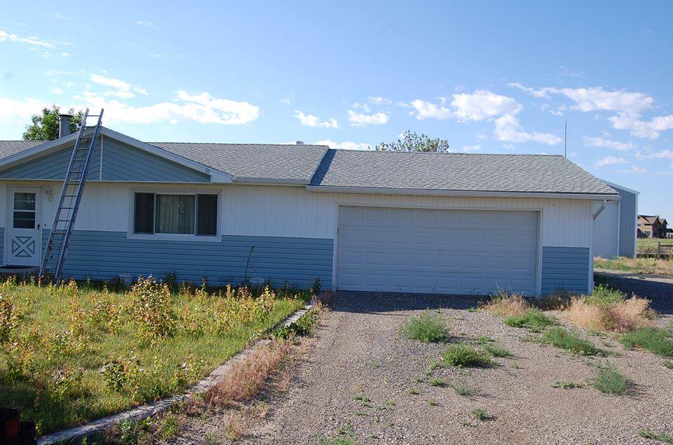

      The move
      Well, now things slow down, due to a move from the little house we were in with a 1 1/4 car garage, to a house we bought with a 30 x 45 pole barn building Only thing is, I stopped progress on the car to try to re-do the shop, and basically wasted time and money, I could have put towards the car
      You can see a little of the shop in the background
      Poor car, just siting there all neglected and stuff :(
      I had big plans for this shop. Office, spray booth, insulated, heated. Almost got it finished, when we ended up moving south from Wyoming to AZ.

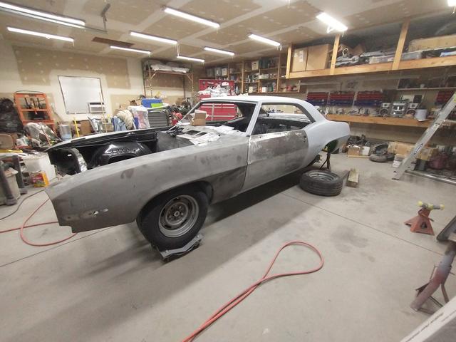

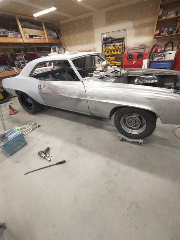

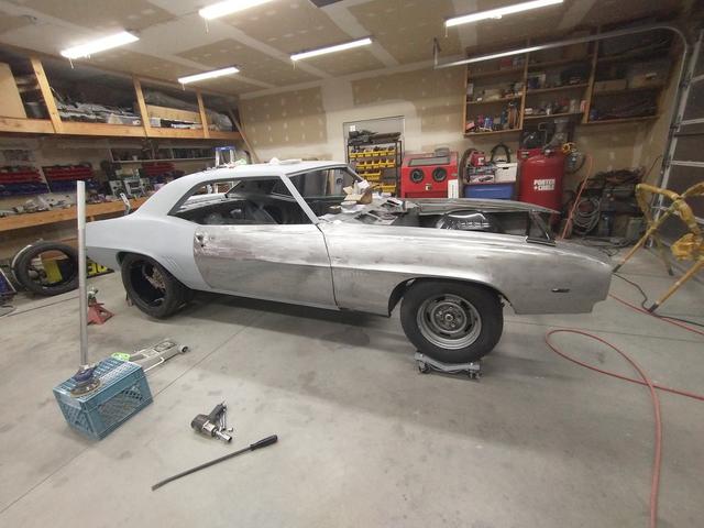

      We're close to current status
      Moving along to the day after Christmas of 2019.
      Now that the panel alignment fiasco is behind me, it's time to strip her down to the skeleton. I was just doing sporadic body work on it, when my friend suggest taking it down completely and stripping all the paint off. He was telling me the fumes from the paint remover can actually loosen and lift the body filler, so it's better to start from bare metal, then deal with the body work.
      The car only had a primer coat, and the original rally green under it, so it's not had much done on the last 50 years, but definitely has some road rash.
      Take it all down. I wonder how many more times I'll do this
      What do you do when you have to take the hood off by yourself? You improvise
      I almost stuck with the original green, but chose something else. You'll see soon, if you stay tuned to this build
      Some rust in the lower left rear quarter to fix
      Got'r up on the rotisserie

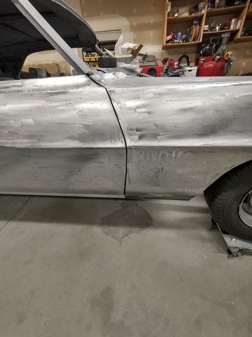

      Driver rear quarter rust repair
      I had some folks tell me to replace my quarter panels with new ones. To me, the car is only original once, so I wanted to save them, as much as I could. Also, seeing the fitment issues with aftermarket panels..NO, I don't want to deal with that headache!!
      This is the second thing to repair after the roof B pillar.
      Just bought a patch panel, cut out the old, treated the inside part with rust inhibitor, and welded the new panel in place.

      I am, at a point of starting to do body work, which as you can tell, I don't do so well. Started working the top of the roof, when my friend suggested to not do anymore filler work, till I stripped the car of paint, because the paint remover fumes, can get into the filler and loosen it or soften it. I never even thought about that!! Also, this was originally a vinyl top car.
      Also, he said don't spot repair the roof. Skim coat the whole panel, along with every panel on the car, then sand it off, because it will fake you out, where the high and low spots are. Boy, he was right about that!!
      So here I was, starting to do just spot repair on the roof, before the actual full tear down. I never said I was smart
      So here's a full skim coat before sanding
      After some sanding
      Some guide coat
